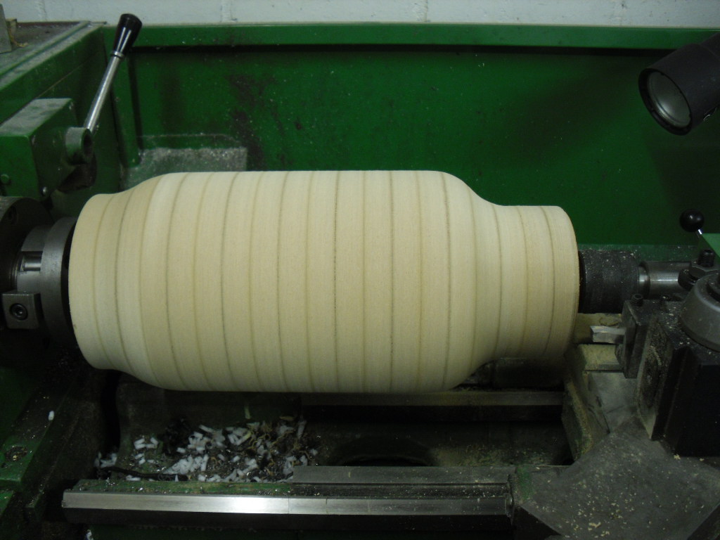

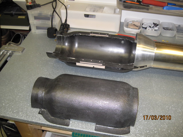

Yes West is good, made a series of carbon bypasses for a Skygate Hawk full duct conversion a few years back and worked perfect with some BVM Heatshield on the back 1/3rd.
Plug and bypass..........
