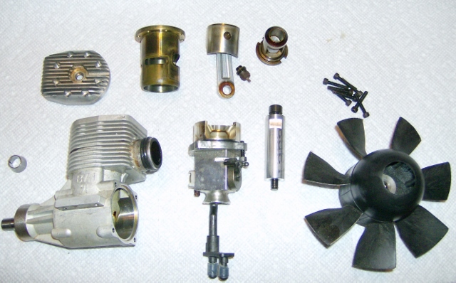

I have been offered a BVM.91 with fan unit and pipe but on taking a look at the engine insides I can tell it will need a new rod. Does any body has a new rod for sale?

The quickest way to get an answer to your question would likly be to contact BVM direct and ask them if any manufacturer is still supporting these engines.. I seem to recall that Jett Engineering Inc. (google them) was suppling parts for them a while ago, but I’m not sure of this fact..
You may already know this. The BVM DF engine, like all high performance piston engines, had large big end clearances to allow for the high RPM. New engines also had very tight piston to liner clearances at the top, which coupled with the “loose” big end, would result in a pronounced “CLICK” when turned over by hand. This could be confused as a worn big end of the rod..
Having said this, if you have any doubt at all, it would be worth changing the rod. They fail spectacularly!.
I have owned 2 of them. Brilliant engines. A piece of history now though..

Yes I hear a click and with the backplate removed I can see the crankpin move on the conrod bushing. I don`t know how much clearance is supposed to have also I have no paperwork or operating instructions. I couldn`t find info on the internet via google. Do you by any chance have the operating instructions? Thanks for the reply mate.

Pull the rod and look at the big end bushing. Make sure the bushing has not spun in the rod covering up the lubrication holes drilled into the big end journal. This is the usual culprit leading to rod failure in these type engines. Did it a gazillon times running Nitro boats years ago. At least until some of the motors started showing up with Needle bearing big ends. Then we started shearing crank pins, And the beat went on........

If I recall correctly, .003" is the magic number for the clearance on the big end.Check with a local machine shop if the bushing is indeed worn out. It is a simple task for them to remove then press and clearance a new bronze bushing. Make sure they chamfer the edges and open up the oil holes.

Also, when you've got it apart, make sure that oil port is installed facing the carb. It's easy to not pay attention and point it the wrong way. I've got a broken one on the wall in the shop. Remember the day it seized up mid flight. was the most abrupt stopping of sound.....

I really appreciate all the help, I bought the engine after taking a good look. I have the engine,fan and tuned pipe that goes with it. I took it apart to give it a good cleaning,replace the bearings and I will be drilling the rod for an extra oil hole in the big end. The cilinder and piston have normal wear but it seem like the engine was not used much. the conrod play is as Roger stated I was able to hear it click. I will be measuring the conrod bushing and crank pin to make sure it doesn`t have excessive wear. I have been around model engines for a long time and I took it apart very carefully to avoid damage to any parts. I grateful for all the information you guys have provided. I have dealt with Dave Shadel previously and tried his site on the internet but is there no more. I will be giving him a call. I had bought Nelson Q 500 .40 engines from him and I know that the quality of The Nelson engines are second to none. Still have a few.Thanks.

If anything, the clicking means you have good clearance. I went through a lot of pistons and sleeves (normal wear) but never a rod on BVM 82, 91R or the 96.
I would guess the clearance should be about 0.003 in, Col Thacker showed me an old trick, that is about the thickness of a page of a magazine.
I would not drill anything or modify anything but of course that is your choice. And start looking for spare pistons and sleeves!
