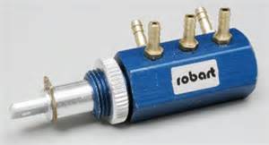

So I have been brain storming on this for a while now, Im about to start final setup point on my 1/7 scale F-14 and as you guys no these have heavy gear. I am using robart 2-way valves for the nose and main gear, each valve has two air outs and two air in, with one air supply line. I will run one to the nose gear and plug the second ports, while using both ports running one to each main. My brain storming is about adding a third robart 2-way valve so each gear has its own valve. The only kicker here is which ever setup I go with only have one air supply will be used. What I was wondering is with only one air supply feeding the two or three valves will this defeat my attempt at giving the most air/force to each gear air cylinder, will I be limited on the air leaving the tanks going to each valve? I know this adds extra leak points but all the valves will be run by one servo and the air supply is tied into a gear failsafe. I am about to put the nose on and start so any thoughts would be helpful! Thanks
A note to my madness, I am putting the valves in a location that gives the shortest length of air lines to help and I will be running two large air tanks just for the gear. Cheers

I think you are looking at the Robart valve wrong. There is one air in. (the single center nipple) That gives you two up outputs (one for the nose gear and one that needs to be T eed for the mains) and two down outputs plumbed the same way…… As far as pressure, the line diameter, length of line, and restrictor setting will not change the pressure to the gear. It will only affect the length of time to get the pressure to the gear.

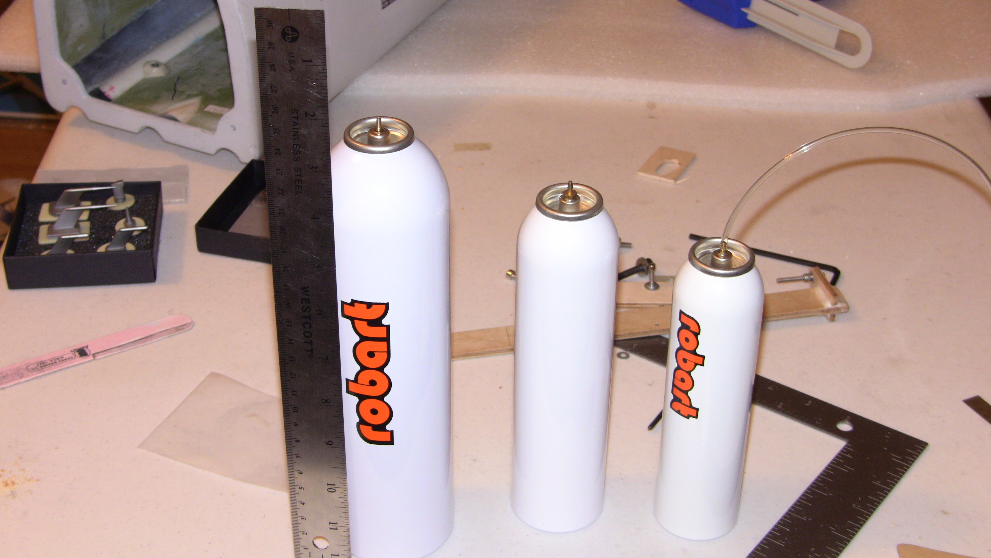

Old 03-01-2015 | 07:45 PM
FenderBean's Avatar
Joined: Feb 2006
Posts: 7,213
Received 99 Likes on 65 Posts
From: Huntsville AL
Awesome info, I wanted to make sure when you guys say 3 large tanks we are talking about the same large. These are the 3 tank sizes I have I the Large robart and medium robart, the middle is the skymaster tanks. I understand about volume but it seems like three of the large would be a bit much. I thought about running two of the large and then two of either the skymaster tanks or smaller robart tanks for the brakes/canopy/speed brakes and gear doors. I dont know where I would put four of the large robart tanks but two will under the aft equipment tray just in front of the main full tank, I can put the smaller tanks in the fuse on the outside of the inlets pushed as far forward as possible. I think like some people are stating its all about volume, Aussiebart mentioned his issue was getting the air pushed out on the back side of the air cylinder have more than one valve would deff help this as well.... I will post some findings and do a few videos showing the setups and how they work when I get to the final setup, I have the gear out at the moment doing other things.

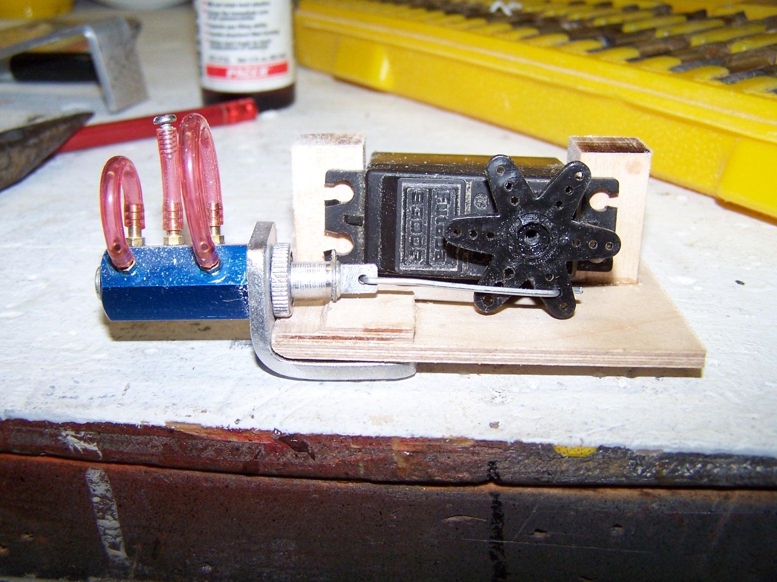

Old 03-01-2015 | 08:25 PM
Joined: Mar 2009
Posts: 1,235
Received 30 Likes on 17 Posts
From: willow springs , IL
Here is a video of my 1/4 scale Panther gear on 1 large Robart tank with 100 PSI in it. I used the same valve you showed in the first post https://www.youtube.com/watch?v=6INtZeAOYfA
