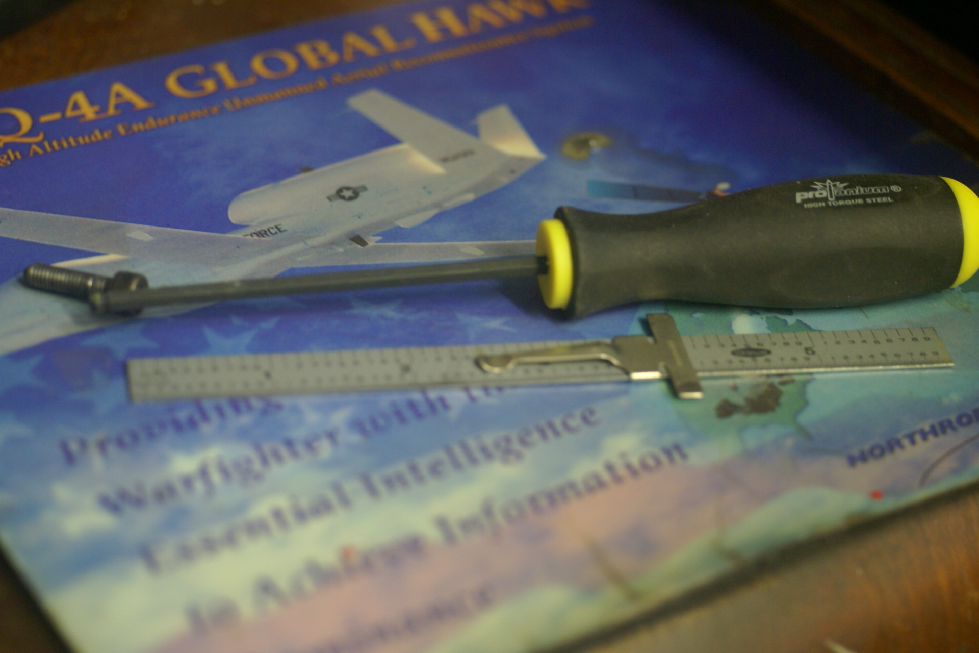

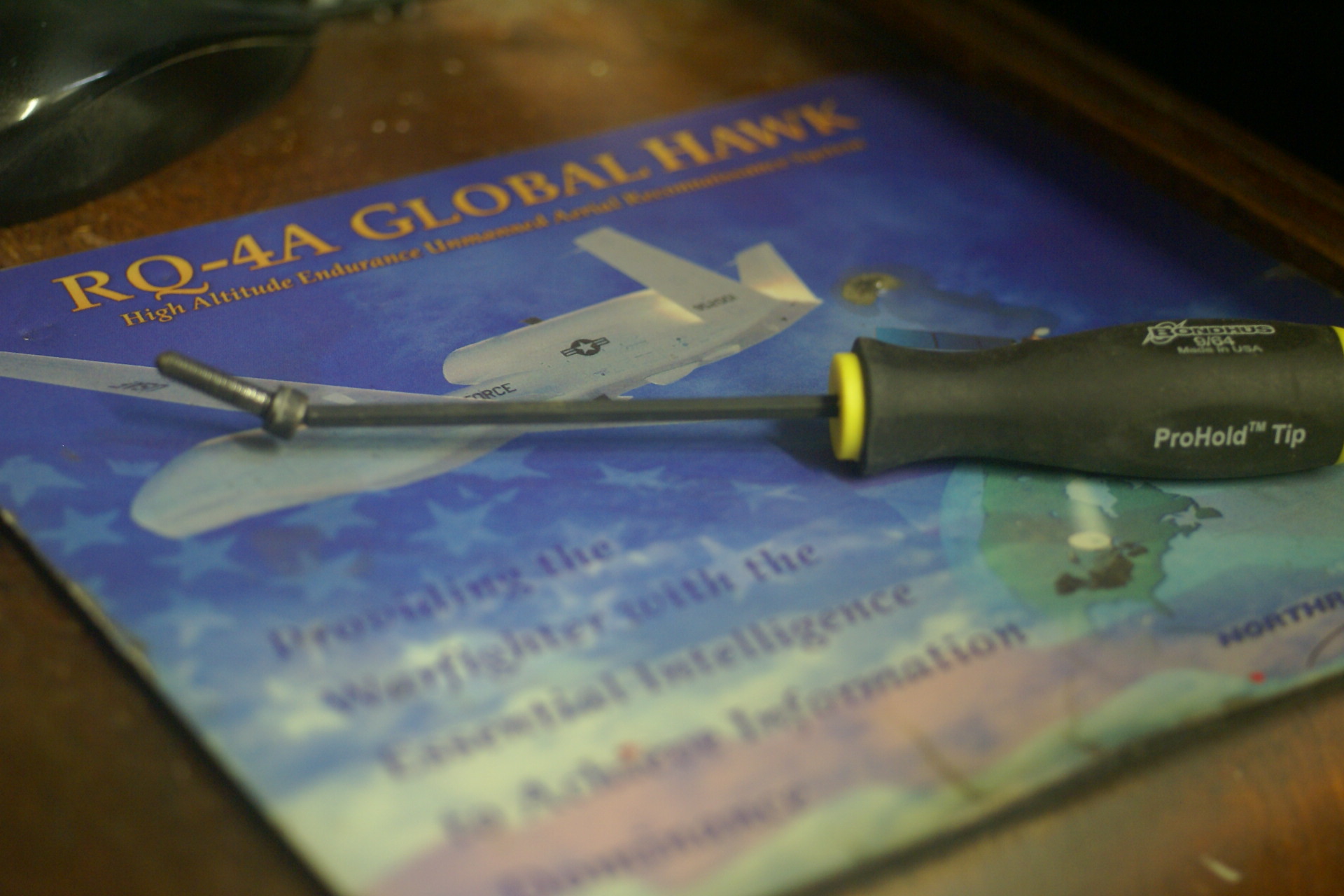

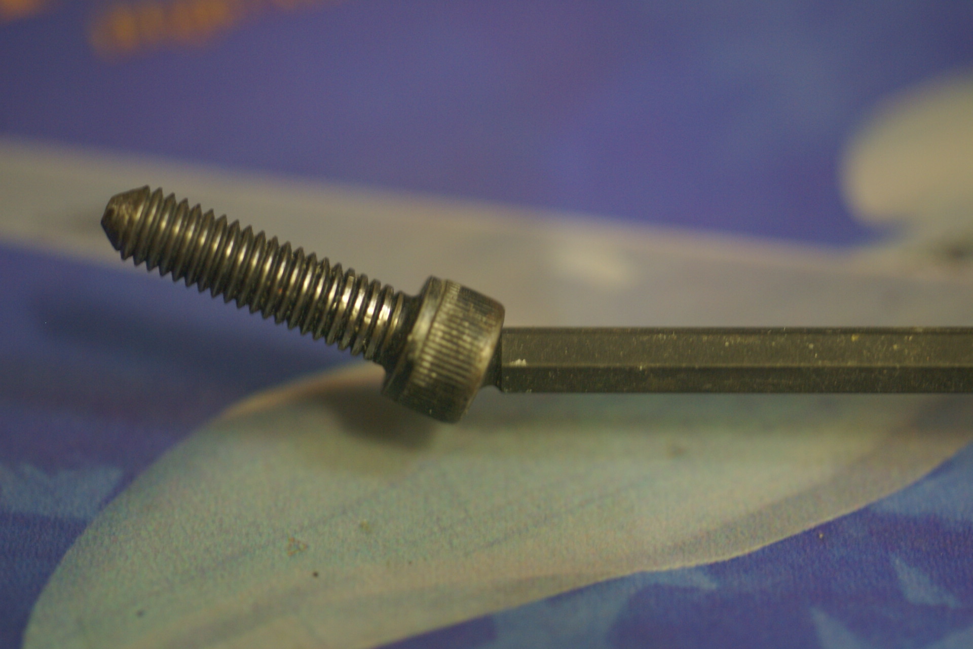

Old 04-28-2015 | 04:07 AM
Posts: 2,341
From: Longwood , FL
Absolutely!
They have a locking feature built into one segment of the ball which allows up to a 25° "off angle" of the screw.
http://www.bondhus.com/features/prohold/body-0.htm
The smaller sizes seem to wear out easier than the larger ones, and they are a shorter length.
Here are some photos of the 9/64 size, which fits Bandit wing bolts. The small pellet embedded in the end is very hard to see, but it is there.
