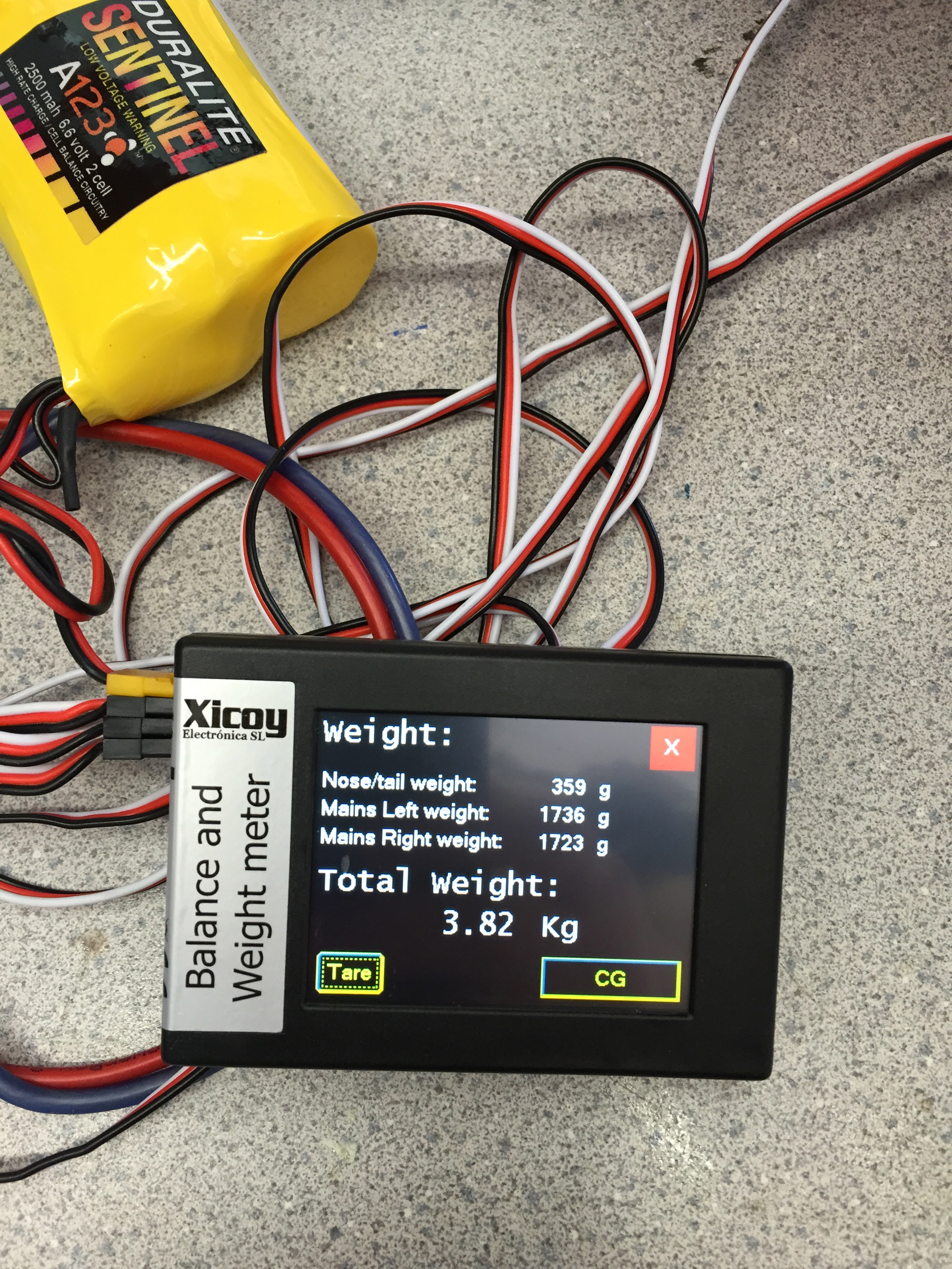

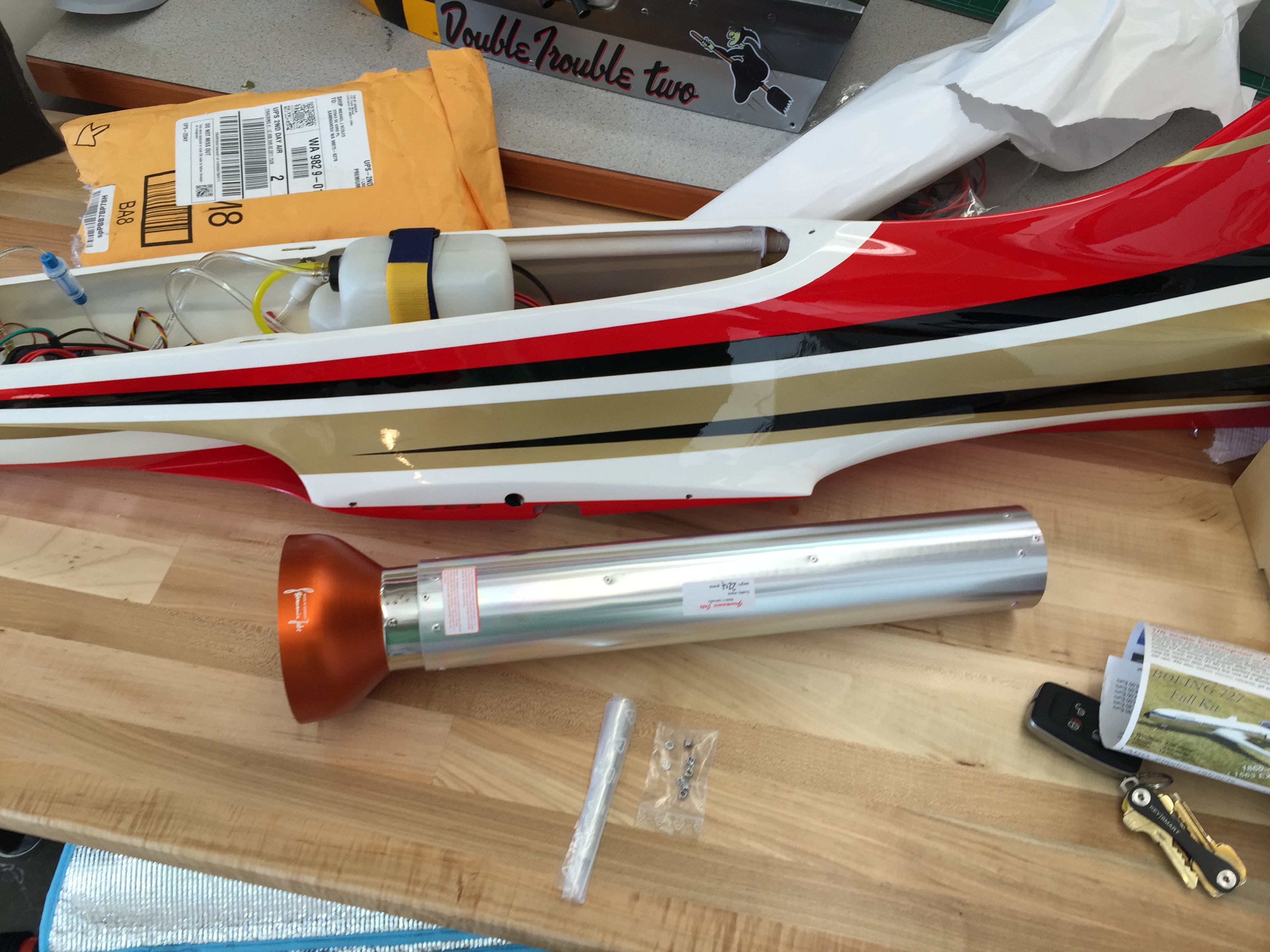

Had a chance to weigh everything. 8.4 pounds with tanks dry and a 2oz piece of lead in to account for the header tank. Kero weighs 80% of water by volume, (according to google)… ;-) So, the 32oz tank will be roughly 1.6 pounds of fuel, so take off weight will be right at 10 pounds. This is with a 2100 life turbine battery and a 2600 liion. My 8S habu 32 is gone, but this plane sure feels lighter than it.
I think Ilja and I had a communication error, the pipe might be too short. Need to see where CG is, then see if it will work. The pipe is fine if the turbine is back farther, but where I had it, its 4cm too short. ;-(

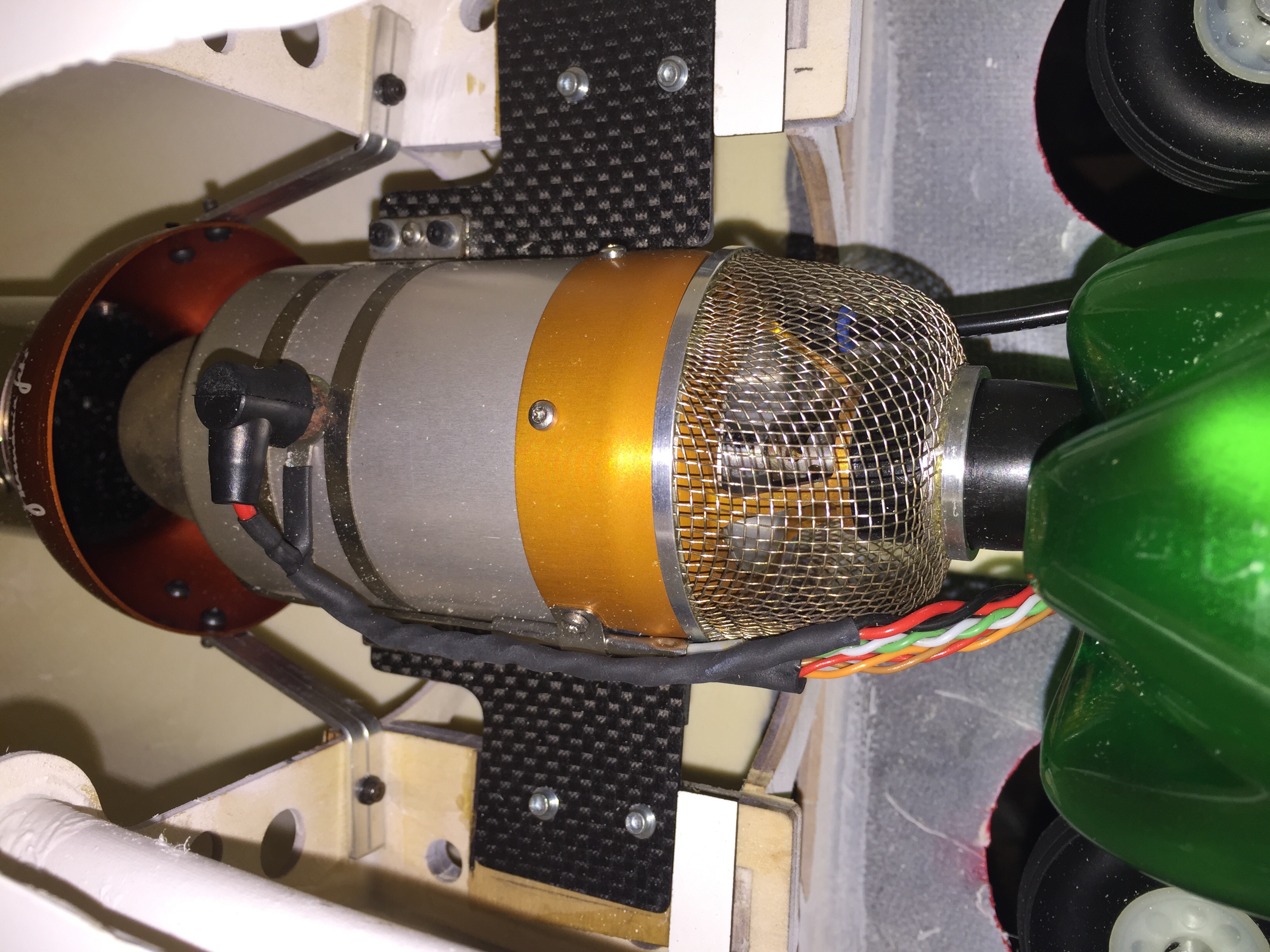

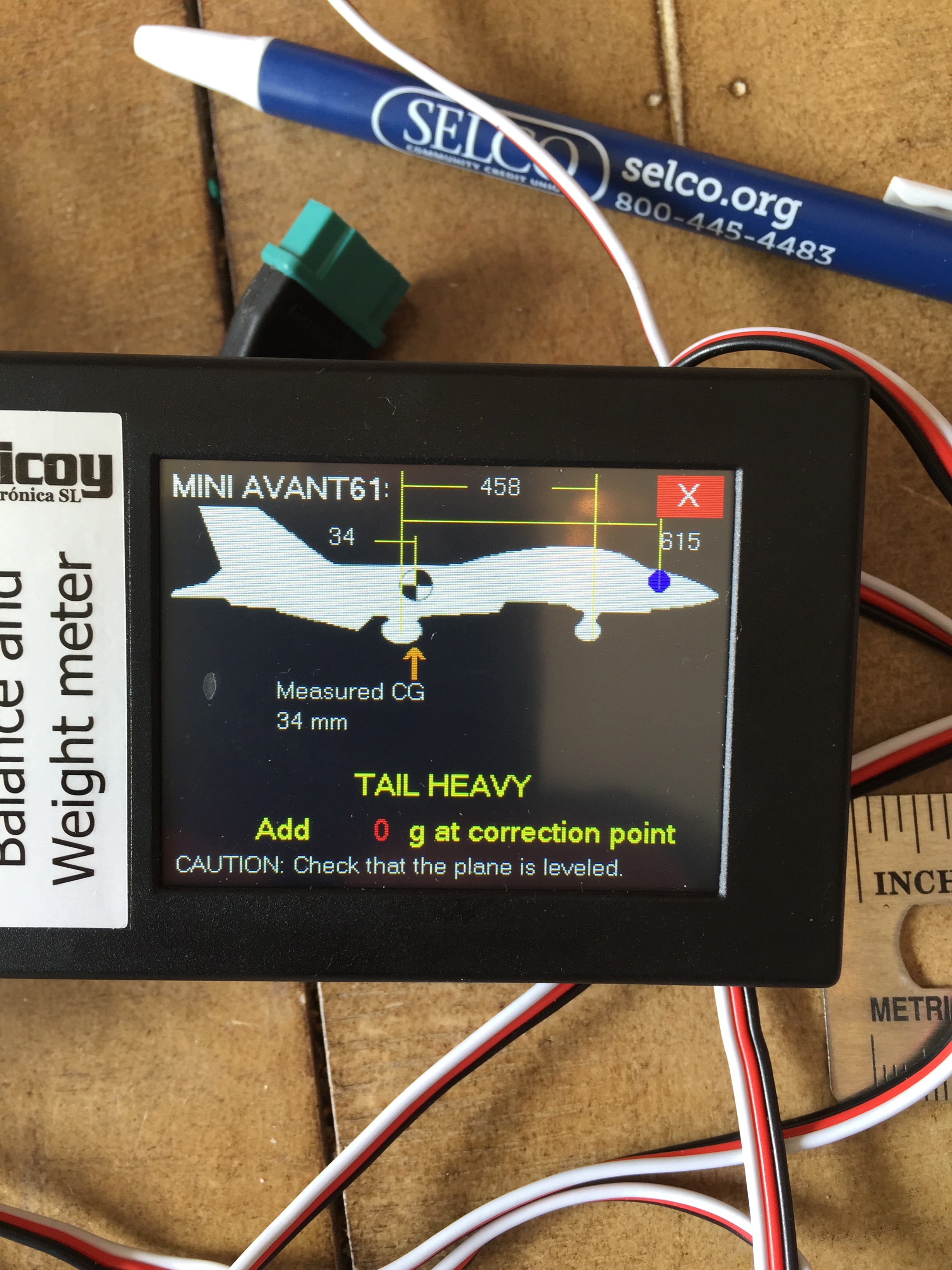

Trial CG. I put the turbine as far forward as it would go on the mount. The pic shows where the batteries were, there is room to move them another 4" forward. So, I think you could easily get away with having the turbine in the stock mounting location and still not have to add weight. Henke's words were running through my head when setting this thing up, wanted the turbine as far forward as I could get it.
Only thing left is the ebrakes. I found some with 2" wheels. This isn't going to effect the CG much, and will add a small amount of weight over the stock wheels. Both of the fields I fly at follow AMA rules, so we gotta have brakes!

The bell mouth on the grumania pipe does need to be cut down. I've been talking to Ilja quite a bit the last few days. If you want the turbine farther forward, the rear former gets in the way of the bell mouth. I may move it back a bit to find a happy medium. I did need to get a slightly longer pipe made.
The wheels were from a guy on regroups out of singapore. I will post a link.

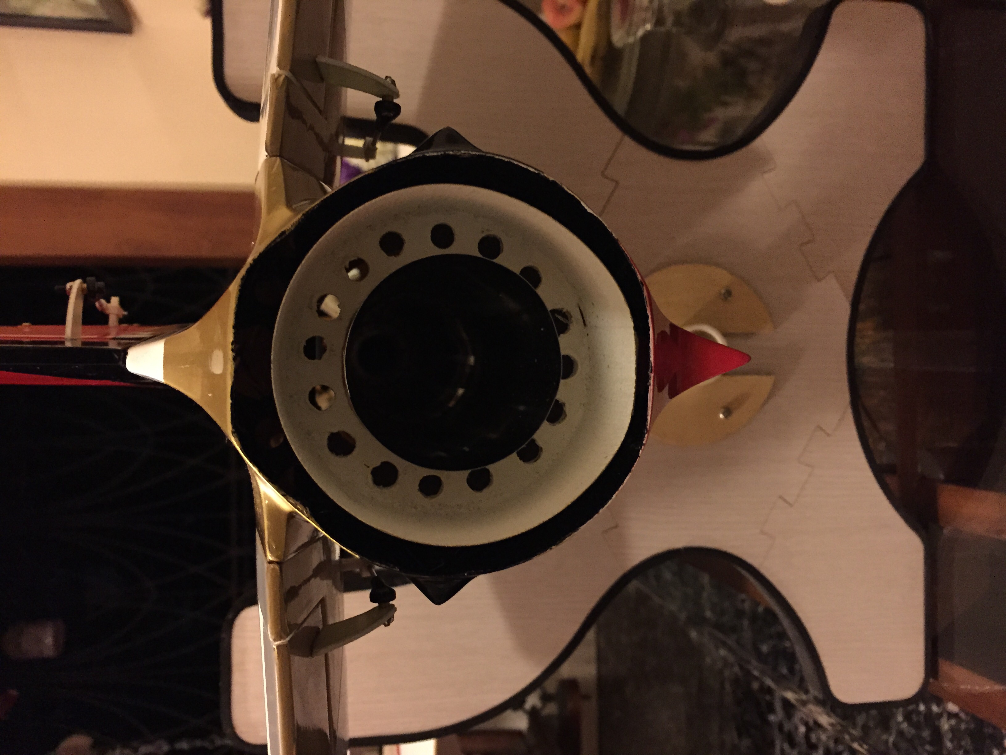

My goal was to build it really light and made some small mods.
I removed the 2 geardoor servo's and sequencer and made a mechanical linkage (saw this idea on RC Network and works great), made a pull-pull system on the nose wheel steering (stronger on grass), replaced the carbon stab rod to a hollow one and use small batteries (2x 450 mAh RX, 1x 1300 mAH turbine)
Weight without fuel INCLUDING battery's: 3,075 kg (6,77 lb).
Including fuel (750cc): 3,7 kg (8,15 lb), so the plane is lighter then Seba's plane.
Small movie of today to give a little impression. Sorry, recored by phone.

I had a left-over titanium pipe and cut it to 4cm/1,5 inch. This will function as the outer pipe. (only 4 cm)
I made a wooden ply ring, glued it to the aft wooden section of the fuselage and glued the outer pipe inside the ring.
The separation between the inner and outer pipe I made with a stroke of Titanium, Z-bended it as you can see.

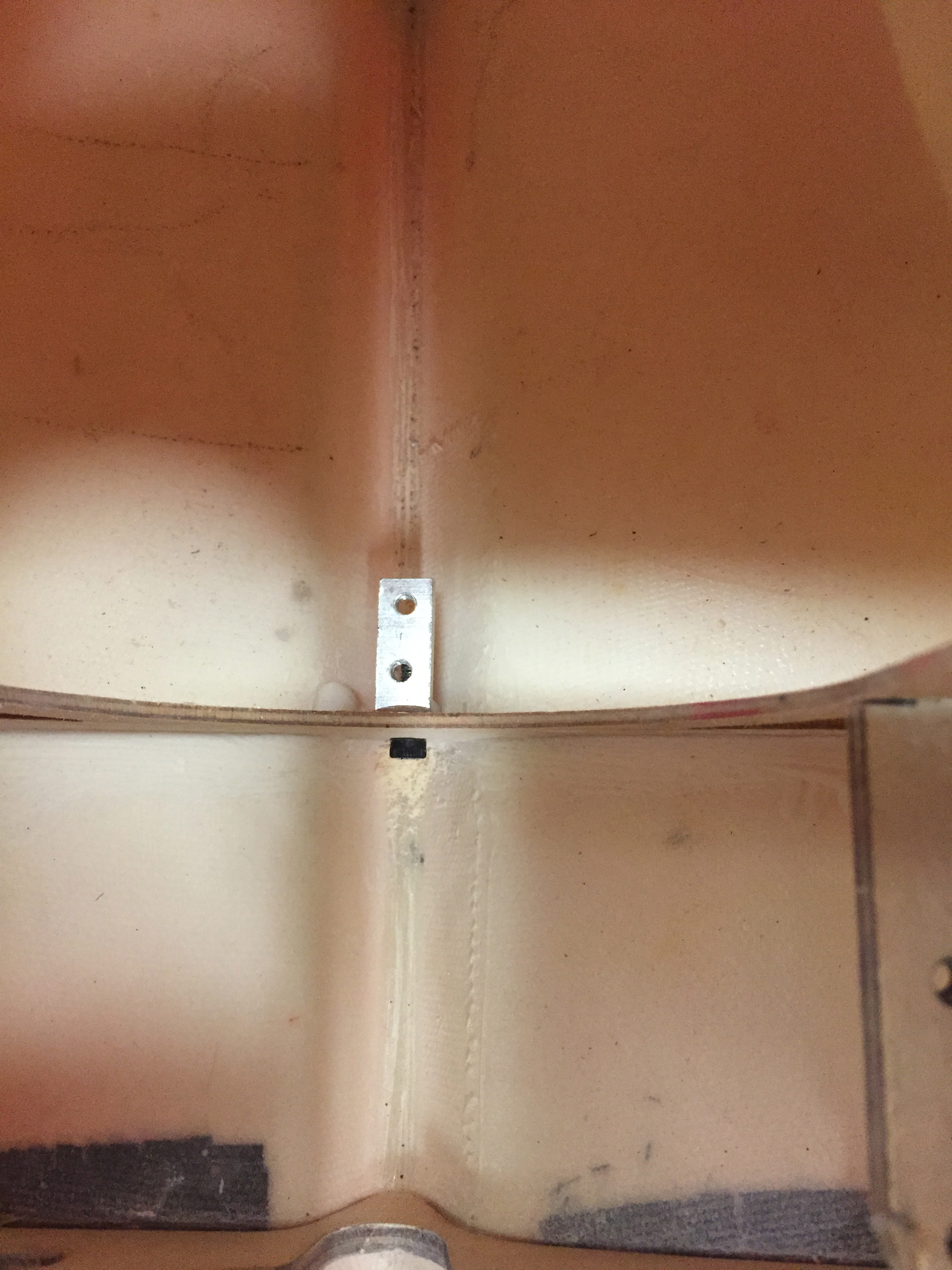

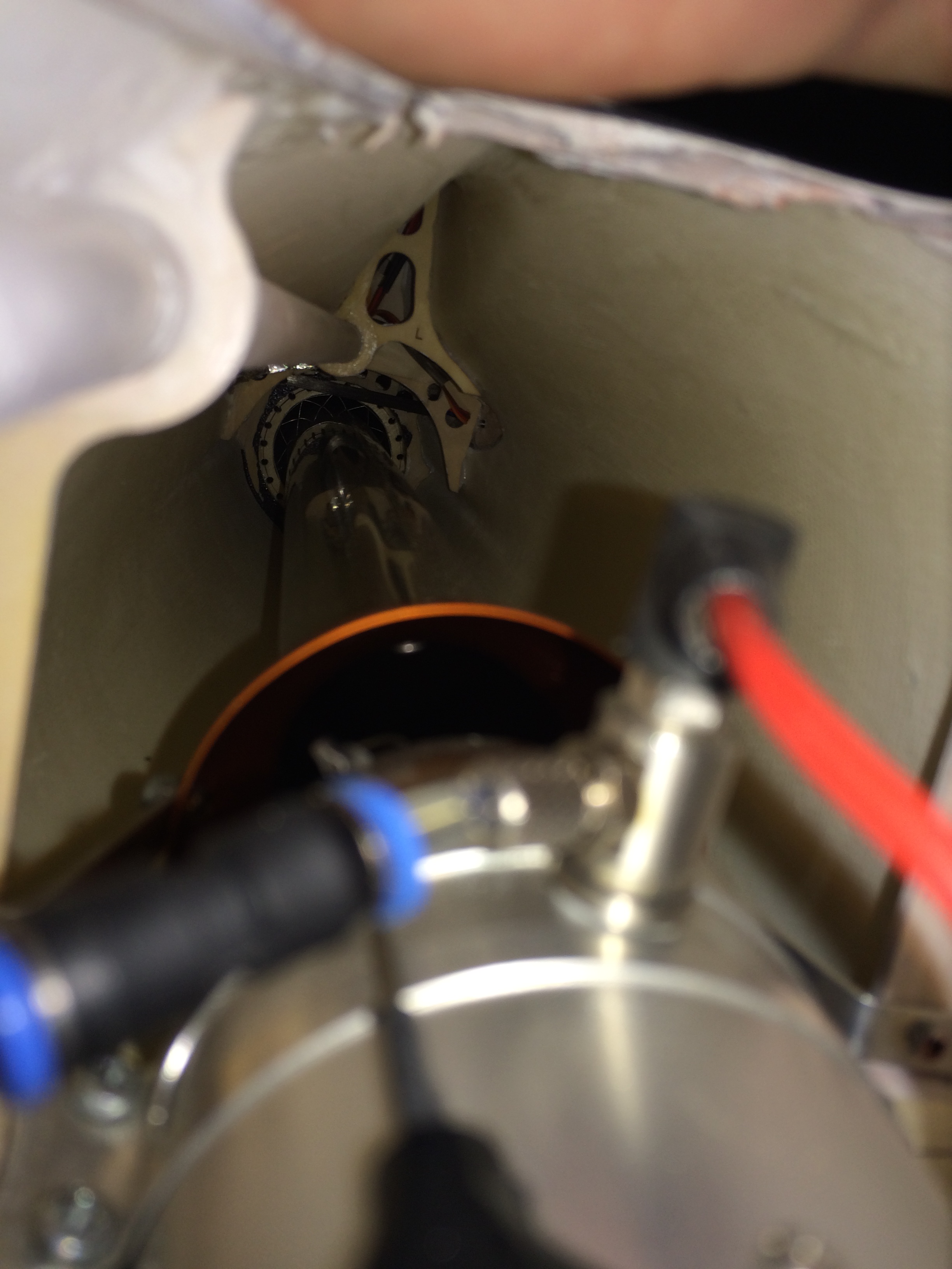

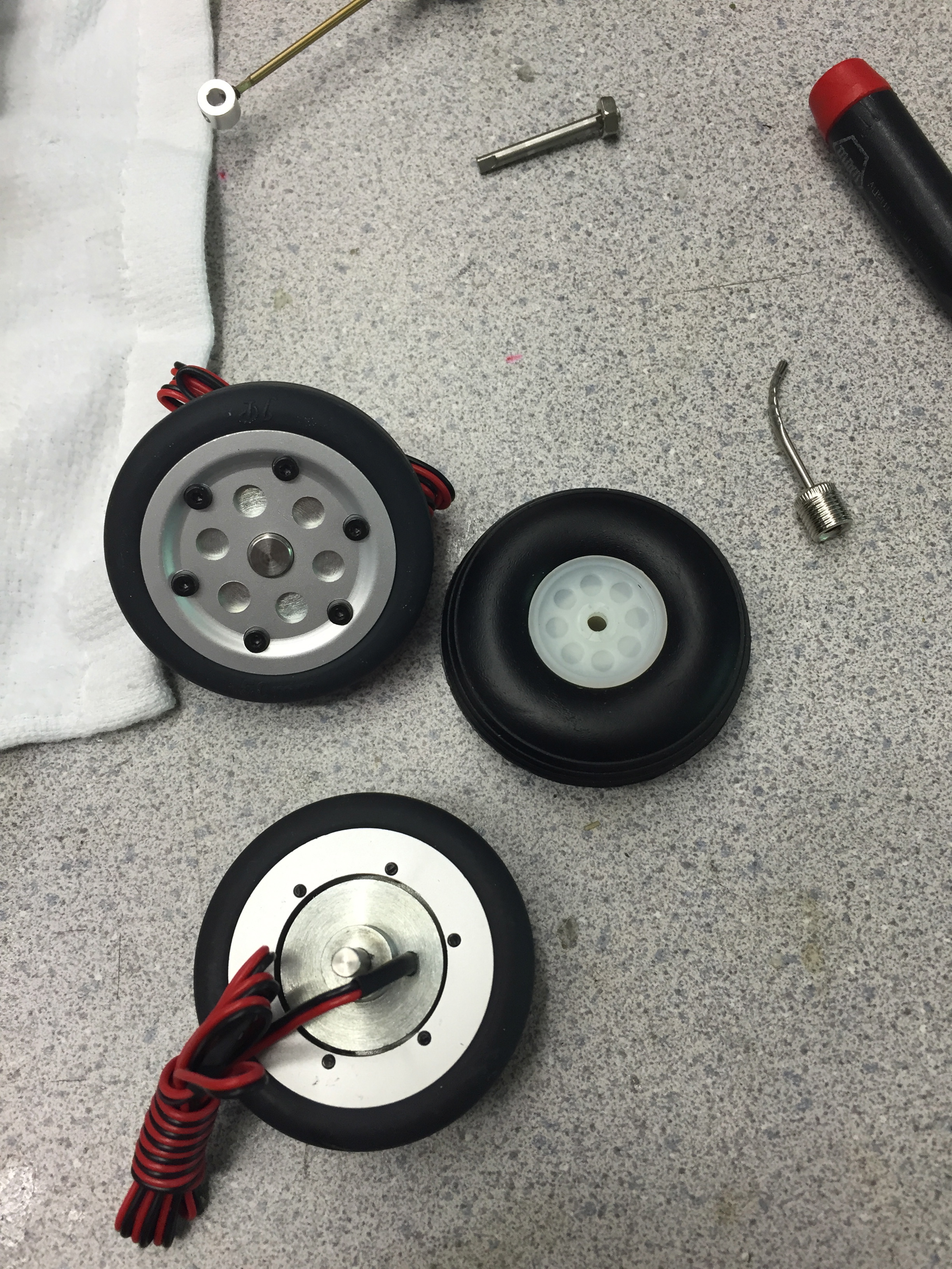

I got the ebrakes and the pipe installed. For those of you who need brakes due to flying at AMA fields, these are 2" replacements. The axle is 4mm, so you have to drill the strut out, pretty simple. They look very nice, but will obviously add some weight.
The grumania bell mouth is too wide to place the pipe and it at the same time. You have to bolt it together using three 3mm bolts while its in the plane. If you have large hands, might want to teach the wife how to turn wrenches. If your wife has big hands…. well… I put an angle bracket on the bulkhead for the bottom, and used one of the aluminum straps that grumania supplies and clamped it to the turbine. I had to cut down the bell mouth 2cm. Obviously, neither this pipe or the the kit were meant for each other, but you can make it work. I know Tam has made a pipe that might be easier to install???
I need to do some wire routing and it will be ready to go. Moving in the next two weeks, so doubt I will get a chance to maiden for a month or so… ;-(

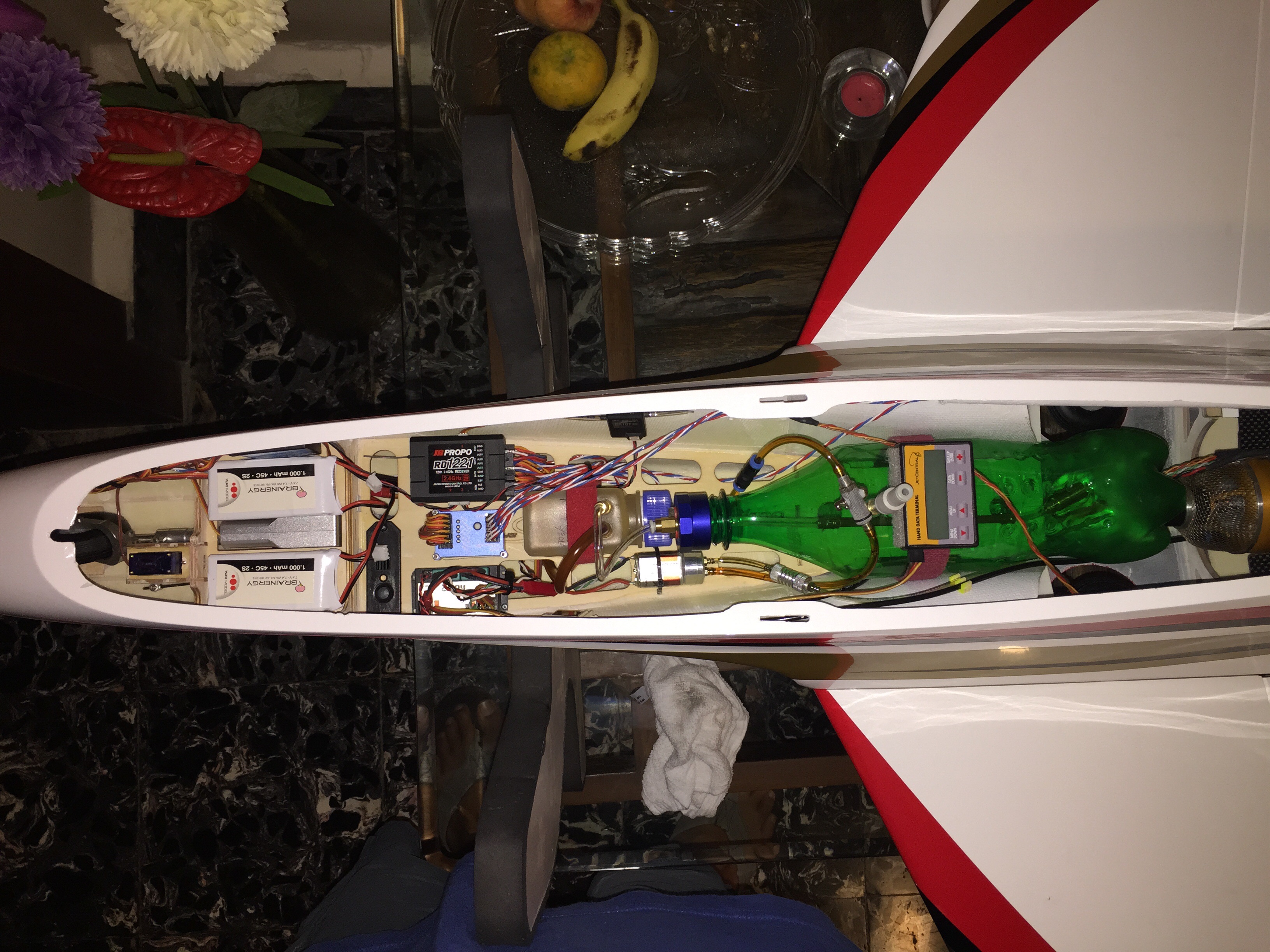

Finally finished building. lambert T35, grumania pipe. Total weight with UAT full and i gyro 3e is 3050 grams.
should have good performance. Can't wait to get her airborne.

Test flew the Avanti yesterday, had 3 flights. Was actually surprised by the Verticals she had, almost out of sight.
All systems worked flawless so far, the igyro 3e made landings a breeze even in cross winds of around 15 gusting 20 knots.
With the 3.5 kg lambert, she is just a super sweet combo.
