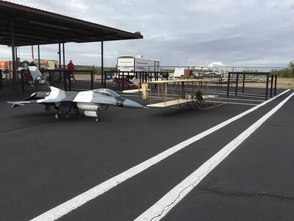

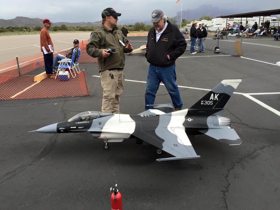

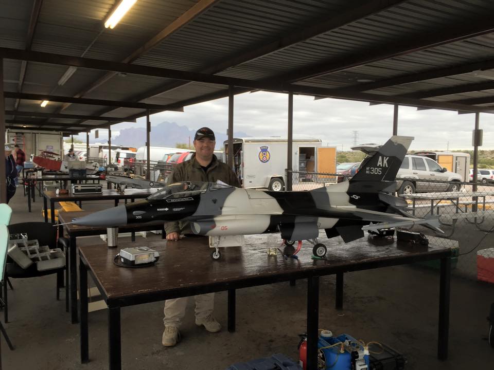

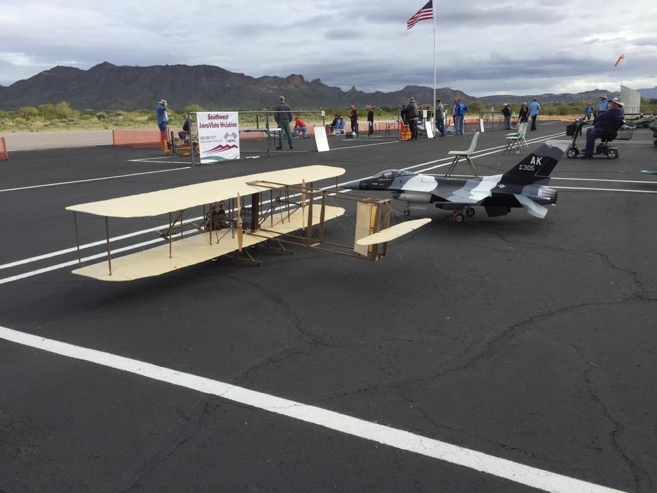

Here I am at the Scale Masters Qualifier in Mesa, AZ with my F-16.
Talking to my dad about the flight we were getting ready for.
This doesnt happen very often but I was fortunate enough to be "hangered" right next to the Wright Flyer model and was able to get some pics of us together.
Hope you enjoy the pics
Steven
Steven
