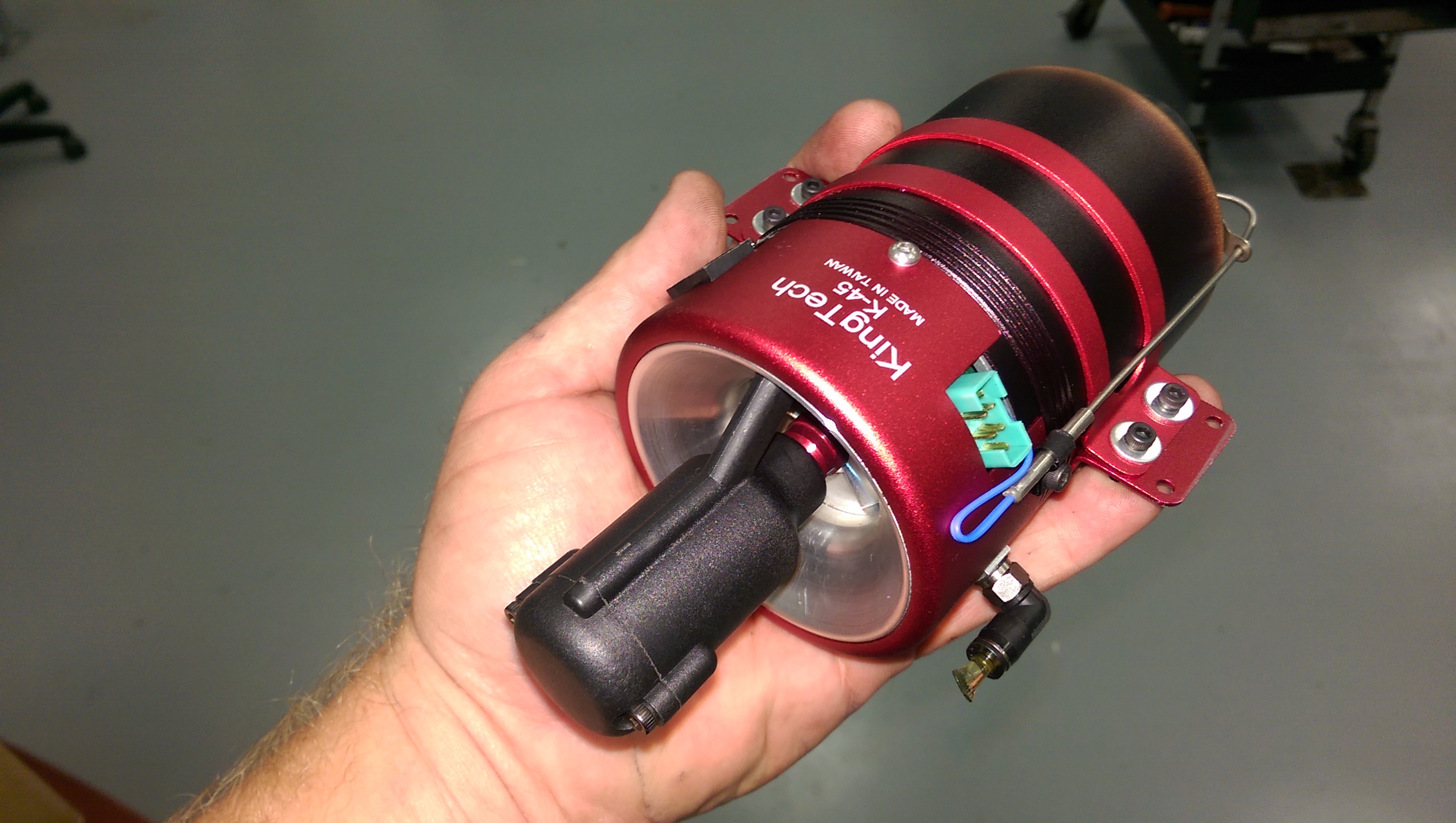

Starting a conversion on an old JHH-A7 electric to turbine. This will be a Kingtech Demo plane for the all new Kingtech K45. I know some people still have these planes sitting around so the K45 should make a good fit for this aircraft.

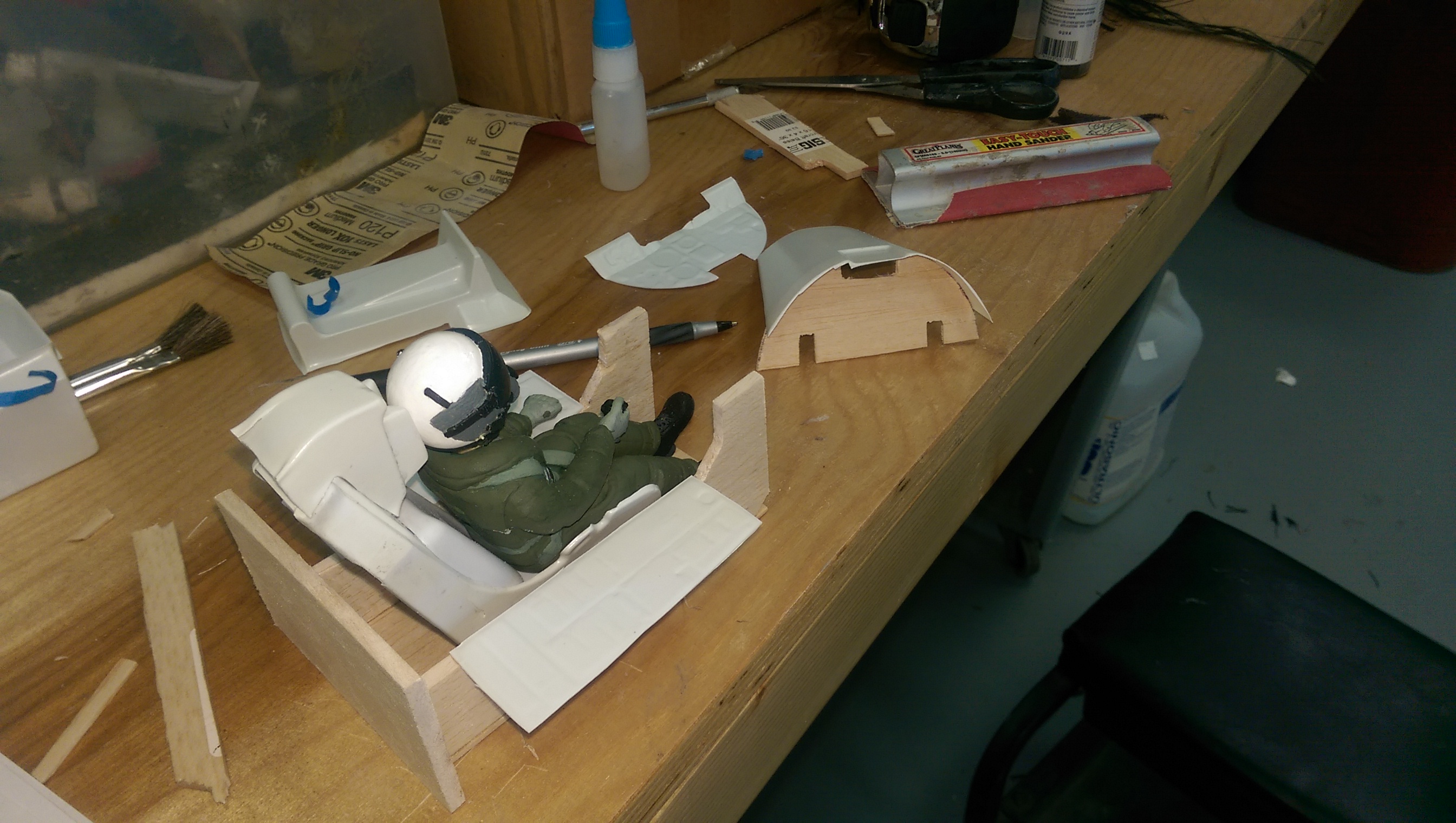

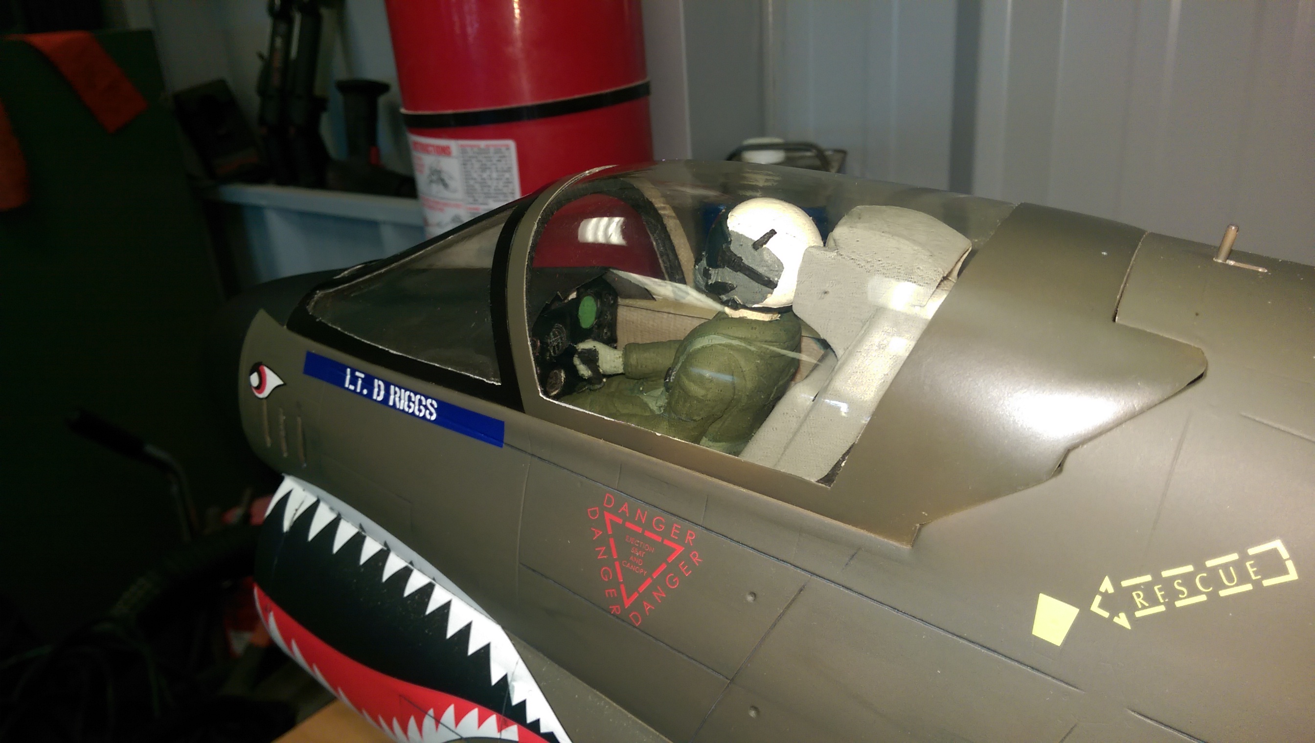

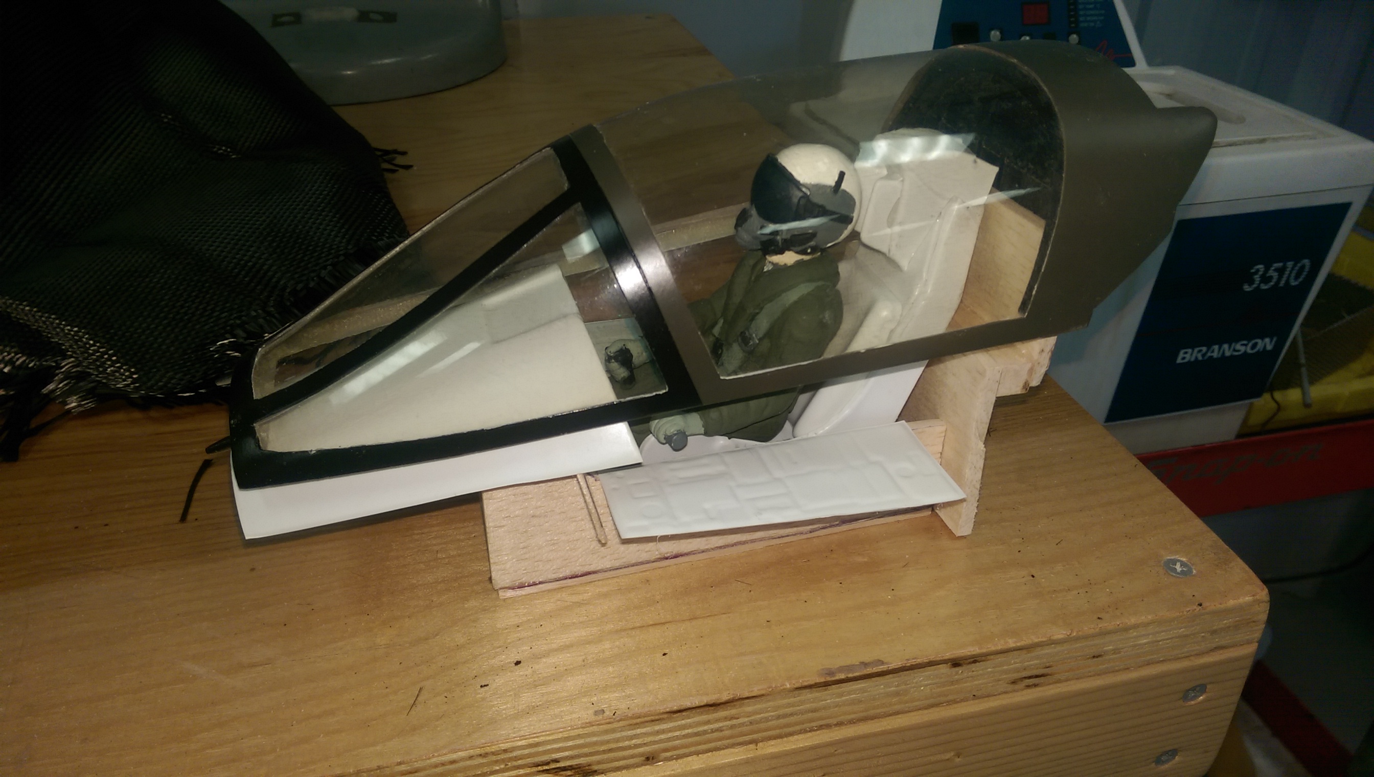

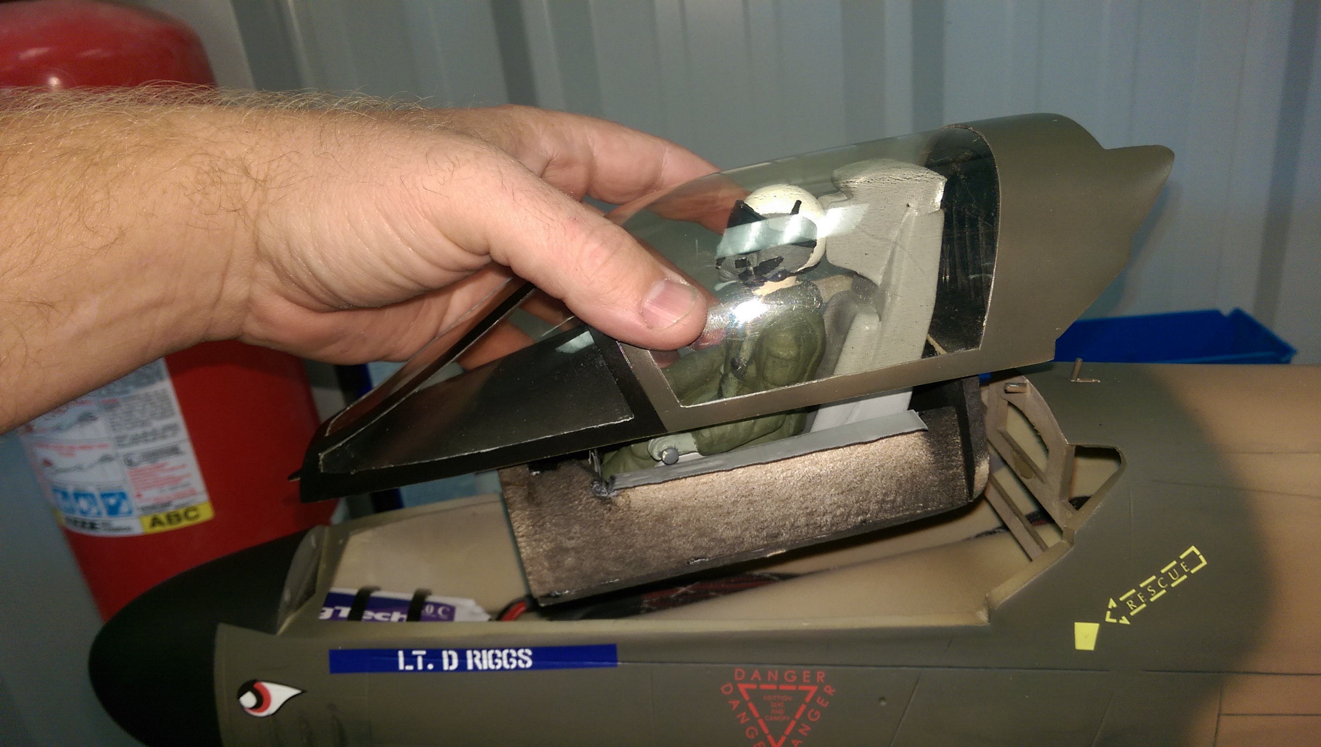

First up was to build the cockpit. The cockpit comes with some vacuum formed plastic parts that need to be assembled. Needless to say it was a pain. My goal was to make it look good but also make it easy to remove for access to the batteries. I want this plane to be an everyday flyer and so I am going to try and not get crazy with scale details. I was able to make the cockpit all one piece for easy removal.

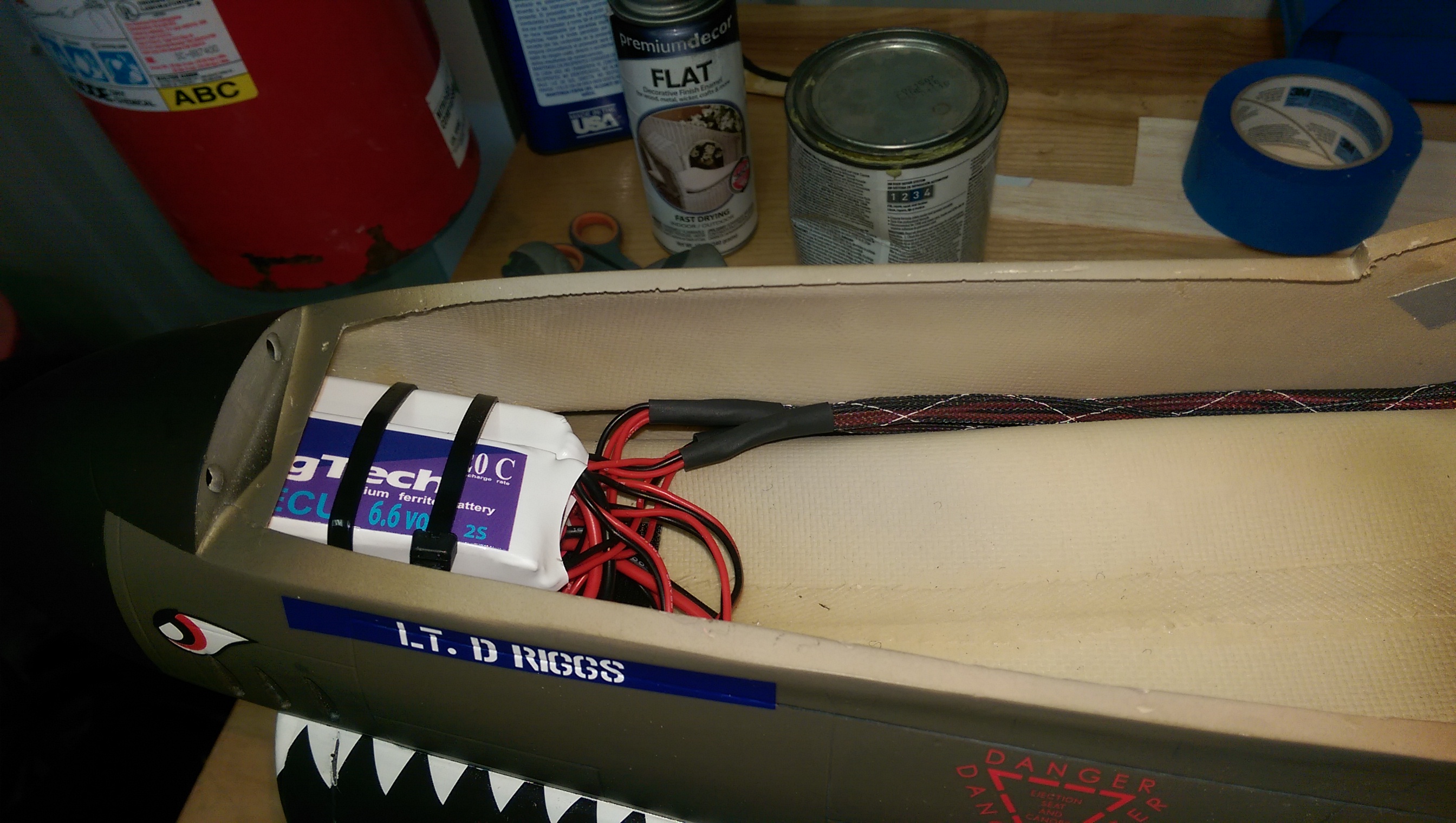

The electric set up had the engine mounts behind the gear. I will use the same mounts for the turbine so for CG both receiver packs and ECU packs need to go into the nose. The new smaller Kingtech LIFE batteries fit well for this in front of the cockpit. They come with nice long leads already installed also.

Not sure if you want weight of the plane or just the turbine. Here are the specs of the K45. Weight shows 1 pound. If you need me too I can weigh it. It has a tiny little fuel pump
Diameter: 76mm (2.99")
Length: 195mm (7.68")
Weight: 700g (1 lb. 8.6 oz. )
Max. RPM: 162000
Thrust: 4.5 kg @ 15° C ( 9.9 lb @ 15° c )
EGT: 700°C max
Fuel consumption: 155 g / min ( 5.46 oz / min )
Fuel: Diesel, Jet A1, Kerosene
Lubrication: 5%
Maintenance cycle: 25 hr USD300

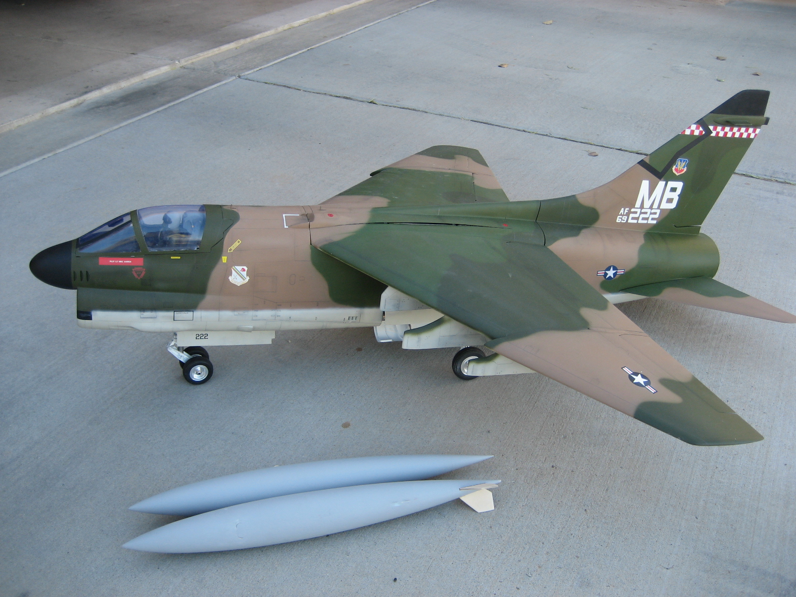

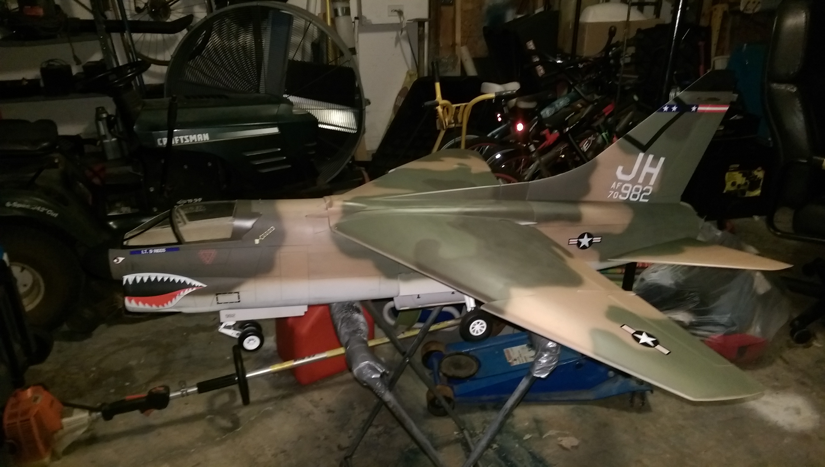

Hi Kris,
My JHI A-7D with a Wren44 (RIP) weighed a hair over 13lbs dry. This with a 4oz header tank, two 1100mah A123's, and scale cockpit and pilot.
- Mike

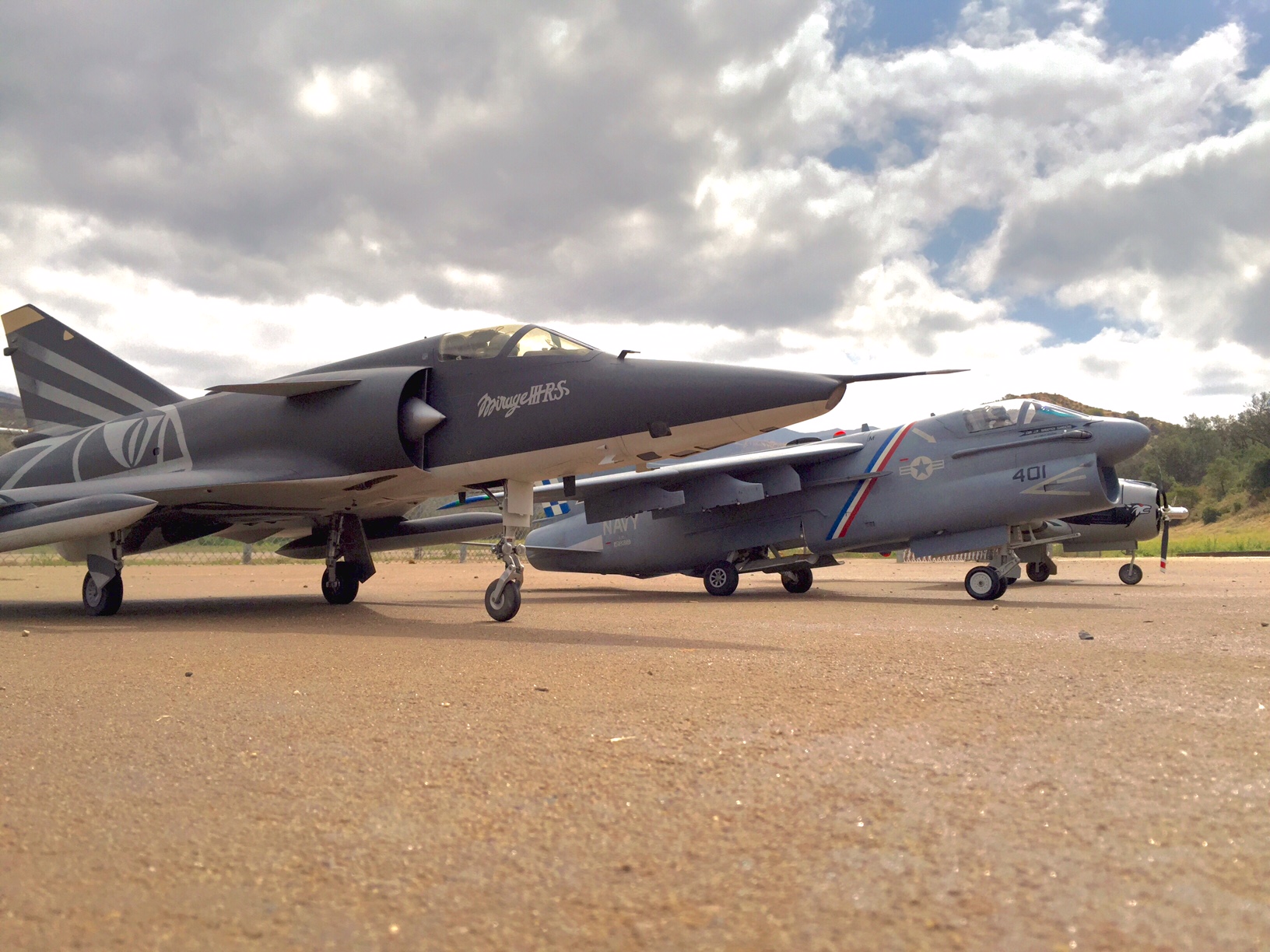

If it's helpful, here's video of my A-7 that was taken around 2008 when it still had the MW-44 in it. At the time, I was using flaps for takeoff and you can see the airplane wheel barrow prior to lift off. As Brian mentioned, the airplane likes to cruise with a decent amount of speed. As it slows down, the wings can wag a bit, but the key is to not try and correct it. If you're using a multi-axis gyro, then I don't expect you will see that at all. CG the airplane by lifting it with your finger tips at the LE sawtooth, that is THE best way to CG the airplane (don't bother with using the measurement shown on the drawing in the instructions). Lastly, regarding rudder throw, I have mine set at about 3/8" travel, I don't recommend any more than that, otherwise elsewhere I'm using all the same recommendations for throws that are in the instructions. Let me know if there's anything I can do to help!
