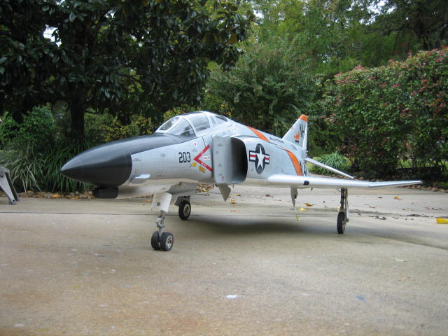

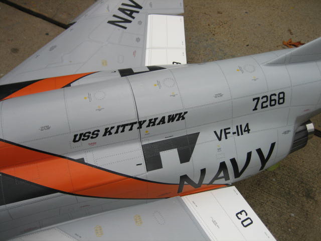

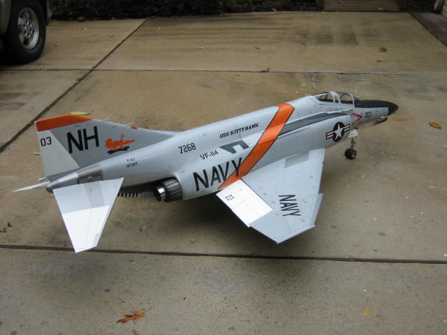

Do you have the belly pan or plug in wings. Canopy was a mess, the wing spars had to be redone, the elevator mechanism is not strong enough, the doors are a mess, the gear had to be worked on. Many parts had to be remade to fit
Old 07-14-2015 | 06:40 AM
Posts: 1,765
Received 51 Likes on 47 Posts
From: Spring, TX
Here is the final result. Tailplane mechanism failed during flight in the 7th year.

I could find no way to make fit what I wanted, In the end the pin that goes through the pivot block broke and jammed the elevator and plane spun in. I used to have high def pics of this in flight someone shot while filming but a computer crash lost that data

The best system is the BVM or Skymaster one piece stab with pivot plate. I should have molded one and converted but did not. The second one met that same fate only much earlier. Doc Rodriques had elevator failure in the fight 50 flights at Austin event

Wow! That's interesting. I'll have to look into retro-fitting mine when I get to it. Your F4 looked GREAT!!!
