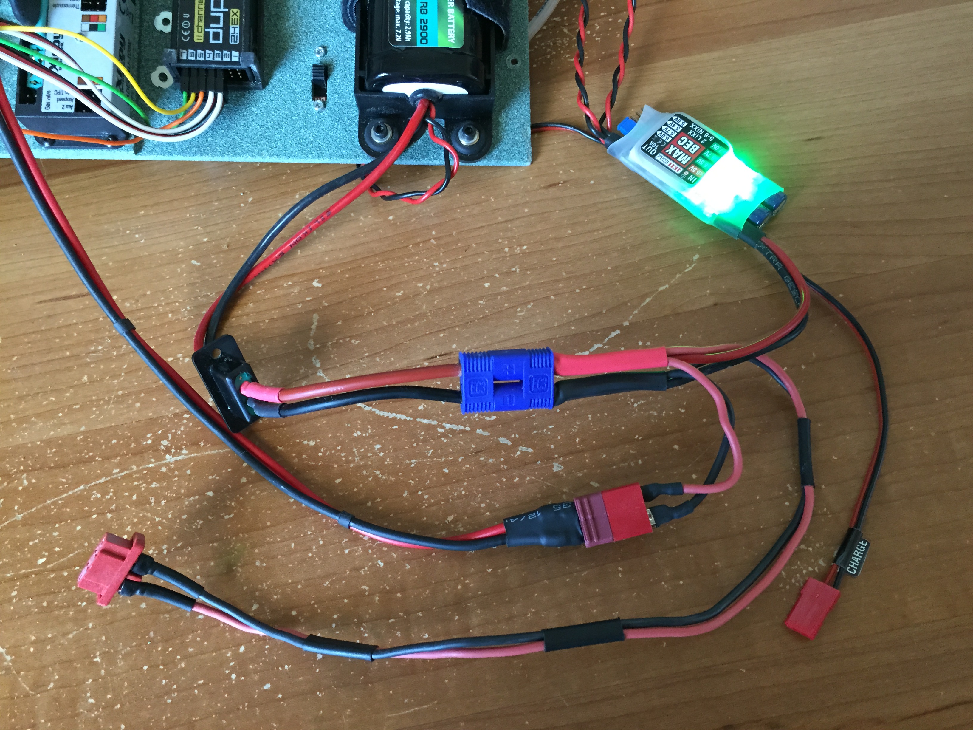

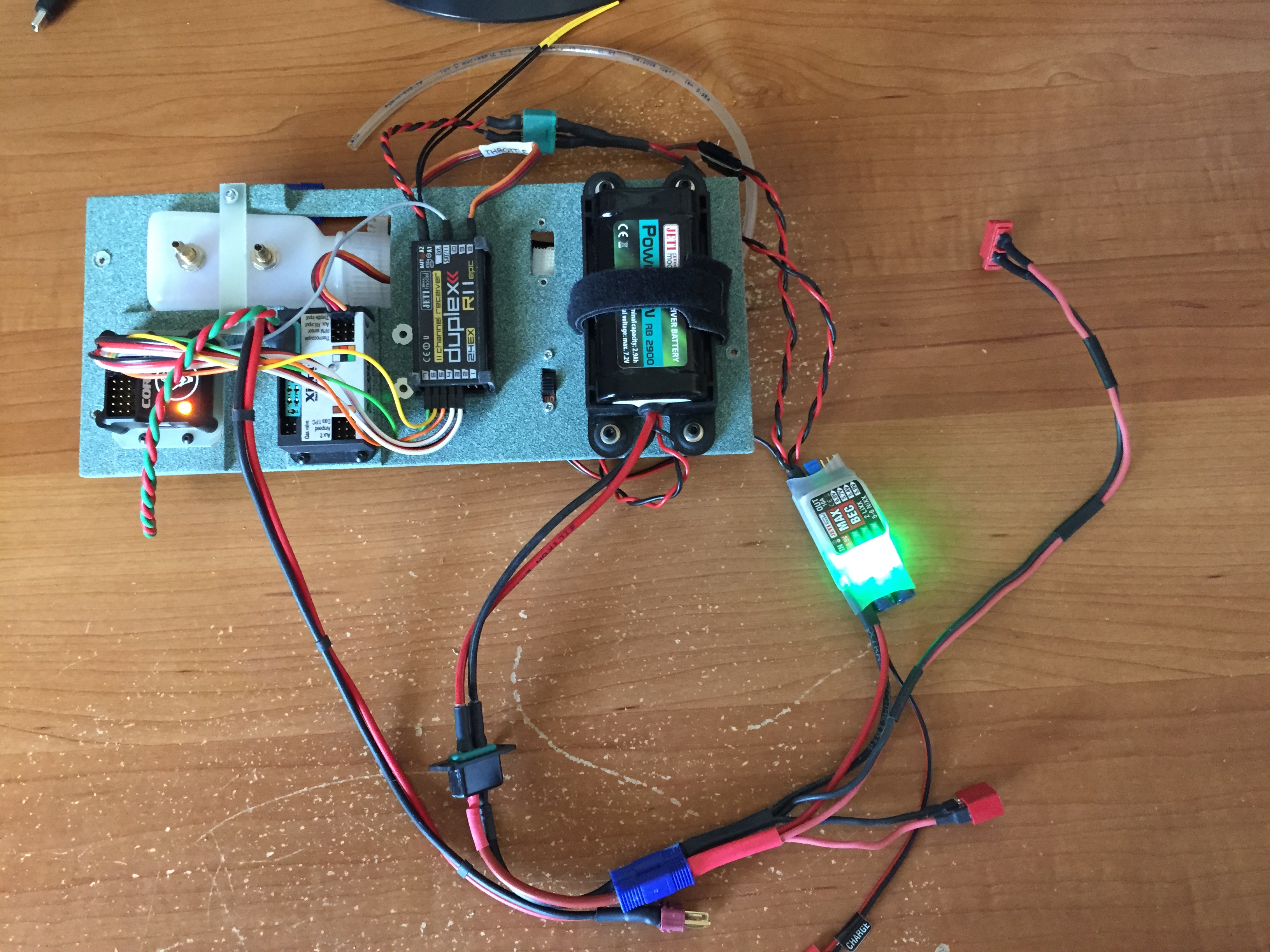

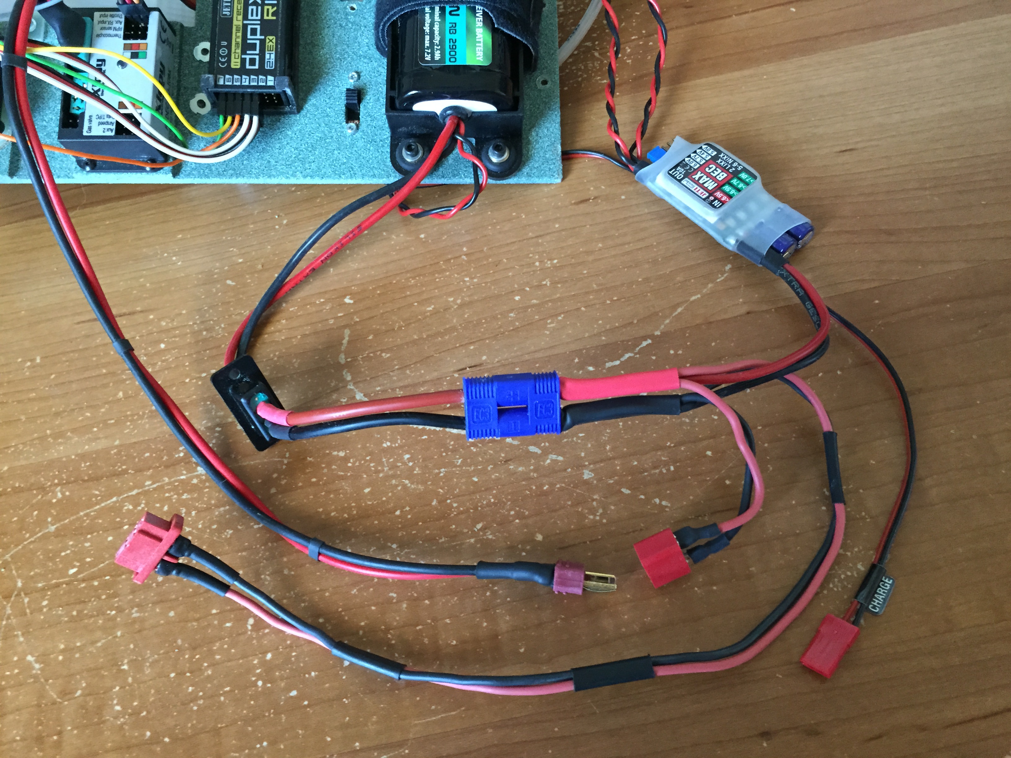

I'm installing the systems on my new model, a Savex L-39, and to keep things simple, I decided to go with just one battery (2900mAh Li-Ion), to power the radio, ECU and e-retracts/ brakes. No air on this one.
Power splits off 3 ways from the battery. One line to a Jeti MAX BEC (5A continuous/ 10A peak) to power the Rx/ servos, and one each going directly from the battery to both the ECU (Xicoy / Wren 44) and Xicoy e-retract/ brake controller.
The BEC also has a safety switch to switch it on/off, which should act as the master power switch for everything. ECU and gear/ brake controller will draw minimal power if Rx is off. Also one main battery disconnect to isolate the battery at the end of the day for storage and to allow for charging.
What is happening is that if either of the Xicoy boxes are connected to the Rx and the battery, something is happening to cause the BEC to turn on, even if the BEC switch is off.
If the BEC is switched off but operating, disconnecting the Rx from the ECU also causes the BEC to switch off.
If I use a separate battery to power the ECU, this does not happen, it is only when I use the 3-way power feed.
Pictures attached.
1. An overall view of the main board.
2. BEC Switched Off. ECU Not Connected - BEC Off
3. BEC Switched Off. ECU Connected - BEC On
I can't work out why this is happening or how to stop it.
Ideas???

Matt,
You were correct. Removing the neutral wire from both the Rx/ ECU and Rx/ Retract controller harnesses fixed the problem. Still don't understand how that affected the BEC switch though.
I've now put a hard switch between the battery and the BEC to isolate it further and set the BEC switch to on and covered it in heat-shrink to keep it on.
Paul
