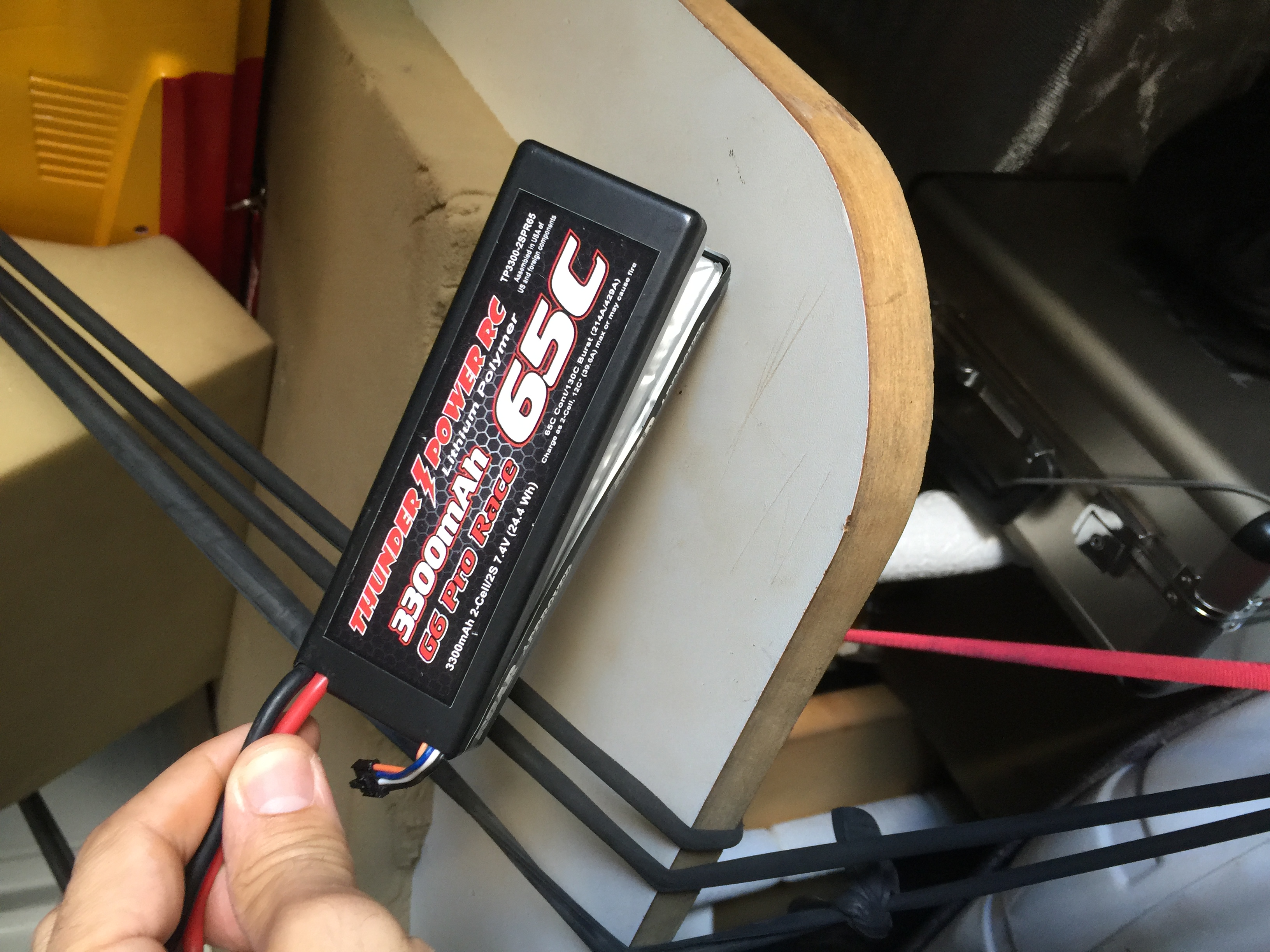

I have no words to say whats hapened about battery.
i have flighpower, thunder power and jetcats lipo batteries to use on rx and fuel pump ( today on rx i'm using lion fromeco and duralite ).
i saw that, today when i was preparing to charge it for flight tomorrow!!!
well, my procedure on charge, storage and use, are owner factory manual since 2005!!
Jose

They can all puff. TP is one of the highest quality IMO, I stopped using any of the "cheap" lipos after I had a fire.

This one above is an brand new ( 50 flights ) TP, bought last year...

Are you leaving them fully charged over night or for a long period of time? Ever go below 3.7?

When you don't use them you have to place the battery in a storage mode : 3.5 V per cell. Or with time they will start puffing . Hobby King or TP or whatever they are almost all the same ....its only the C rating and internal resistance who is important.

I noticed it's a 65c pack, these are known for having issues when left fully charged for long periods of time. Keep in mind they are the biggest fire hazard when sitting fully charged. I would reccomend doing a storage charge after your done flying and not charge them till the morning of flying. This is safer and will make your packs last longer.

more like 3.8-3.9 not 3.5!!!

Not unexpected, looks like TP changed some of the pack chemistry for those cells

A lot of cell makers moved to iron cobalt years ago because they're stable down to 3.2 a cell under load and don't have the negative effects (puff, over heat, pop etc) of magnesium cells have
It wasn't much more expensive and now the cell makers can put them in bigger packs like 10,000 mah and 12,000mah without going to 2p configurations. lighter and smaller form factor... thx to quad copters
Now HK has some of the best packs that are stable under 20 - 30c pulls, don't know why the other pack makers aren't moving to the more stable chemistry other than magnesium is 5,000 a ton and iron cobalt is 50,000 a ton or something close.

There is nothing wrong with using a lipo, you just have to understand the proper care for it and it will last for a very long time...
