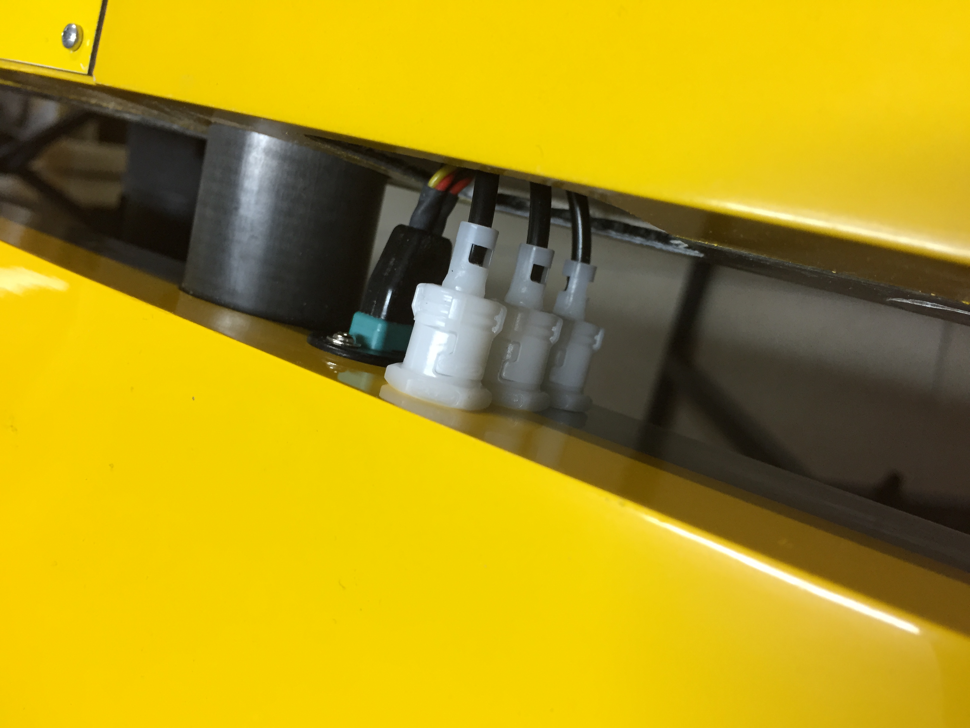

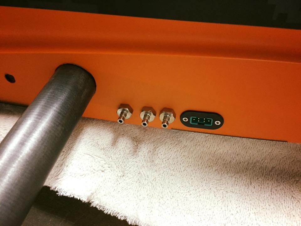

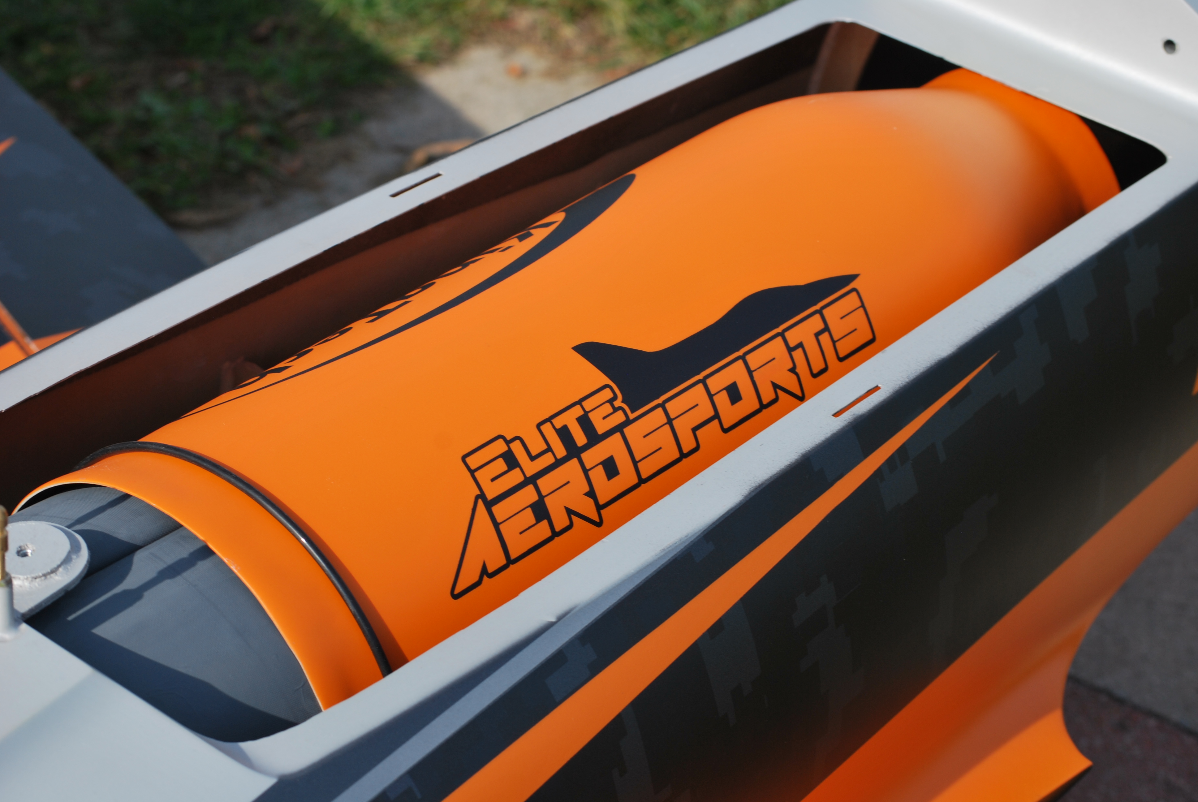

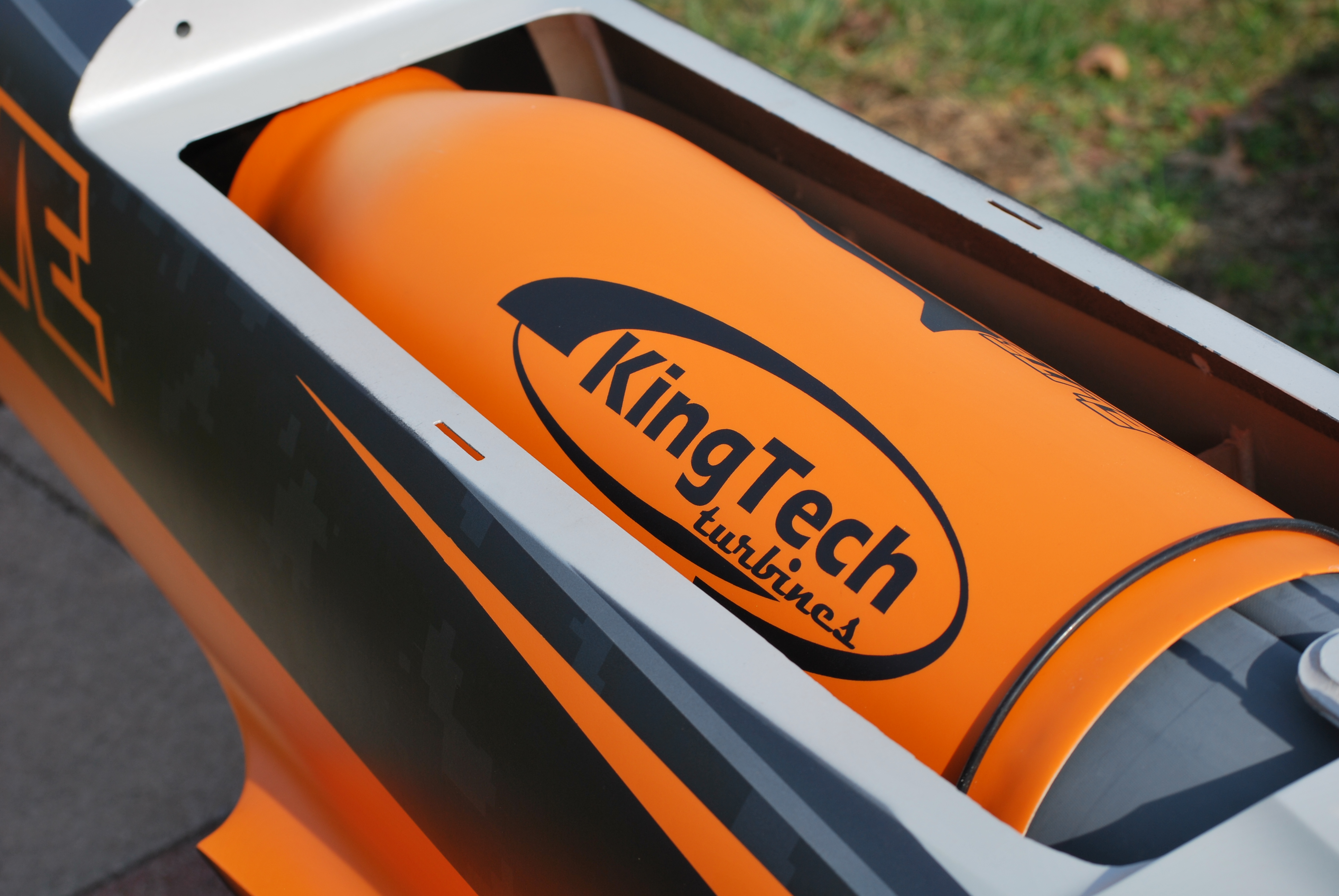

Have made some progress, installation of the tanks and most of the equipment is done. Preliminary balance check has also been completed.
Just need to install the K210, ECU, and Pump and plump up the upper service tray.i
Elite Aerosports provide top notch fittings from JMP and it certainly suits the need for a large jet. Couldn't be happier with how it's turning out.
Also, so far the matte finish has been simple to maintain and hasn't been impacted by handling it like I anticipated.

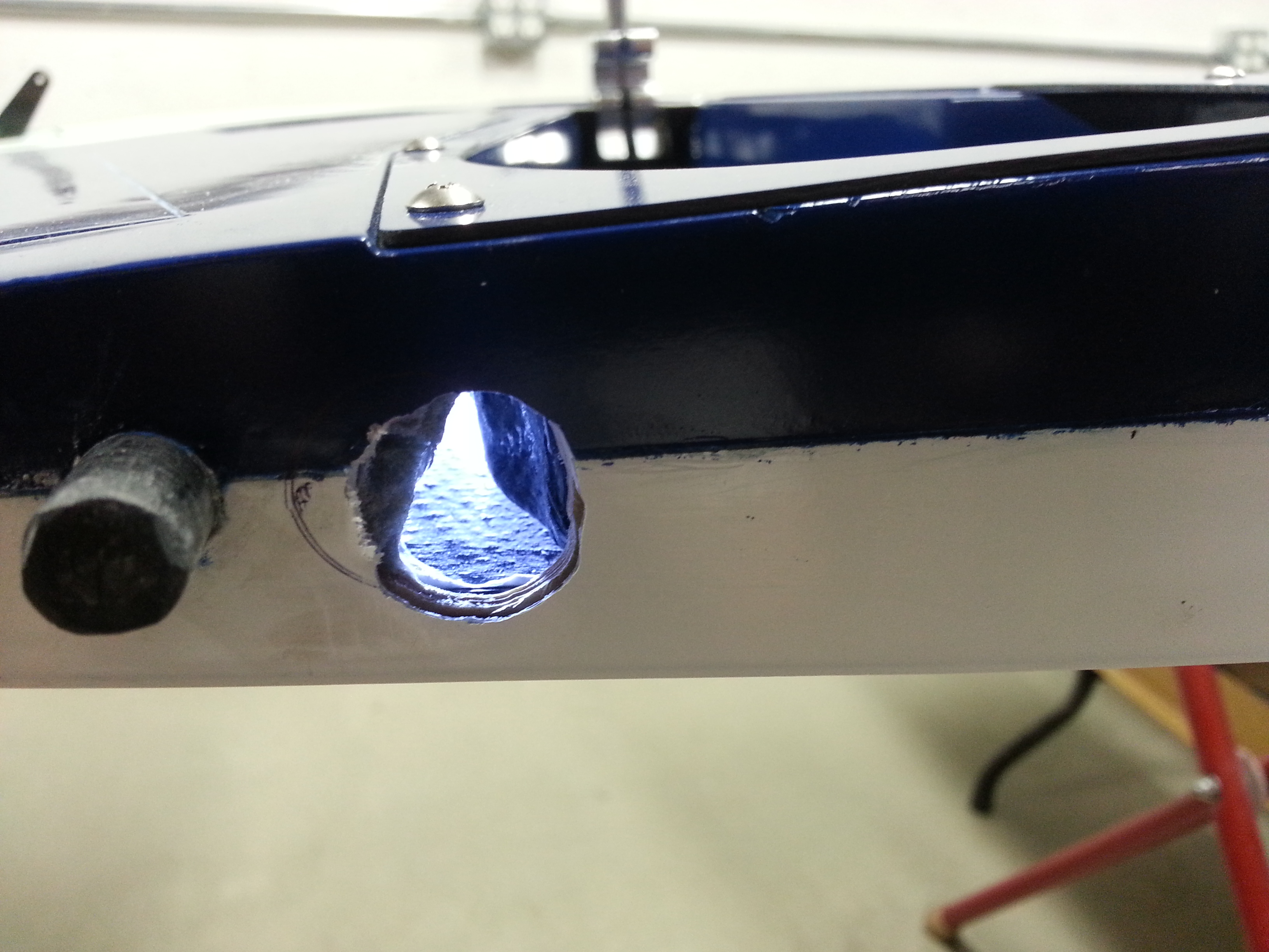

Hey Sean,
Did you make a small hole in the spar to get the air lines & servo leads to exit in front of the wing tube? I saw a similar method in ZivBit's thread. The stock method of exiting by the rear anti-rotation pin works, but a little cramped for using nice fittings or sockets. I have some paint work to do myself this winter and was also thinking of relocating my wing connections like yours.
So any tips or more pics on how you did it would be appreciated.
Thanks...Scott

Scott,
thanks for checking the thread.
you're correct there is no way to get the leads in front of the spar without a hole. I have two. One small hole out in the aileron servo bay and one close to the wing root. The spar is a lamination of ply at that point.
while typically I would avoid drilling through the spar but with the layup of these wings I don't foresee any risk.
it was quite easy to run all the lines out to the aileron bay, then I used a nut on the end of a string to find the path out the root. Then I used this string to pull the leads through.
the connection points are all low to avoid interference with the fuel tanks. I have blocked those up slightly to provide clearance.

Please share where you got the deans and JST mounting brackets for charging.....That is Purrrrrrty!!!!

Sean very clean. I am always tempted but never had the nerve to drill through a spar. Sure makes the routing easier to get in from the front of the spar.
Thanks!
The Dean's mount I got here:
http://www.aztechaeromodels.com/inde...h&search=deans
Note the owner of Aztech recently passed away and while it does look like the family will continue the business it wouldn't hurt to call or email first.
You can also find them here, when in stock:
http://www.dreamworksrc.com/catalog/...-Connector-Set
The JST socket isn't really it's intended use. It's meant for MPX plugs:
http://www.dreamworksrc.com/catalog/...ket-Housing-(4)
If you spread it apart slightly with a flat screwdriver you can push the JST plug through and it won't fall out the bottom. Just makes it easier to find for charging. It's just laying in there loose.
