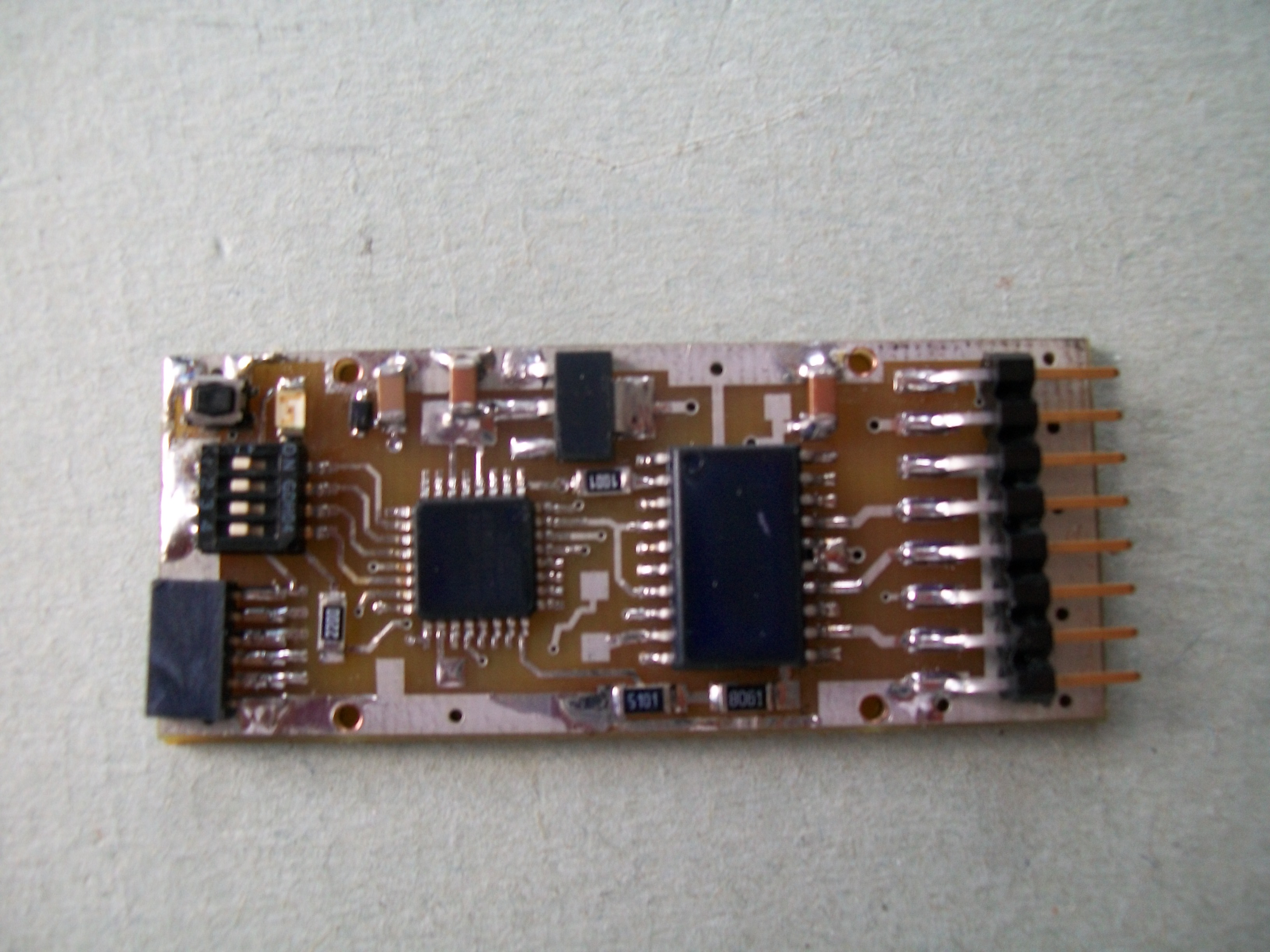

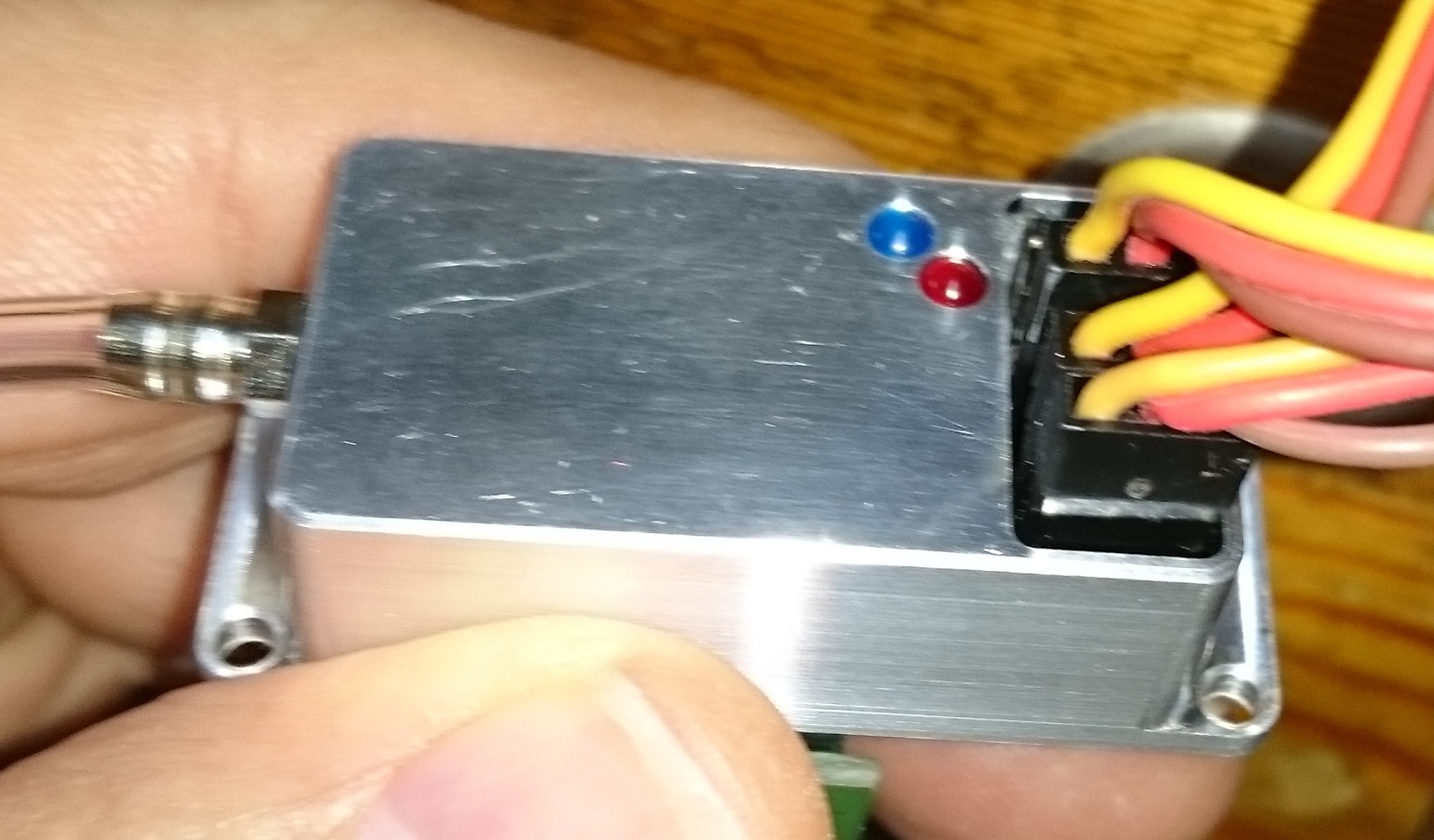

Hello,
I'm finishing the development of a new sequencer/failsafe for air operated retracts, but have a doubt about what is the desired operation after power-up,so I would like to have some feedback of "real life" use.
The device is composed of two sections. One is an air pressure sensor used for to detect an air loss and to extend the gear before running out of air. The current pressure can be transmitted over telemetry to Jeti, Multiplex and Futaba radios. Failsafe pressure can be adjusted from 0 to 10 bar.
The other section is the sequencer. It have 5 outputs (4 if telemetry used) and one input. The outputs can drive air valves or servos, for servo use the endpoints of the 5 outputs are freely adjustable. The sequencer have 5 steps (Gear Up, GearDown and 3 intermediate steps). In each of the 5 steps, the position of the 5 outputs is configurable, as it is the time spend on each step. All programming is done by use the Xicoy data terminal (used in Wren, KT, Jetcentral, JetsMunt and other engines).
All is working fine, software is in last test phase and hardware being manufactured. We plan to launch the product in a couple of weeks, but still I'm not sure ofthe power-up sequence, meaning what the device should do after power up.
In current software,once the power is applied, the device wait 3 seconds to give time to the receiver output to stabilize. After this delay, if the command received is "Gear Up", it does nothing to prevent the gear to collapse if the gear switch on the TX has been inadvertently left in gear up position. Once the command received is "Gear Down", it arms, sets the outputs to "gear down" position and on next transition to "Gear Up" it does the retract sequence as programmed.
This should work fine if the gear is always extended at power-up, that is the usual situation, but in the case that the system is switched-on when the gear is retracted, it looks that could cause issues. If a door is programmed to be in closed position when the gear is down, then this door will keep closed when the system set the outputs to "gear down" position once armed, so this will prevent the strut to extend and possibly causing damage to the door.
To prevent this possibility of damage, I think that a solution could be that at power-up the system set the all the outputs to the doors to OPEN position, allowing the gear to extend if it was retracted, and few seconds later, the doors that should be closed when the gear is extended, will close. This avoid the possibility of door damage, but will cause the doors to cycle at each power-up. Only the doors that should be closed when the gear is down would cycle.
Would this be acceptable? I'm open to suggestions, now it's the time of the "wish list".
Thanks for your feedback,
Gaspar

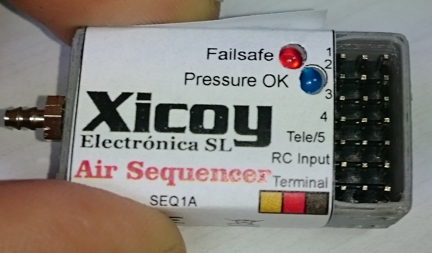

Woow... thanks for all the valuable comments.
@Dave McQueeney and @Alkaline: I think that current setup would be usable for canopy. The pressure failsafe can be disabled, no telemetry need, so you would have 5 programmable outputs, and 5 sequence steps. You can unlock, open the canopy, lock again... plus a extra 2 outputs and 2 steps to do other things like to move the arm of the pilot, etc.
@George: It would be possible to define a "power up" position, but so that this power-up position be compatible in all possibilities, the only safe position is with all doors open. You would not define a door closed at power-up when this door can interfere with the gear.
@Thud_Driver: Very nice and well thought your device. I have taken in to consideration to have the unit to remember what was the last position of the gear, but on plane that the mains are on the wings, often the position is changed manually by operator during assembly / disassembly, so it is not warranted that what is remembered is what is currently at power up, so I prefer a solution that is not dependent of what was done last flying session.
About the "do nothing" option. Could be the best one, but still are possible issues. First one is the definition of "do nothing". For servo actuated doors and Xicoy valves, OK, the sequencer does not output any signal so servos keep "soft" and valves keep both sides closed. Nothing moves. But for mechanical valves and some electronic valves that are open in either position even without valid signal, this could cause a odd power-up. Also there are planes that need air pressure to lock the gears.
After your comments, it seems to me that the best setup would be to add a programmable "power up" option:
Option 1: If command is "gear-up" do nothing. Once command is selected to gear down or if the power-up is already executed with correct "gear down" selection, then open all the doors, pressurize the gears and then close the doors that should be closed with "gear down". This mean that each time the power is switched on and "gear down" is selected, the doors that are closed will cycle open and close
Option2: Do nothing until the gear switch is cycled from "Gear Down" to "Gear-Up" and back to "Gear Down". Then perform the "option 1", pressurizing the retracts, open all doors, close the ones that should be closed.
Option3: Immediately execute the retract sequence as defined by the switch.
Option4: Open to suggestions...!
Gaspar

The time spent on each of intermediate states is defined in 0,1s increments.
On each of these states you define the output position of the 5 outputs. You can have, for example, one output closed in first step, opened in second step, closed in 3th step, opened in 4th step and closed in 5th step. All outputs are independent of the others and nothing is preset, it is not defined that the gear output should be open in gear down and closed on gear up, you decide. You can use diferent valves for the nose to the mains and have the nose extending at different time than mains.
The output commands for "open" and "closed" are programmable independently for each output, so you can use servos for the doors and adjust electronically the door endpoints.
Hope this explain how the sequencer works.
Gaspar
