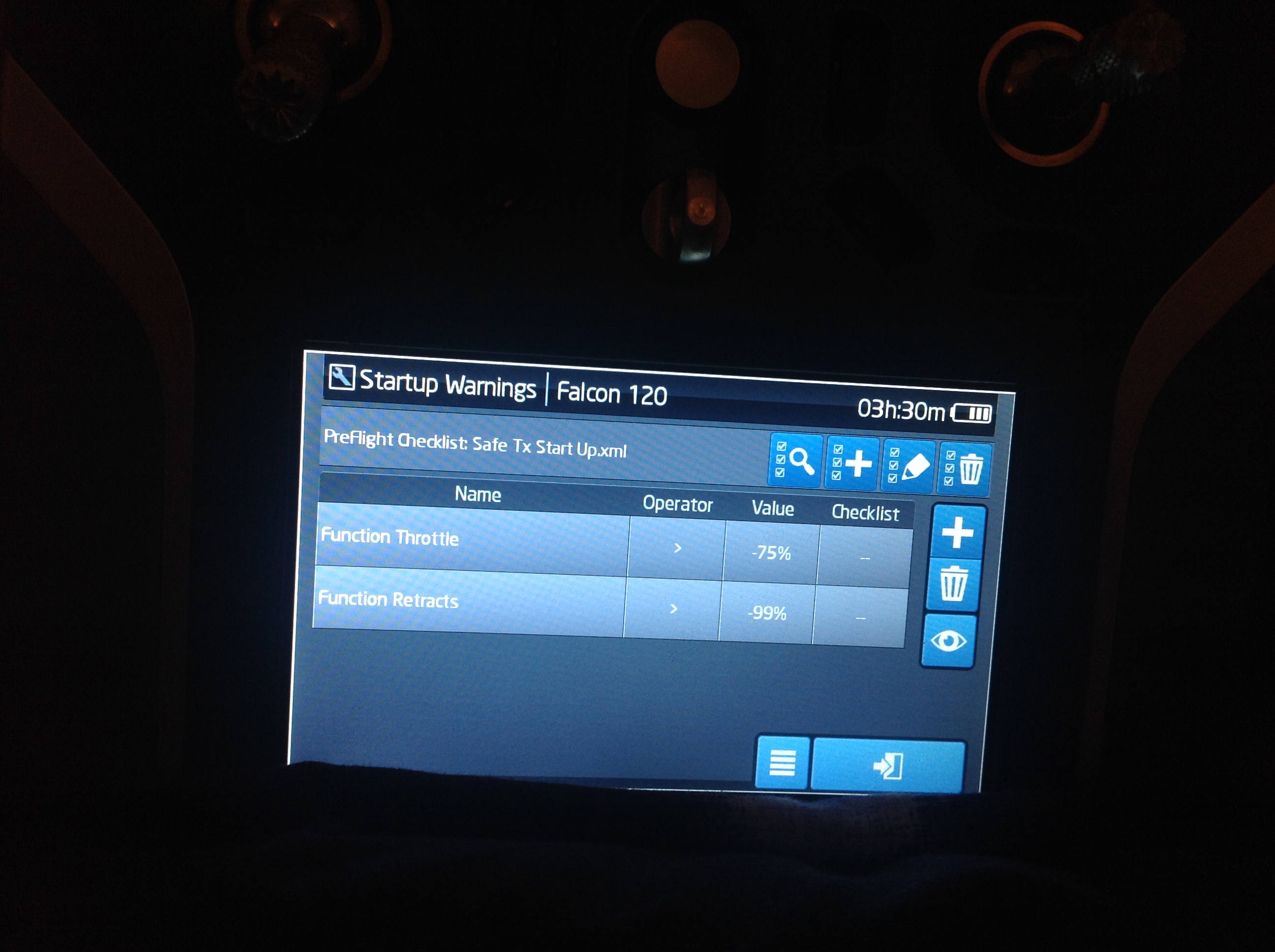

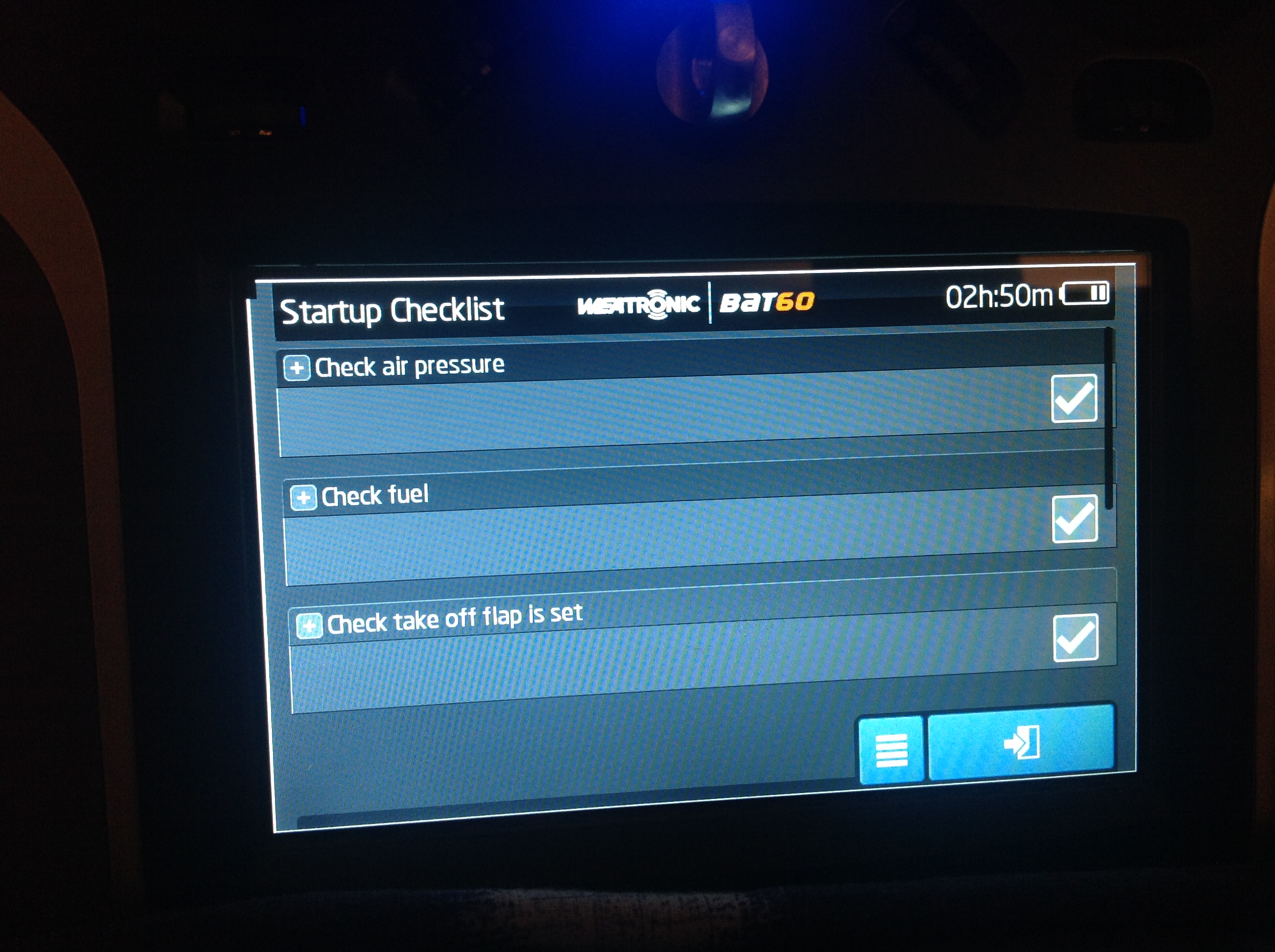

Have been trying out the start up warnings and checklist these are not final just learning how to...
Also cool is I can plug in iphone/iPad to charge once Bat 60 is booted up! Handy if at field and your coms device's are running low etc
Alan

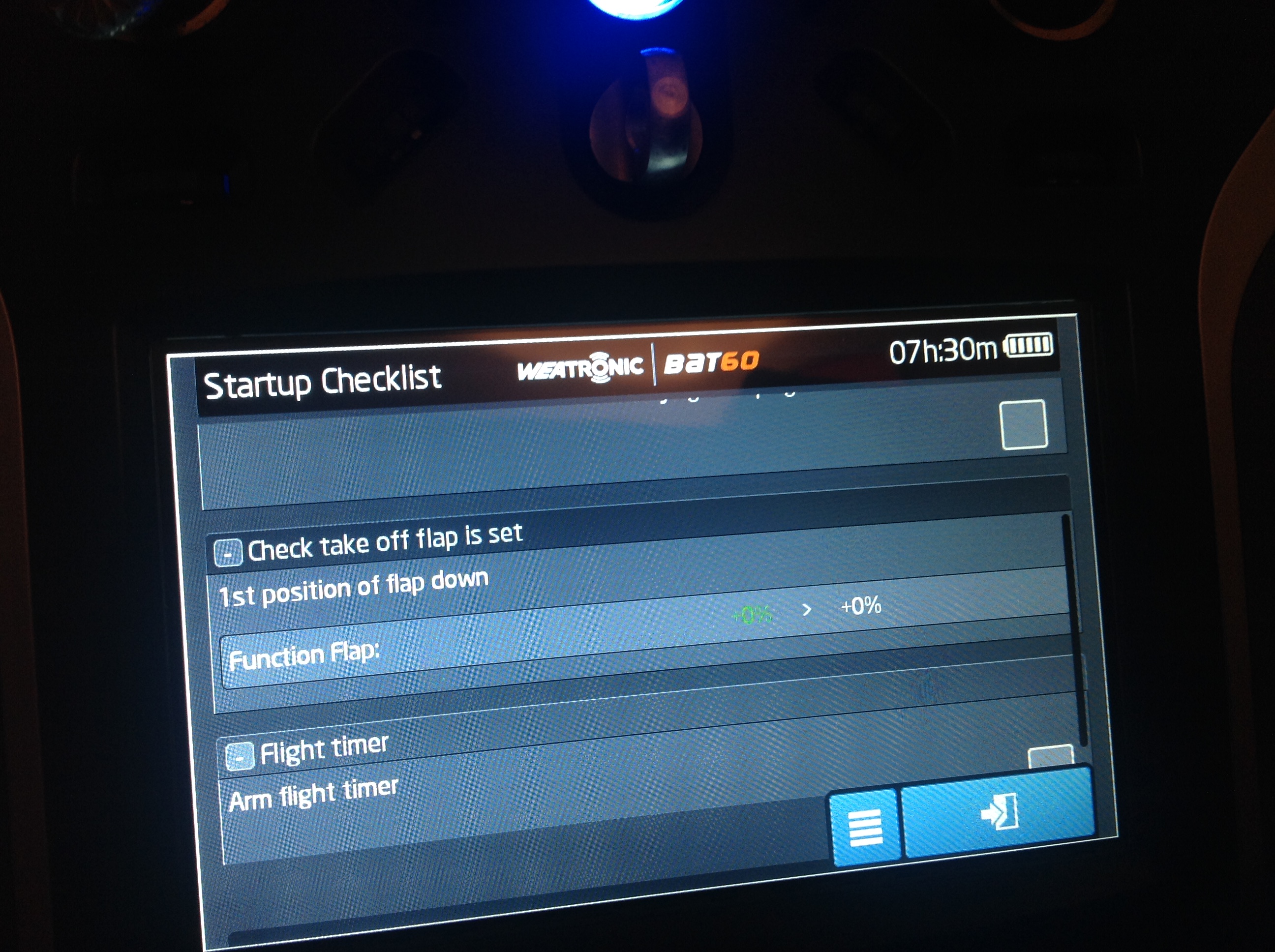

Alan, for the "check takeoff flaps is set" you can assign a function value:
If the flap position is not set, RF link will not go live.
This is one of the auto sensing items, just like on the latest Boeing ECL system.
The auto sensing parameters I use on the A-10 are:
. Engine switch OFF
. Flap takeoff position
. Gear down
. Brakes ON
. Canopy open ( to access some switch )
Also note that this check list is model dependent. So the auto sensing values can be customized for each case...

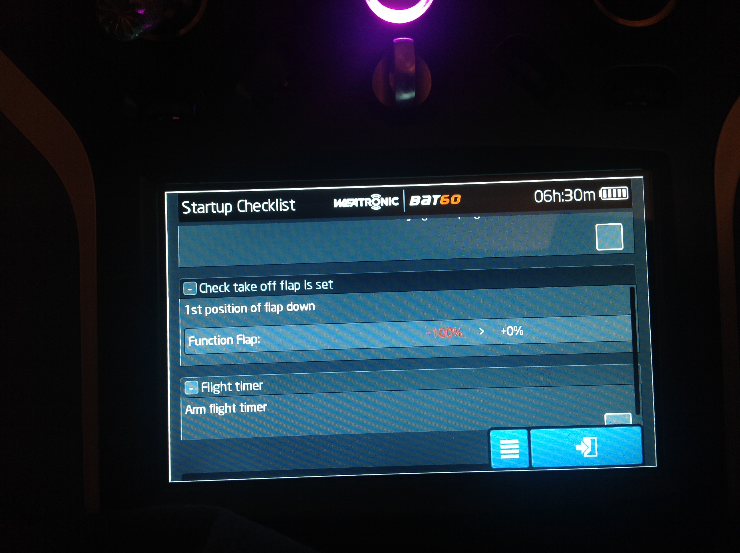

From: Leicester, UNITED KINGDOM
Oli i think i have it programmed correctly as the flaps now come up with alarm when flaps are either fully up or in landing position (red) and when flaps are moved to take off alarm cancels etc (green)
Alan
Alan
That looks correct, Alan.
