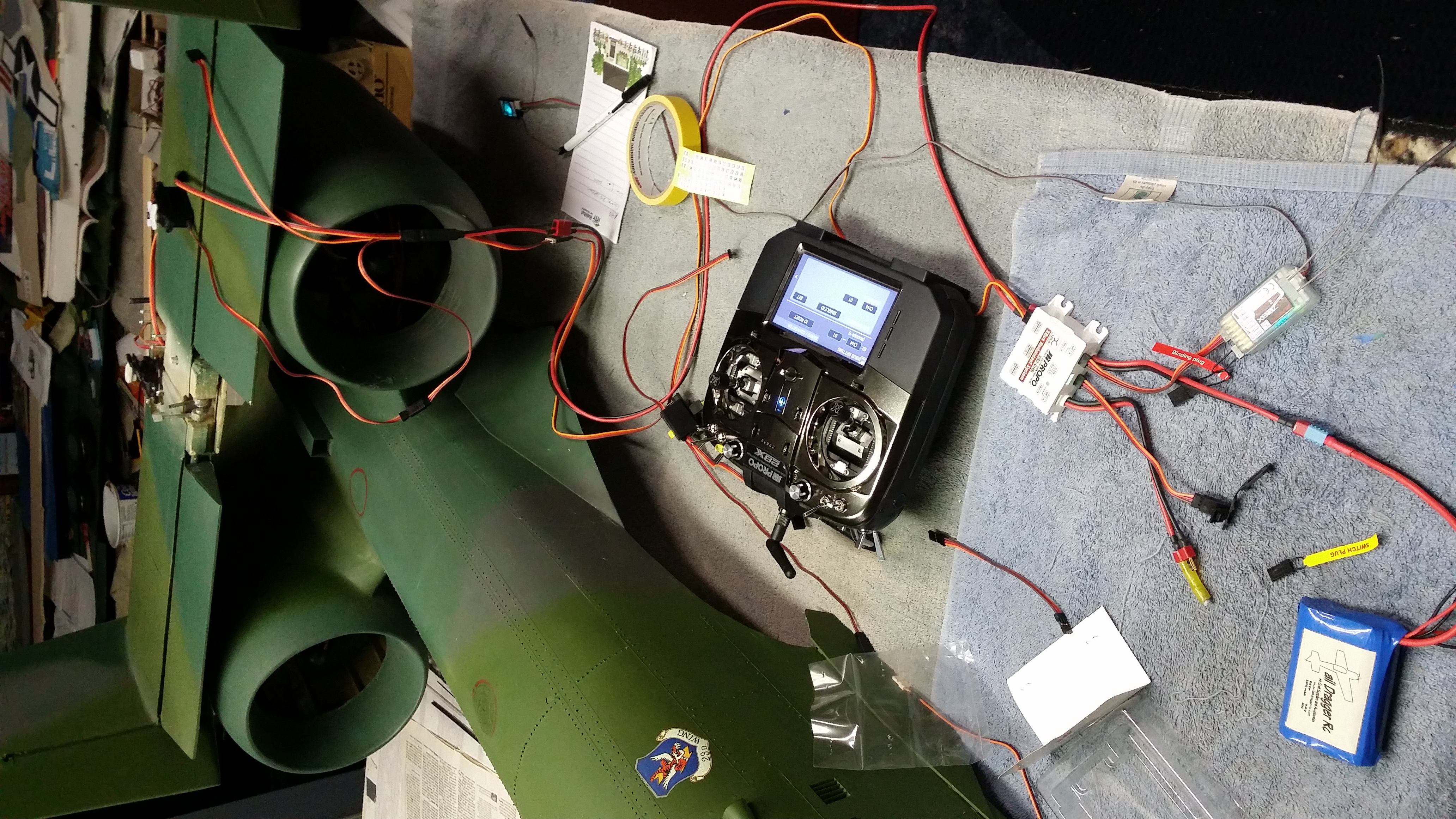

My A10 is currently going to DMSS with JR 28X. I flew the radio at Nall last year with my dle 111 Sbach342 all xbus servos and Infinity rx. Also my Ziroli P51 and several other planes. Sold all my Spectrum equipment a year ago. The DMSS and xbus system allows everything from the simplest to most elaborate power and data set up. A 4 foot extension to 500 oz torque servos needs the voltage. I'm using the B2 hub with heavy duty deans lead

There is a function on the chip that would allow the chip to boost its input voltage to ride out brownouts much better.
The vendor explicitly states that if this function is not used the relevant output pin MUST be grounded and not left "floating" ie unconnected.
Well floating it is on spek's where it acts as a source of poor power regulation and a random input of RF and EMI to the RF subsystem.
Ironically some of the clones do have this properly grounded.
Its not my opinion but that of the chips vendor technical department application engineers as confirmed to me when I raised a query about this.
You should check with Spek if they have since corrected this when I pointed it out some 5 years ago.
Its a ridiculously easy fix to do.
As the mfr will tell you the fail mechanism is unpredictable but will certainly cause the RF chip to brown out randomly, depending on the environment it finds itself.
But I suspect it also degrades the RF link in some way regardless of power conditions.
Its perfectly OK for a foamy I would think...

The ground is the traces connected to the neg battery side or brown/black lead of the servos.
The chip has a feature called PMU. Look in below doc and look at description of pin 37.
On my units the pin 36 was connected to GND as dictated by the datasheet.
So it could just be a matter of soldering the 2 pins together....
http://www.cypress.com/documentation...ical_documents
In addition, the CYRF6936 IC has a Power Management Unit
(PMU), which enables direct connection of the device to any
battery voltage in the range 1.8 V to 3.6 V. The PMU conditions
the battery voltage to provide the supply voltages required by the
device, and may supply external devices.
