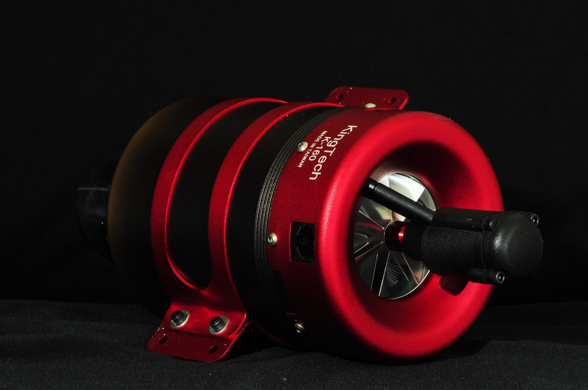

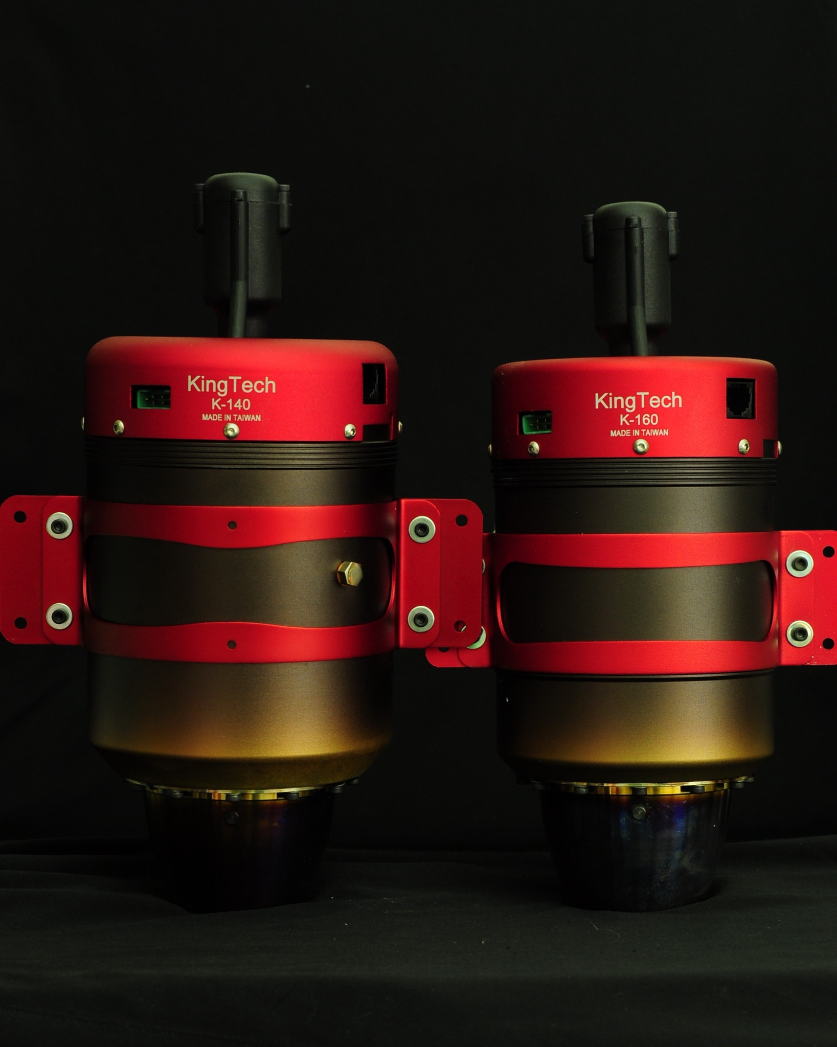

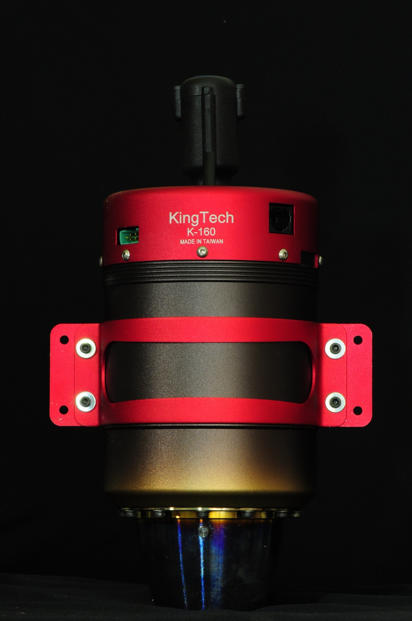

As some of your have already heard....., here's the latest specs:
Specifications:
Diameter: 103mm, 4.06 in
Length: 260 mm, 10.24 in
Weight: 1460 g
Maximum RPM: 130000
Thrust: 16 KG @ 15° C
EGT: 700°C max
Fuel consumption: 490 g / min
Fuel: Diesel, Jet A1, Kerosene
Lubrication: 5%
Maintenance cycle: 25 hr USD300
This engine tests very favorably by Colin Straus of RC Jet International and should be featuring soon, please get a copy.
"....... The K-160G is yet another very impressive turbine from KingTech, with its compact size and weight........"
The 160 will soon become available in February!

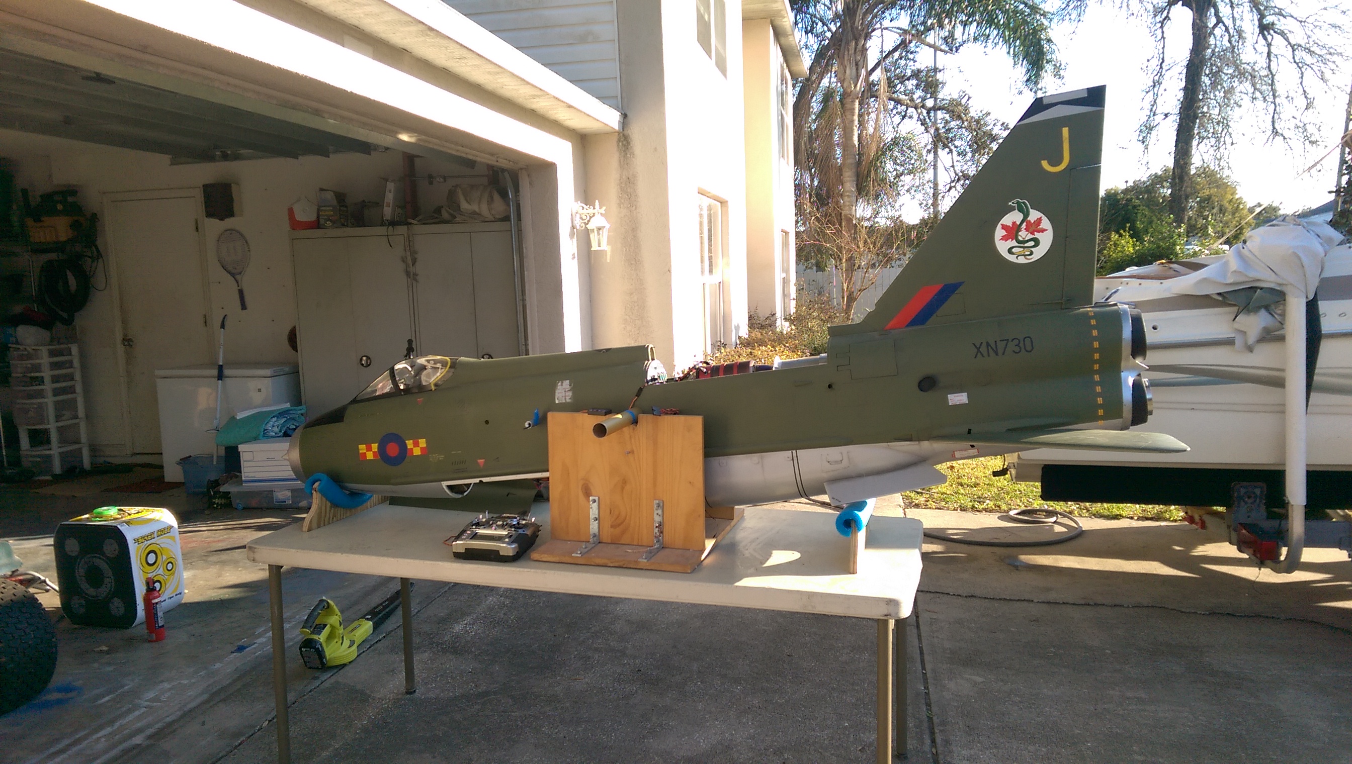

Ran the twin K160s today in Barry's plane and it was clear I need help holding the plane lol. Could not go full power it had to much push.
Always nice when you simply plug it all in and it works without messing with it.
