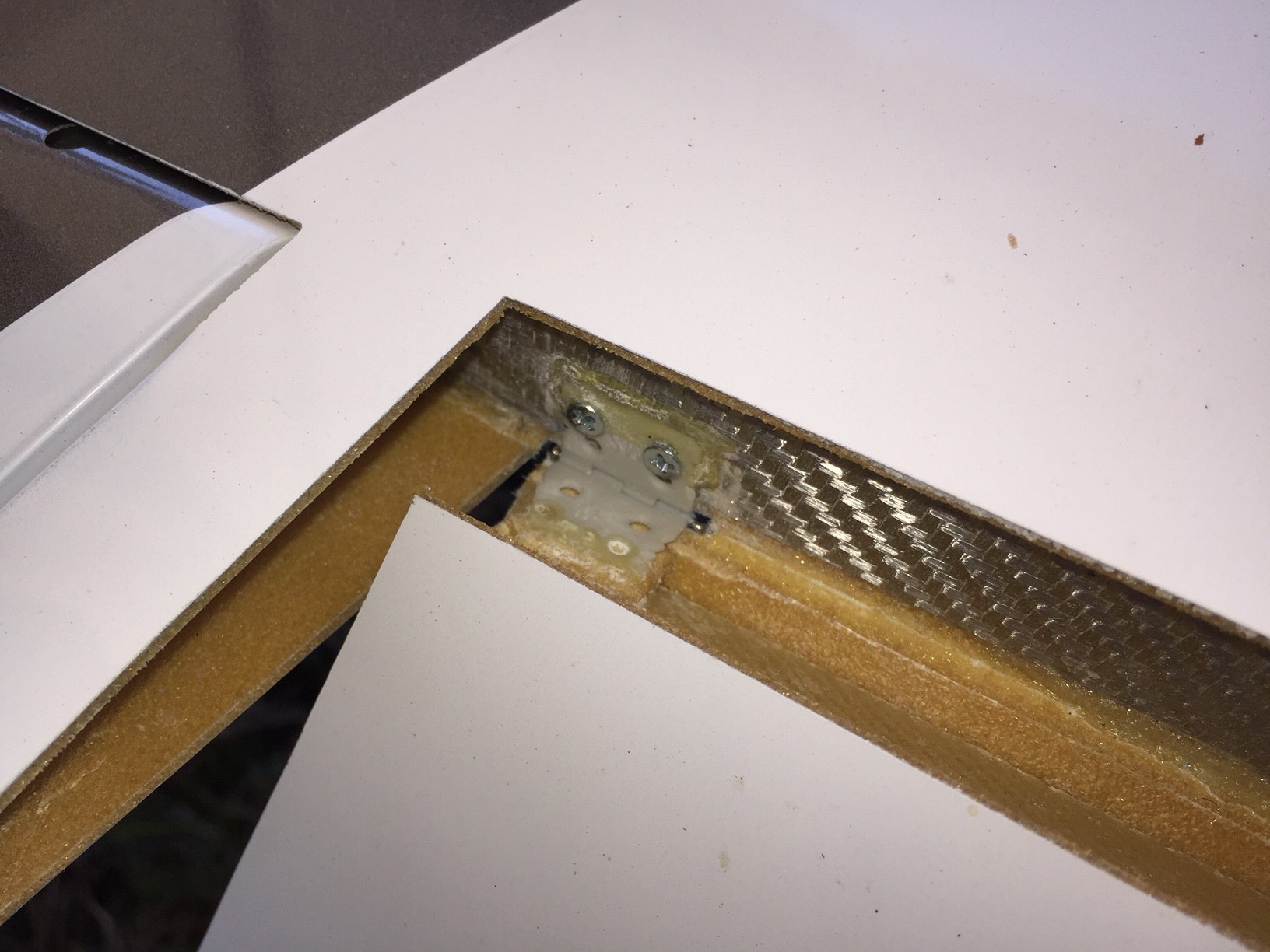

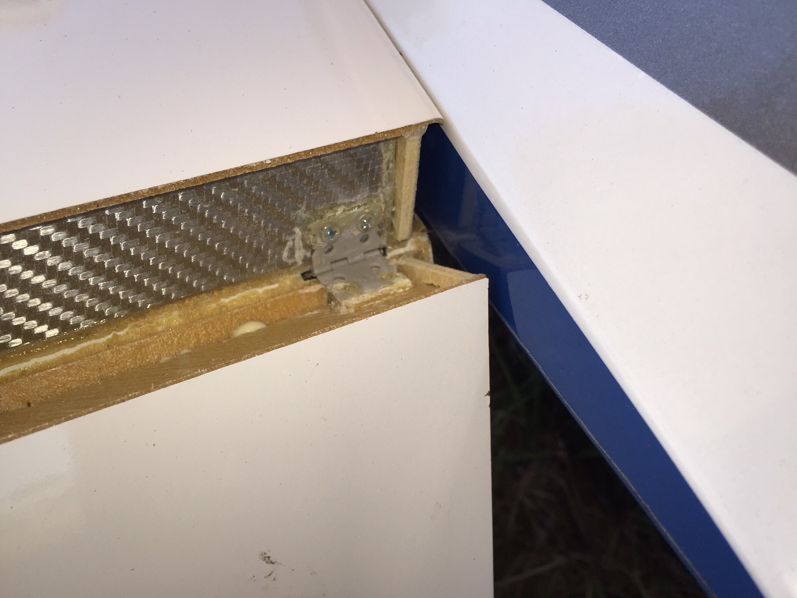

Here's a nice little trick Krill does on the Avanti flap which uses a 'live' hinge. It's simple but very effective!
I'm trying to post from my phone but the pics show upside down, but if click on the pic, it expands right-side up, so not sure how it is displaying on a PC. I'll edit the post when I'm at a PC if it's not correct.
