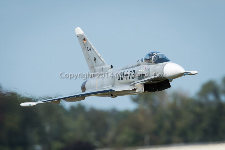

This is maybe a daft question but how close to scale is the CARF Eurosport and can it be used as a basis for a reasonable facsimile of a Typhoon?

I have the carf and the old fiber classics and for some reason I think the fiber classics looks more scale specially the wings the have little curve air foil to the leading edge just like the full scale jet

Yes, the CARF Eurosport does not have the curved wings of the full scale Typhoon, but that is a minor imperfection. I built a model of Eurofighter Development Aircraft 5 and entered it into a Scalemaster's Qualifier in Mesa AZ a few years back, and got a 95 static score out of a 100 possible points. The model had a very good static score, but I didn't do too well in the flying area.......not a problem with the aircraft, but I had a problem with my flying manuvers. Got a couple out of sequence.......my fault, not the airplane. I flew it for several years, and really enjoyed it. I've never found another airplane easier to fly and to land than the Euro. Currently, I'm building a new one that I plan to compete next year with all electric gear, doors, and speed brake. I think the CARF Eurosport is a good base to build a competitive machine, especially since there are no others out there that are more scale. It does take work to make the necessary mods to make the a/c competitive, and you may lose a few points here and there, but it flies so well, I believe you could make that loss up with the flying portion.
I really like the CARF Euro and plan on having one in my fleet from now on since it is a really nice airplane. It is a big airplane and draggy, so it needs a minimum of a 120, and more if you want to hang stores on it. The one I entered in Mesa had a JC P120 with tanks and missles and was pretty soft on verticals. I replaced the 120 with a 160 and it was better, but a 180 would wake it up for sure.

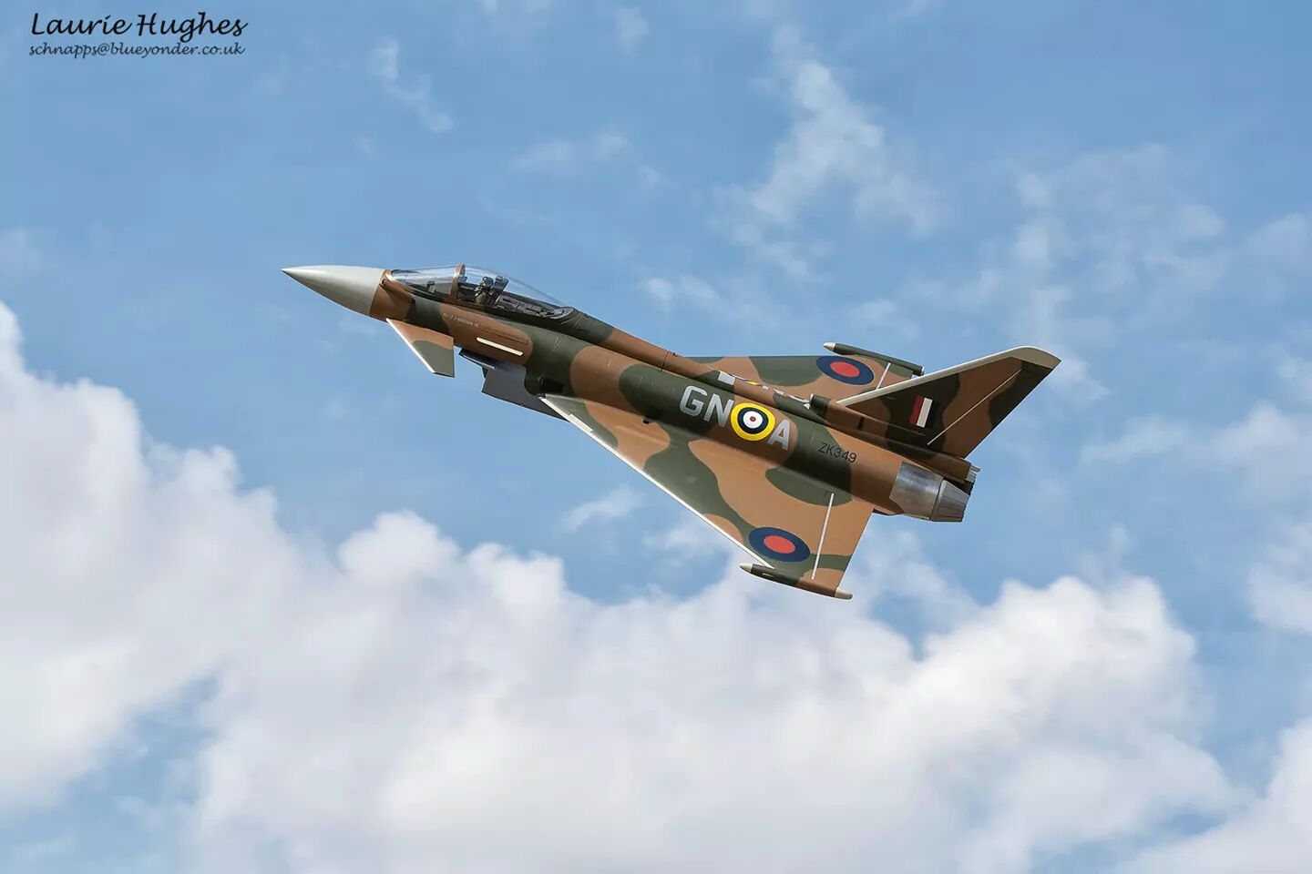

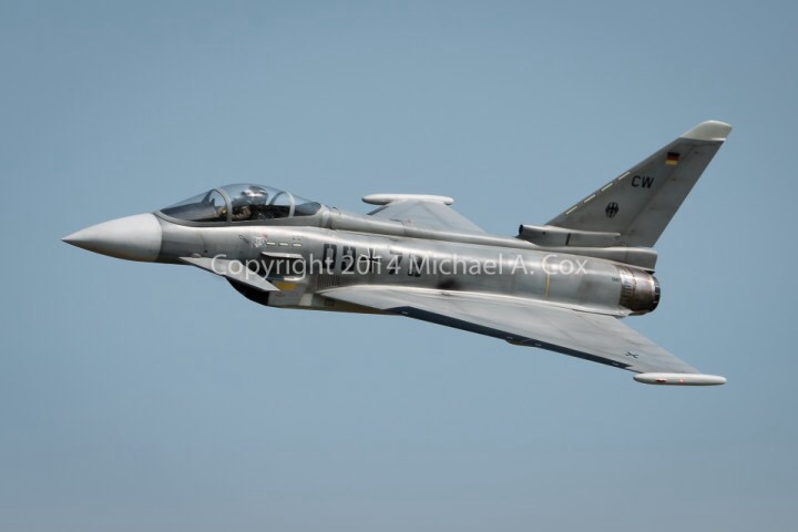

It depends what level of scale you want, it is never going to be better than stand off scale but it makes more than just a reasonable facsimile of a Typhoon. One photo below is the real thing, one is my Eurosport, apart from the leading edge slats I think they are hard to tell apart unless you did some close static judging. With a scale colour scheme no-one will have the slightest doubt that it is a Typhoon.
