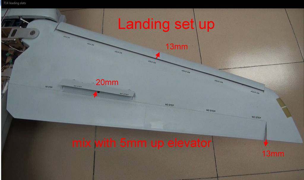

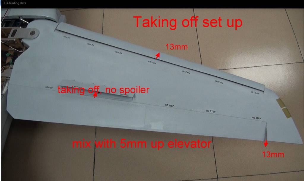

Anyone with experience with this pane can give me advice on control throws for the stabs, Slats, Speedbrakes, Airbrakes etc.
Ive seen on FEJ Website they have takeoff settings for slats, flaps and Airbrake for takeoff, and also for landing. Have these settings been working??
Also are you dialing in Stab correction for wing sweep, Delta flying??
Are you using only stabs for tailerons or also using airbrakes for turns, IE right turn Stab deflection and Left airbrake out? are they modulated for more stick movement more airbrake deflection??

I have posted this question one week ago but no one don't give any answers to me.Maybe It's just two of us still flying this jet in the world.
I have a few informations from searching in old threads.
Do you know CG position for this jet?
