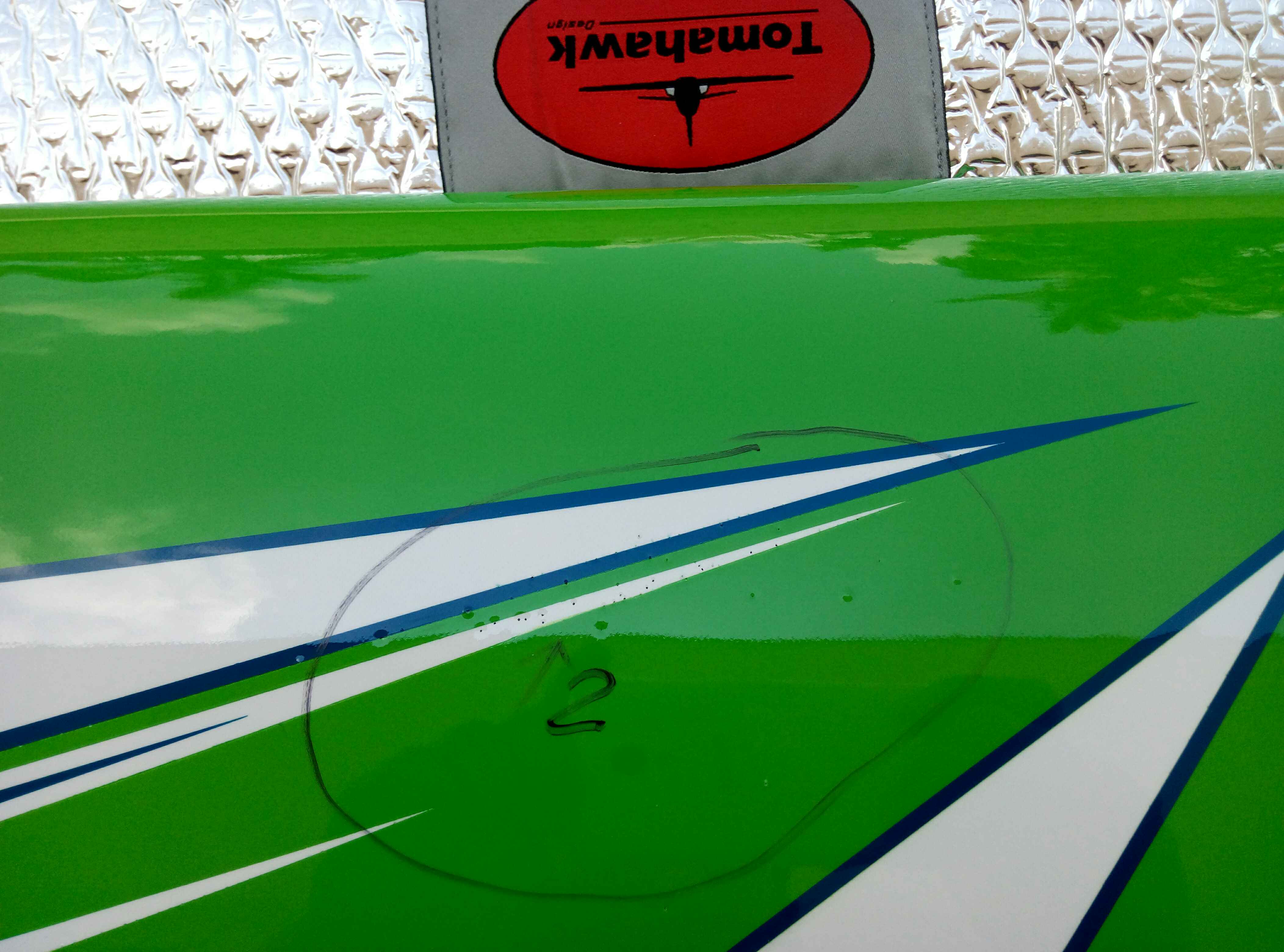

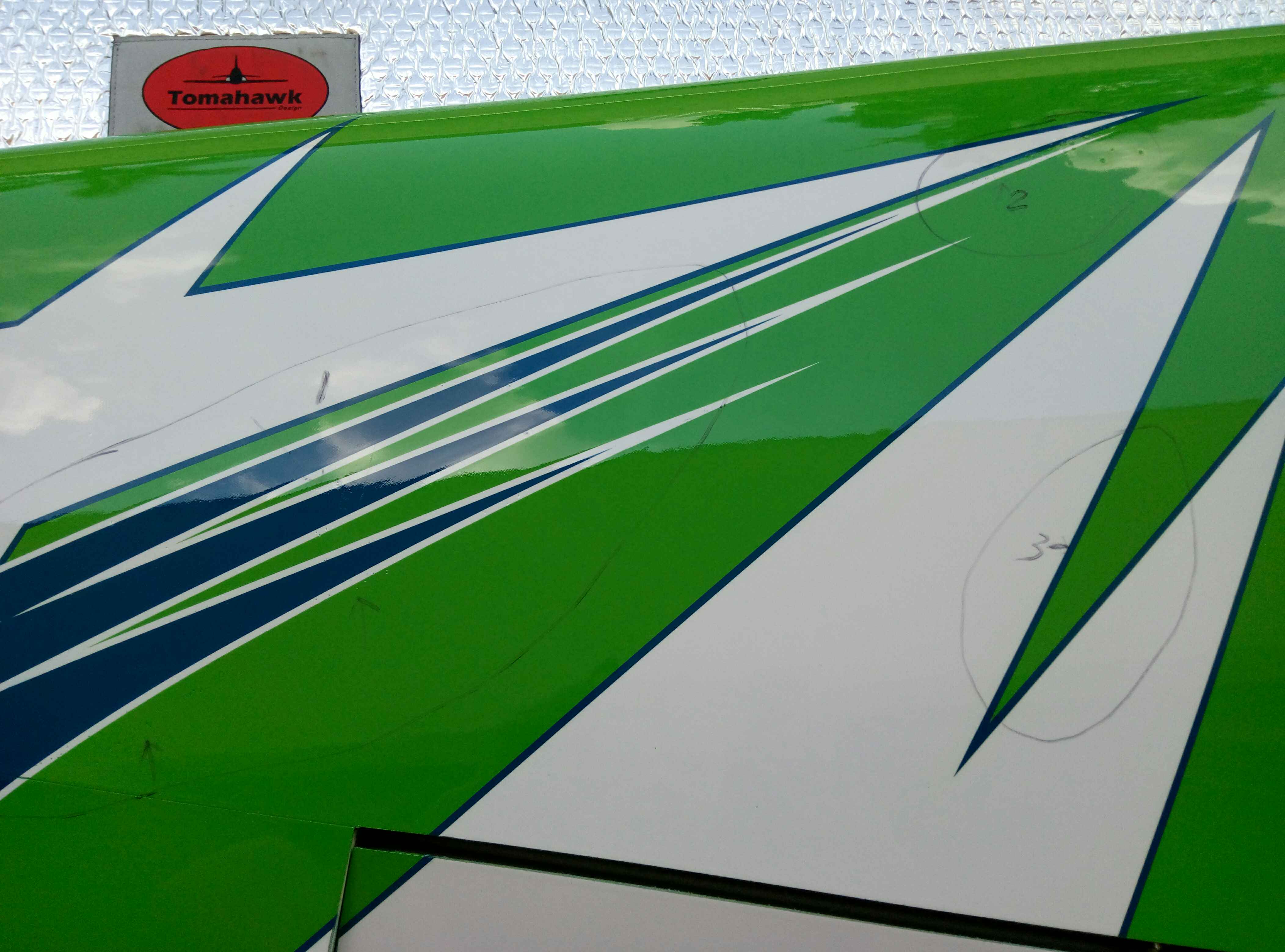

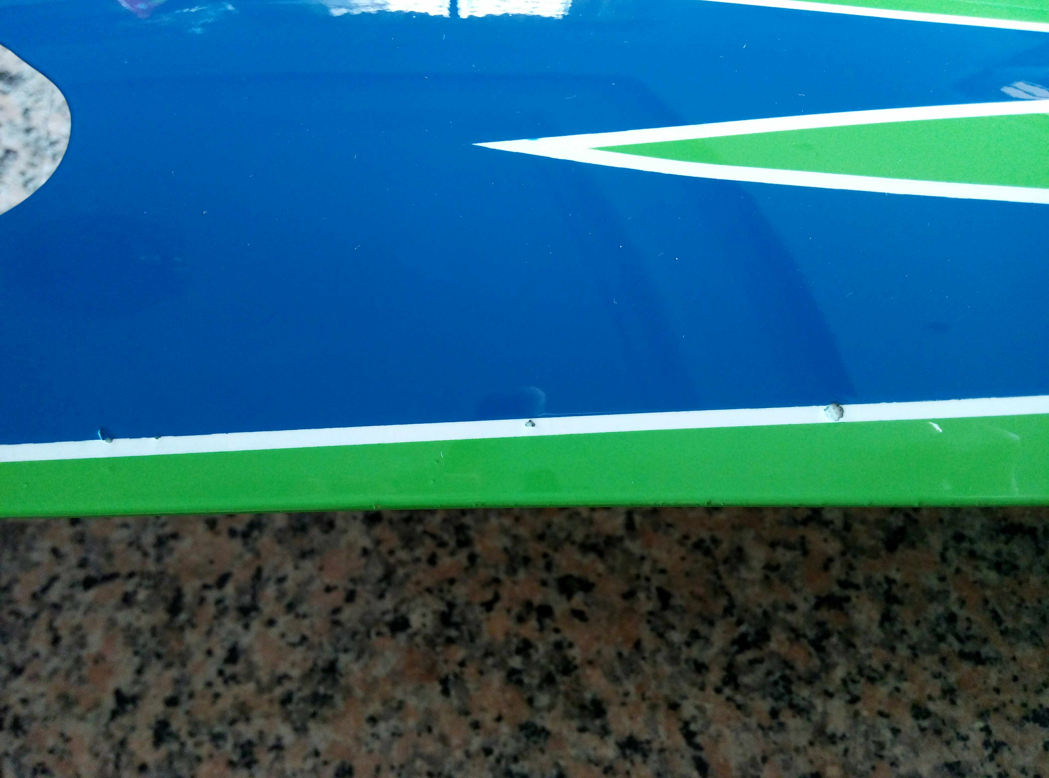

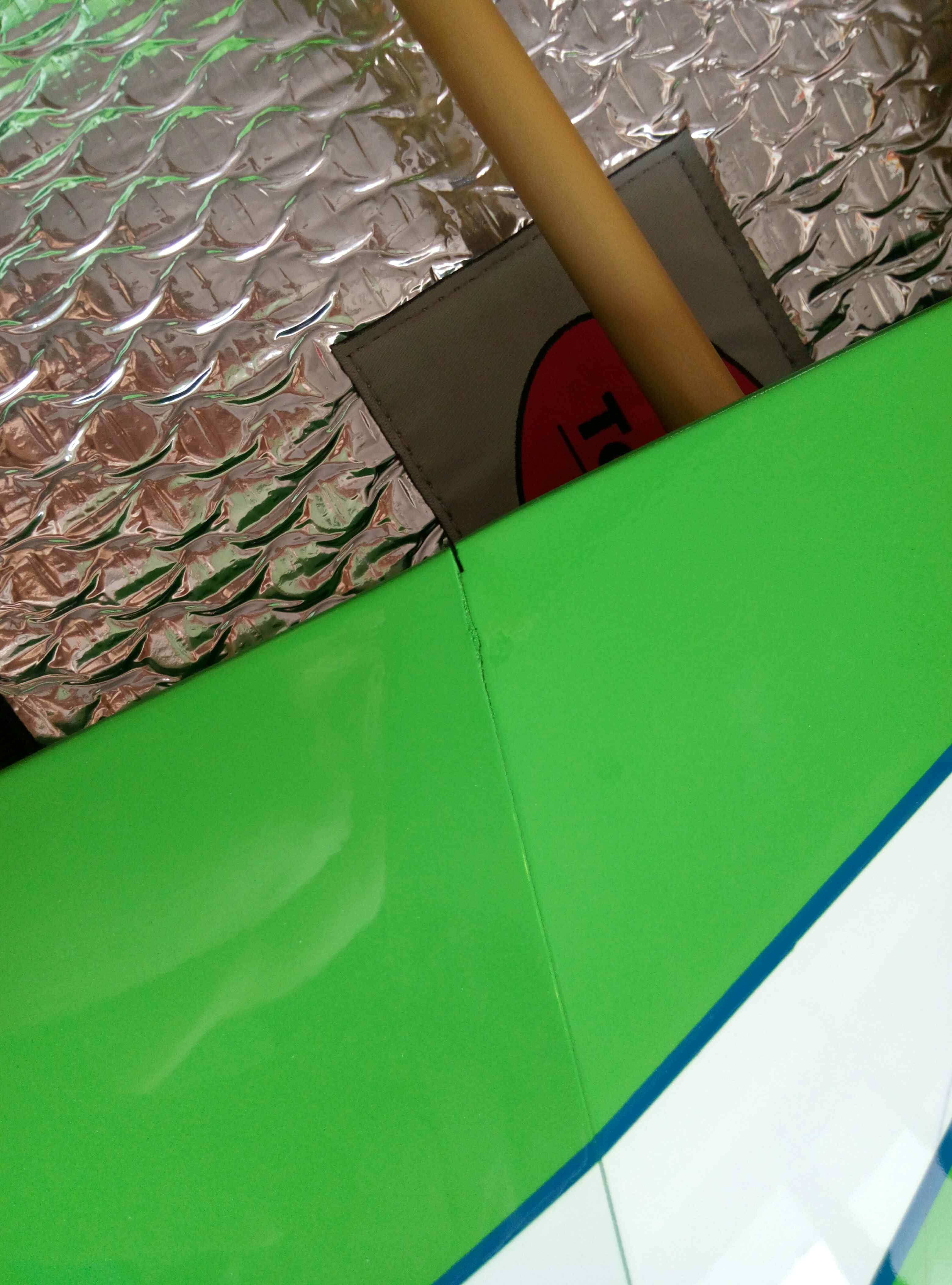

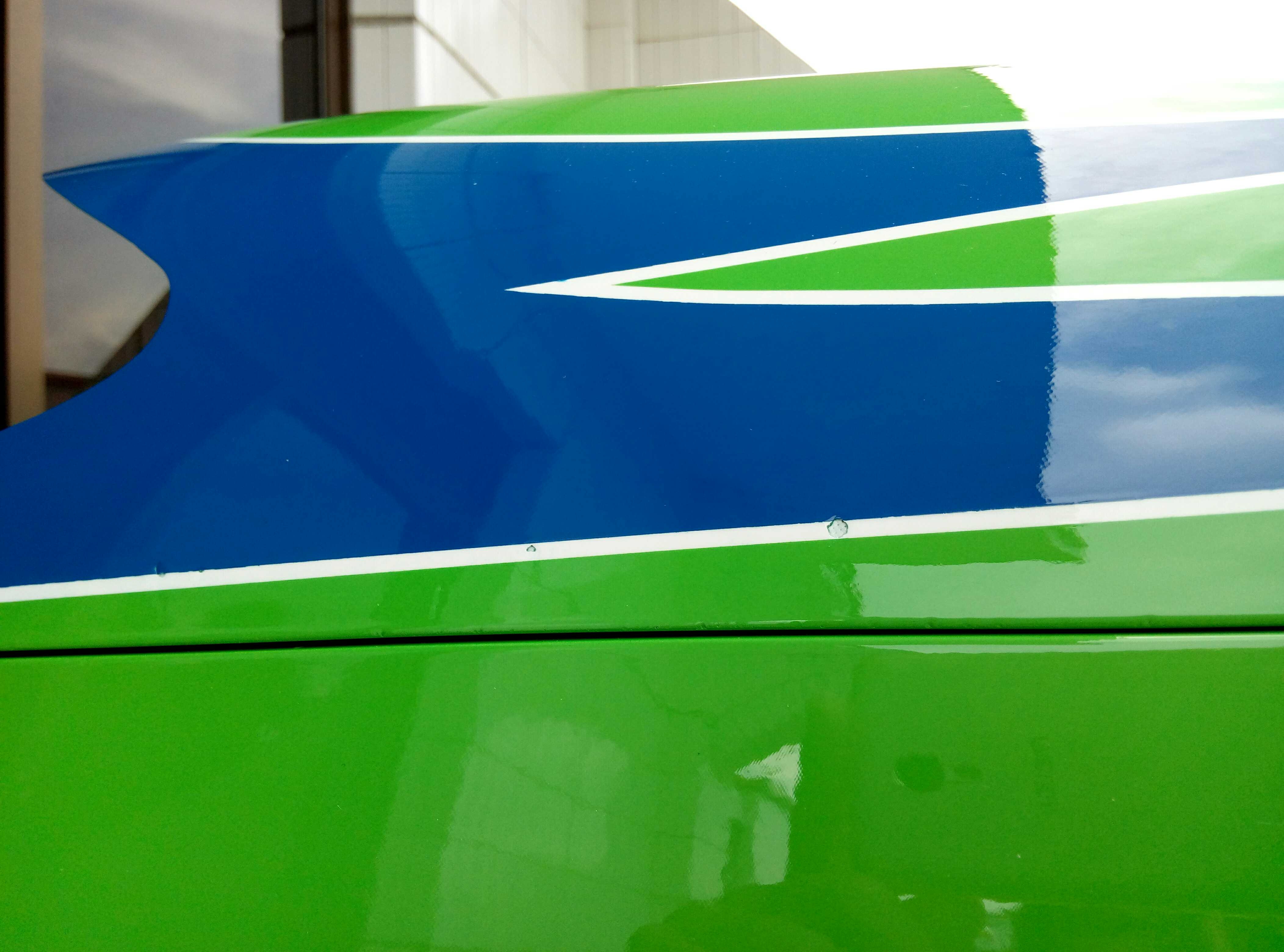

Hi ,everybody ,
The following pictures is my 2.5m Futura of Tomahawk , Left wing , right elevator , canopy frame all has small holes , Left wing is most serious. Such products can be shipped to customers ! Is it a bad intention to deceived the consumer of other countries or his quality is so poor ?

The plane in the pictures was painted out of the mold. Unless they offer that option, I would certainly say that this is a scam of some sort.
If you look at the first two pictures, there is paint in the void. We all know that when you paint in the mold and have a void behind the paint, the paint will bridge the hole in a thin film, or it will pop out leaving natural colored resin/cloth in the hole.

- this is NOT painted in the mold
- some damage occurred AFTER paint was done , some holes were clearly made before painting or in the prep process. I dont see how any part could have left the mold with that kind of damage ... not eve FEJ wold have been this bad.
- to me it looks like there is A LOT of high intensity heat damage, from the fiber weave popping through, to the popped / blistered paint... almost as if someone tried getting the paint to dry with a heat gun.
- the original gellcoat would not leave such a bad surface out of the mold... weave would take a VERY long time to come through like this on a new air-frame of any type.
I don't see how TH would even be able to manufacture something this bad if they wanted to... oh yea, there is definite Photoshop work also
