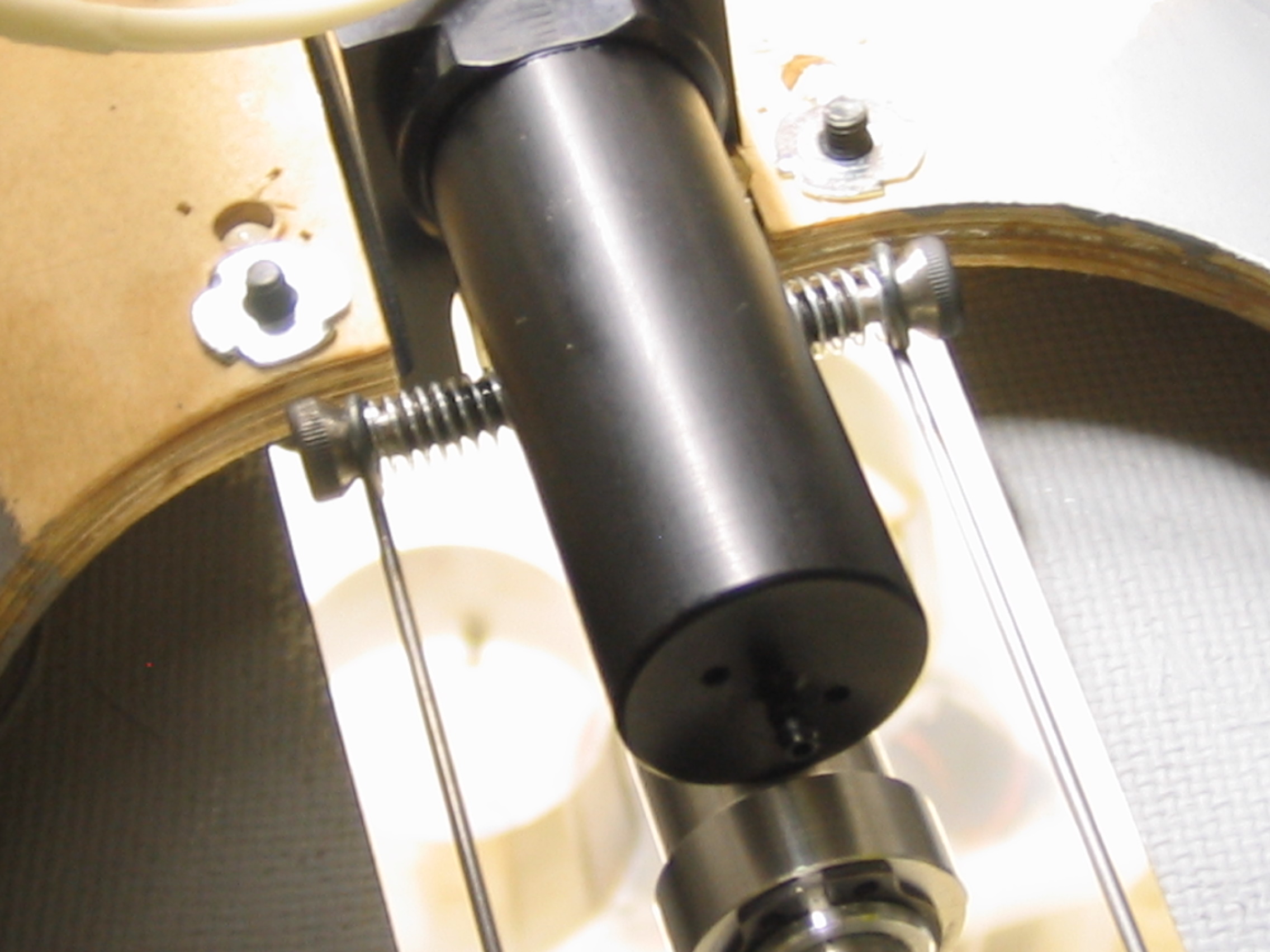

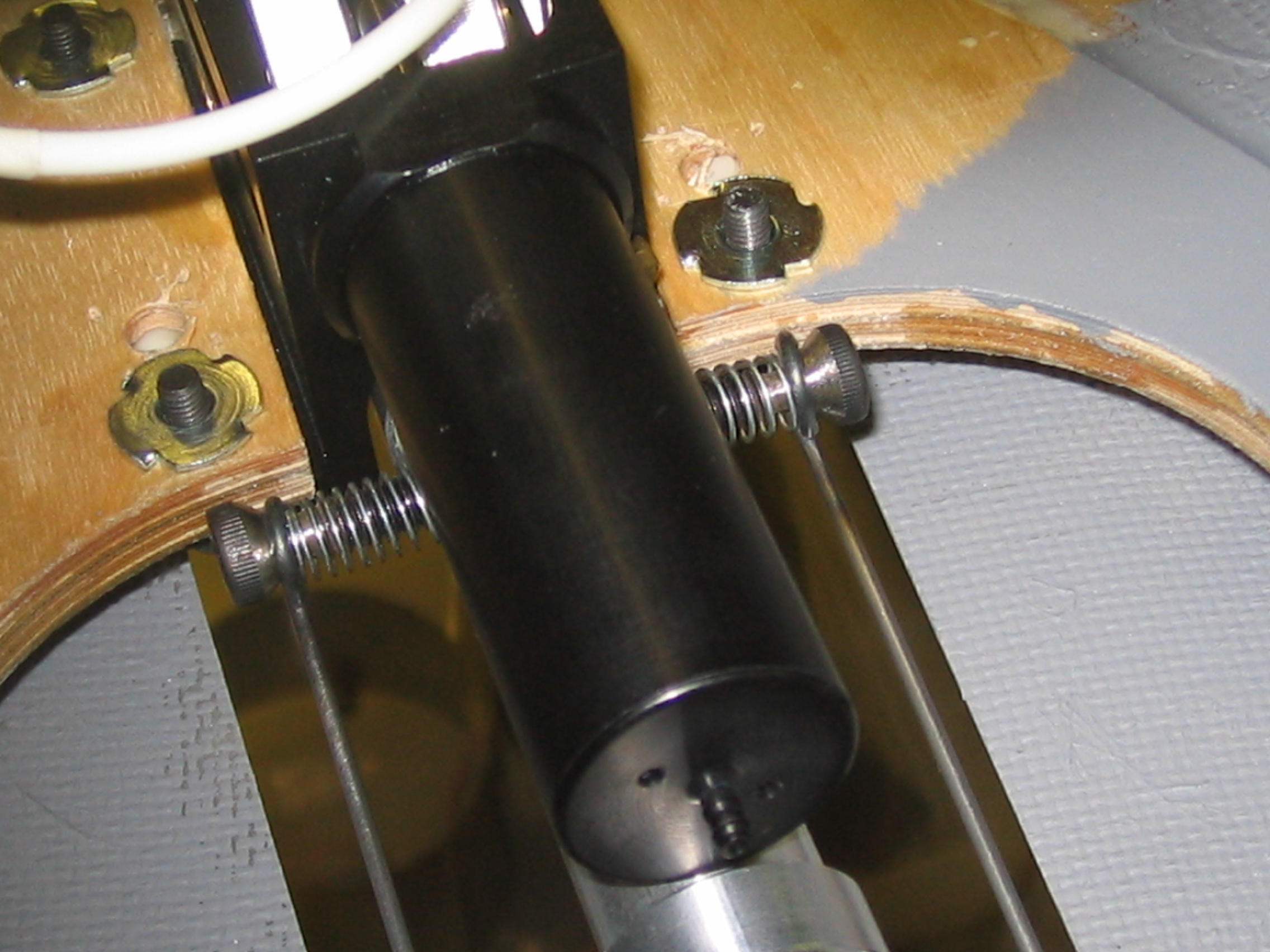

Recently built a model that used springs in front of the retract to keep the nose wheel centered. Steering cables run through tubes on each side. As the wheel retract the springs keep the nose wheel centered. Very simple and effective.

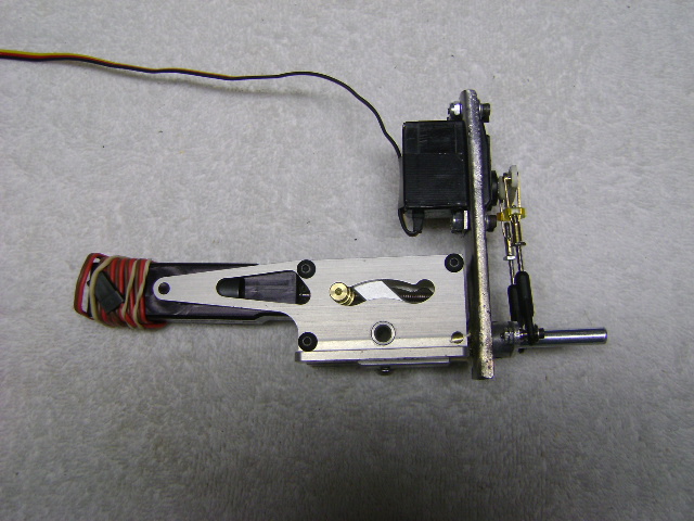

Len, some nose gears have reversible trunnions and can be fitted with one of these in the link below. Just need to be able to turn the cylinder in the other direction so it must clear any formers. I am going to try this with a set of pro link electric gear on the ultra flash.
Best set solution is get rid of the cables if possible.

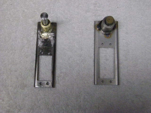

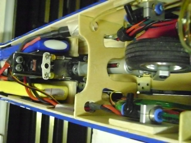

I don't like cables so I used the same approach as Gary. Since I couldn't buy a direct drive adapter to fit my application, I made my own by brazing a bushing to a piece of steel and cutting an opening to mount the servo. Works great.
Joe

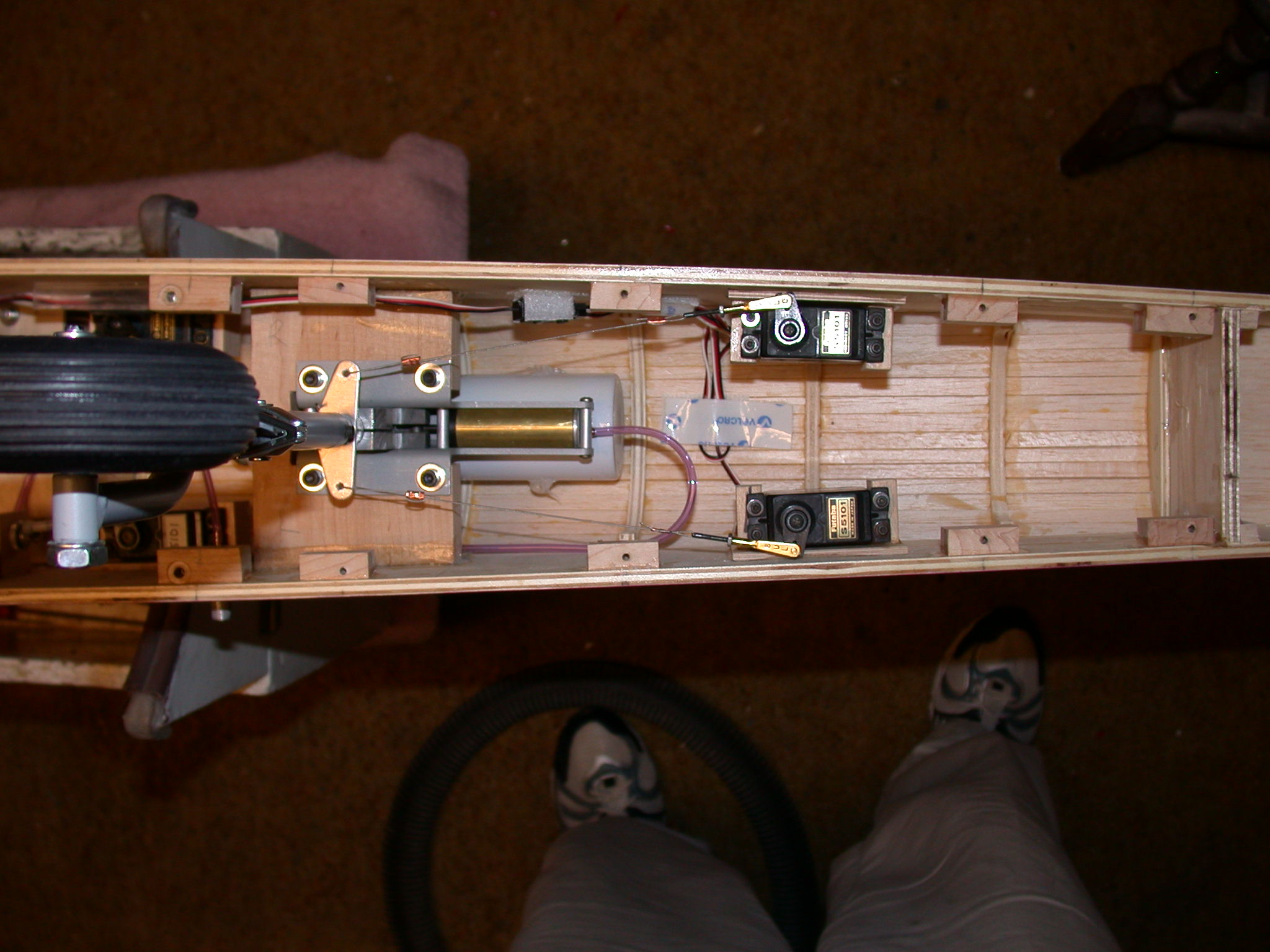

Hi, on a Eurofighter a long while back I used a solid wire idea on the nose leg, the original link was a wire pull pull and the servo was located in the fuselage and no connected to the nose leg so you had to have long loose wire in the fuselage while retracted which could snag on deployment.
The idea was to use piano wire which did not bend but instead slid through two little wire clamps used in model kits fitted to the servo arm, when the gear was extended the wires slid through the clevis and a brass stop fitted to the end of the wires contacted the servo arm allowing the steering to be used in full, when retracted the wires simply laid flat between the nose leg and the servo.
Hope the pictures explain better..... it worked very well.
marcs
