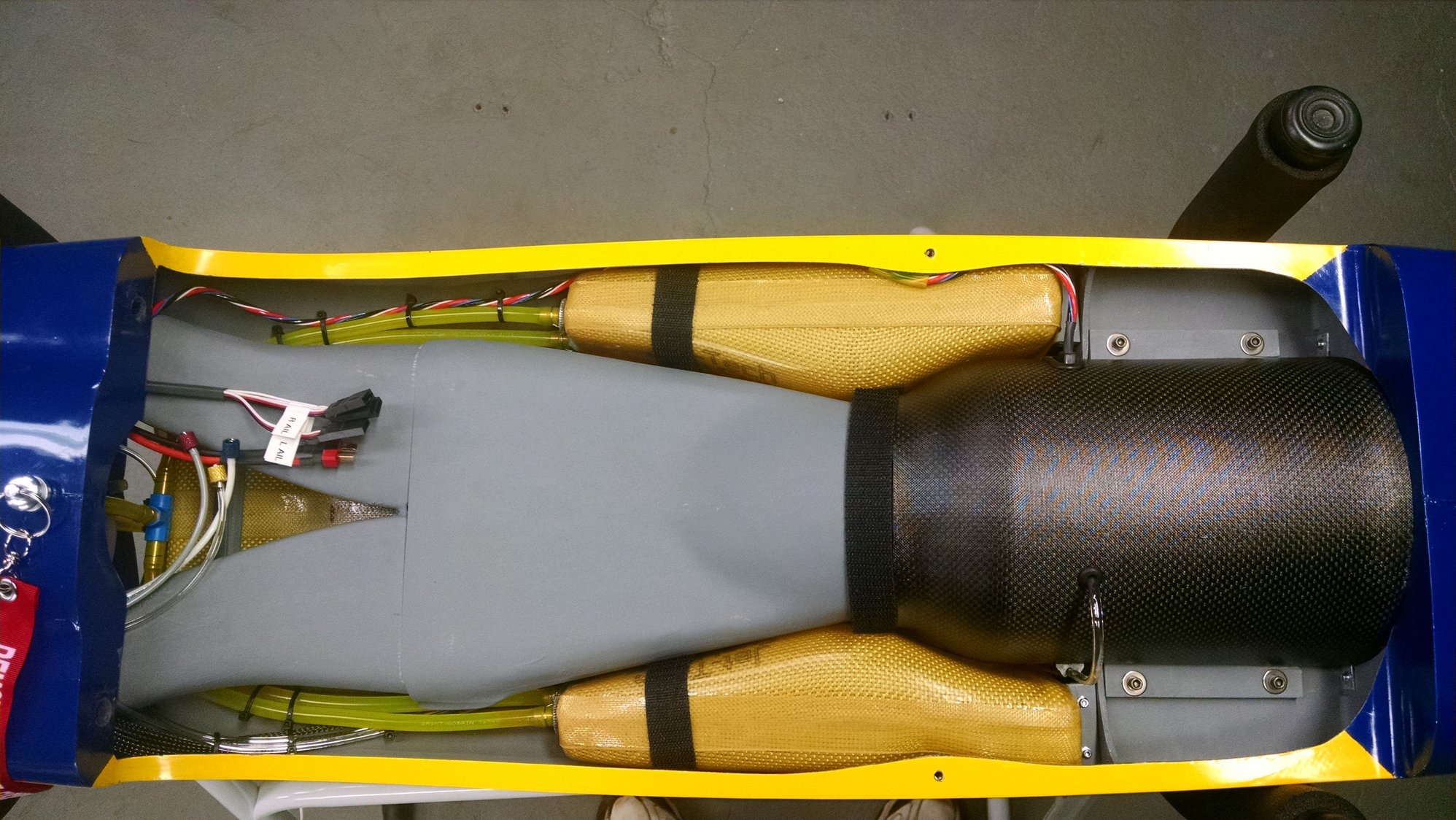

The Fly Navy Flash came in 1/2 pound heavier than the Aggressor. Aggressor 25.5 Pounds, Fly Navy 26 Pounds
Old 05-15-2018, 03:40 PM
  #686
MaJ. Woody
My Feedback: (28)
MaJ. Woody's Avatar
Join Date: Apr 2003
Location: Rochester, NY
Posts: 5,149
Received 9 Likes on 8 Posts
When I went to bolt on the stab, I realized the Airex Block was crushed. I had to grind this out and replace it with Good Old Hard Plywood Block.
Old 05-15-2018, 03:42 PM
  #687
MaJ. Woody
My Feedback: (28)
MaJ. Woody's Avatar
Join Date: Apr 2003
Posts: 5,149
I have tons more build and install pics but I am ready to be done with building and build threads! I want to go fly!! See you there!!
