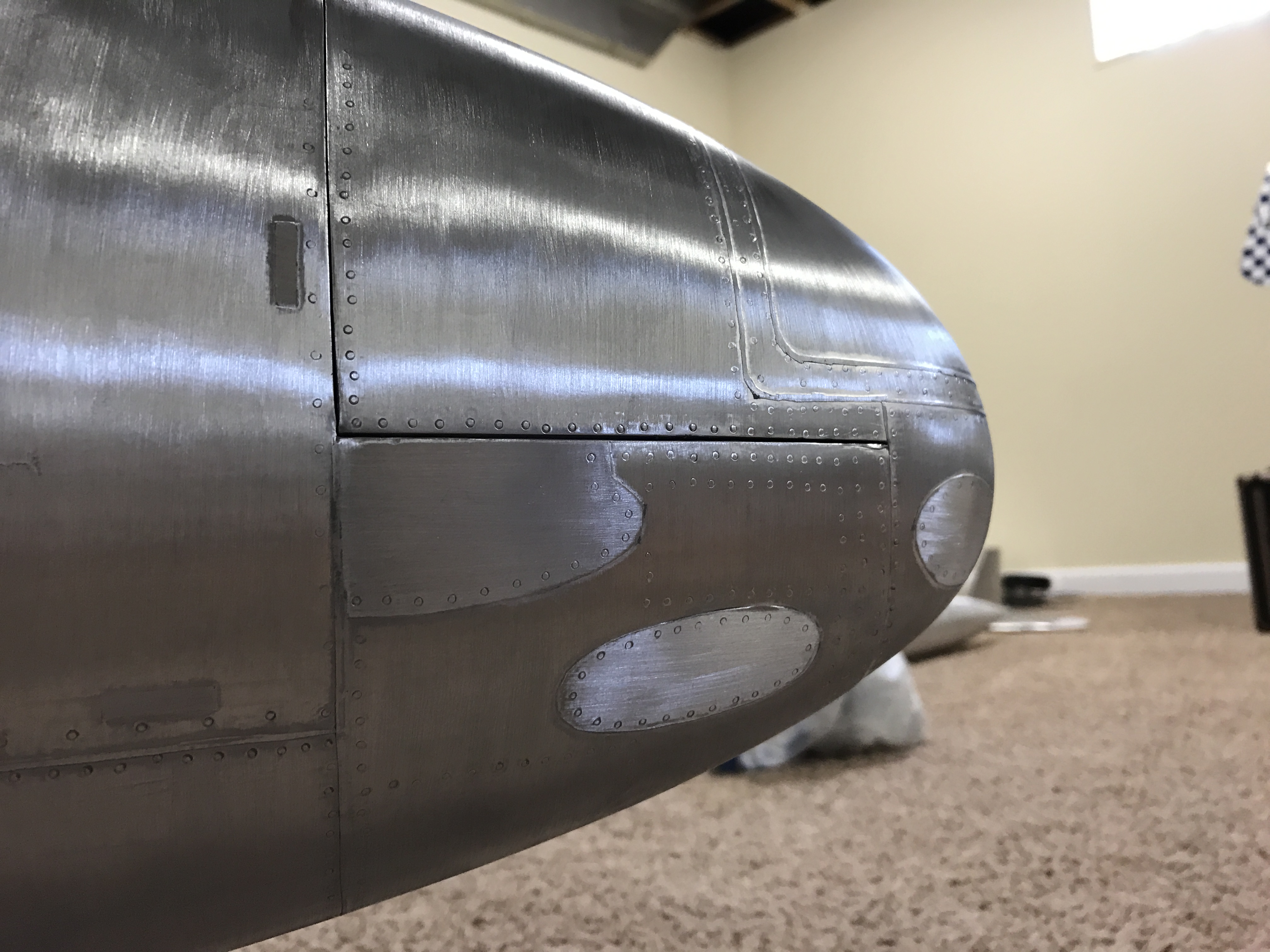

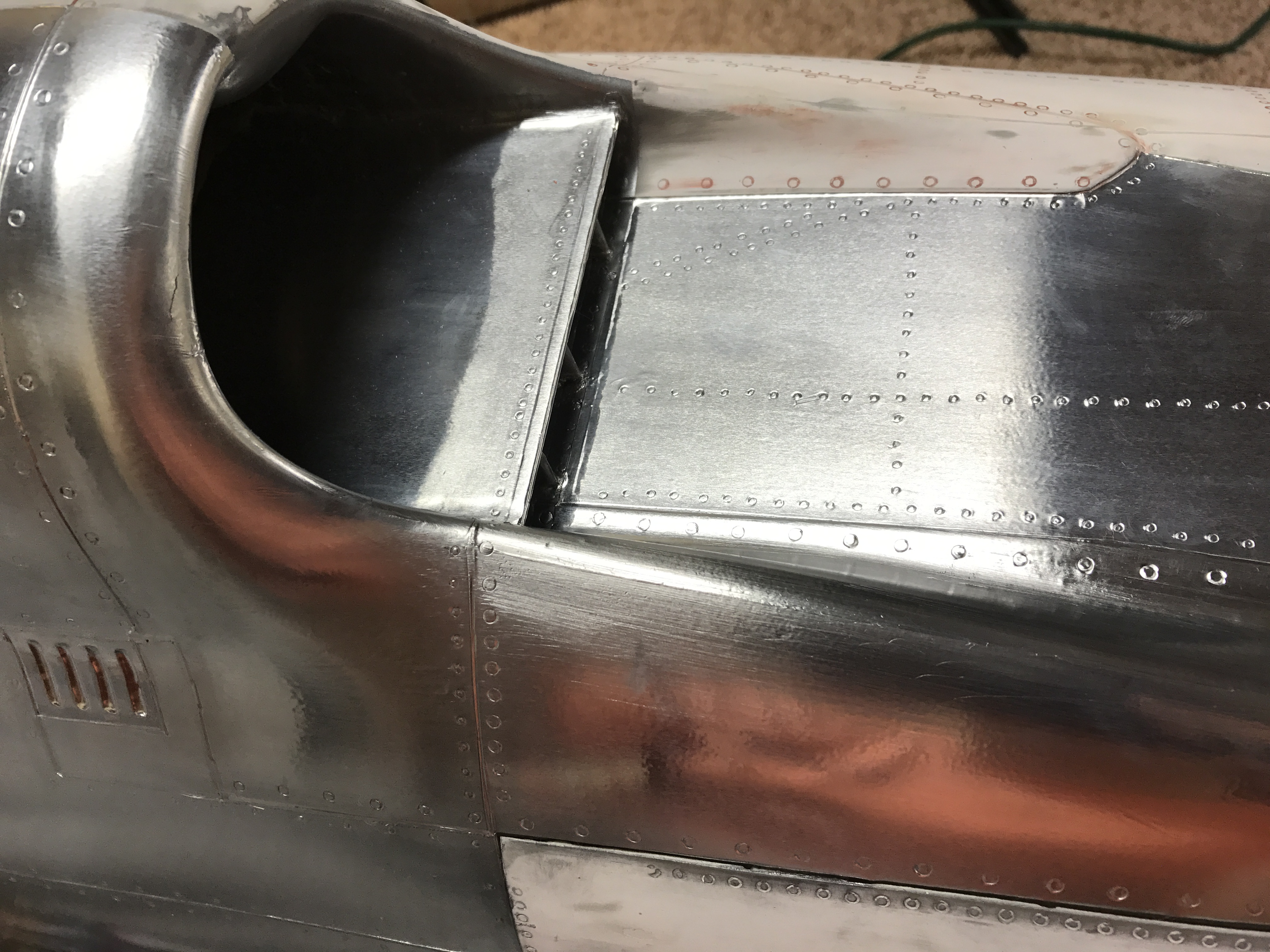

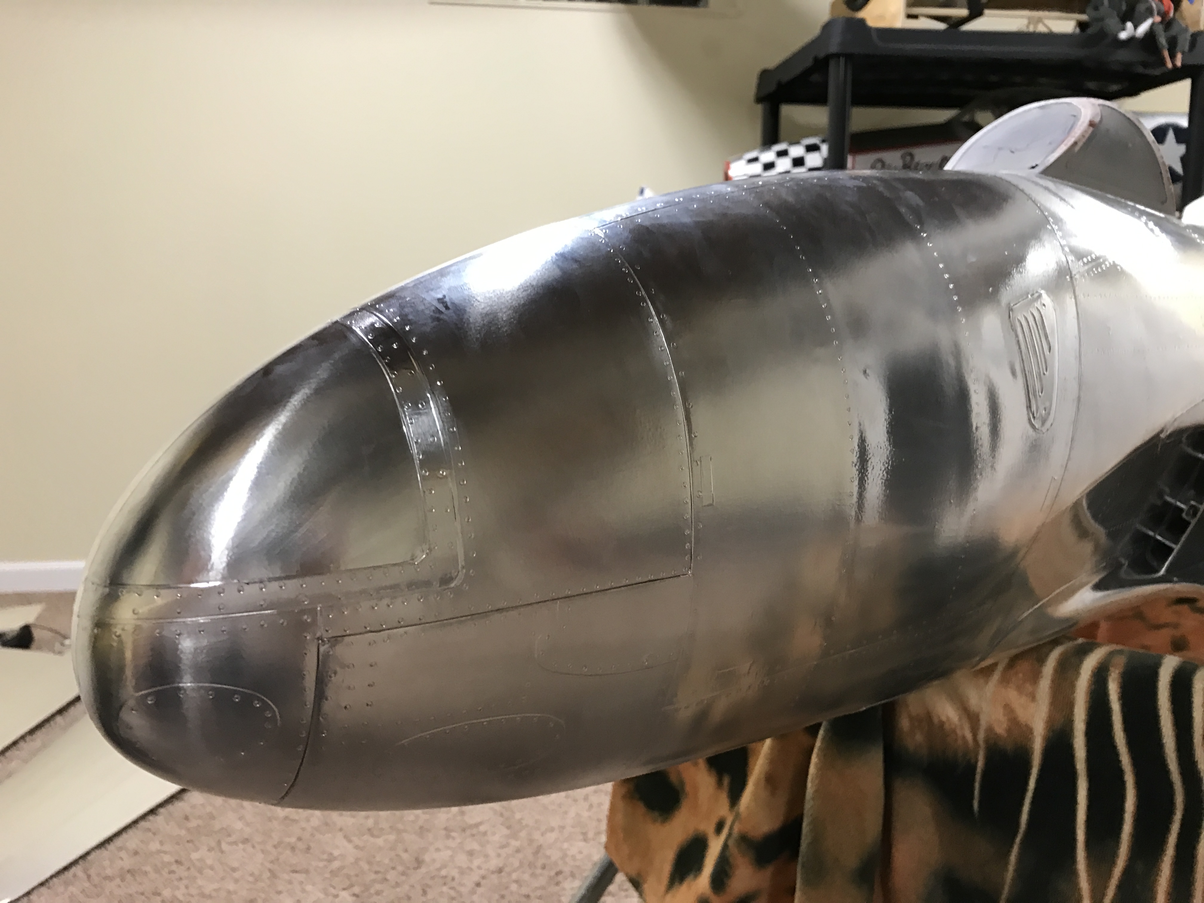

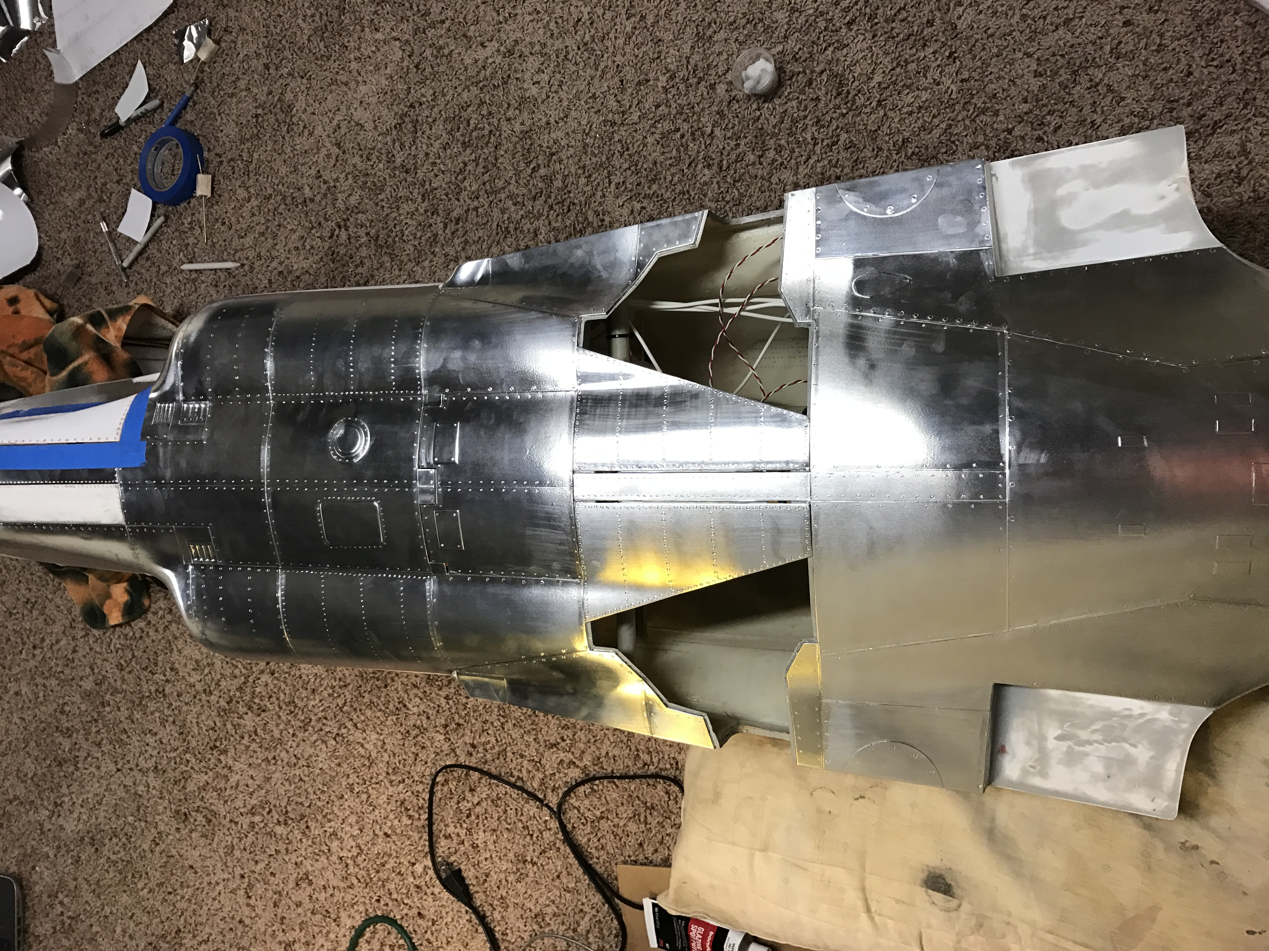

Progress has been slower on the front end of the fuse- there are a lot of complex panels to do and I haven't been home to do them. Also, apparently there are far fewer rivets there than on the rest of the plane.
Total rivets: 23,793

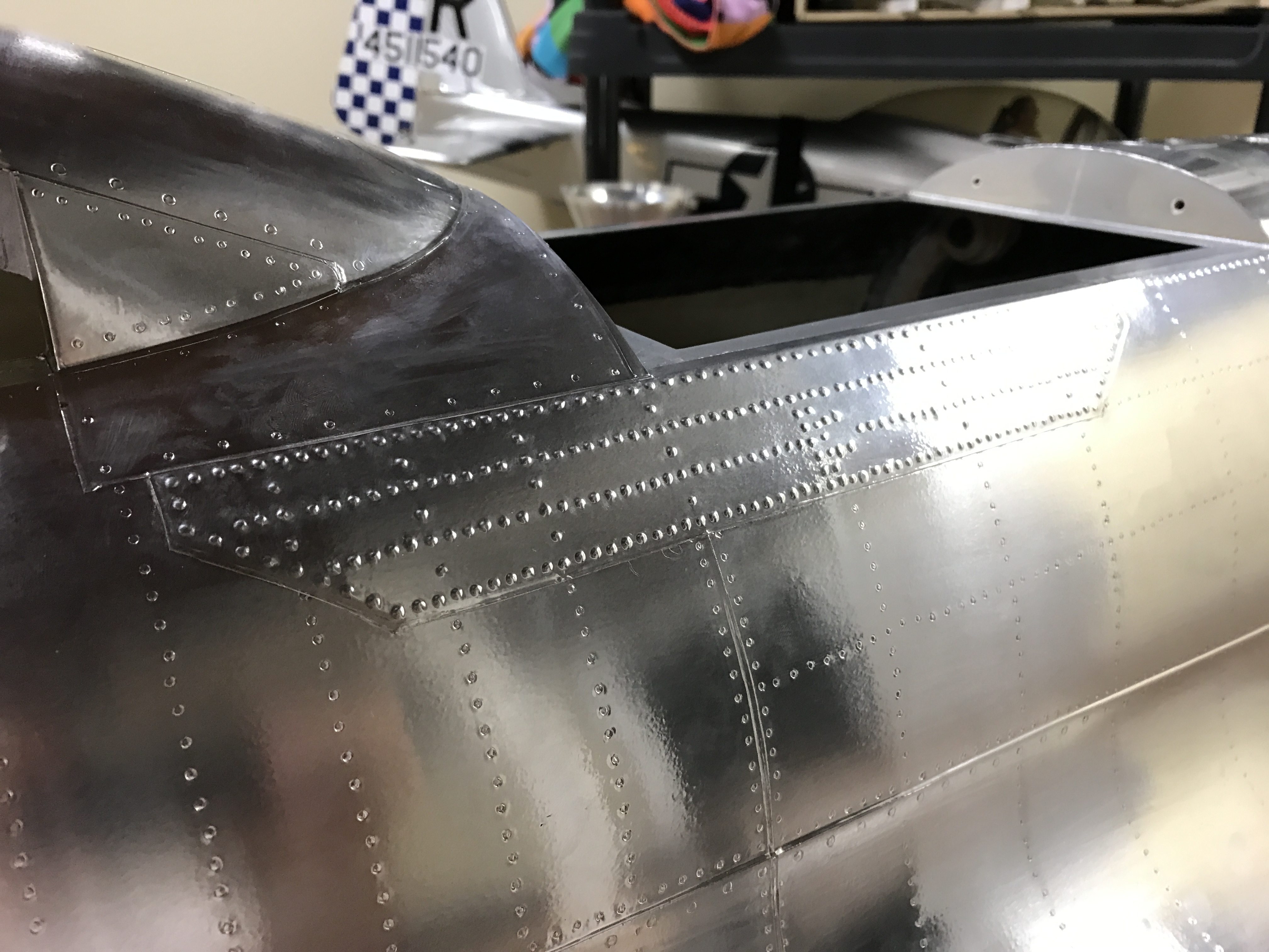

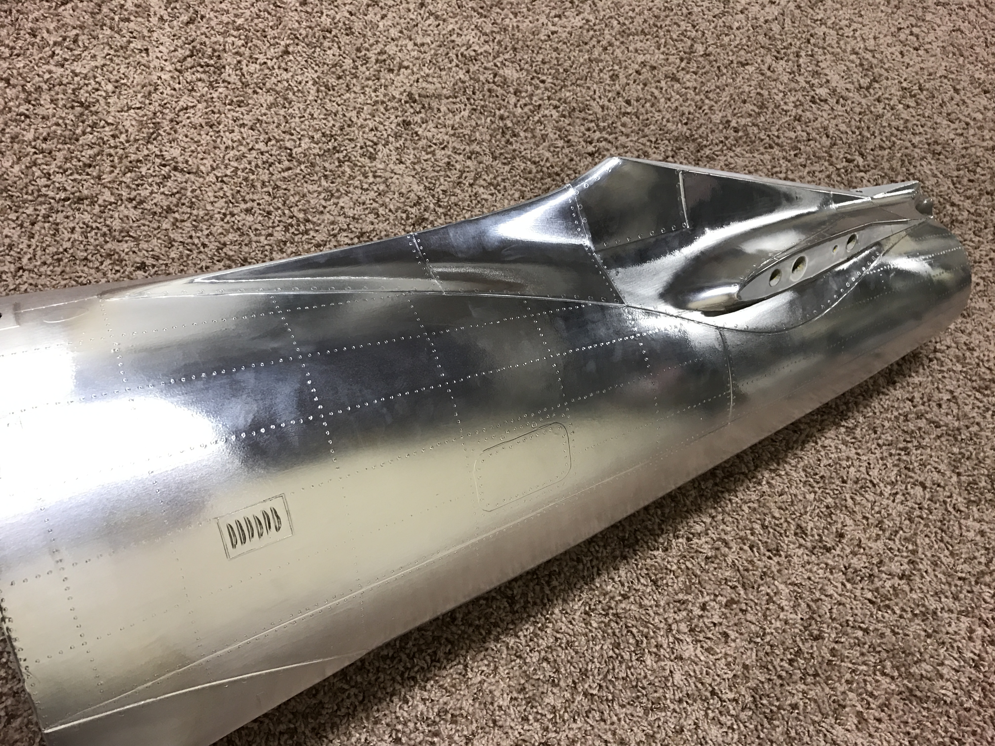

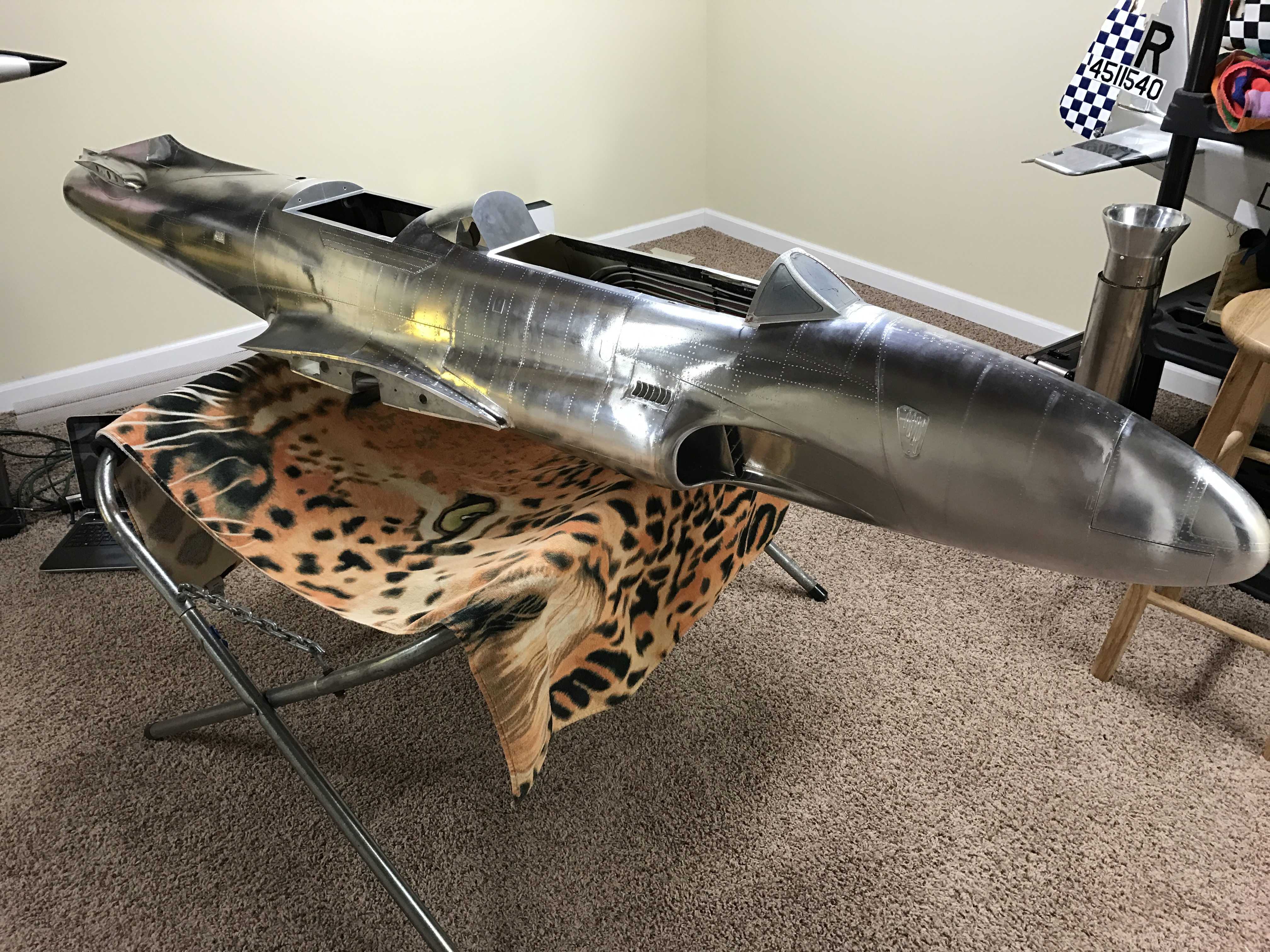

I've been hard at work the last few days and have now completed the fuselage.
Total rivets: 29,999

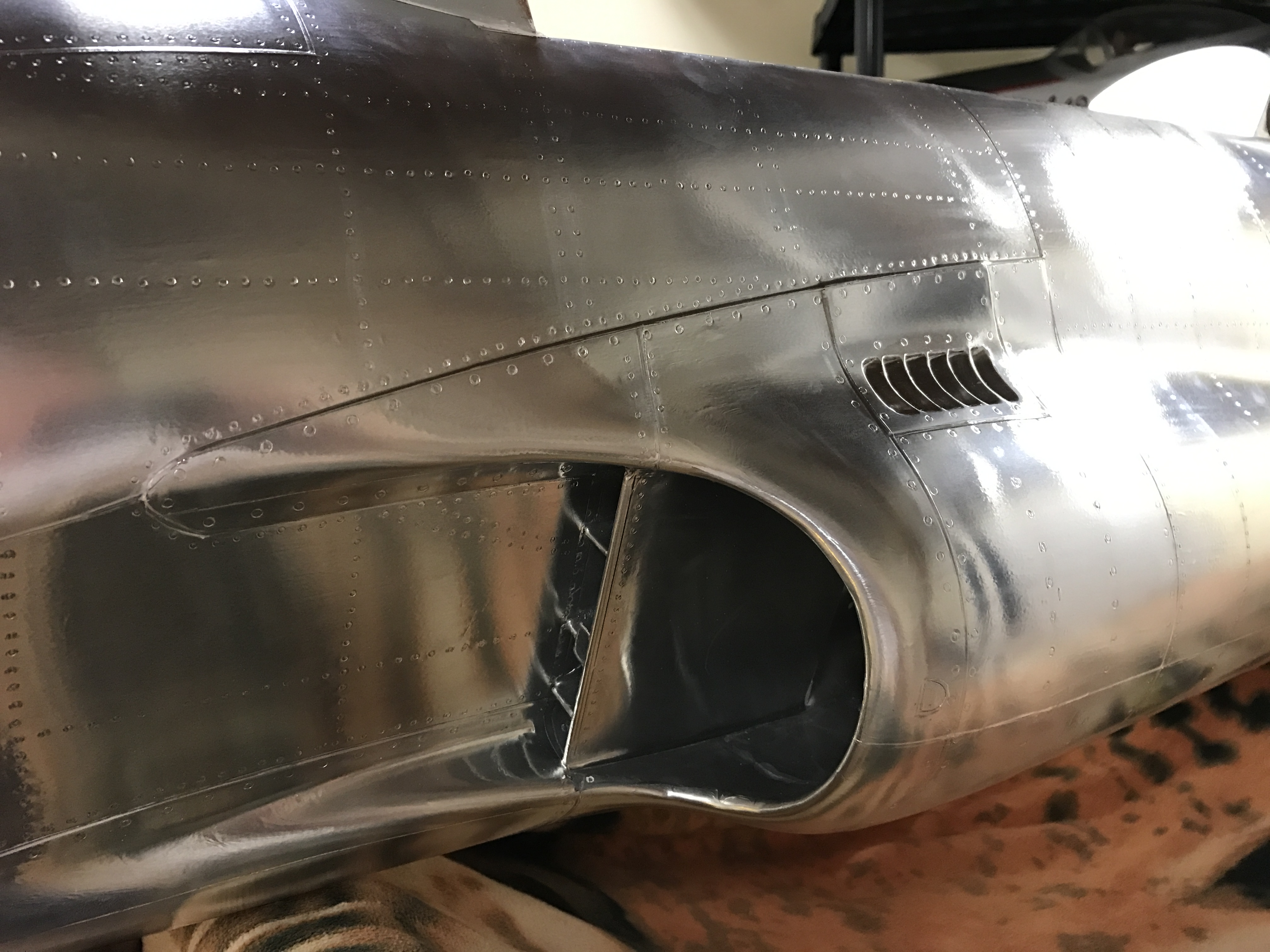

I finished up the tail and tanks in the last week.
Total Rivets: 32,376 - I still have to do the small gear doors and aileron covers, but this is a much larger number than I would've guessed before starting out.
Next up is sanding everything, followed by a good cleaning and paint

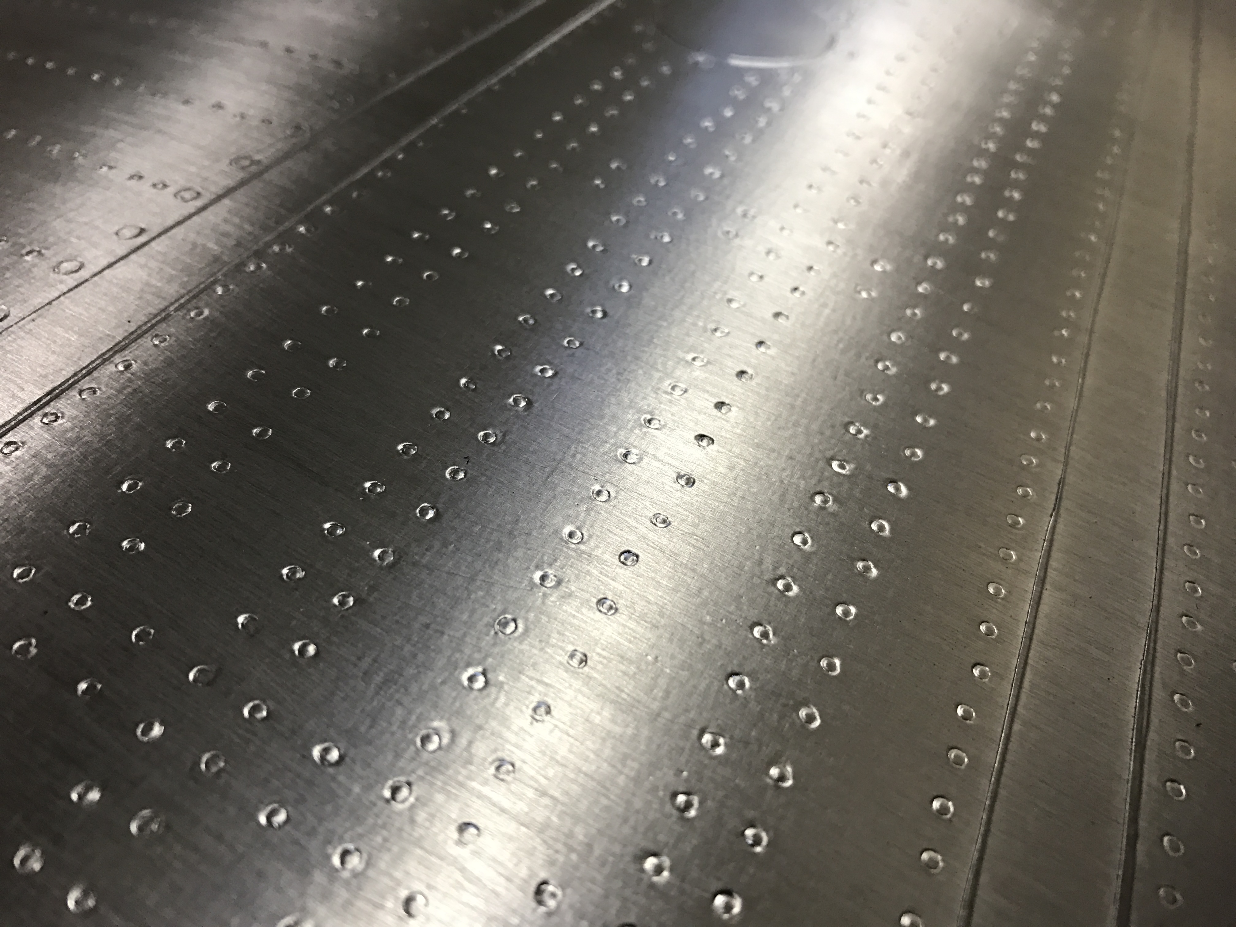

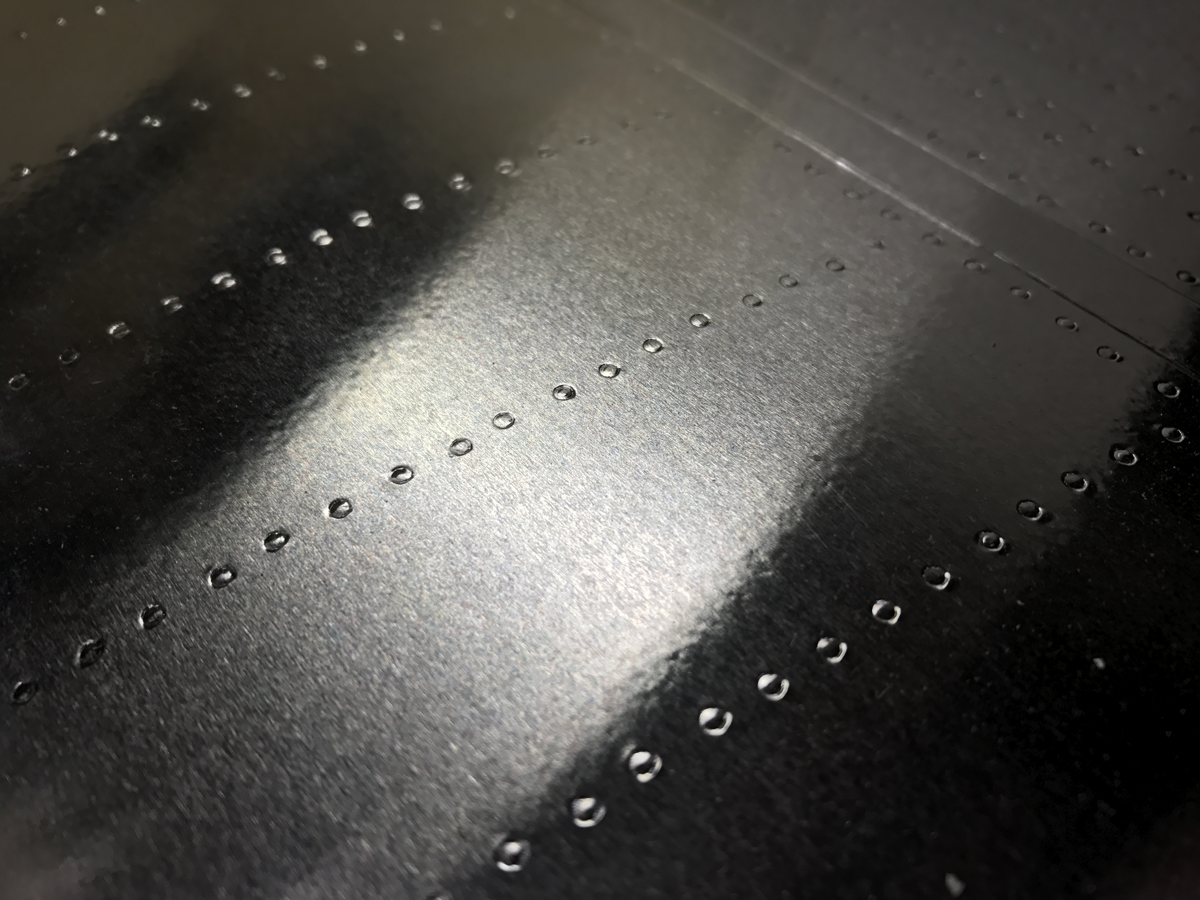

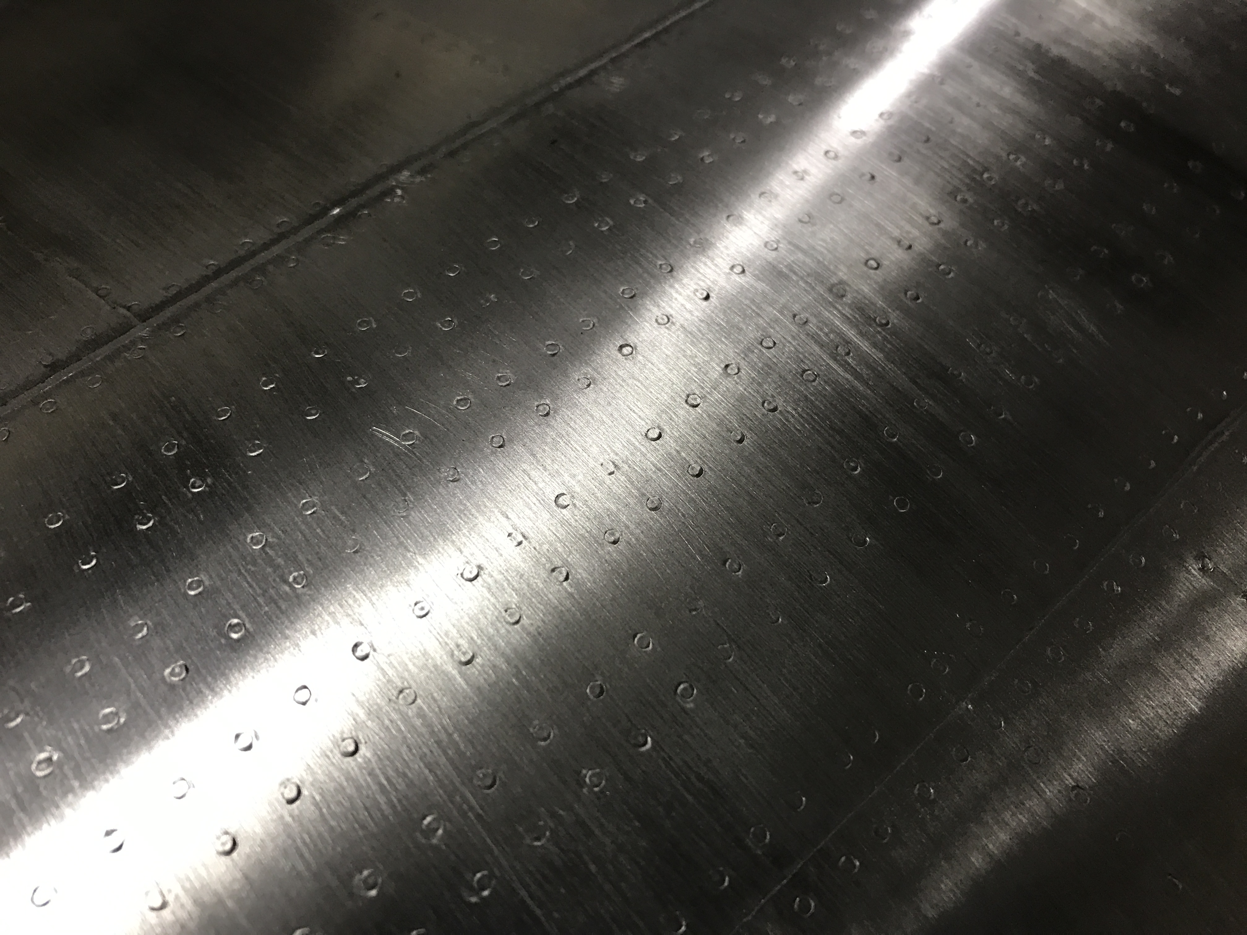

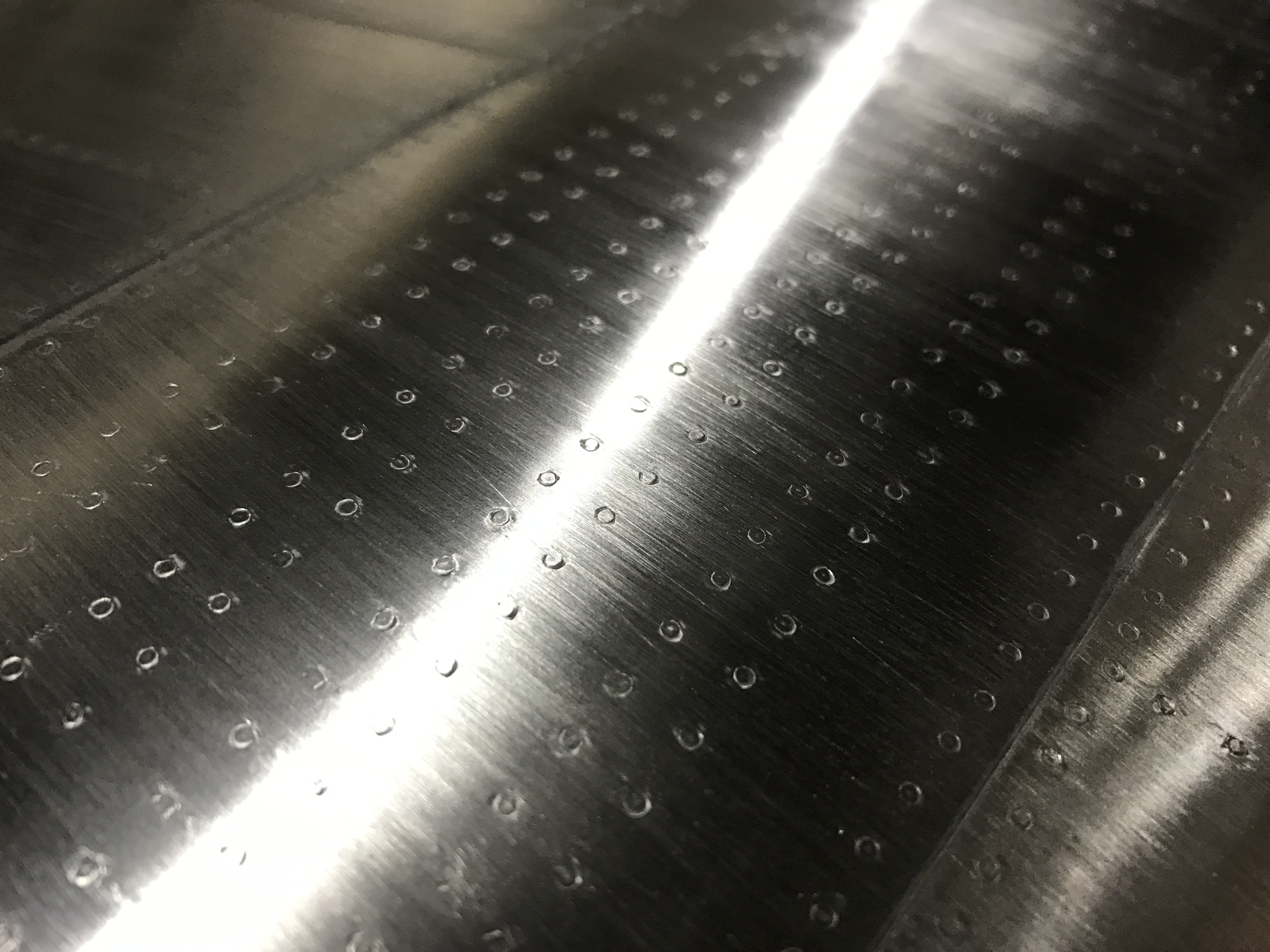

I've been sanding the last few days, and still have a lot more to go. Although it takes a lot of time/effort, it's pretty incredible what a difference it makes! Pictures are: 1) Flite Metal as applied- not sanded, 2) sanded with Scotch Brite pad- brings out an "orange peel" effect from the glue backing, 3) 320 grit sandpaper- starting to remove the orange peel, 4) 400 grit sandpaper- bringing out a nice shine. The surface needs to be cleaned really well before painting, and will be polished when everything else is finished to stop (slow) the oxidation

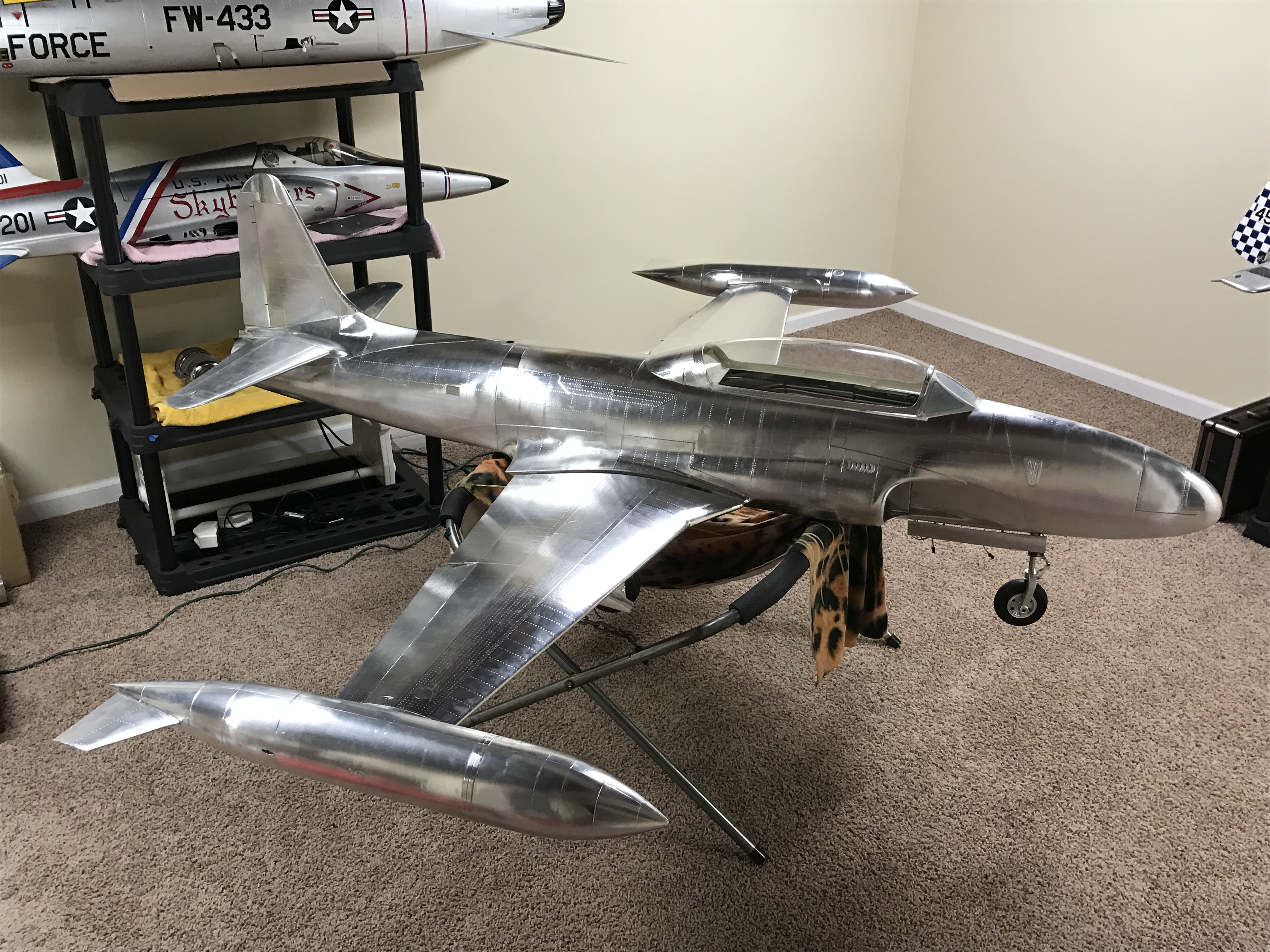

Sanding the flite metal took a long time, but I finally got it finished. All the 3D panels on the plane were sanded the opposite direction so they stand out more.
Paint booth is booked for this week, so I should get it painted soon!

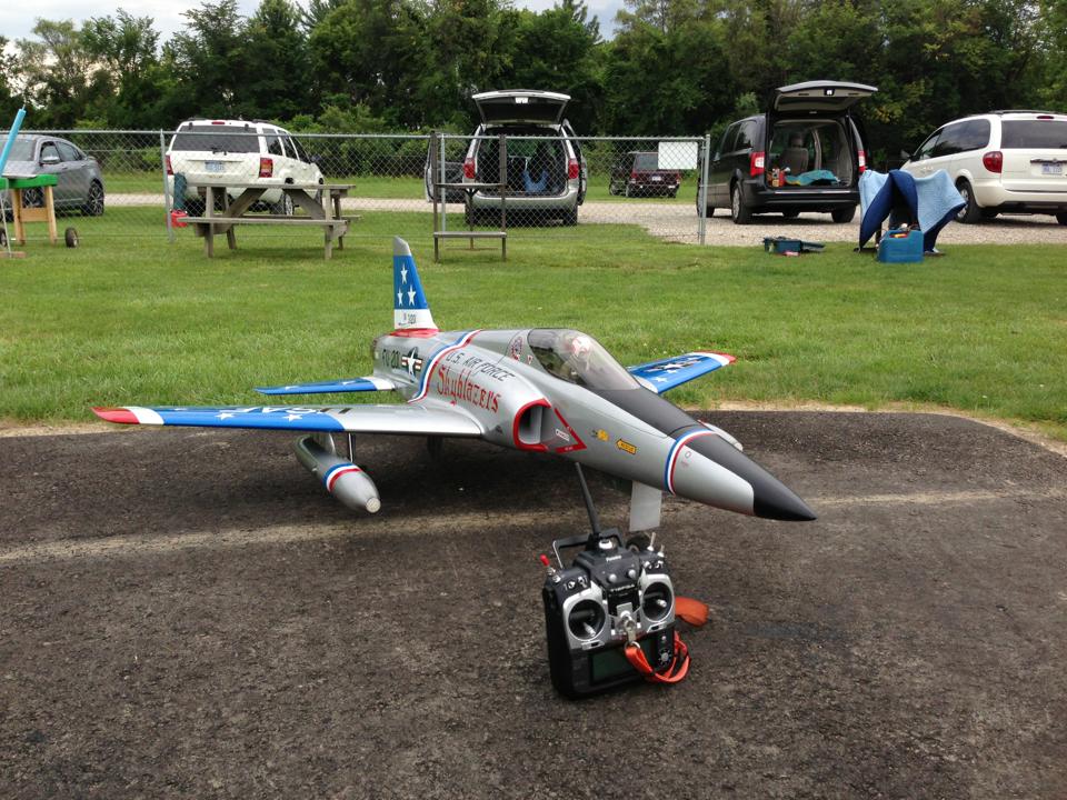

Thanks Ravill!
BVM Super Bandit
BVM F-100
PS: I'm the girl

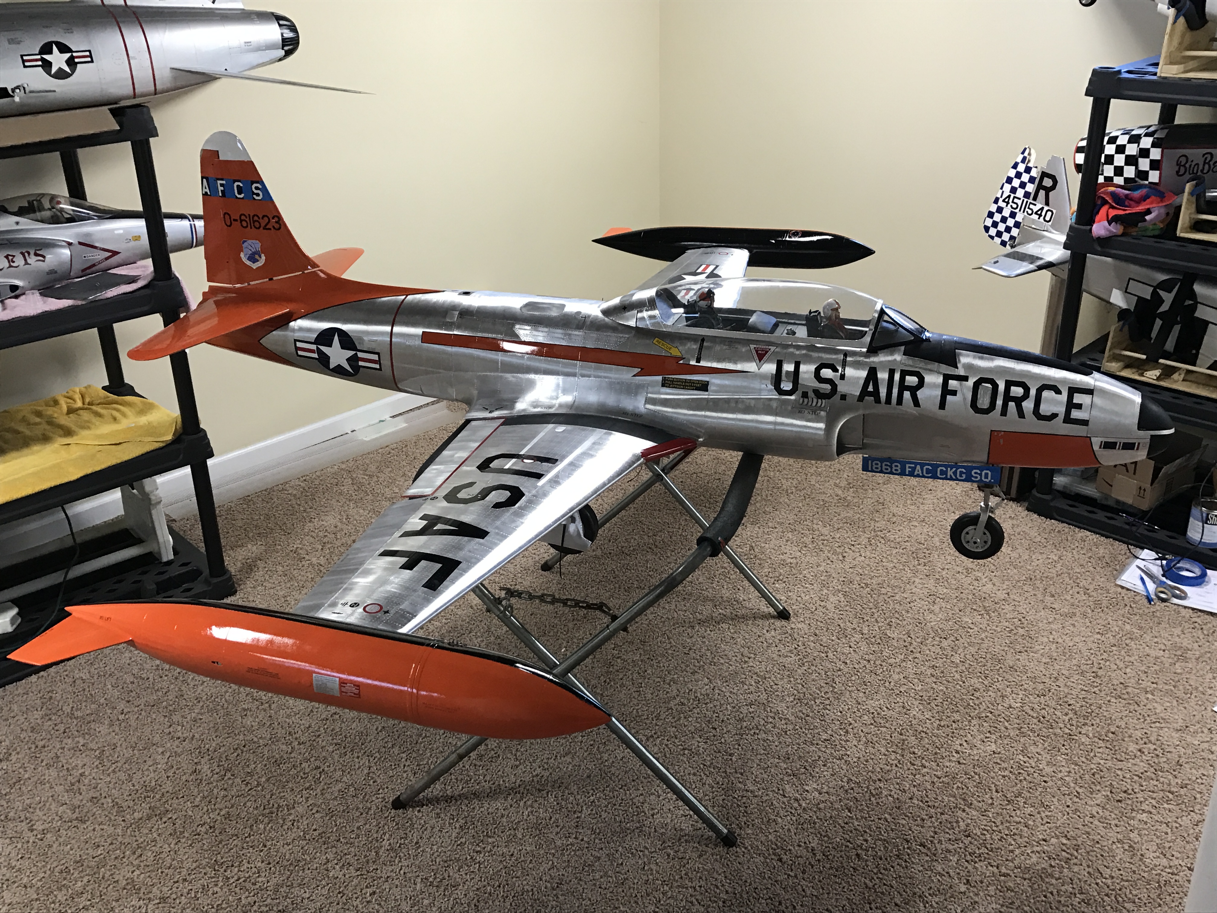

Got the T-33 painted last week and I've started adding the nomenclature
