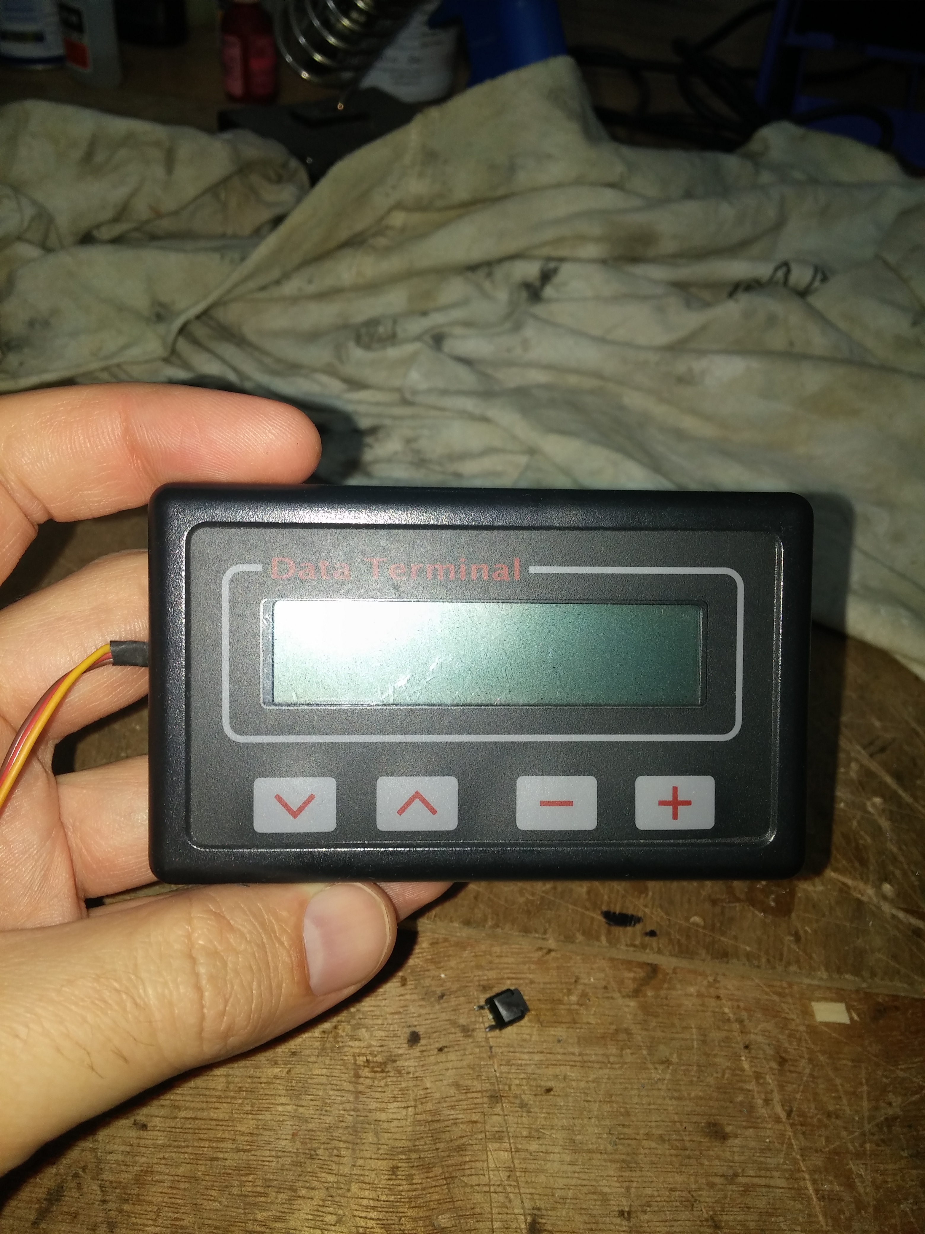

Hello guys,
Theres nothing more fun than a good useful mod! and i found this mod useful if you fly in the sun and can barely see your Xicoy GSU lettering.
This mod adds a very strong back light to the Xicoy GSU, and can be done both for V6 GSU and V10 GSU. these GSUs are very common among several jet engine manufacturers.
To do this mod you will need:
- a 16x2 generic LCD (yellow, blue, red) - cost is 1.7$ or so, such as:
http://www.ebay.com/itm/1602-16x2-HD...sAAOSwj2dXkHUK
- a small 5k pot
- some wiring
- a soldering iron
- basic soldering skills
Lets get to it !
Attached: GSU before mod. very hard to read in the field in sunny Israel!

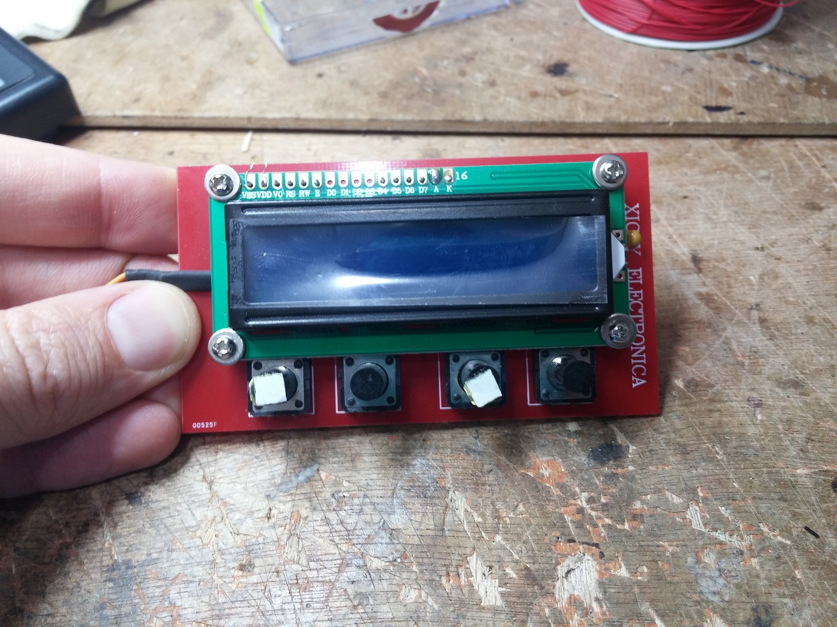

Step 1 - pry open your GSU - it would usually open with hand grip.
This is what you will find inside:

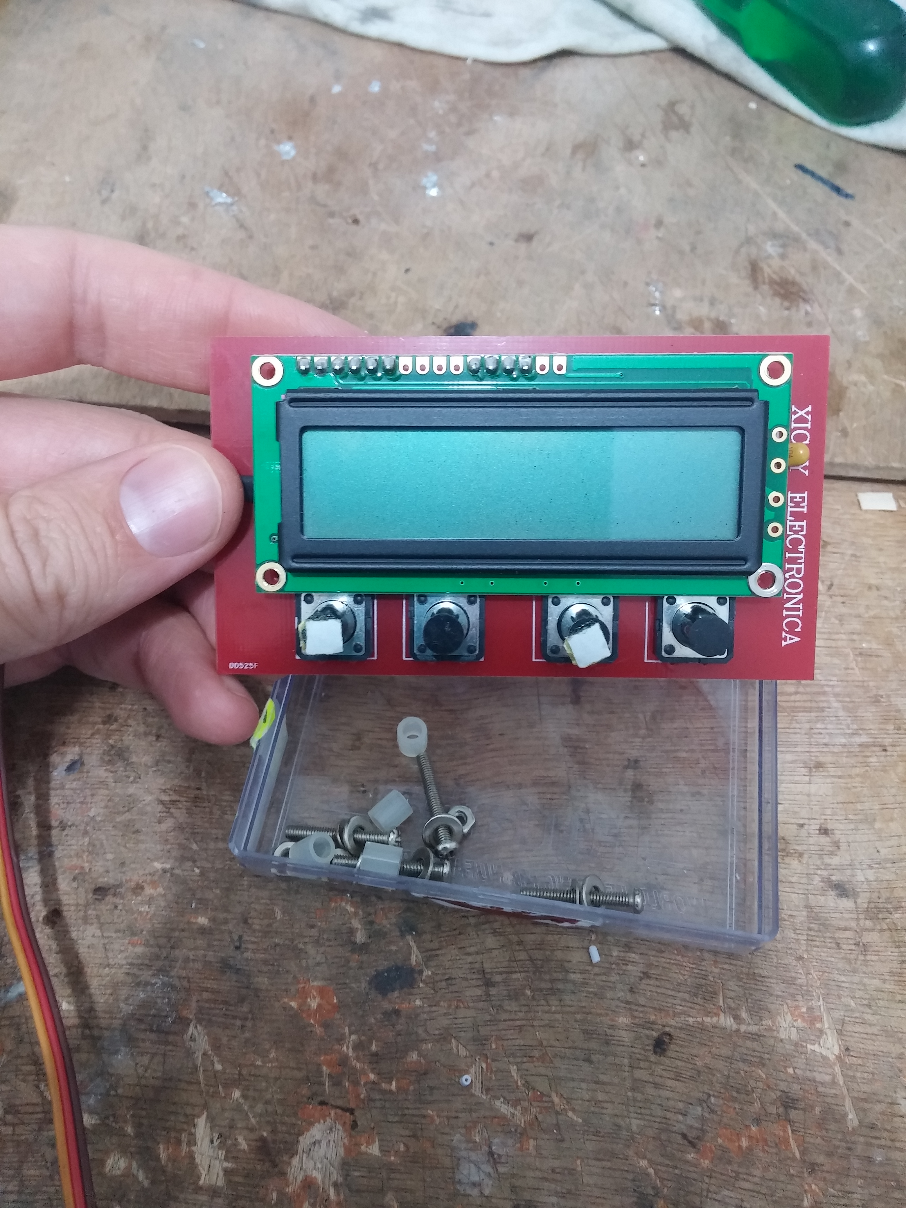

Step 2: remove the 4 bolts from the LCD module.

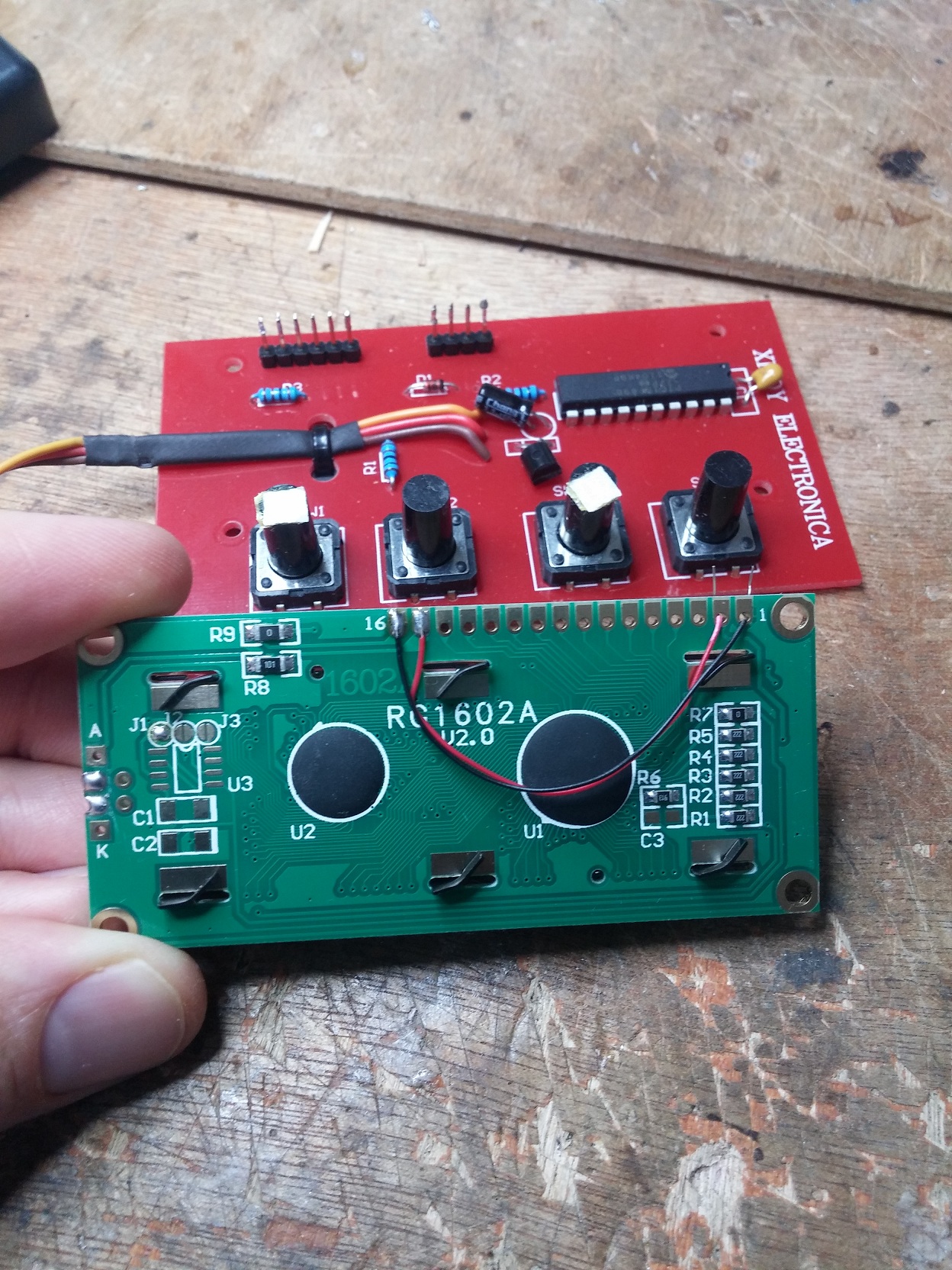

Step 5 - on your newly aquired Ebay backlit LCD - prepare 2 thin wires (i used wire wrap wires) as shown in the picture, these will supply power to the backlight.
PS - these can be added afterwards if you wish, but i like a neat install with wires in the back.

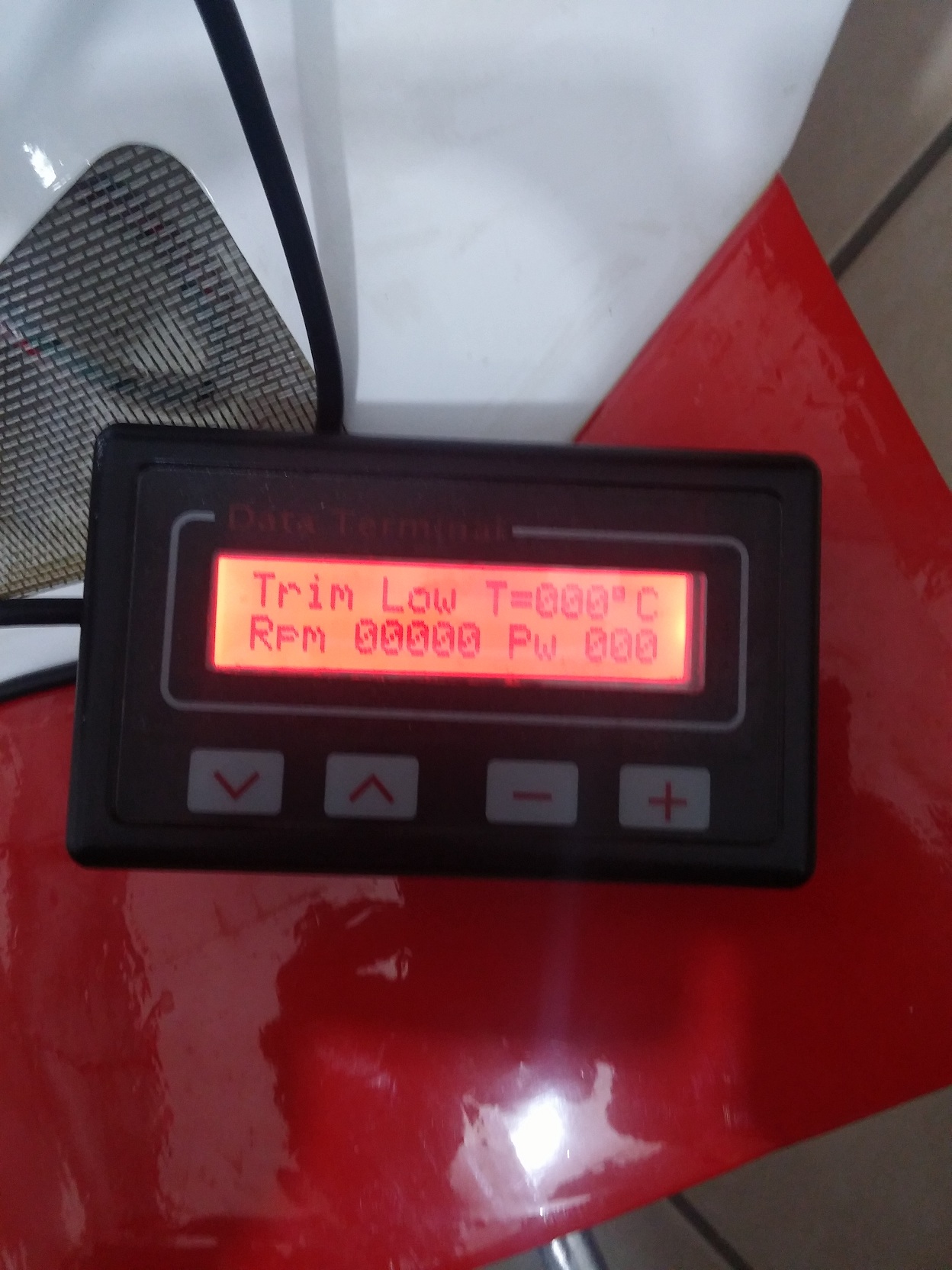

end result:
