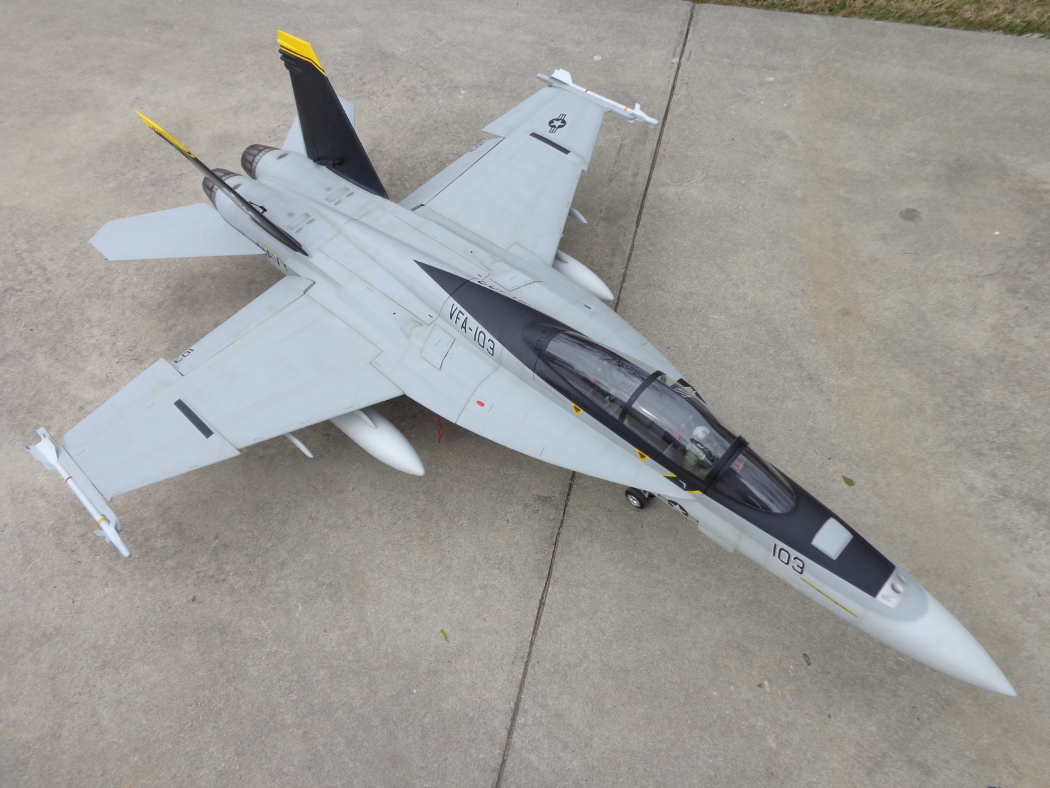

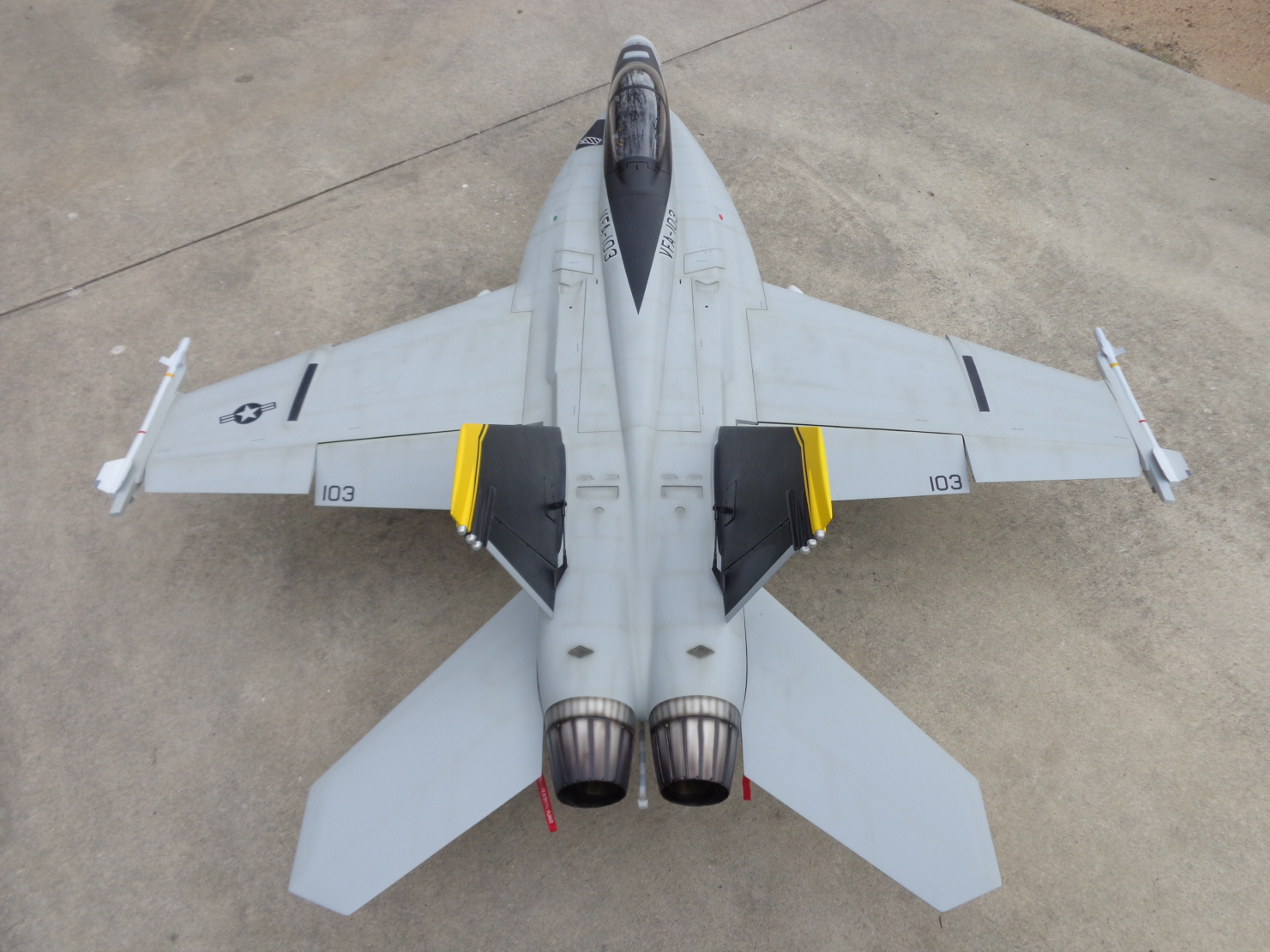

My latest project is the Xtreme Skymaster F-18F. Using an airbrush I used a combination of the dark Gray, mixed with Black and Yellow to highlight the panel lines and make it look dirty, looks like rust and oil.
Of course the biggest problem with weathering is over doing it and I think using straight Black for weathering is a bad idea in most cases.
The pictures do not show the weathering very well, in person it looks pretty convincing. Not shown is the bottom under the engines and behind the gear doors is where most of the dirt accumulated.
Less is more!
Luke

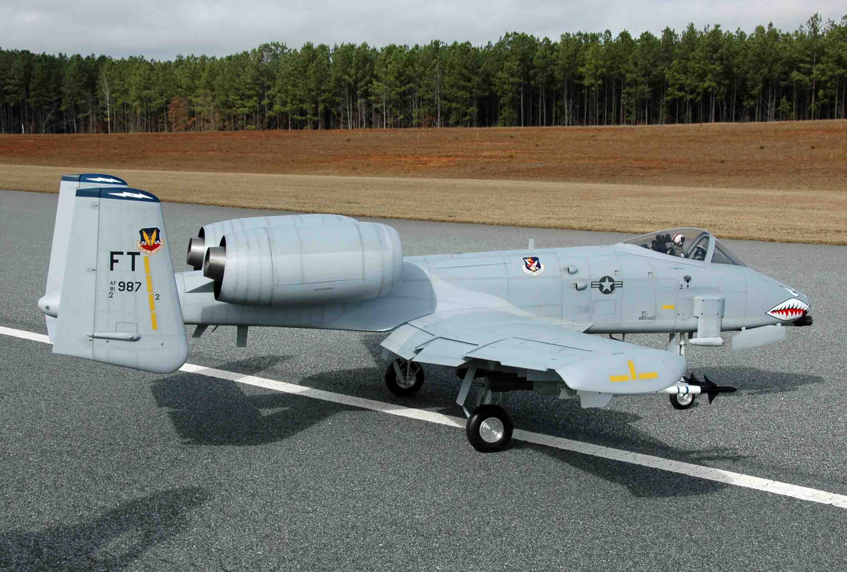

I have had good luck with artists chalk. Buy a multi pack like the one shown for about $15. Pick the appropriate color(s) and use a piece of cloth to rub it where you want weathering....panel lines, streaks behind hinge lines and fuel caps for example. You can vary the darkness and amount by how much you apply. When you are done, spray it lightly with a flat clear coat to seal.
Here's how it looks on my A-10.

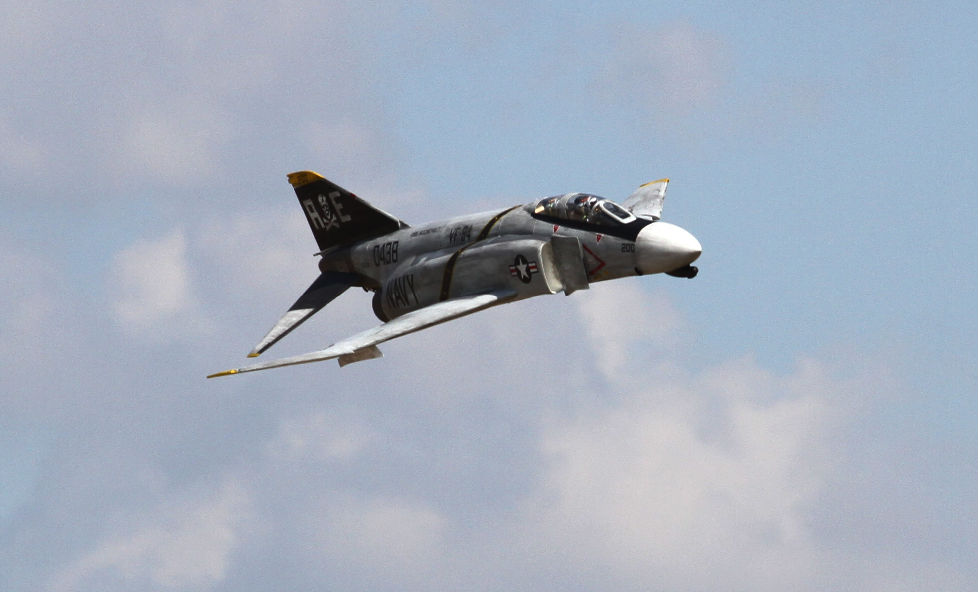

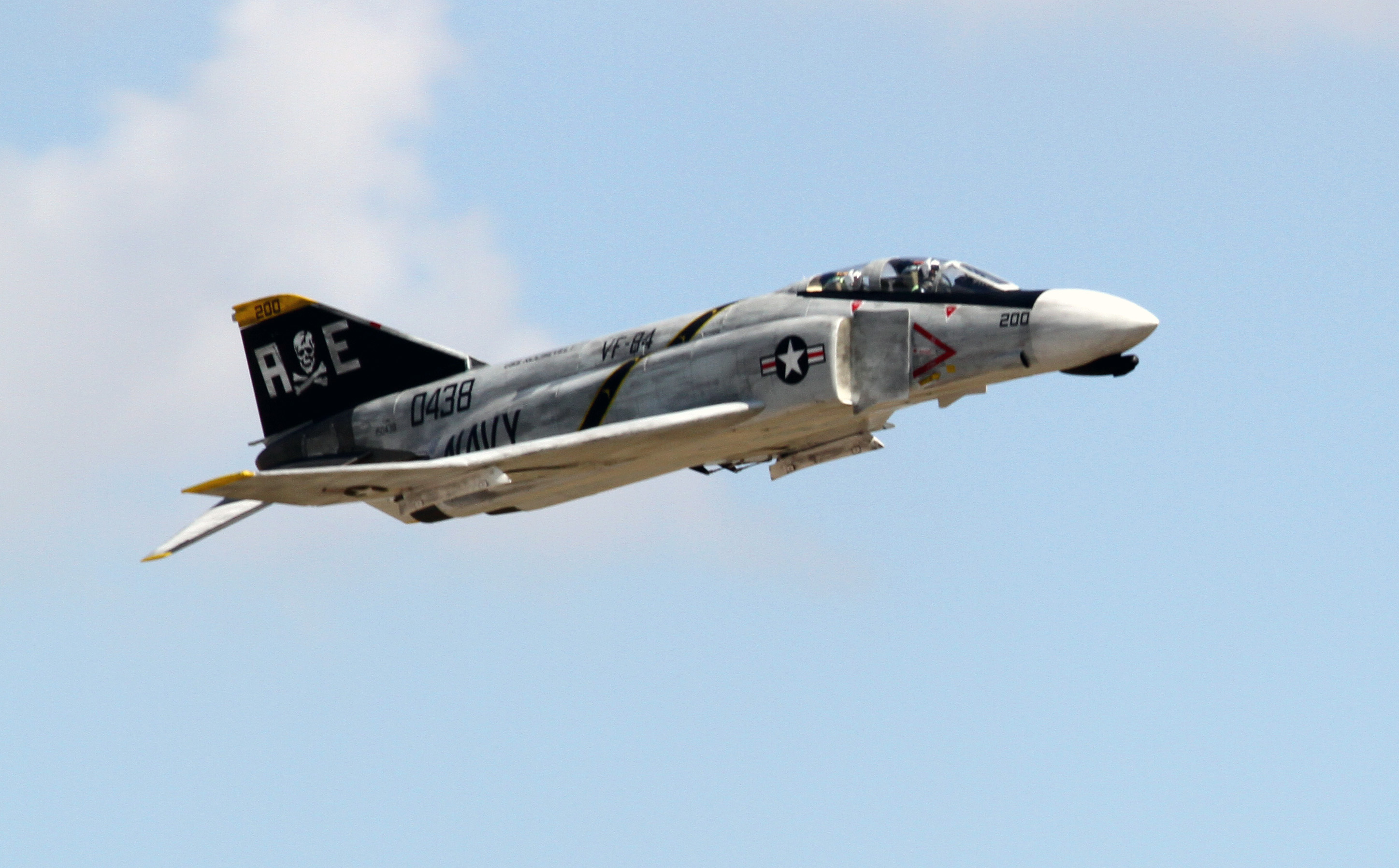

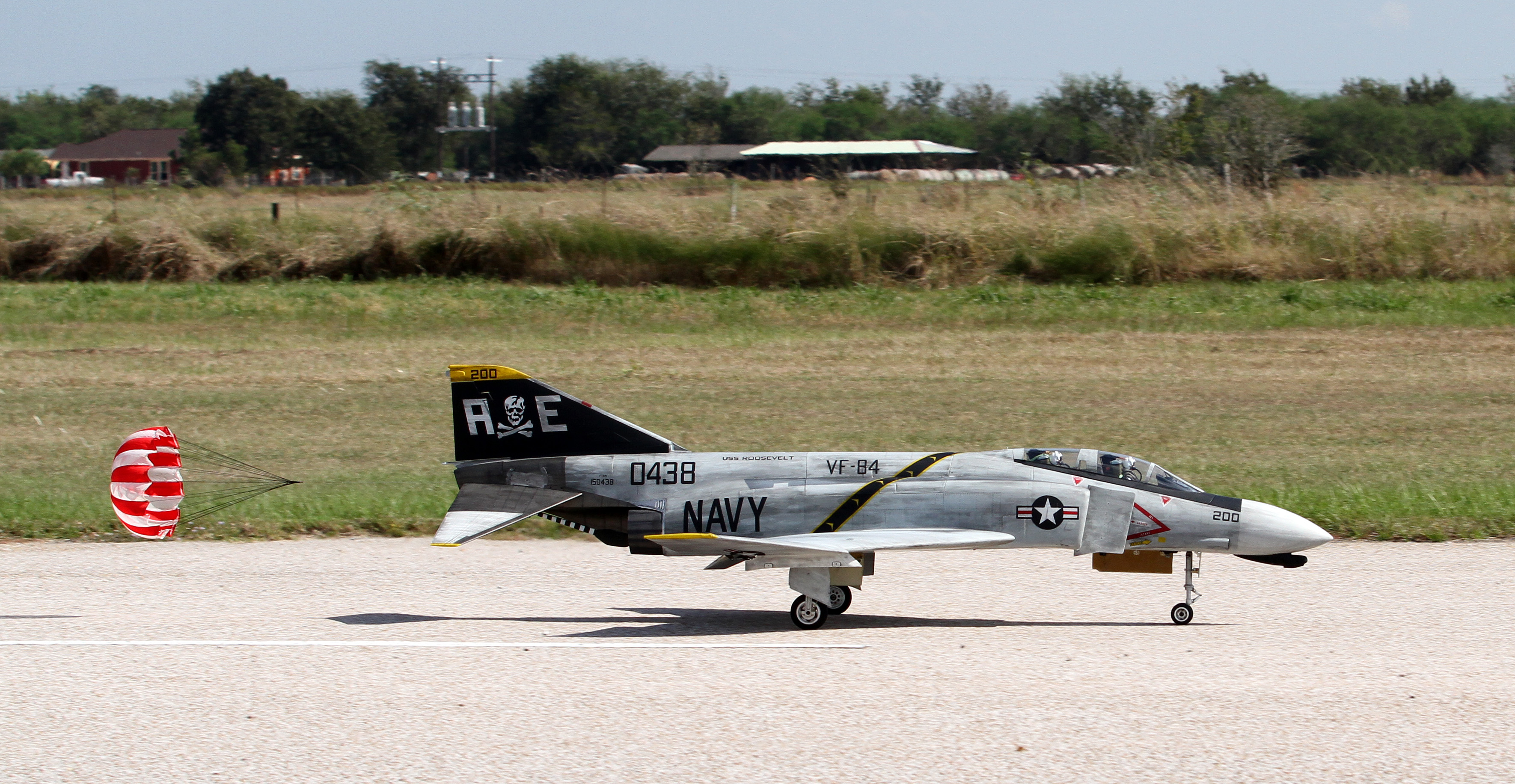

I like acrylic paints. Black browns. Wipe on and wipe off with damp rag. Wet sand with fine paper to remove more if needed. Here are 2 examples one very dirty and one air force not so much

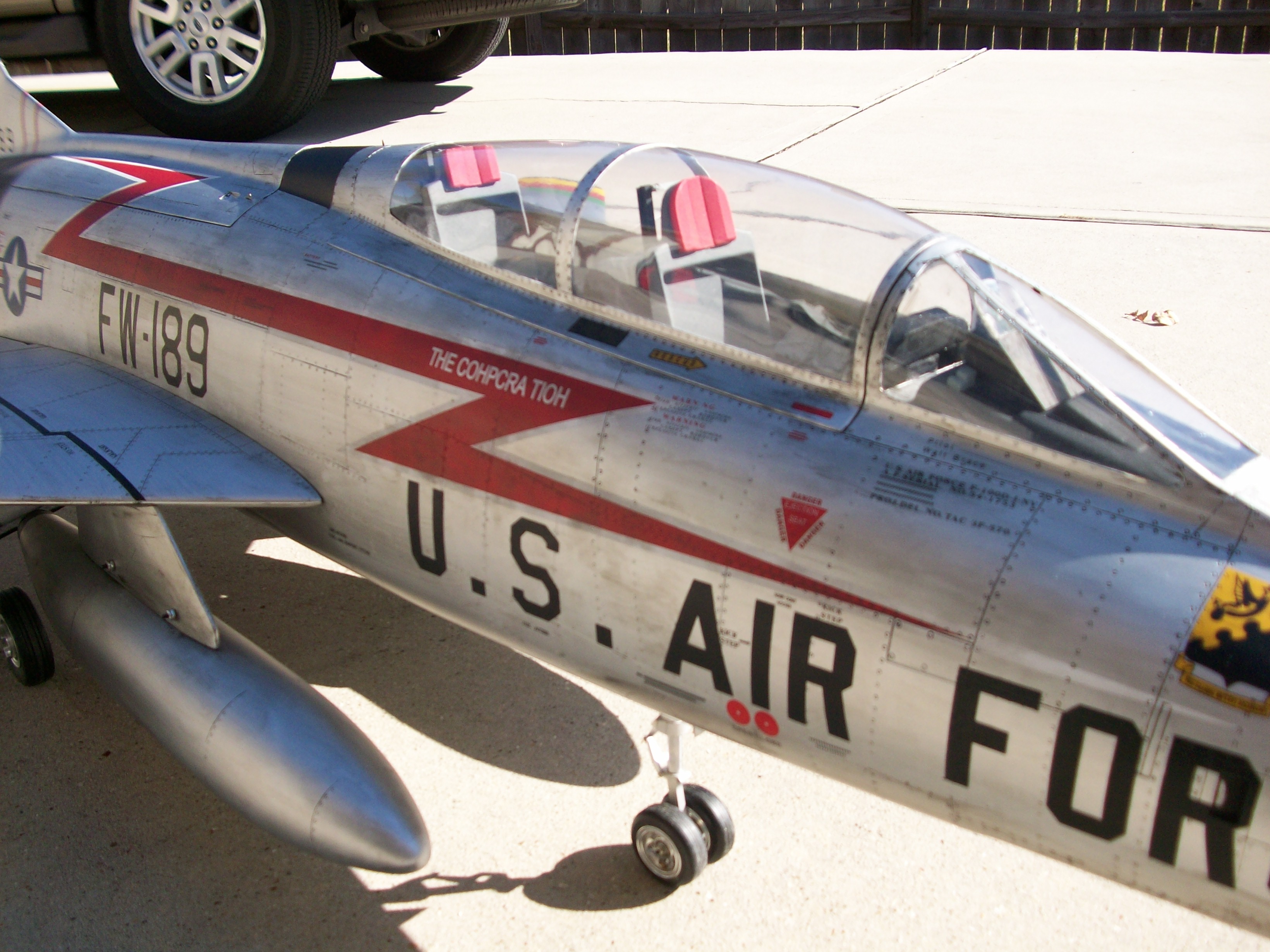

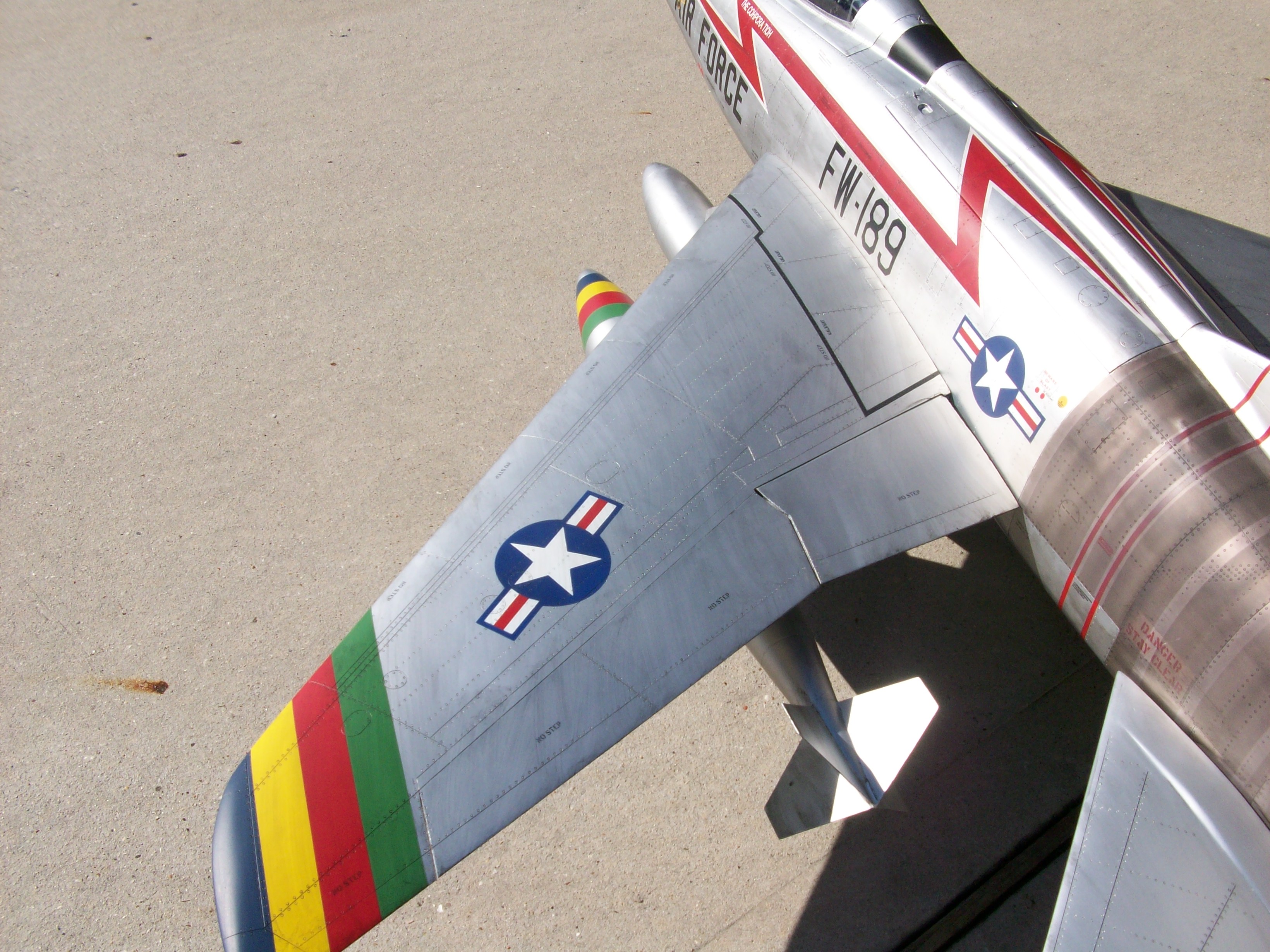

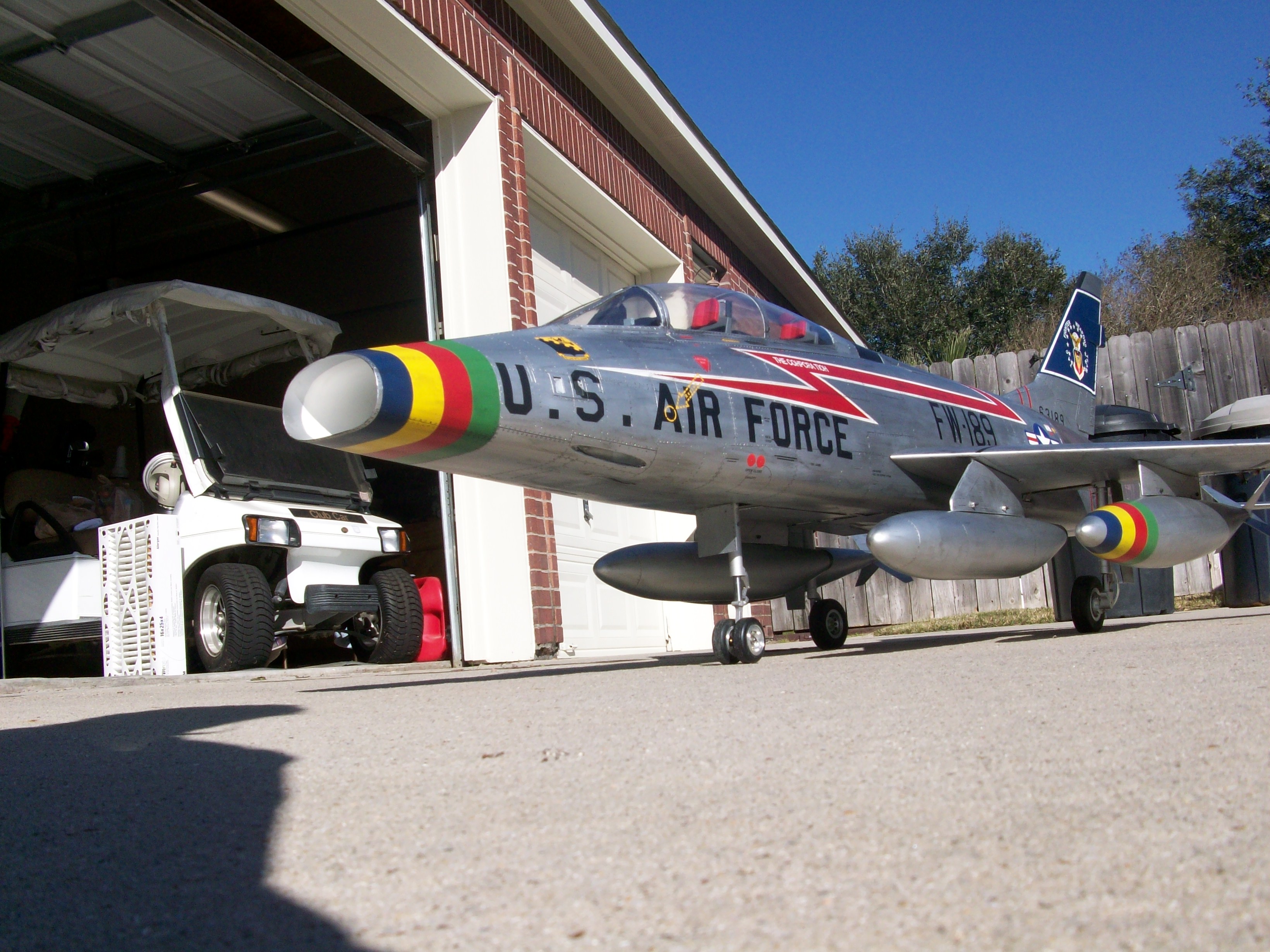

This thread has some detail on the weathering of My BV F-100.. My first real scale jet! From the bottom of page 3 on. http://www.rcuniverse.com/forum/rc-j...bvm-hun-3.html
I used a combination of Airbrush, artist oils, dry paint pigments, and guess work.. I learned a some techniques from the very good RCJI Articles that Sean Mchale wrote.
My subject was a well used Vietnam combat veteran. These plane were dirty.
