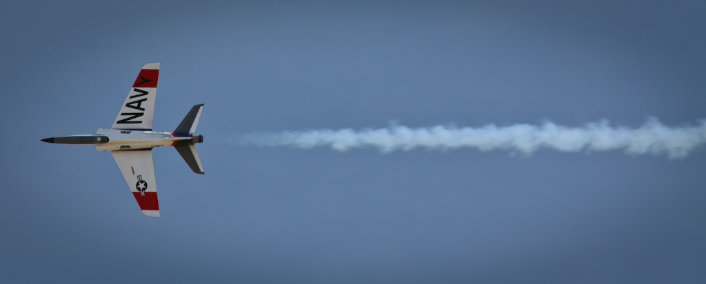

Im going to very respectfully disagree with you Ravill. Tisdall has a Classic BB (possibly my fav Bandit).
Mine weighed in at just 19 lbs with a PST 600. Fit a VT 80 and you have nearly 1:1, which is yahoo territory with a Bandit.
Plus. A light weight is more nimble, more forgiving, and just more user friendly than the fire breathers...
Looks great Tisdale

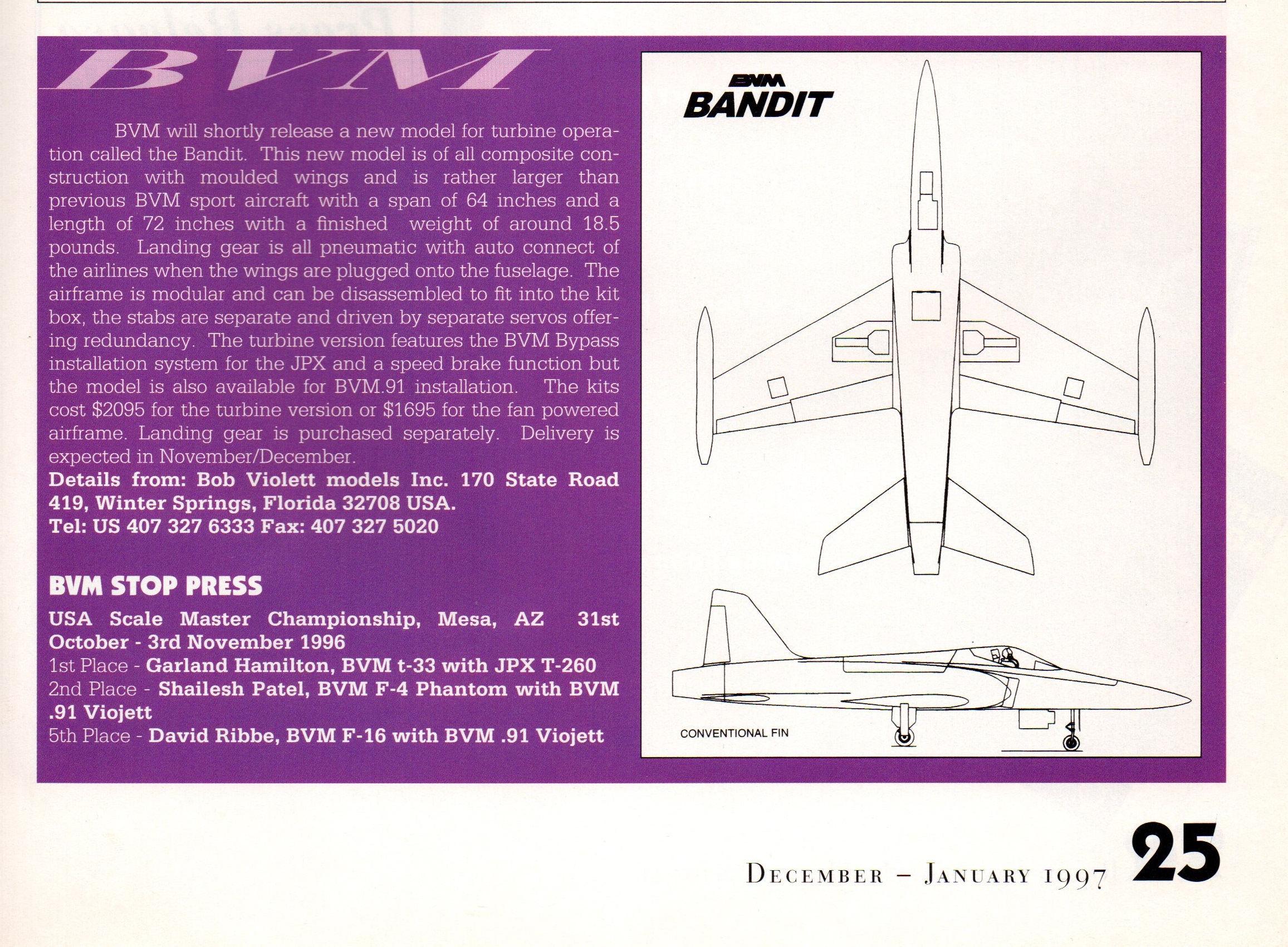

I’m with you all the way there Rav. Bandits Rock.
The original Bandit was first released in 1996!! Way before the “Chinese ARF” movement. It was originally designed for methanol ducted fans, or the JPX 240 flame thrower. Either power plant would struggle to put out more than 8 lbs on a good day, but they still performed and impressed.
In the intervening 2 decades it has gone through upgrades of materials and construction techniques, and one major redesign to the Super Bandit fuselage, but the basic air frame layout and wing plan remains of which all Bandits share. (Excluding the Ultra, which is something else altogether).
They have been fitted with pretty much every engine on the market from Wren 44s to P180s. I have heard of a Munts M 200 XBL going into one!!
BV got it right with this model .

We should remember the original Bandit flew on JPX power, which if I remember right made about 10 pounds of thrust on a good day, if you were lucky.
