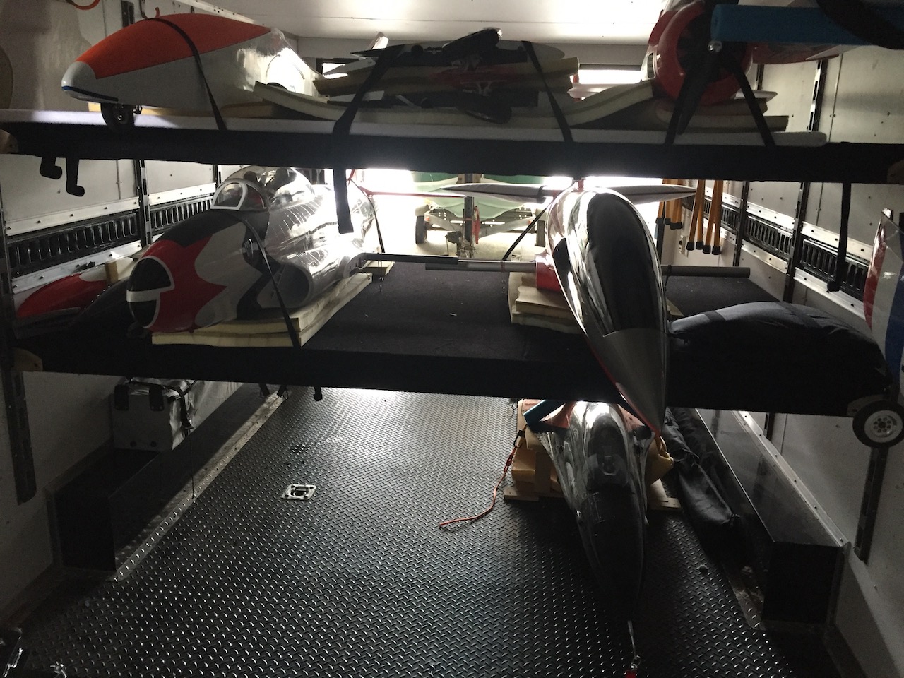

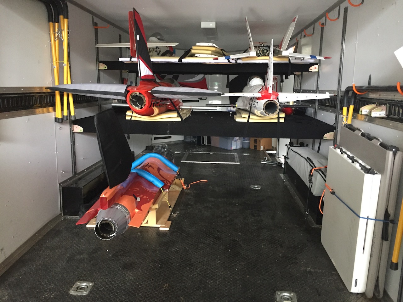

Covering the shelves with the fabric that likes velcro is great too.

Bob, Like your trailer.. good setup.. If you leave the spars in the jets for transport, you can also velcro the jets down by the spar, thats the strongest point on the plane.. fyi.. I used to do that with my kingcat.. I had a cutoff spar that I slipped into it... Nice trailer

I went the extra mile years ago for my trailer , I installed the Happy Jack bed system like you see in the toy haulers . You can raise and lower the beds for your needs and the jets are tied down and riding on bed mattress. So far lots of miles and no damage . Terry

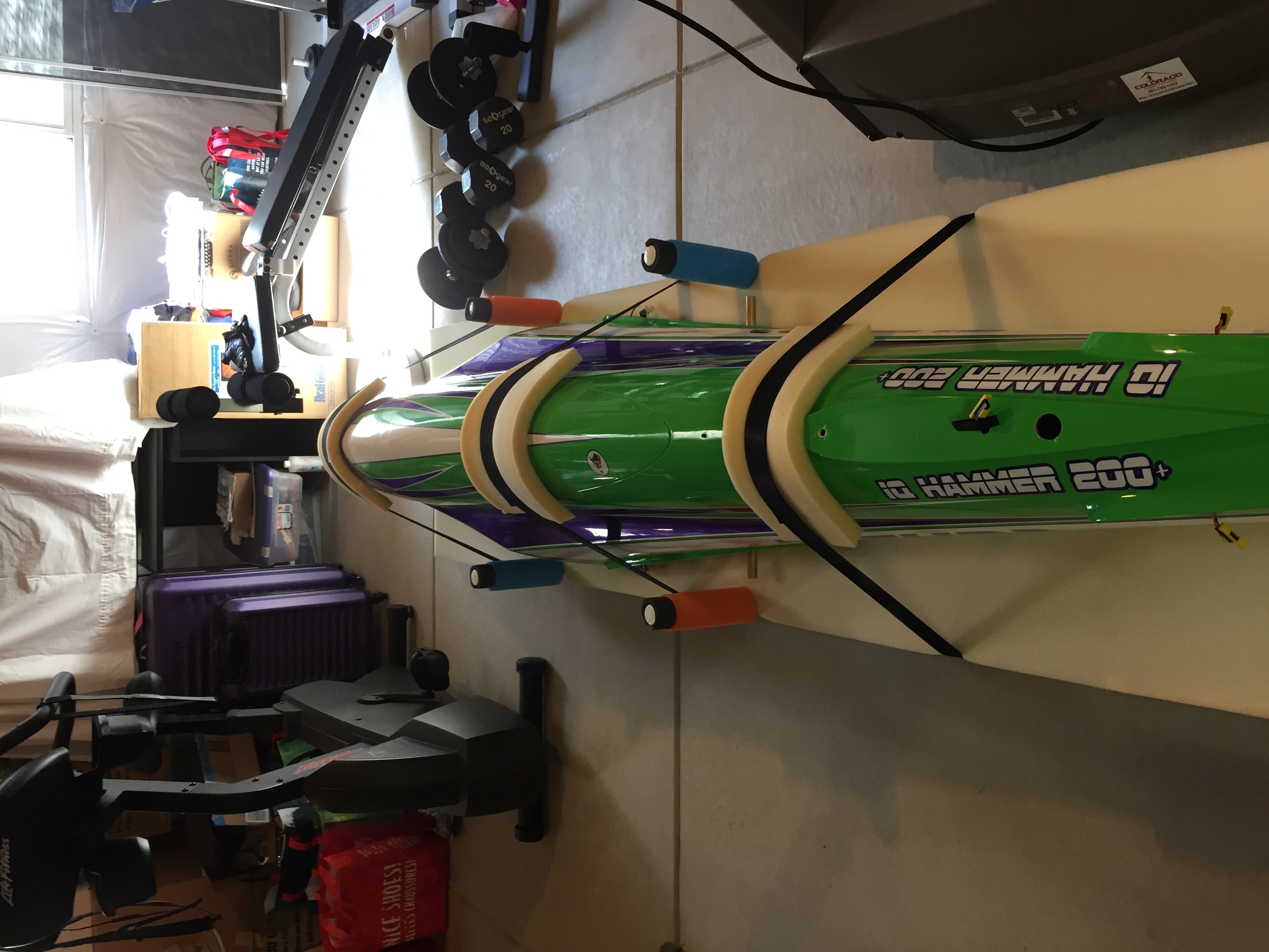

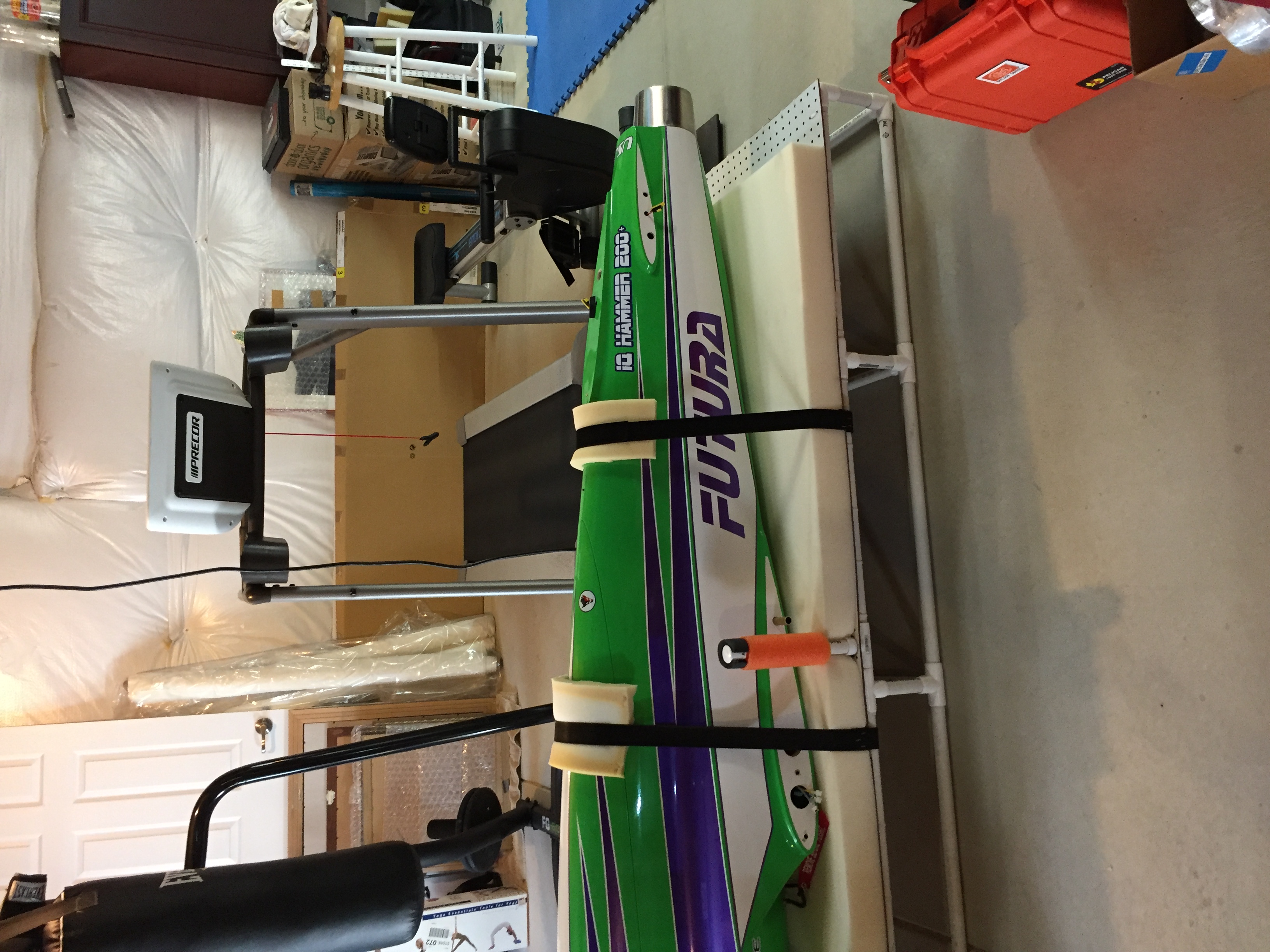

I plan on using this platform to put in my trailer and then remove at the field and place on a table for assembly. The front velcro is pretty loose over the clear canopy, and with 3" foam under the jet I don't think it should move front to back. This is my first try at putting a jet in a trailer--anybody see any issues with this setup?
Thanks!

My buddy designed and made these but has withdrawn effort to sell them.... doesn't need two full time jobs! Ha!
He has only been making and selling to prexisting customers like Dave.
I will ill direct him to this thread, maybe he will change his mind.

Looks plenty stout. Where did you get the foam? Still looking for a good source myself, currently the best I have is memory foam mattress toppers from Walmart.

Thanks! I got the foam from JoAnn Fabrics, it is 3". They have a bunch of different ones but this was 8 feet long or close to it, and they had a 50% off sale so it was like $25, and I got a pice of 8 foot 2" as well for my Bandit for the trailer. I won't need all of that so I should be able to get the King Cat done as well.
Extra High Density Urethane Foam-3"X18"X82" | Jo-Ann
It was like that one but it was cheaper at the time, so I guess just keep an eye out. You haven't done your profile above to say where you are located so I assume you are in the US?
