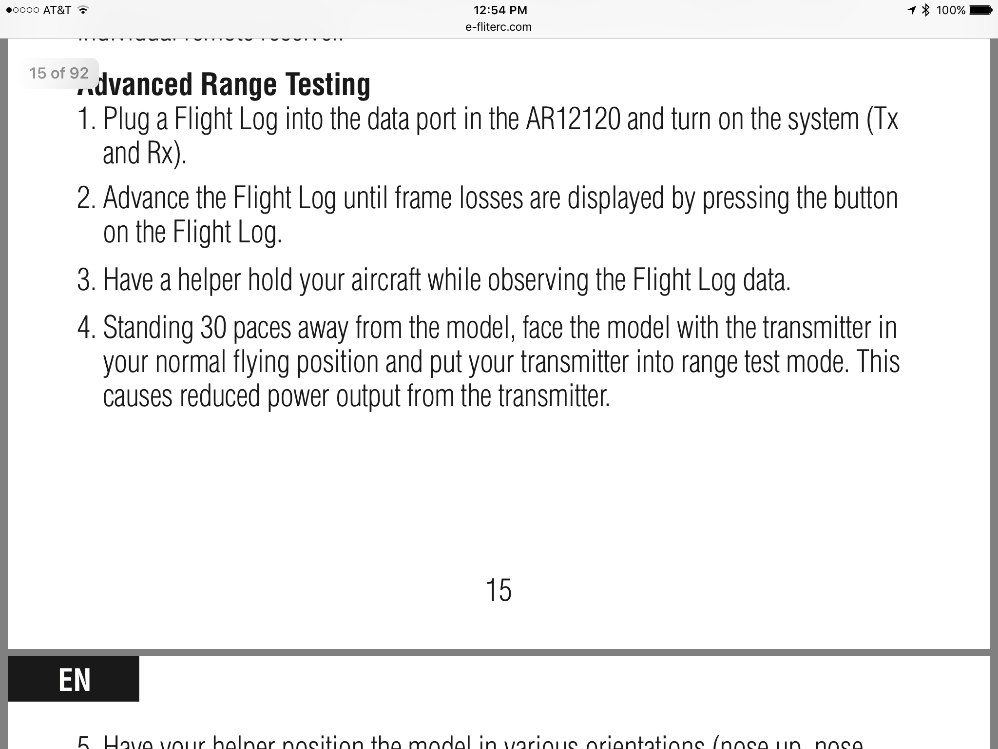

There is a software bug in AR12120's that causes the R satellite (pretty sure its R) to display the actual number of fades incorrectly. If you divide by 256 then that is the actual fade count. I first noticed this around 5 years ago or so and asked Horizon about it and they confirmed this...I thought I had a bad Rx. So, you pretty much have to ignore R. I don't know why Spektrum never fixed this.
At any rate ... per the manual. You should do the range test for 2 minutes total at 30 paces away...1 minute with nose down and rotating in all directions and then 1 minutes on its wheels while rotating it in all directions. See below. If you do the test for 6 minutes then. You may have higher numbers. Note that they allow up to 10 frame losses but I've never had a frame loss on one of mine during range test or flight. I have seen people with frame losses and worked with them to reposition their satelllites to eliminate this.
JS
JS
