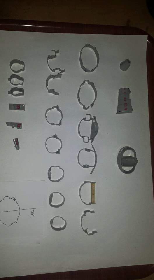

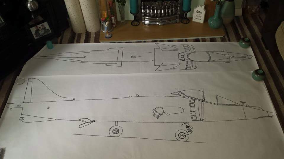

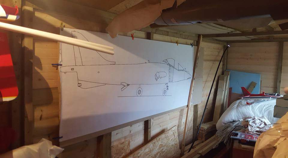

Ok so here's a quick how we got where we are... started with a 3 view diagram off the internet for all outline shapes which was then blown up to 1/7th scale and a 1/72scale Airfix kit.... also had a 1/48 scale kit which was cross secrioned ever 5mm to give me scale frame shapes

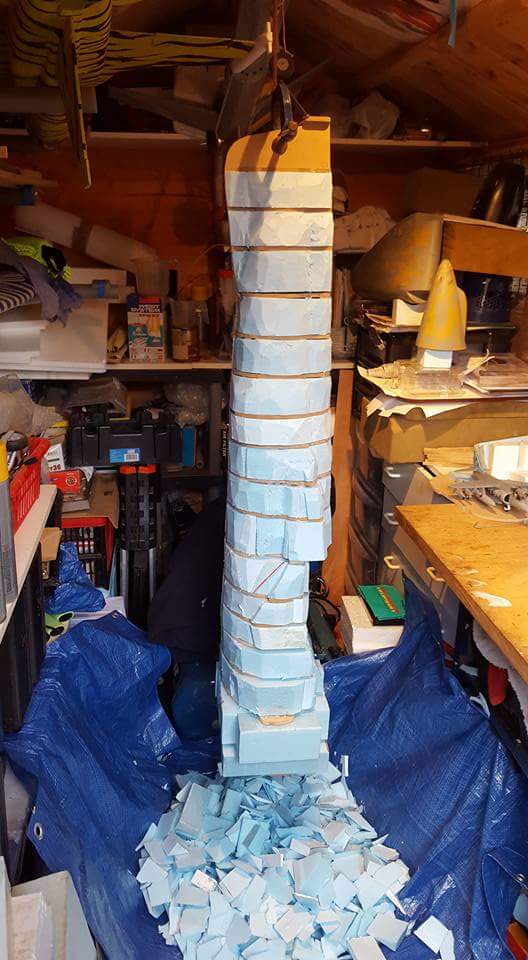

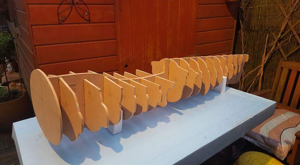

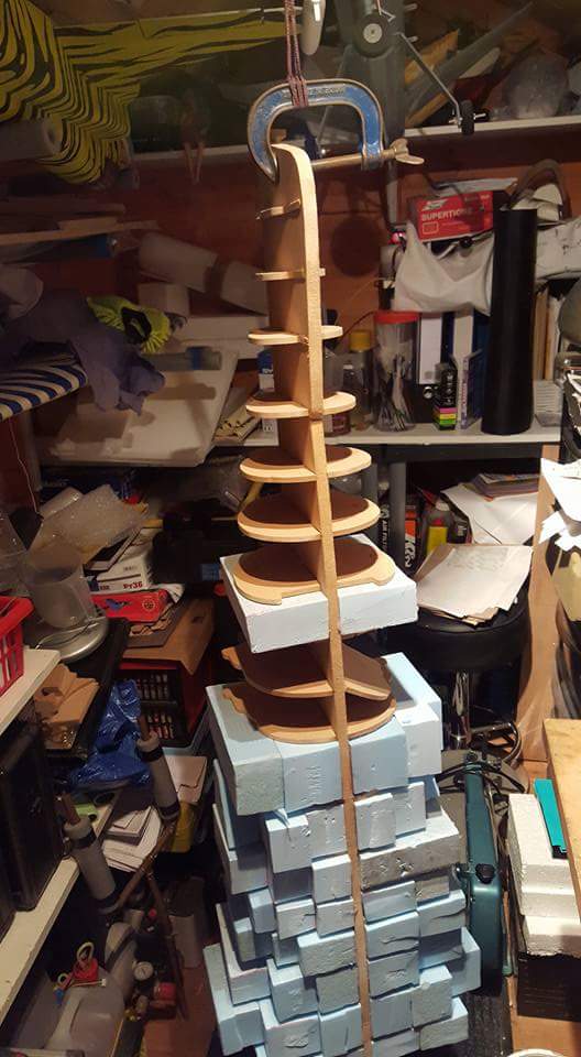

The scale frame shapes were then blown up to size, drawn not and then cut out of MDF board and attached to the spine also made from MDF board. This creates a skeleton of the fuselage which in turn was in filled with blue foam and then carved roughly to shape

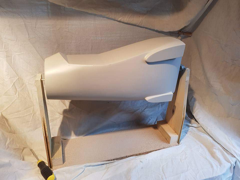

Old 10-09-2017 | 08:50 AM
Joined: Sep 2005
Posts: 124
From: Bradford, UNITED KINGDOM
Fuselage plug is actually made in 3 pieces, a front cockpit plug, a main fuselage plug from the intake rearward and a separate nose cone..... the front cockpit plug slides into the intake area of the main fuselage plug forming a tight joint. I have done it like this as when this model is finished I will be able to go back and make another front cockpit.plug for the 2 seater version as that too will just slide into the intake joint.

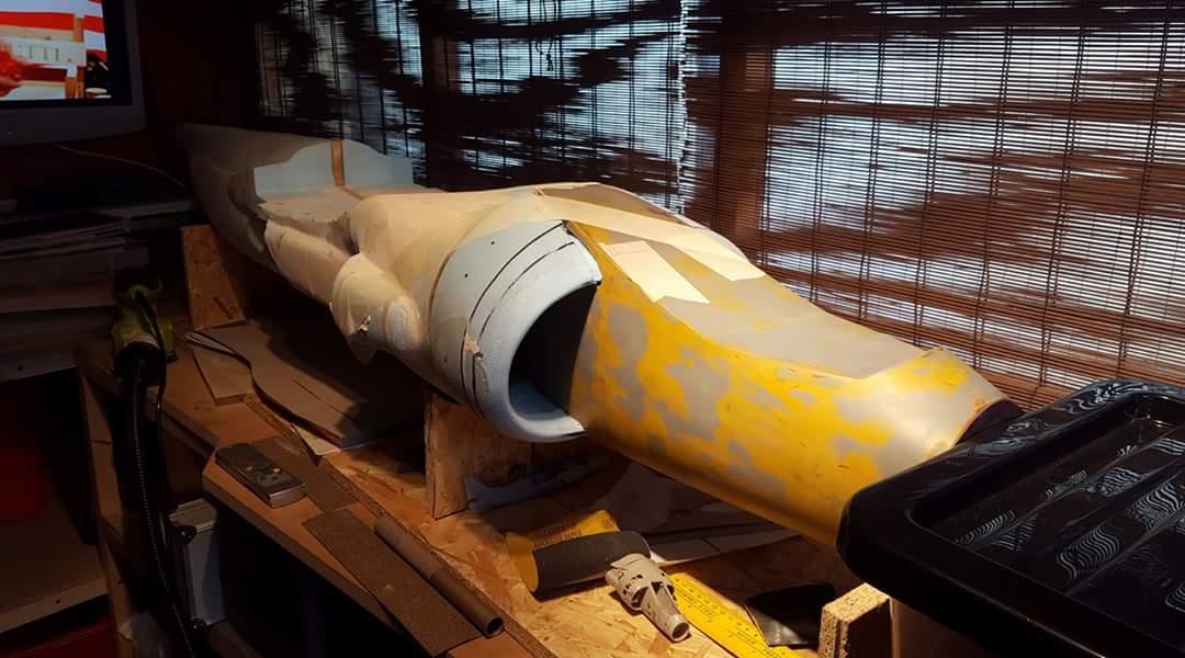

Front cockpit plug has now been shaped and covered in 12oz cloth, rubbed back and first layer of primer has now been sprayed...... plenty of elbow grease and more layers of primer to be applied to flatten it down before applying panel lines and rivet detail.

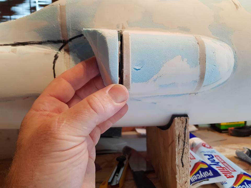

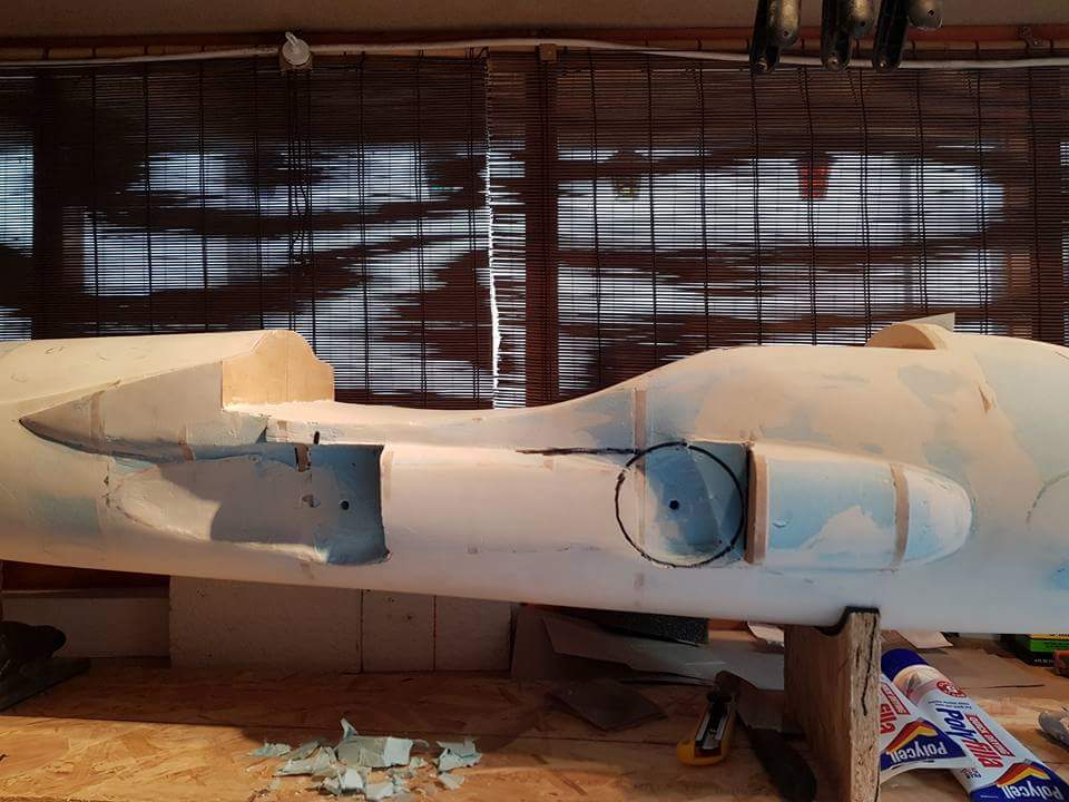

Main fuselage plug is less far advanced in that it is roughly to shape and I am now working front to rear getting the shapes and curves correct before again covering it in 12oz cloth.
