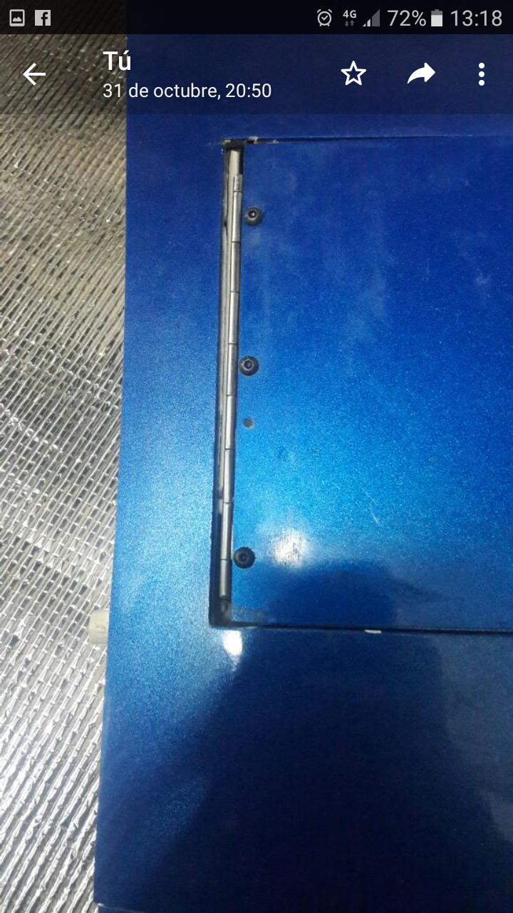

hi folks,
is any one other than me having problem with main gear doors,i have my UL equiped with kingtech k210 and electron retracts and lineal actuator for 3 doors.the only 2 times i flew full power first time blew one door,so i replaced hinge system for a very strong industrial style steel hinge.the second flight i flew it full power one door fluttered,so i reduced power and landed,aluminum control horn was bended,before anyone asks doors close totally flush and closing is very stiff.
any advice is welcome.

Sorry but I don't see in any of your pictures where the Comp/Arf supplied textolite piece that gets glued on to the door. Its for the actuator to connect on to. How is your actuator connecting to the door?
Old 11-15-2017 | 08:03 AM
Joined: Sep 2007
Posts: 192
From: buenos aires, ARGENTINA
as i said before they blew off,attached is how i´m fixing it.

it’s not the hinges that need beefing up, it’s the actuation horn leverage that needs increasing. Post a picture of the angles you have on the actuator ram please

Dave.horn geometry is ok .lever is a little closer to hinge point due actuator is 25mm stroke not 30mm as original.

Change the drive point so that you have more leverage (longer moment arm) in the gear closed position.
You might need more throw from the door motive force (servo, air cylinders, linear actuator) but that is the breaks
