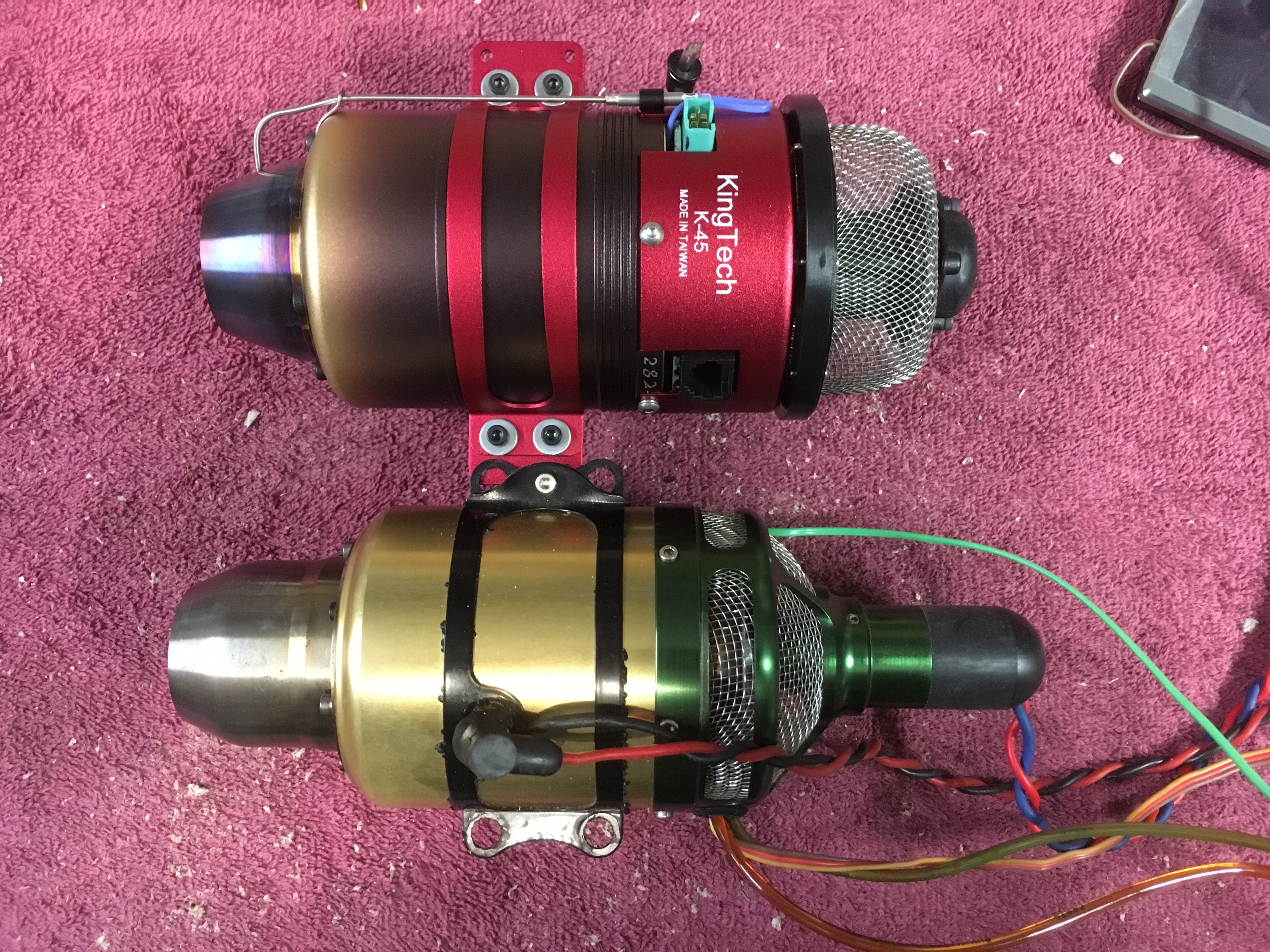

Not a chance. The tail cones are different sizes, and the wren pipe is a diverging design. You almost need a "60" sized pipe.

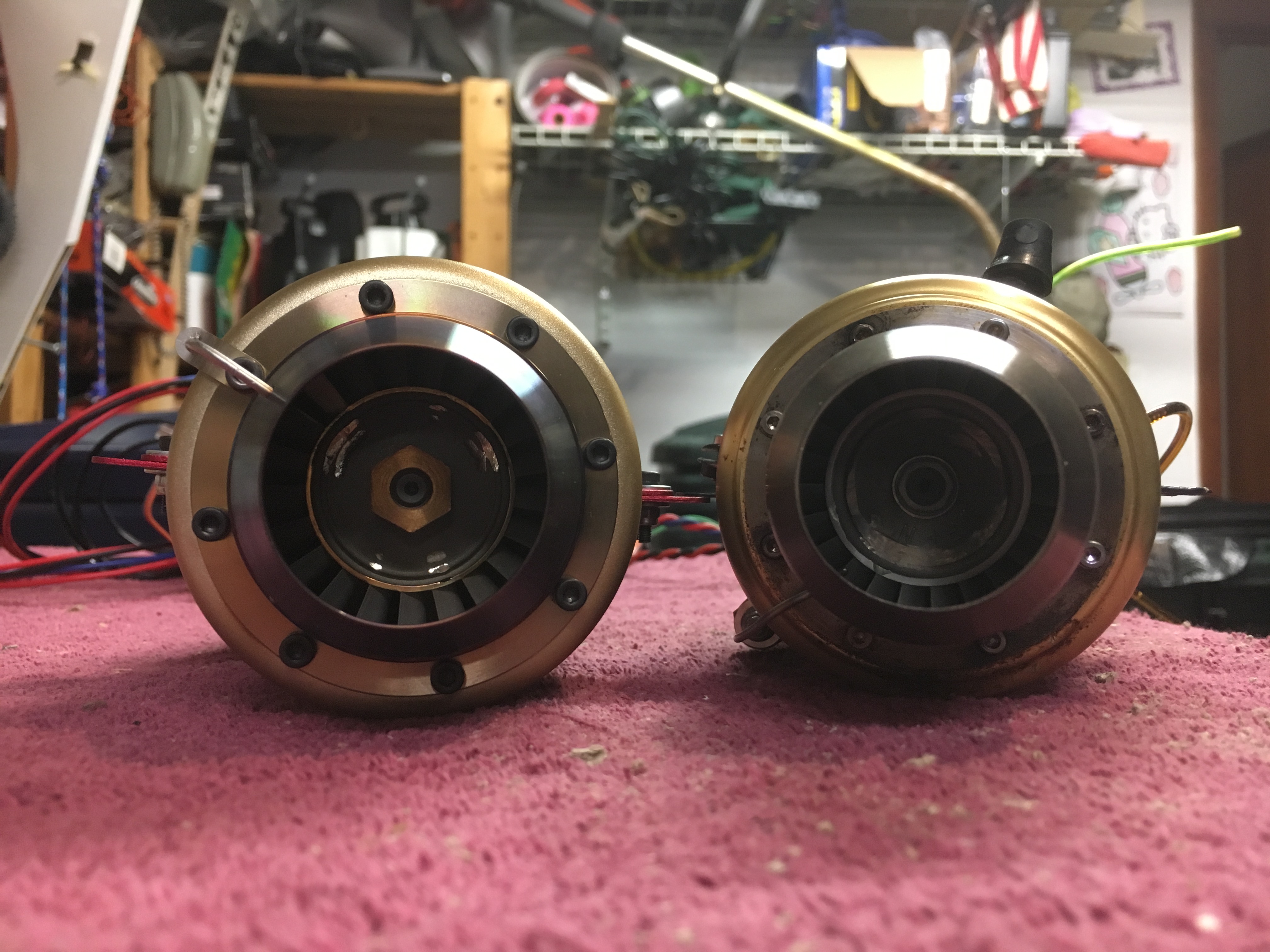

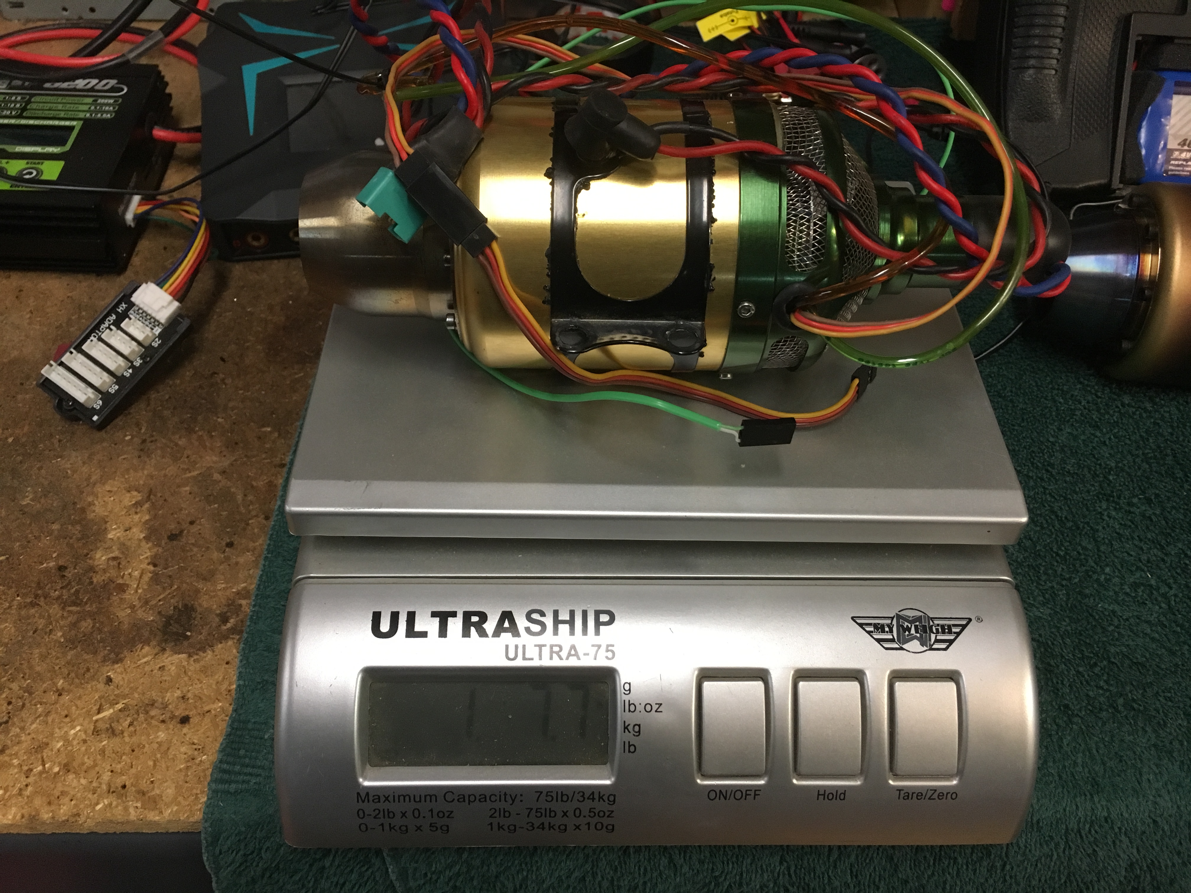

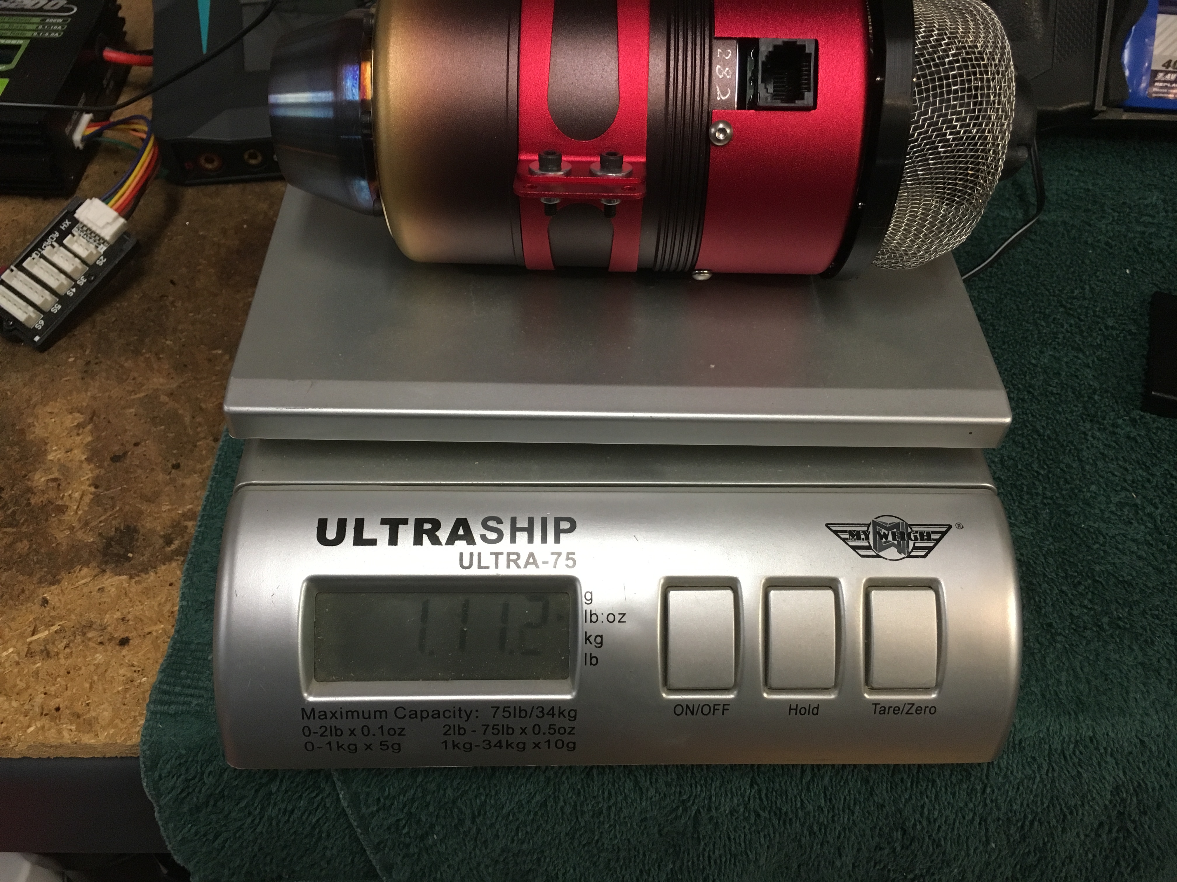

I'm not sure what you are asking/saying with the "1mm" comment... but the K45 is MUCH fatter than the mw44. The K45 is shorter. Overall... the K45 is a heavier engine on it's install. AND... Kingtech changed the ECU and now it needs a 3s Life battery. (hard to find high current LiFe, so the required ecu battery is bigger too)
In the purest sense... yes... the lower RPM of the rotor, and the larger nozzle on the K45 will produce a lower velocity, and in theory, could produce a slower flying model. But you have to remember that we are dealing with velocities upward of 1000 mph coming out of a small turbine... so it's really the drag of the airframe that will dictate the top speed of the model. SO... on a very slippery model... the 44 MAY be faster.... but on a draggy model... the k45 may be faster. But, without a radar gun, and someone willing to swap engines in a couple different airframes... who knows.
As a final FYI... the K45 is a great running engine, and I would recommend it to anyone wanting to get it... but I was a little disappointed once I got it into my hands, and put it beside my wren. (I've stuffed my wren in some small models)
Once a get the kids off to school, and I get some coffee into me... I'll measure the nozzles. (I did it before, but don't remember what the sizes were)

OK.... 1mm on the od of the can. But still doesn't sound right. But, OK. (can't get a good measurement on that since they are mounted)
I was able to get calipers into the nozzles, and the wren is around 32mm.... and the K45 is 38mm. With that info... I guess the wren pipe could work. Just a little less room for error. (it's in the low 50mm range in the bellmouth)

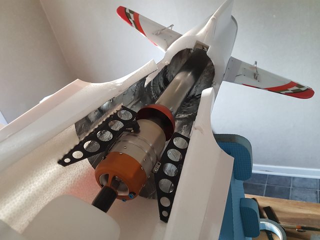

Don't remember, it was for my Victory race jet. Now flying it in the Super Viper. 11lb including 9min of fuel LOL. I can check both lengths for you later today.

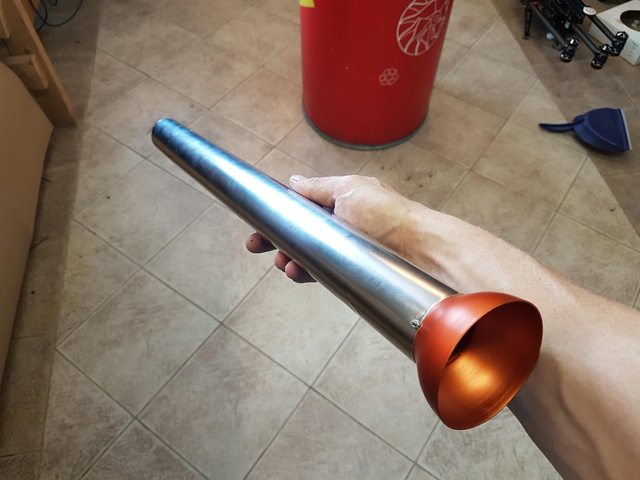

The Wren diagram suggests a pipe inlet diameter of 1.5x the turbine nozzle diameter. Would that be a decent ballpark figure for all turbines or is there more to it than that?
Gordon
Seems resonable. Remember the setup is tuned for an all round maximum performance. testign static is only just static. I have seem pipes implode as speed as they were too big. Pipe size, and air inlets need to be tuned for the speeds you expect. I'm not a wiz at it but doing some basic testing usually gets you there - and often way of the standard charts.
