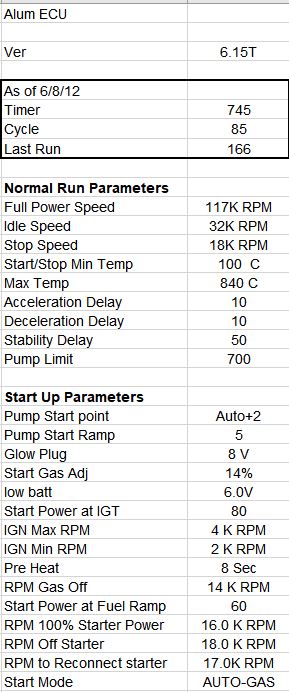

I have an older but new to me gas start Rhino with a new ECM that is having an issue starting. Could someone share their gas flow setting or the factory default.
See attachment for the ECU settings that were in my Gas Rhino when I had it.
That’s exactly what I needed.
