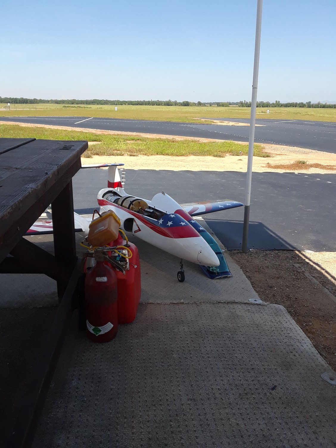

Here, a chilaxing afternoon at the flying field

Nice! this is your club? some times I think that life that really matters is at this places. This is ours, last weekend.

Now that I'm not driving, yes, that is my flying field with new petromat, the only other member today at the field was a pattern flyer practicing his new sequence, just the two of us all day.

Cool place Carlos.. crosswinds arenīt a issue there!
