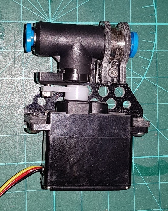

....or do it the HAB way.... €10 [email protected]
Automatic fuel/smoke valve for servo control.

thats a nice little setup you have there. Did you make the mount?

Thanks! It's done by my local hobby store HAB. They have a router and make CNC G10 parts. This is where I do all the conversion kits for turbine foamies. This holder is designed and made at HAB for either HS81 or HS65 servo at the moment. Many people add a manual shut of valve for extra safety as they don't trust the solenoid. Then they forget to open it and you get a disco inferno when opening the valve half way through the startup sequence LOL. This is used via a mix in the Tx to open automatically when you arm the turbine.
Those who like it just drop an email to [email protected] for details on ordering.
