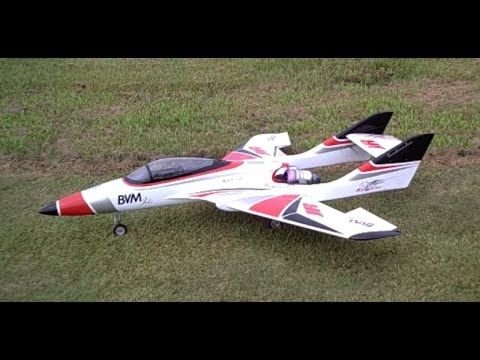

question l have a dv8r new to me with a jetcat 80...plane flys flys good for what it is an the engine it has..the issue I'm having is a half to below 3/4 plane flys straight an level at full power she climbs...now l guess l could add a mix of down elev to solve that..but can l shim the engine...to avoid the problem almost like the ziroli turbinator like to climb at full until a thrust angle change was done..do l do the back or the front of the turbine...

Front, you want the back of the engine to point down, in flight the engine will push the plane down to keep it flying level when more trust is applied.

The DV8R is not blowing gasses under the tailplane like the BC you show, that’s the main reason the turbine is angled down on that, but it is still the front of the turbine that needs lifting.

Agreed, pic is there to show the engine angle.
You may end up needing about 1/4 inch up on the front.
