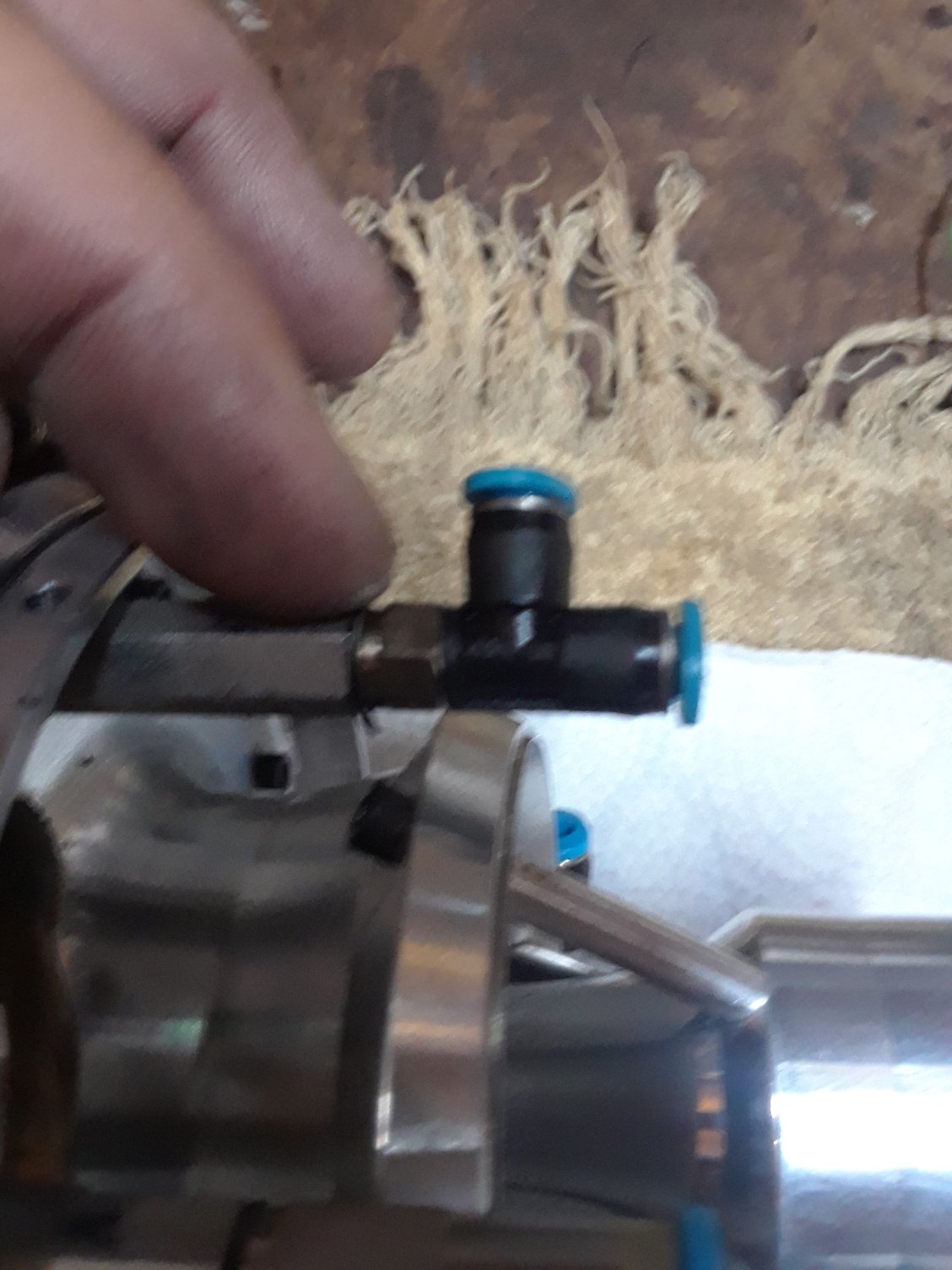

The starter problem was more than just a grommet swap. I noticed the bendix was not moving forward enough, dipped the pump in water the run it for a about 30 sec to clean it, after that the bendix moved all the way forward when the starter was run, replaced the grommet with a slightly different one ( smaller ) and the starter slipping problem is gone.
Moving on to the next problem, I had a flame out on the runway on TO the day before our jet meet, today I was able to start the engine normally and after a few runs at high rpms I went for a flight,TO was normal, I got to fly for about 5 min then, a flame out at high altitude, landed just fine.
What do you guys think, I didn't see any air in the lines, pump? thermocouple?

Tank setup, UAT setup, would help as well. Your pulling air from a fitting for sure. Five minutes in and flameout? Do you remember if the fuel level was below the suction fittings? I have seen loose fuel tubing in the tank that eventually gets "soft" start pulling so much air that the UAT just cant keep up?
My Feedback: (7)
Dr:cito I think you are looking at the smoke tube.
I didn't notice any air on the lines at the moment, I've changed a small piece of fuel line near the engine but I will look for any loose fittings.
I started the engine again after a few minutes and all was normal, it feels like air is getting in there some how as mention above, I will have to do a more detail inspection.

It has been some time since I change the fuel lines and checked the fuel system, something may have come loose after nearly two years of flying and is allowing air in the lines, pump PW is normal at idle and max rpms, the thermocouple has not acted weird ( had that one go bad years ago ) and it is displaying ambient temp when the FEDEC is on.
