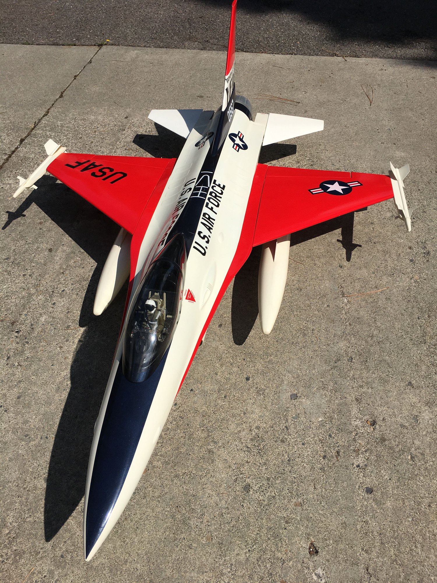

From: Coeur d'Alene, ID
Here are a few pics of mine, older build, still holding up though. Had a pancaked landing in tall grass so it popped its forward formers and messed up the glass up front. That’s basically all that happened to it. Was flown on a Rossi 81 and I was there when it was flown last. Just not enough power, overheated and lost altitude. The missiles and tanks did not fly, just for display.
Was planning an EDF conversion or small turbine but other stuff got in the way.
Best set of luck on your maiden Rick, looks awesome as a Thunderbird!
