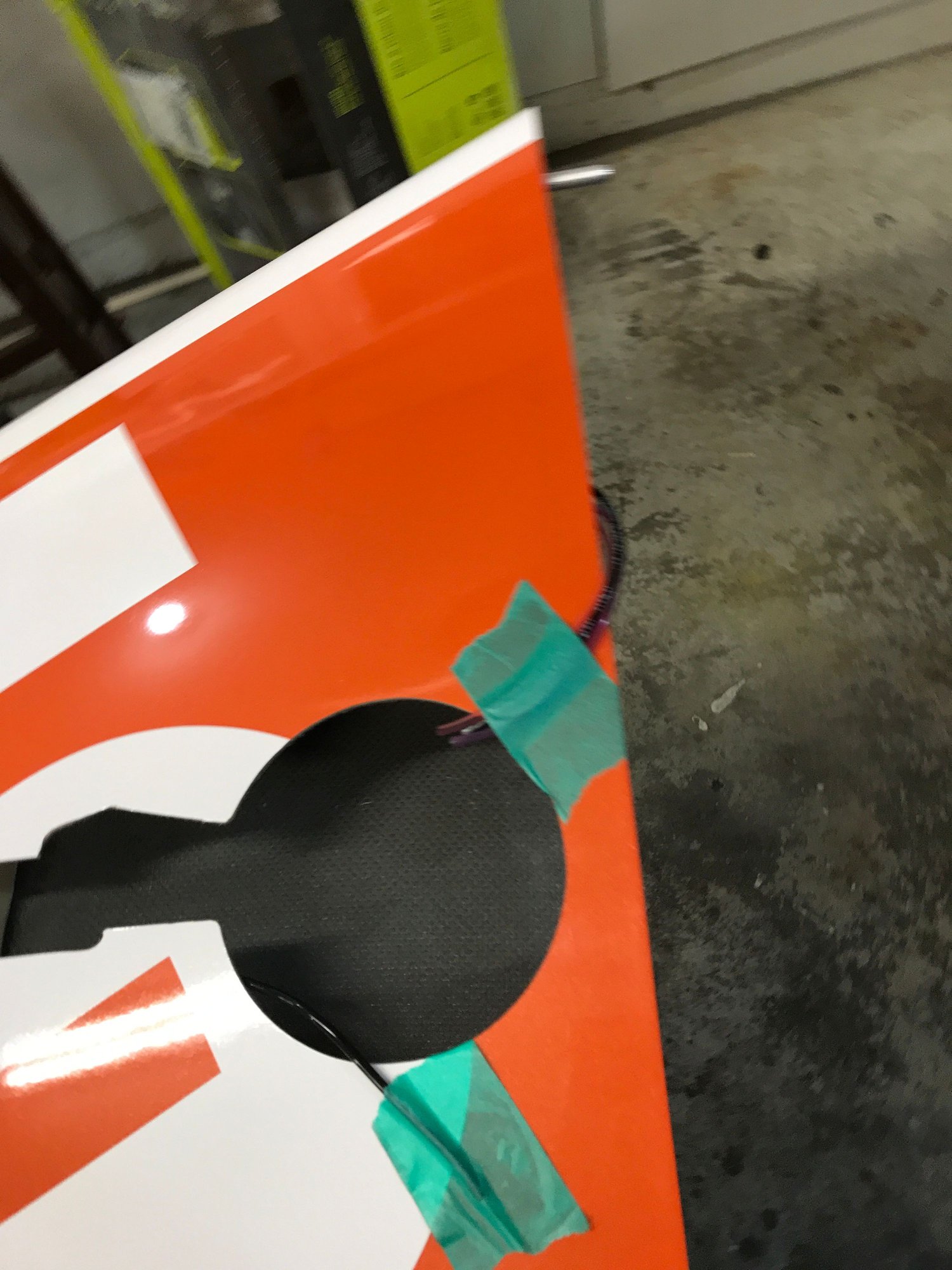

I was able to find a gap between the plywood former and skin to fish son servo cables,and I did all the heat protection tor the tail cables there one hole to make.

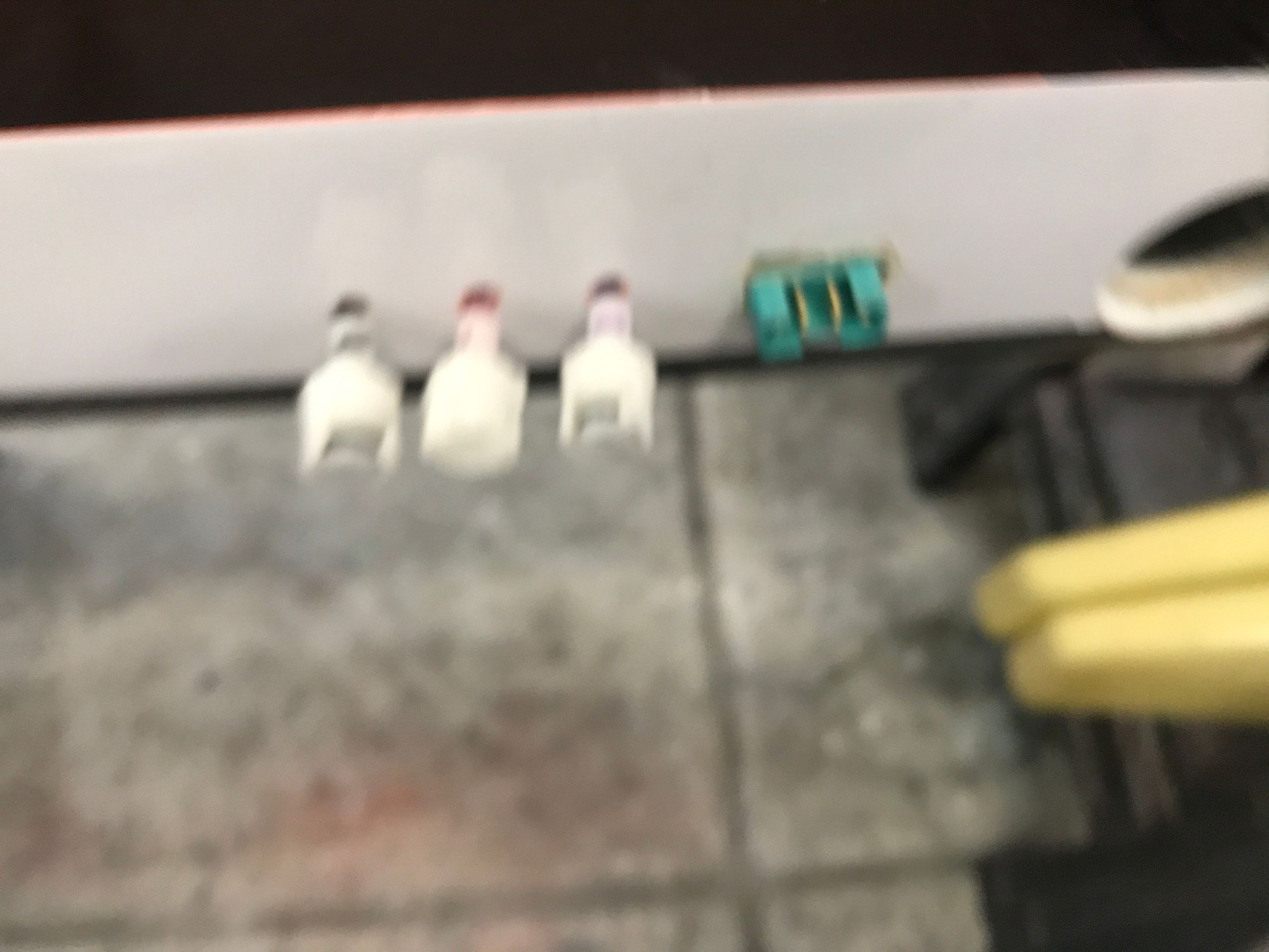

So not much today just fished some power cables for the rx and turbine ecu ,the 12 gauge for the ecu and 14 gauge for the rx ,they need to be made the ones I have from aviation design are way to short 💩 so not so happy about spending the money on something that doesn’t work.
