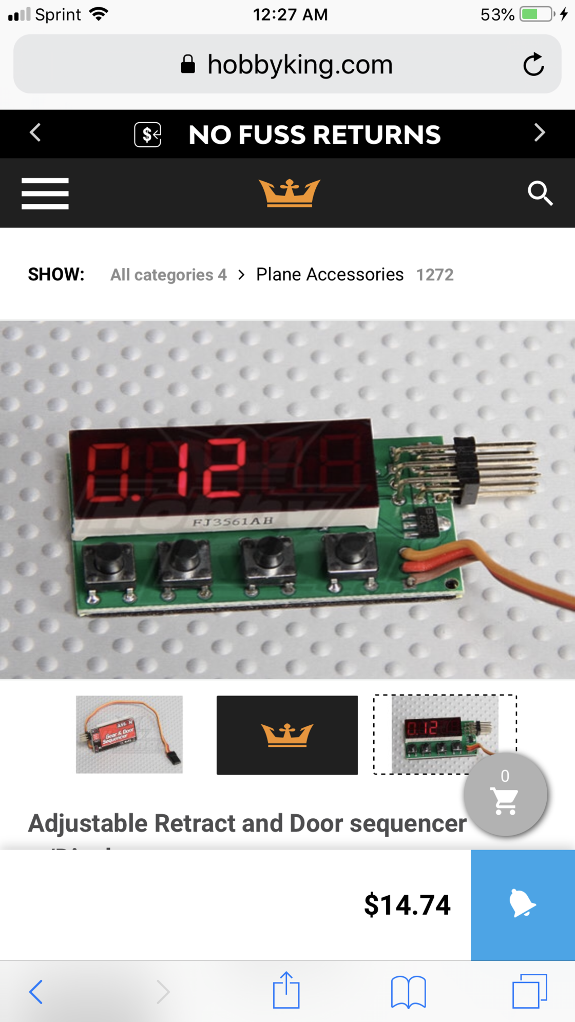

Maybe you should dibbled cylinders,I have one sequencer from hobby Kong and ther so many options to program specially for servos operation,you could program almost every thing the throws and delay and cost about $12 ,actually I have one in my feibao t-33 this was the only one I could use 4 servos separately and program so the center gear doors stayed closed after each gear rotation.
