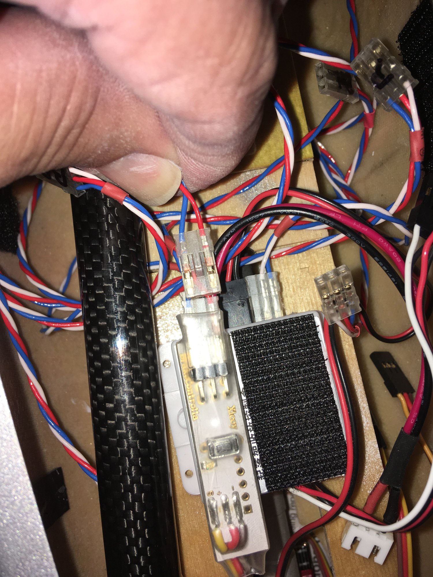

He’s referring to the stand alone brake controller. When you activate the brake function a blue LED lights up.
You have to replace the plug that comes on the JP brake line with a std servo plug.
The red wire goes where you normally would see the signal wire in the plug. That why I told him to match the input power.

The blue light gets brighter as I move slider switch but nothing works I did not get no instruction with Controller my question is how do you plug in I think I have tried upright side ways there is only two wires coming off each wheel ?

Pic
Old 09-15-2019 | 09:07 AM
Bob_B's Avatar
My Feedback: (11)
Joined: Nov 2003
Posts: 4,773
Received 96 Likes on 85 Posts
From: Bluegrass State of Mind
Old 09-15-2019 | 09:26 AM

Thanks for help but not exactly sure what I am seeing is blue wire negative, red wire positive and are they plugged sideways ,is that a different plug ? Why did you separate wires ?

The controller is wired with the pos and neg in the two outside servo lead locations. The brake unit has the pos and neg next to each other. Hence you need an adapter of some sort on the extension to change the pos wire. I just moved the wire over on a typical extension and placed in series. This unit only controls brakes. The LC15(?) has a gyro and will pulse the brakes in time with the gyro to make the braking happen straight buy controlling the brake action on each brake.
