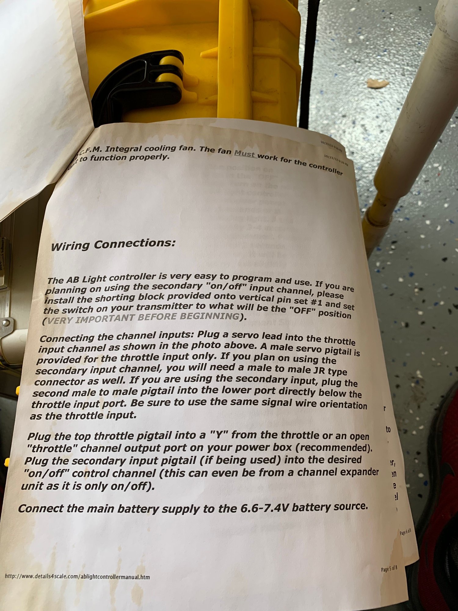

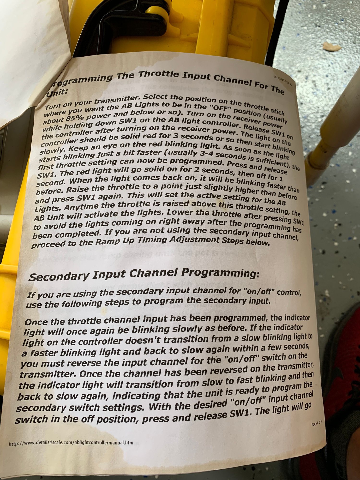

Bought a used SM F4 that has AB lights. Anyone have an instruction manual that I could borrow? Thanks

I had a couple of Details’ lights. But I don’t remember which one. Post a pic of the controller and that might help.
I will I’ll post some pics of the instruction manuals I might have somewhere.

ravill's Avatar
My Feedback: (11)
Posts: 5,720
Received 94 Likes on 76 Posts
From: Granite Bay, Ca
Old 08-06-2019 | 06:03 PM

You are DA MAN! Thanks bunches.
Old 08-07-2019 | 06:45 AM
ravill's Avatar
My Feedback: (11)
Posts: 5,720
Hope that helps!
