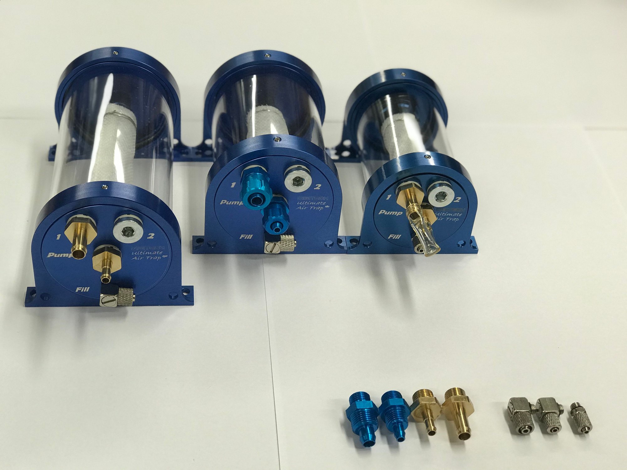

I just purchased a Digitech anodized UAT from DreamWorks. I guess it doesn't come with any directions there are some washers to install the nipples but is one wondering if he should be locked I did and also so not sure if anybody has this tank?
Anyway if anybody has this please let me know your thoughts thank you.

On their website digitech - aerosports . nl (not allowed to post links yet) you find more info and 3D print files for mounts
- click on the pictures of the air trap and one has details I think

As this product and the Maglok's he sells are blatant copies of my products which I designed I can help you here. My D-CAT product required the nipples if they are the barbed type to be fitted using something like Aeropoxy or the Hysol 9462 epoxy, if its a Festo push fit then the O ring seal fitted to the Festo connection should suffice but pressure check before hand.

they go under the nipples , only hand fasten them . no need for a lot of force to seal them.

no need for glue , just a nice festo seal that fit under the nipple.
you can replace the filter , no glue needed.
