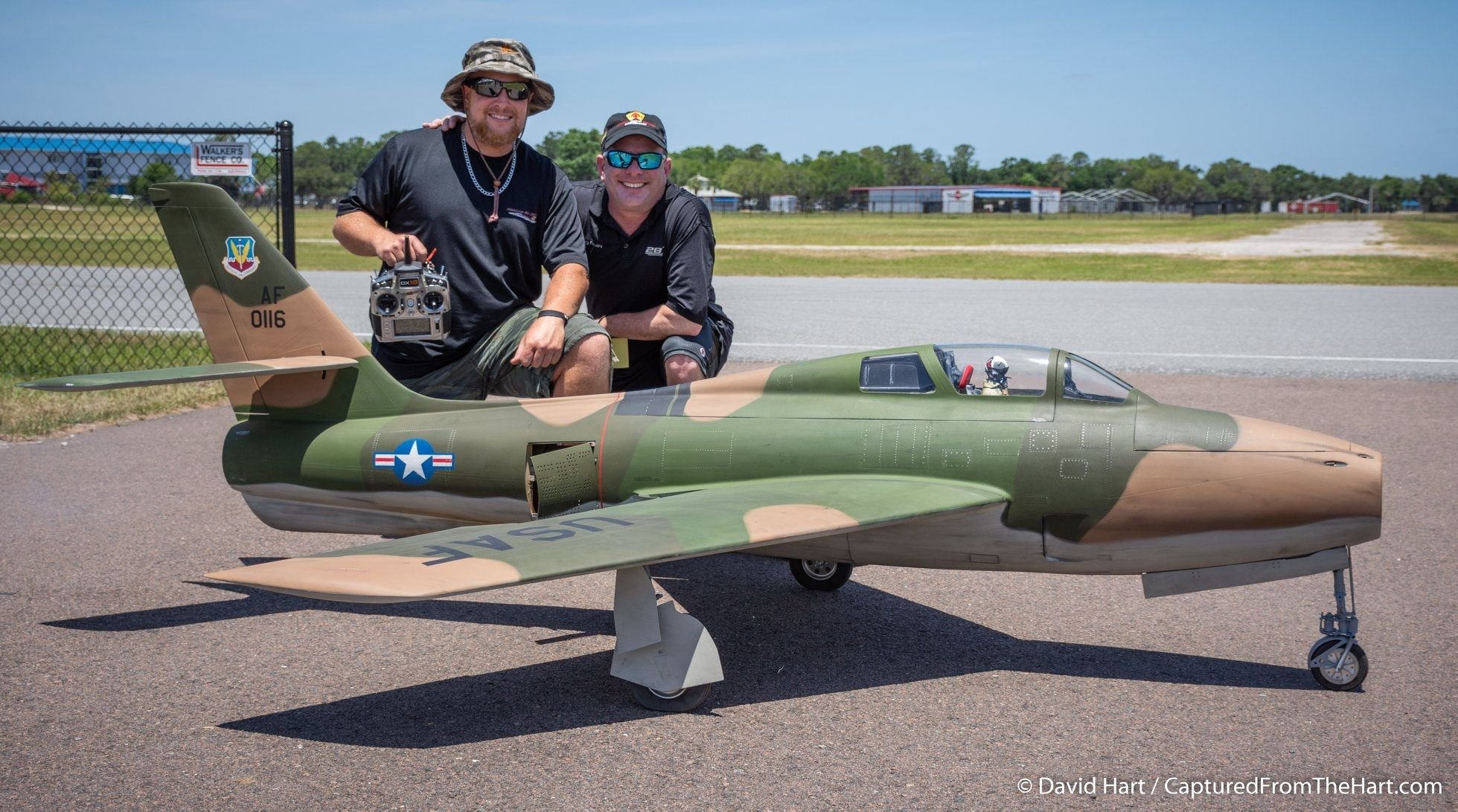

Mirce sets has good rivets and I love using them. Here is a pic of the F84 I built for Barry using his rivets. Note this plane was a kit I built... Had no panel lines or rivets. Old school build.....

You guys have great ideas. I think I'll try the Mirce dry transfer rivets, as I'm putting them on a Tamjets A4. I've used Elmers glue in a syringe on kit built models before but will definitely try burning them in on my next project. Thanks for all the replies!!
nsmodelers.rs
Very nice aircraft!!
