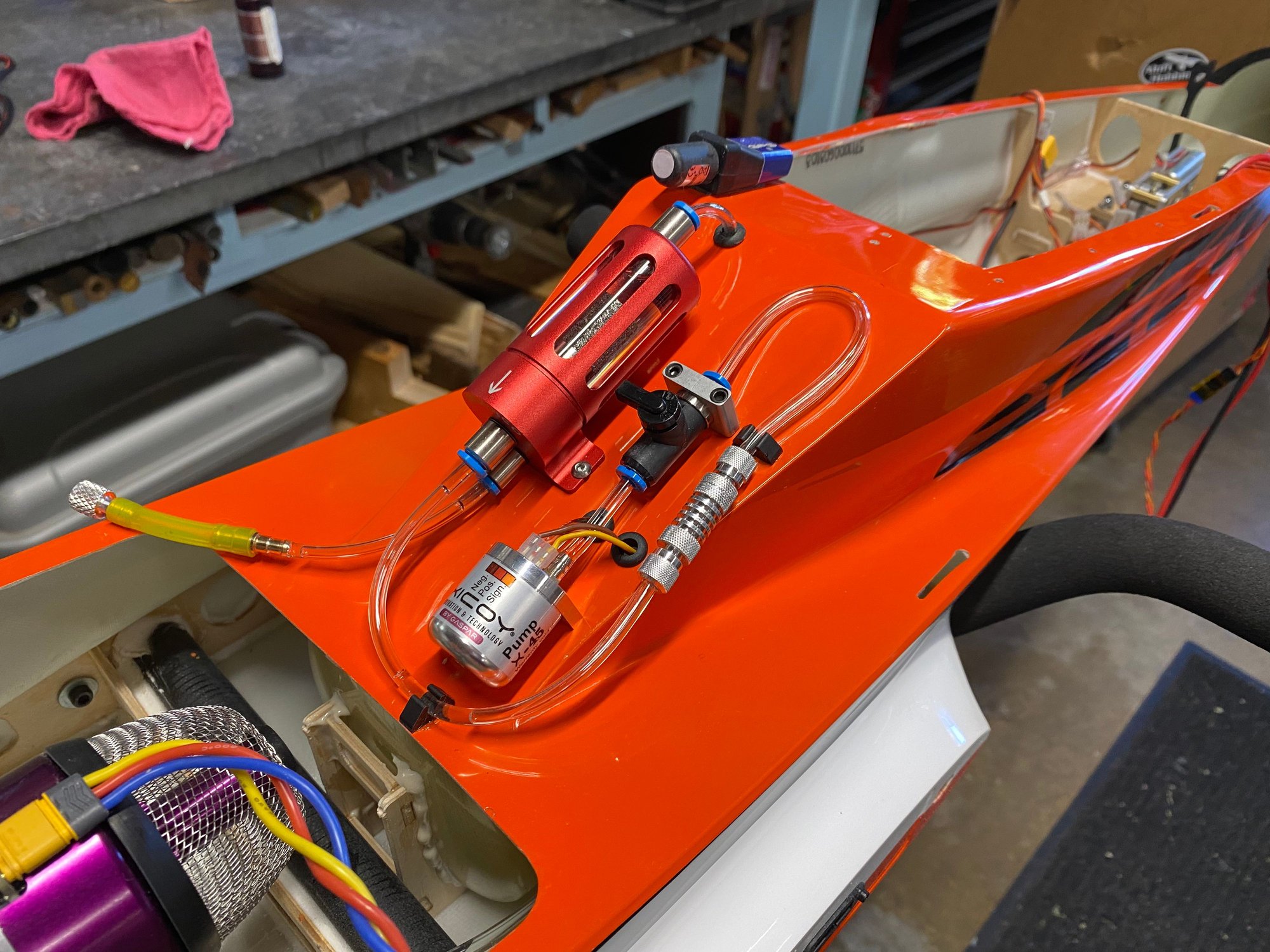

Tip for 1st time turbine builders. The air trap has up and down, the pump connection should be lower than the fill, in the case of the Intairco mini trap. I had mine installed upside down.
The mini trap has a built-in filter. But Intairco also recommends a filter between the pump and turbine inlet. The X45 instruction manual recommends that nothing is put between the pump and turbine. If I follow Xicoy's recommendations then I can eliminate the 2nd filter.
I accidentally got fuel all over my Xicoy interface screen and ruined it. And the airplane was finished and I had to tear it apart to clean the fuel spill up.

the filter between the pump and turbine is to catch any debris that comes off the pump gears...

Page 11 of the Xicoy X45 user manual:7. Run a single piece of tubing between the pump and the engine. Do not install anything (valves, filters, flowmeters... ) between the pump and the engine.
I'm not arguing, the filter sounds like a good idea, but the book says don't do it.

You fuel pick is fine in the mini iTrap.....but obviously it shouldn’t be mounted on that angle upside down ....inside the UAT it’s not really a filter but a diffuser....it break down the bubble....the filter if used should always be after the Pump....

I confirmed with the manufacturer - they recommend the filter be placed upstream of the pump - same as the manual states. Since I don't have experience either way, I will follow their instructions.

Jet Munt : filter before the pump

[QUOTE=Dansy;12645033the filter if used should always be after the Pump....[/QUOTE]
Really?
JetsMunt, I have a100, say no.
XiCoy, I have a X45, say no.
AMT , I have two, Olympus and Pegasus do not have a filter AFTER the the pump.
Might I suggest you follow the manufacturer.s recommendations.
In the case of the superb little X45 Gaspar says NOTHING Between the pump and engine.
He probably knows best.

I had the nerve to write Gasper and ask him what his opinion was about the filter - he replied that the manufacturer's opinion was to follow their instructions.
That's what I'm doing.

Since Gaspar said nothing between the pump and engine, then I’m assuming the shutoff valve is also before the pump, correct? I figured I’d make sure just in case . I know the whole shutoff valve placement is a massive debate.

T-CAT I put the valve between the air trap and pump.
