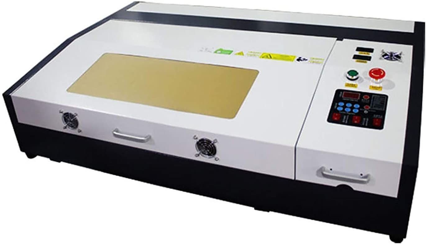

Pat,
I have a TenHigh 6040 50W laser cutter, bought from Amazon. It can cut at least 1/4" ply.
It's the best investment in hobby tooling that I have made, closely followed by my 3D printer and mini-lathe.
If you get one of the cheaper cutters, plan on changing the lens to get a much better quality and more highly focused cut.
I use K40 Whisperer as the controlling software, as what comes with the laser is worthless.

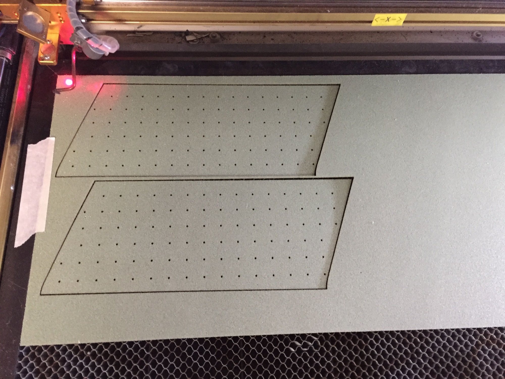

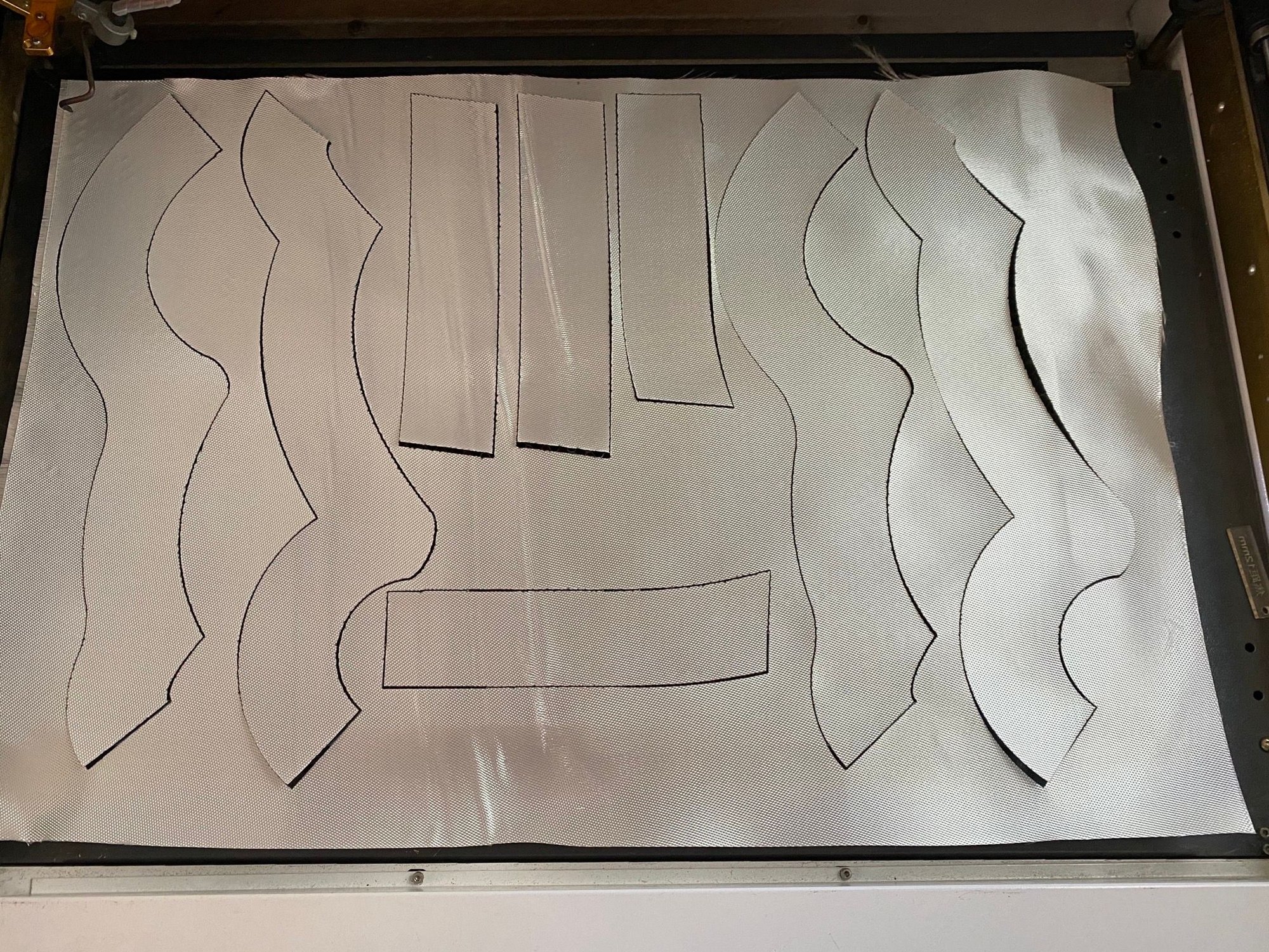

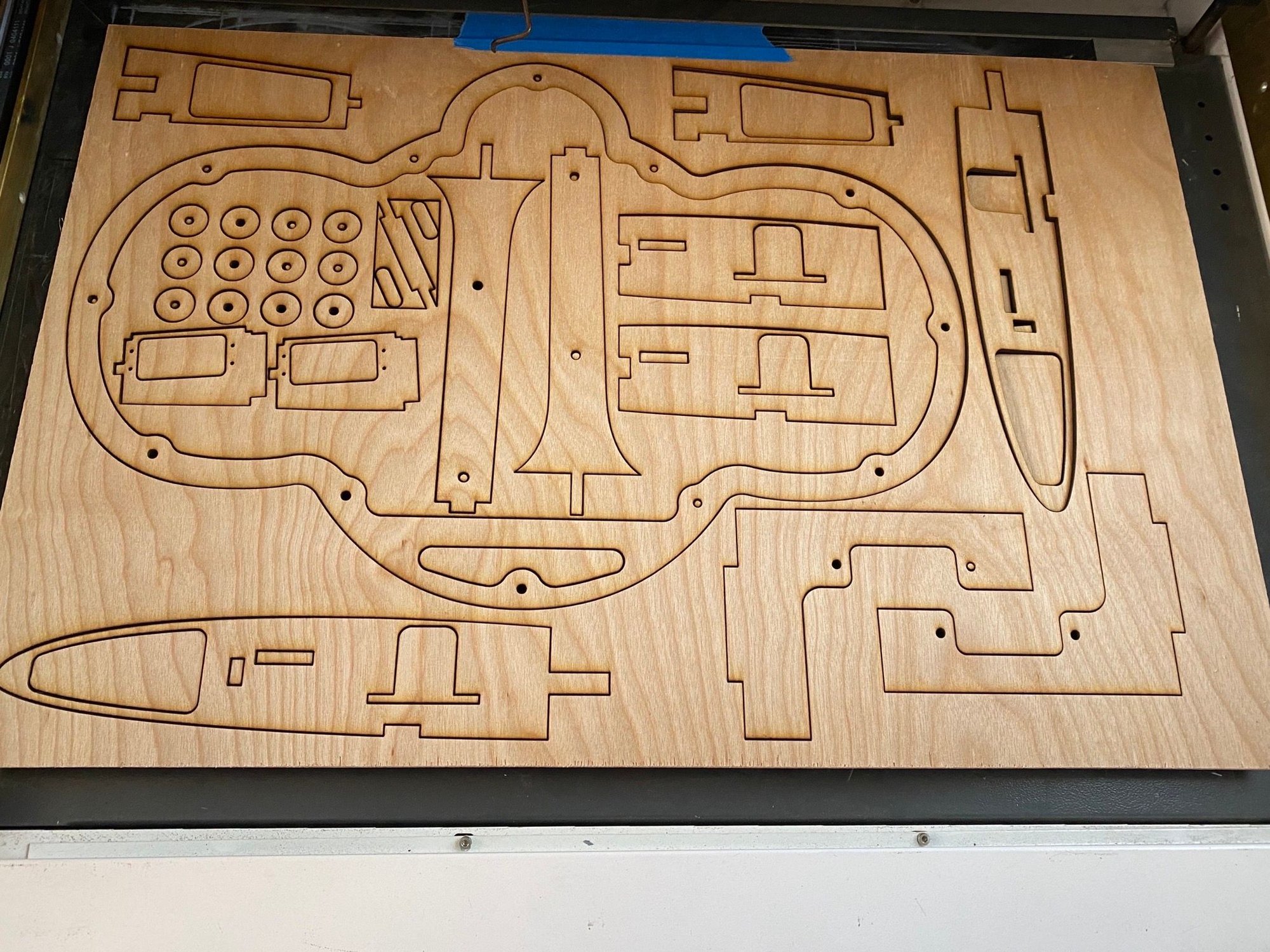

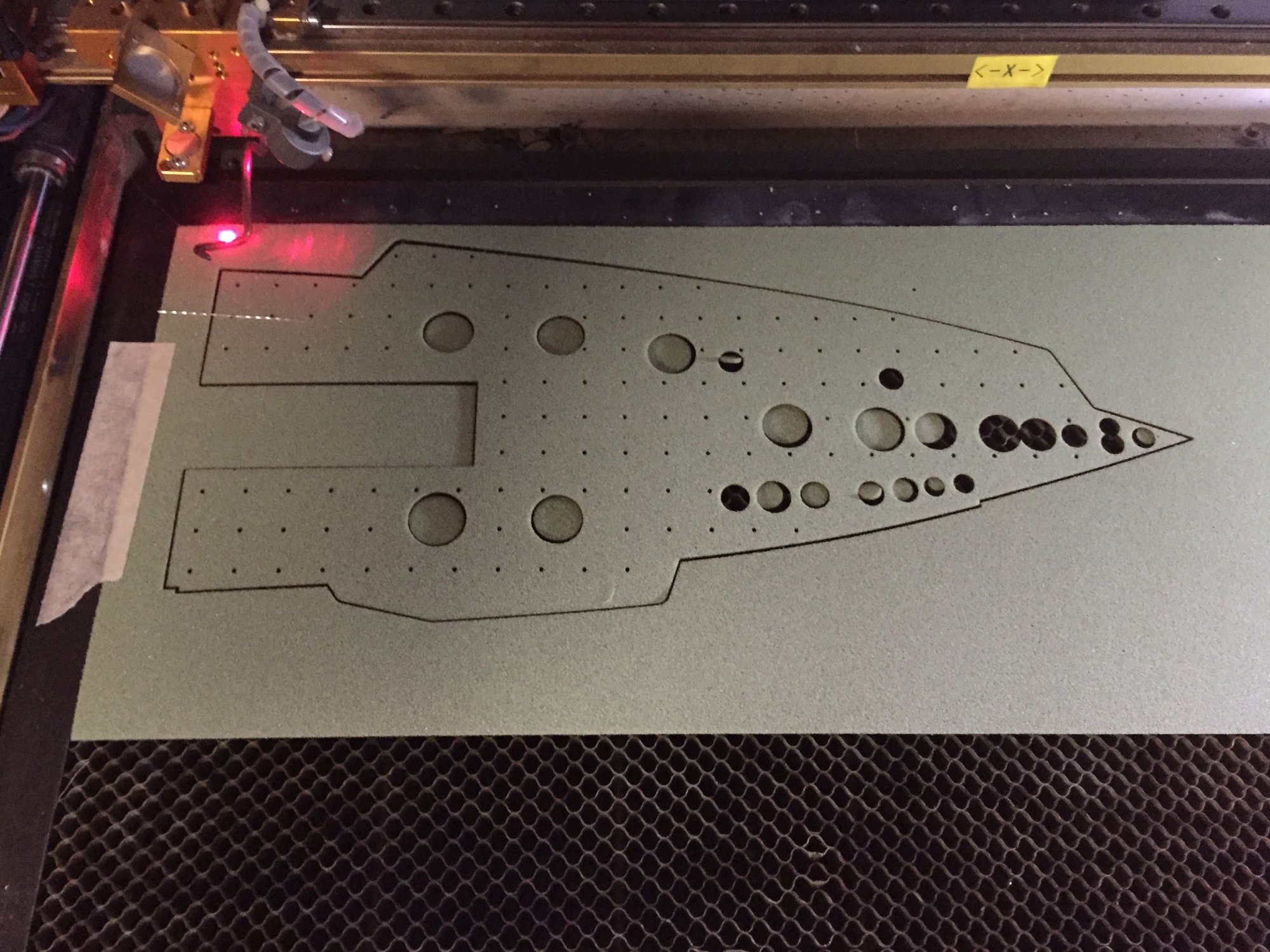

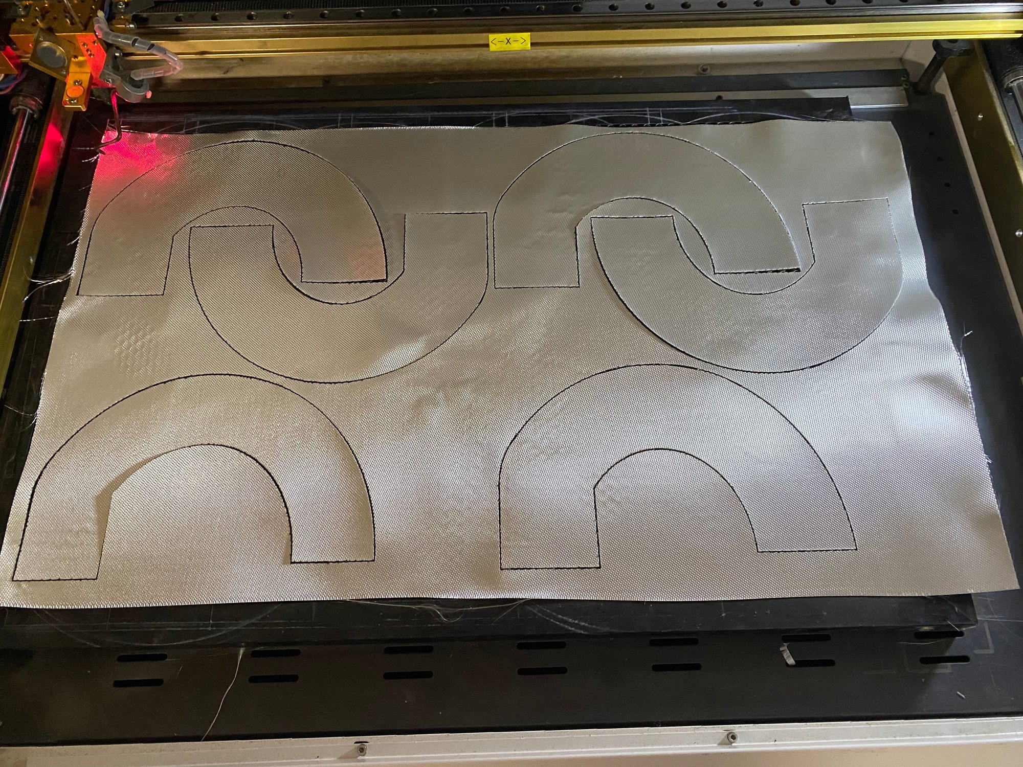

Gary,
A few photos attached.
I have not tried to cut carbon sheet, but I have tried to cut carbon cloth and it doesn't cut very well. I seriously doubt that carbon sheet would cut. G10 doesn't cut well either, it needs multiple passes and gives off nasty fumes.
Balsa, plywood, foam, fabric, glass cloth are my main materials that I use so far.
Note, for plywood you have to get laser compatible plywood. Some plywood will only cut through the first layer and then start to char - this is due to the glue used. Finding good quality, strong 5-ply birch that is laser compatible is tough. One source I had has stopped making the 5-ply that was great.
Paul
I second that. You MUST get the right plywood, made with the right glue, not always easy. It should cut with pale brown edges, not black and charred.
It must be flat, really flat, so I store it flat and dry with weights on top.
My laser cutter was unbranded, Chinese-made and bought from a dealer in the UK, so I can't help there. But I assure you that you'll love it and if you scratch-build you'll find it indispensable.
I stick to cutting 3mm balsa, liteply and birchply and 1/16" birchply. If I want 1/4" I cut two, perfectly identical, and glue together.
That repeatability is the beauty. You can cut two perfectly identical fuselage sides with holes for wing tube and incidence pegs/bolts. Then two root ribs with the same identical holes and you know they'll fit, and line up perfectly.

Carbon cloth can be cut with a CO2 laser, but it doesn't cut easily, unlike glass cloth.
I've not tried pre-made laminate though - I suspect it doesn't cut at all well, even worse than G10.
