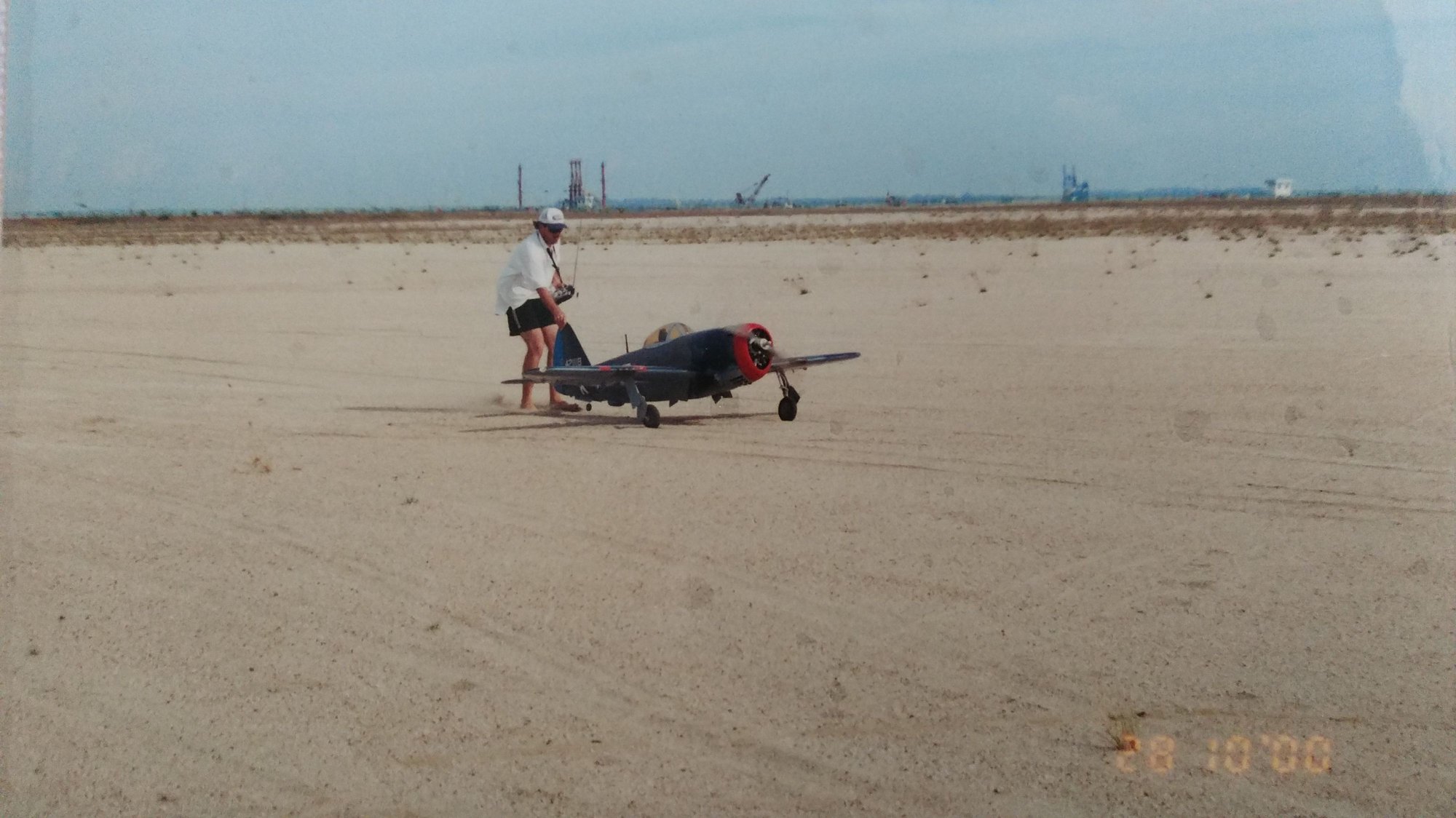

The pic is a 1/3 scale P-47 I was flying 22 yrs ago. The fuse was re-enforced fiberglass, wings/tail were foam core with obichi, carbon fibre and glassed, engine mount was carbon, main gear used golf buggy wheels and the motor was a monster 3W-240B4 quad and it came in at 65kg.
It was 95% wood as well.
