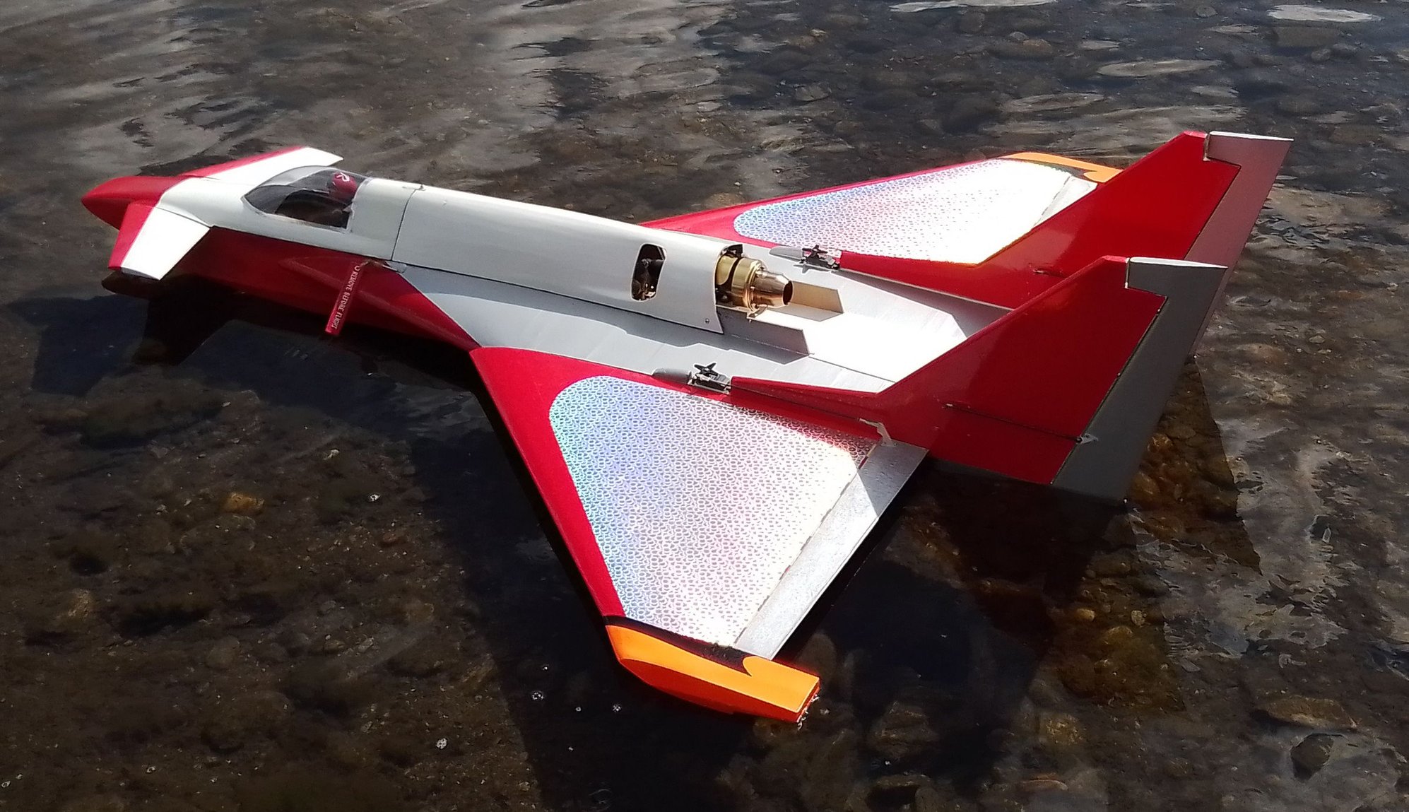

Engine in question is a Wren 44 gold (10 lb thrust) that I bought in 2007 for a model that I was planning, a delta-wing seaplane, a sort of cross between a Northstar and a CARF New Rookie (both of which I had at the time).
Finished the model this year (slow builder) and it flew well. My problem is that on every landing, and sometimes just on a low slow pass, the engine would quit. Deadstick landing, retrieved by rescue boat, no problem really. But why does the engine quit when pulled back to idle every single time?
Yes, I tried increasing the idle revs from 55 to 60k. I tried increasing the deceleration delay by 4, then another 4. It would never do it on land when I tested it, no matter how sharp I was with the throttle. It only happened on landing, or low slow passes with throttle closed, even when still airborne (so not a water splash).
The only "different" thing about this model was that, since it was a flying boat, the tank vent could not be the usual nipple on the fuselage floor, it stuck out forwards, like a pitot tube or a refueling probe. I wondered if the engine quit when pitot pressure applied to the vent reduced as speed bled off. I tried simulating that by applying pressure to the vent pipe (and the idle rpm increased sure enough) but when I released the vent over-pressure the engine settled to idle rpm quite nicely.
So, just out of interest, can anyone suggest why this was happening?

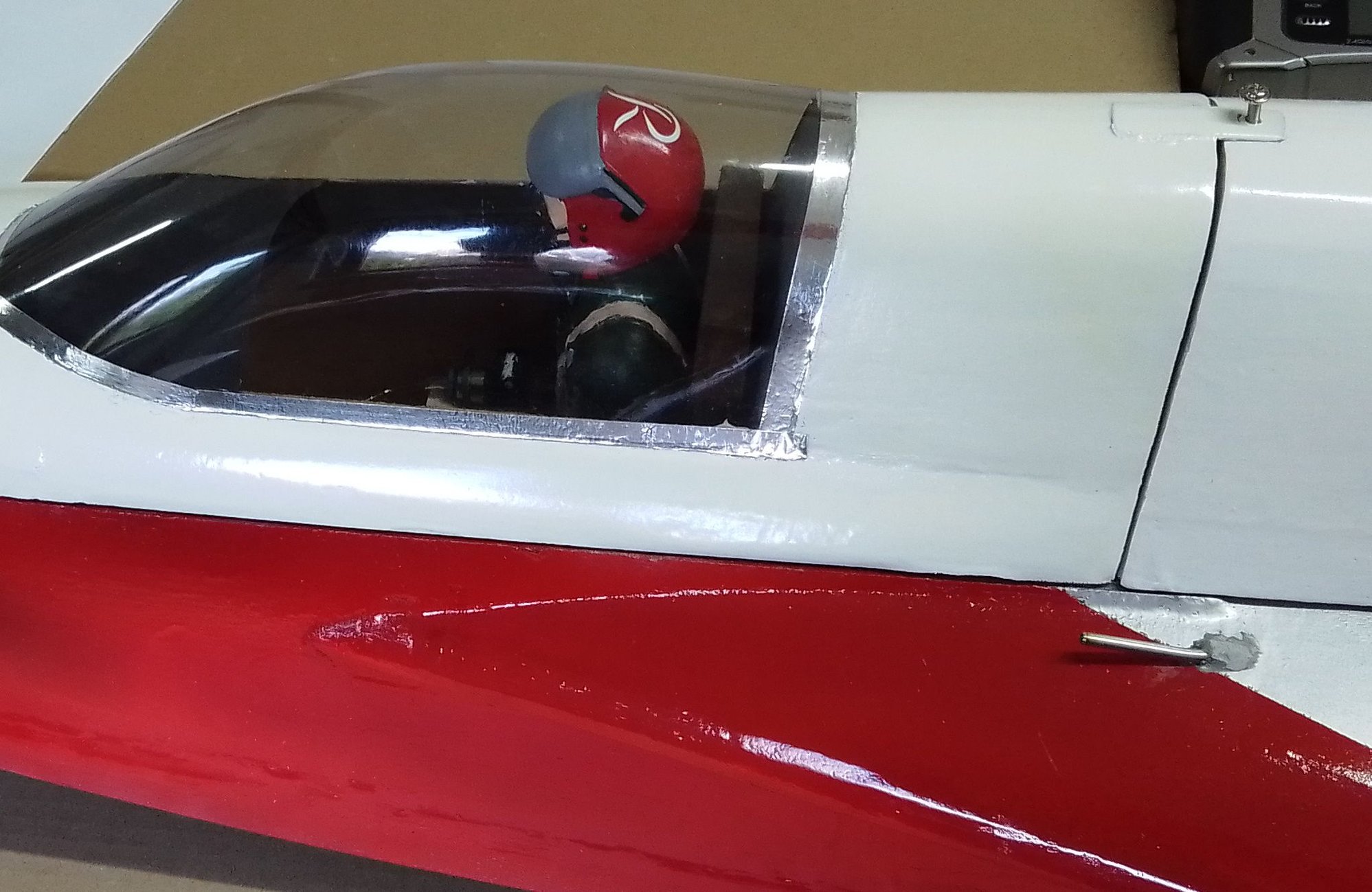

That's the vent pipe just below the canopy/hatch rear corner.

Hi Alasdair,
Given your vent is fairly close to the wing leading edge and also close to the wing root/fuselage junction I wouldn’t be surprised if the turbulent air in this region was leading to pressure variations in the vent. These are just as likely to be negative as positive. Also on a low pass or landing you are likely to be flying with the wing at a higher angle of attack which again could change the turbulence in the vicinity of the vent. Given that you have already proved that pressure variations in the vent affect the ECU’s ability to control the idle Im fairly certain this is what’s happening.
If the tree hadn’t severely modified the aeroplane I’d have suggested adding a U bend to the vent so it was facing backwards. This would be much less likely to see pressure changes even if the effect is to reduce the pressure in the vent.
