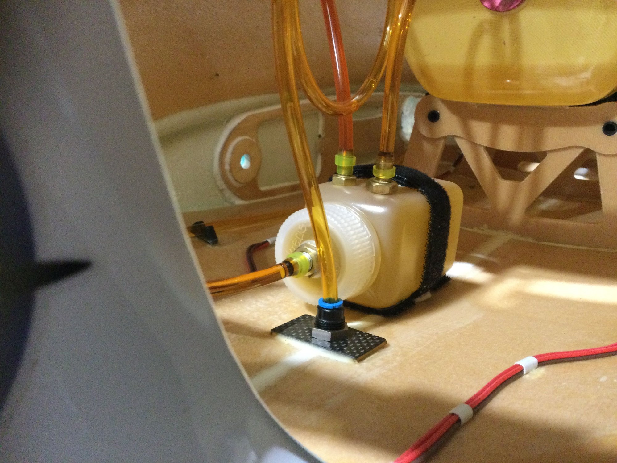

Tank mount goes behind the tube. It should also be glued to the wingtube sleeve for additional stiffness.
Vector rods need to be trimmed slightly. Degrease the threaded rods very well, then hysol them into the carbon tubes with an adhesive you really trust. If those pullout it's game over.
Carbon rods over the threaded rod just free float. They're provided to increase the stiffness of the threaded rods, so they can't buckle under extreme loads. Most critical for the flaps. There is a manual that is mostly pictures that you can get through your rep.

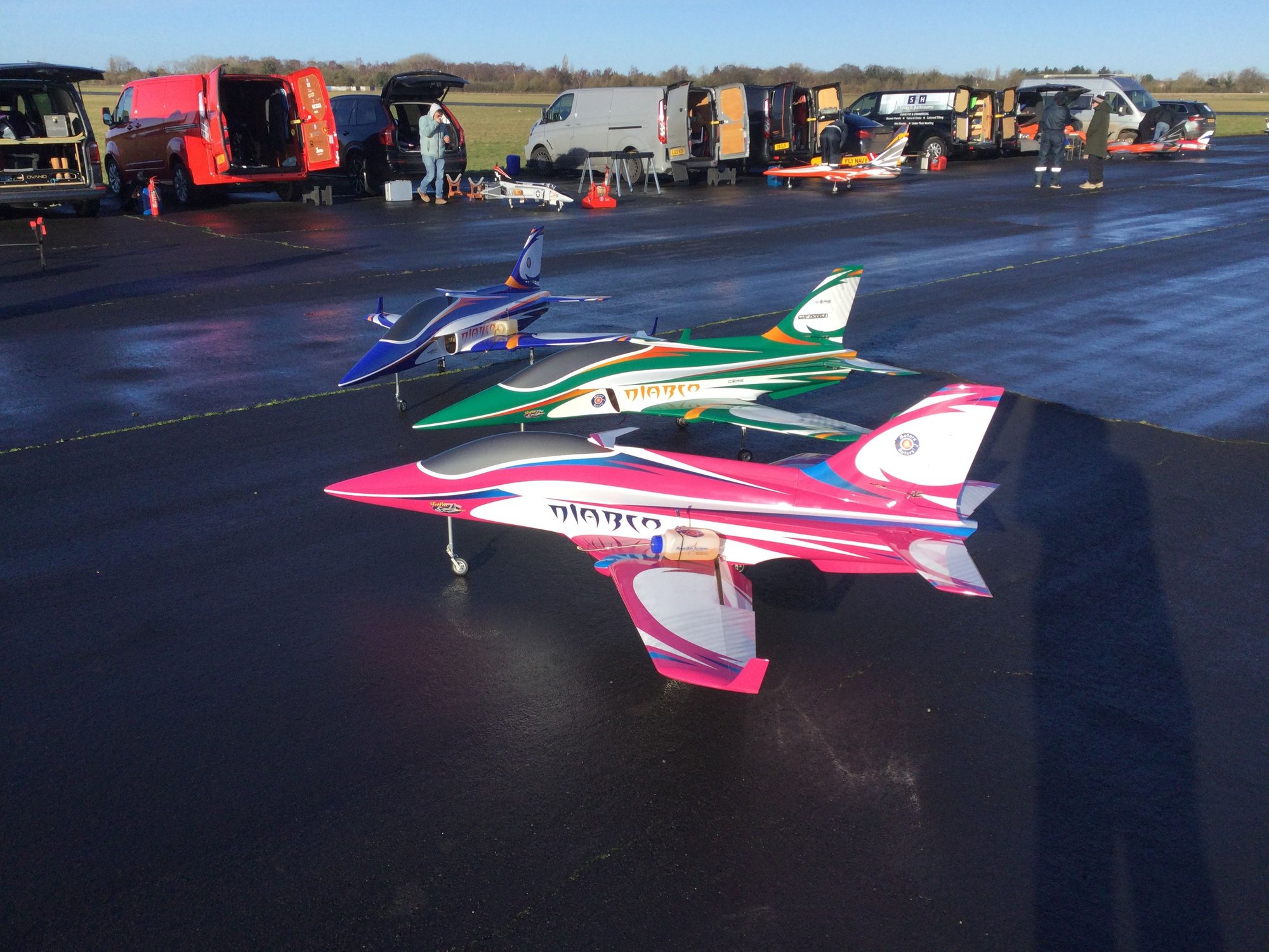

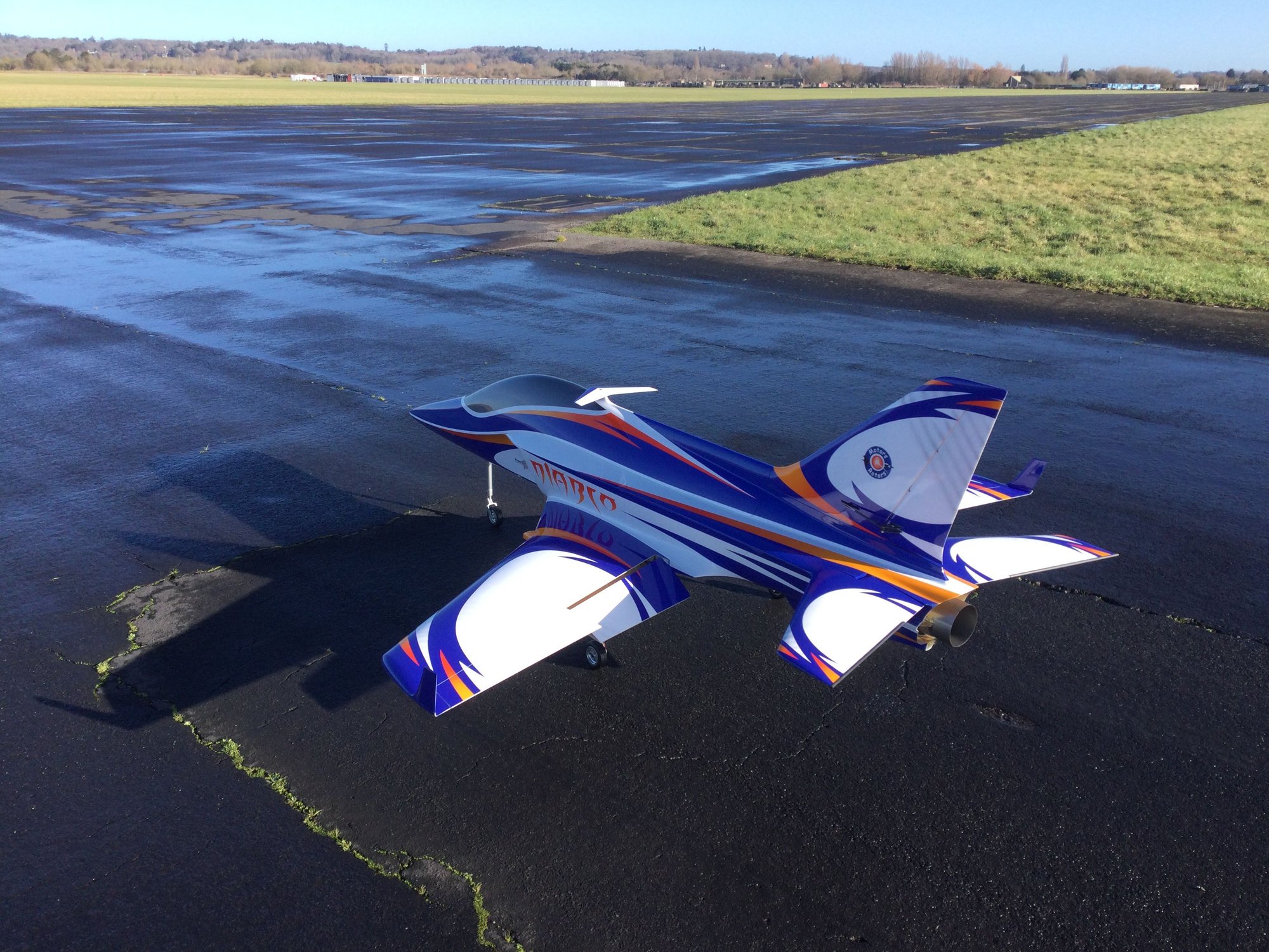

Few shots AP took of the thread starter last weekend at Elvington Jets. In just over a year of flying I have done nothing to the Diablo. All the equipment is the same, mainly charging Rx packs-JetCat take care of the ECU pack and Electron sip so little power I get more than one flying session out of a charge on the Retract Li-Po.
I’ve been helping customers who are not 3-D pilots set up the Diablo, it does not need very much elevator travel for normal flight programme-Take off, aerobatics, landing. 20mm movement is enough.

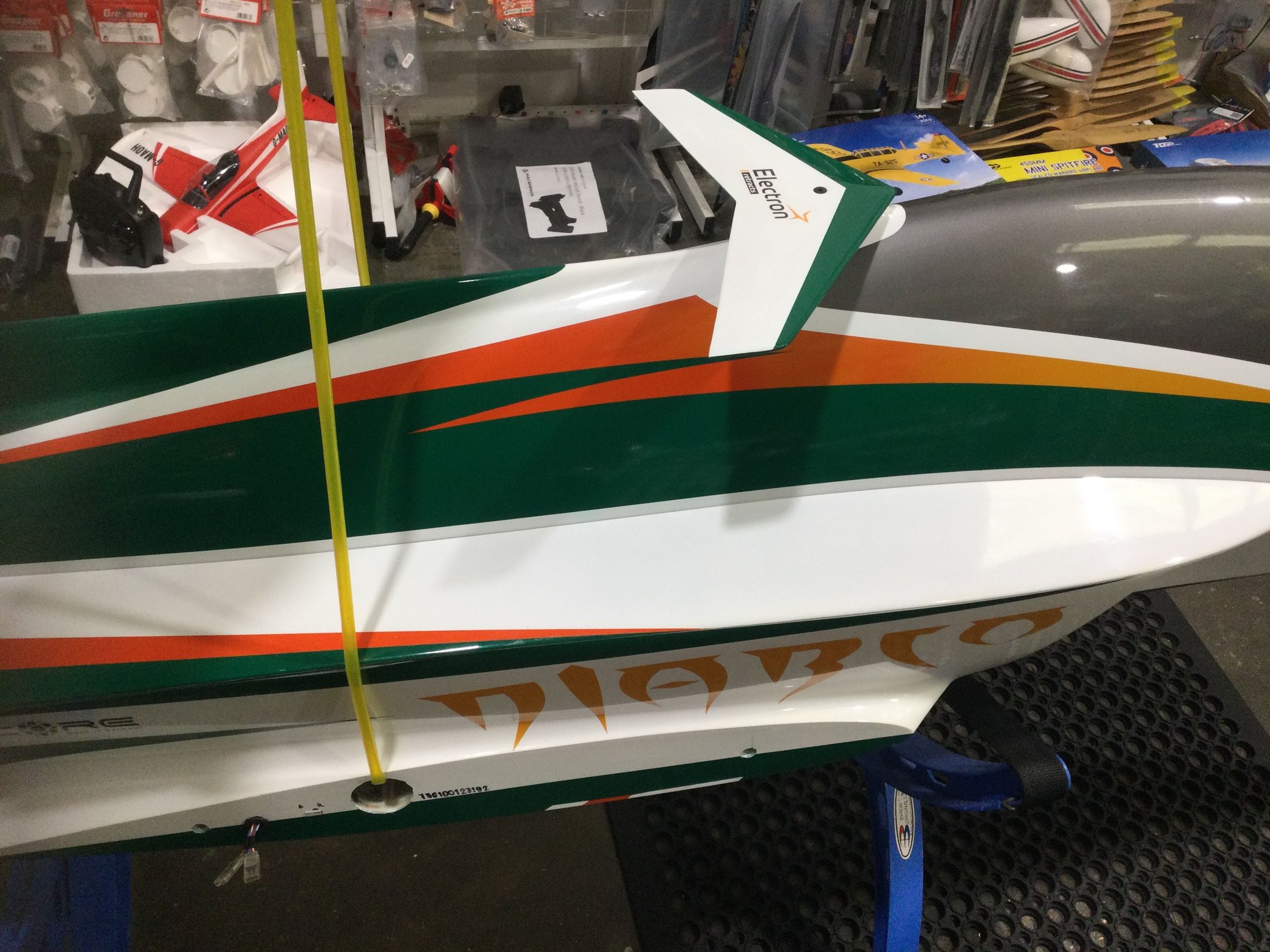

My way of balancing everything except wings on, this fuel in tank and it balances middle of tube.

Dave, do you balance it without the wings with the nose wheel down? I assume yes but wanted to double check. Thanks.
Old 05-03-2025 | 10:33 PM
  #124
Joined: Jun 2002
Posts: 13,258
Received 788 Likes on 571 Posts
From: Watford, UNITED KINGDOM
No this is nose gear up.landing fuel. Tails on and canopy. Middle of wing tube.
