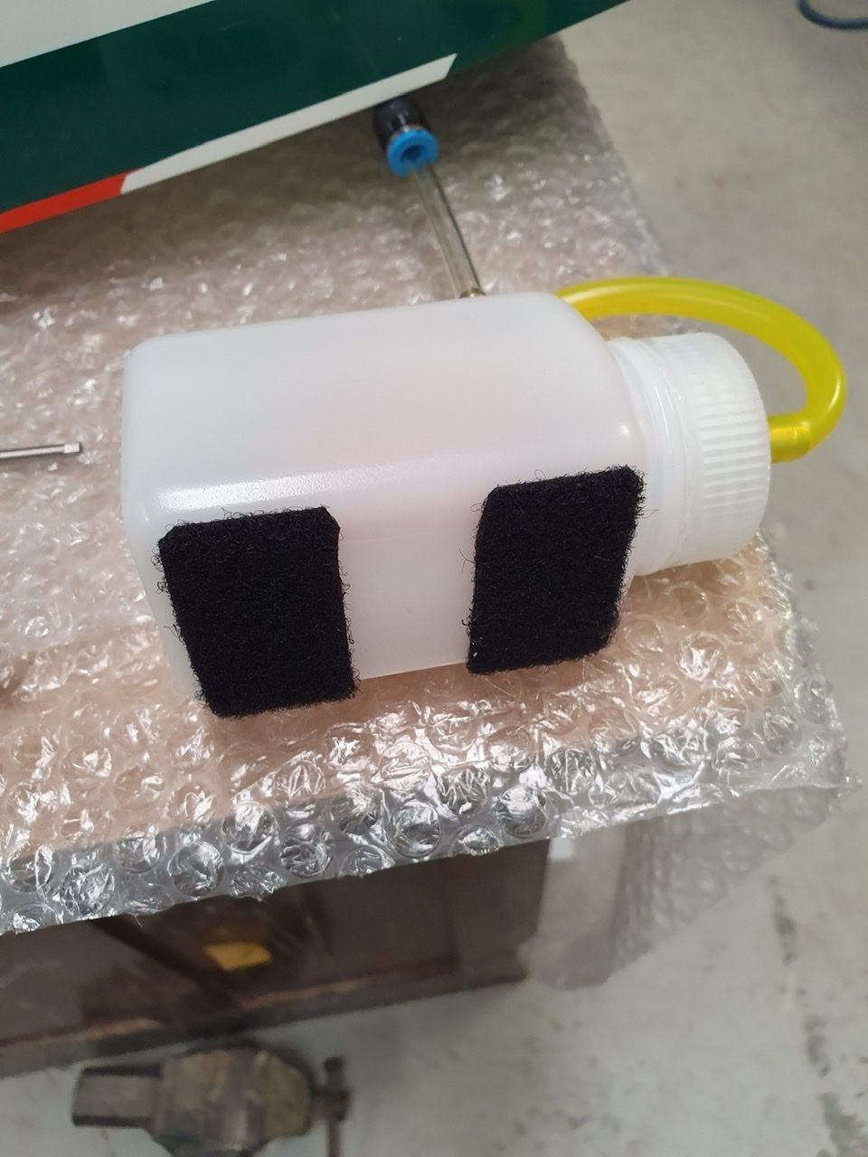

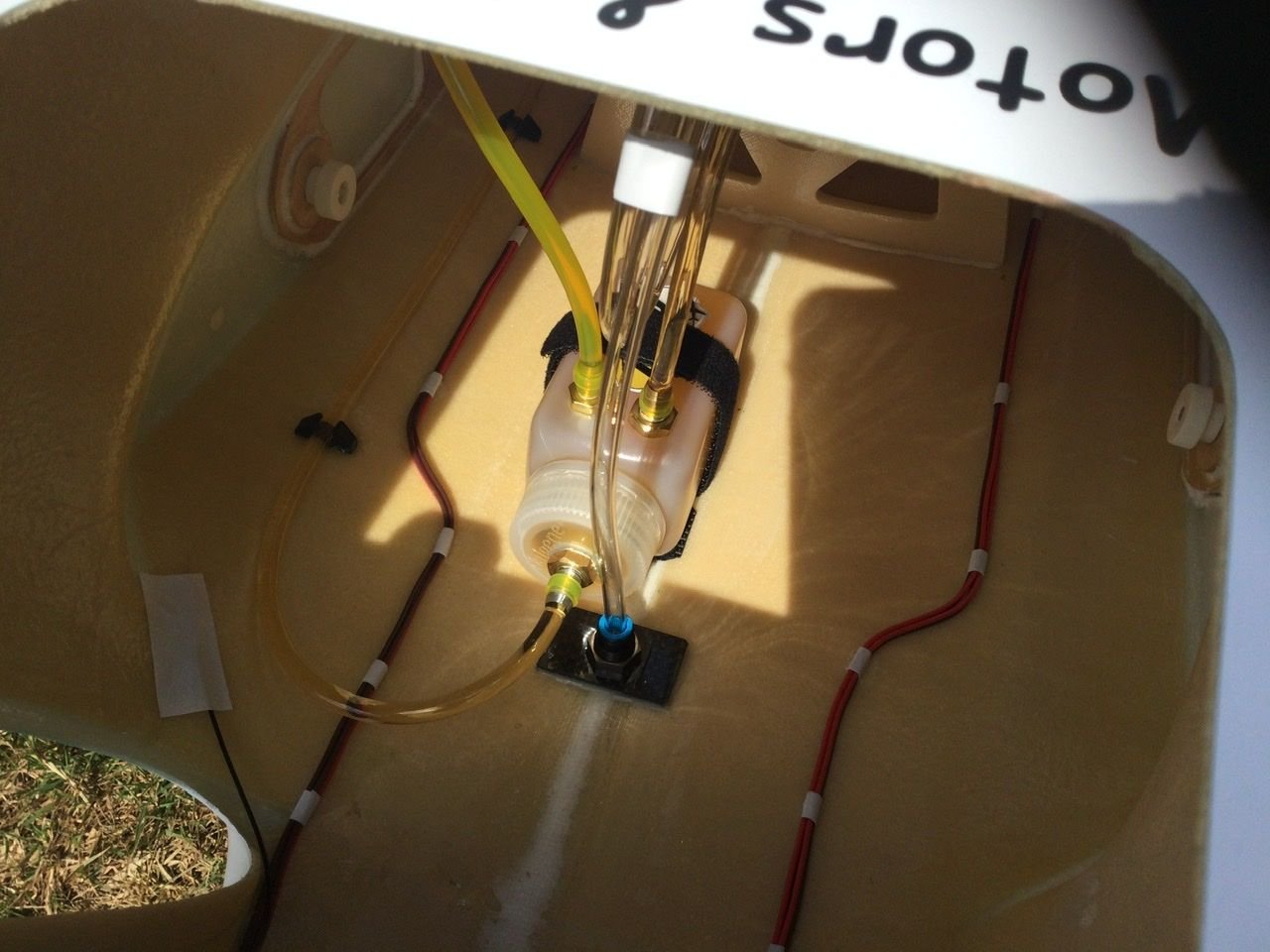

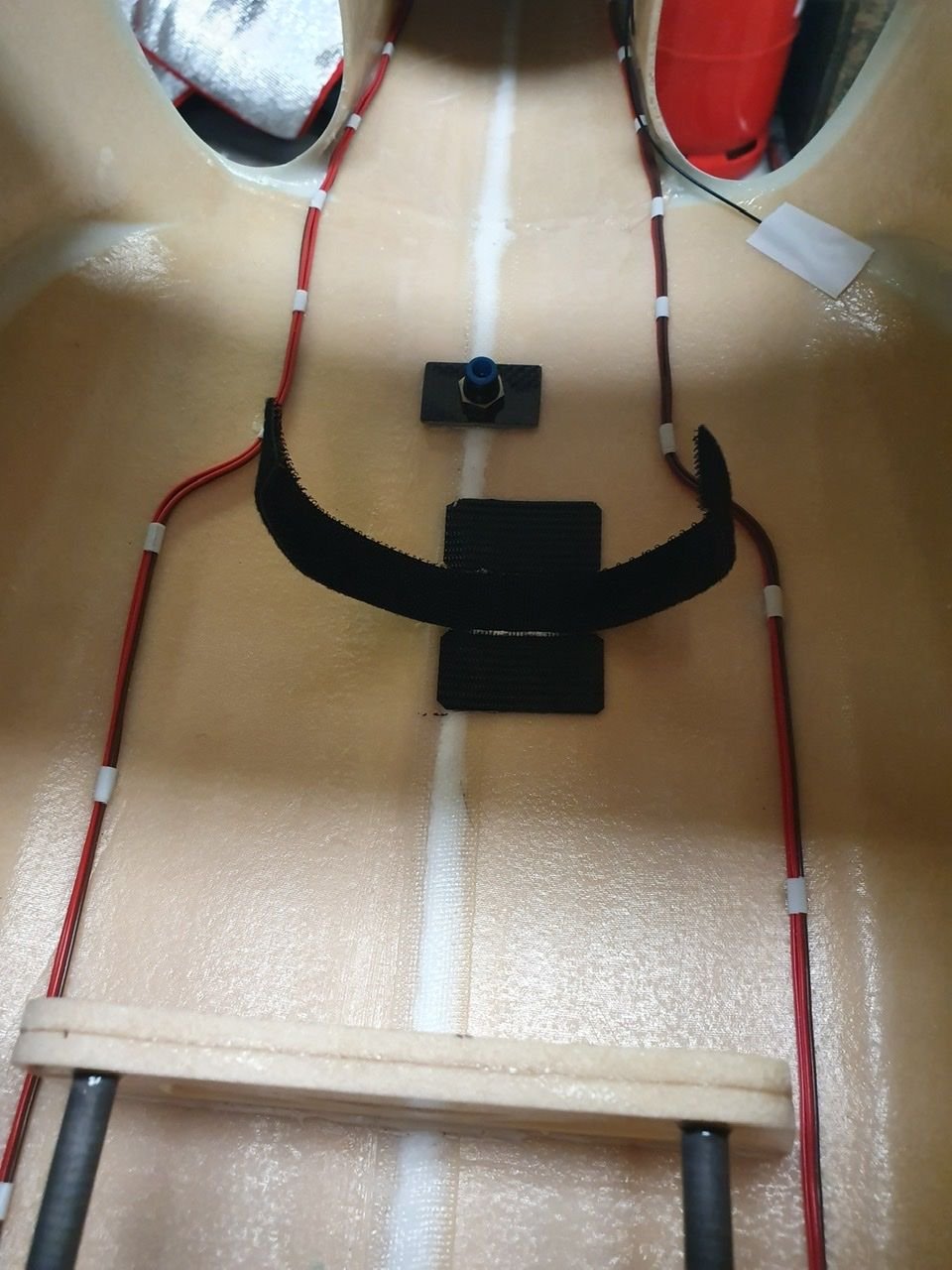

Velcro…pad and straps

Bit like this…

With the Velcro method you are Hysoling the strap down, the pads are only to stop it sliding through, it will last a models life time, but I do CA the sticky Velcro down…
