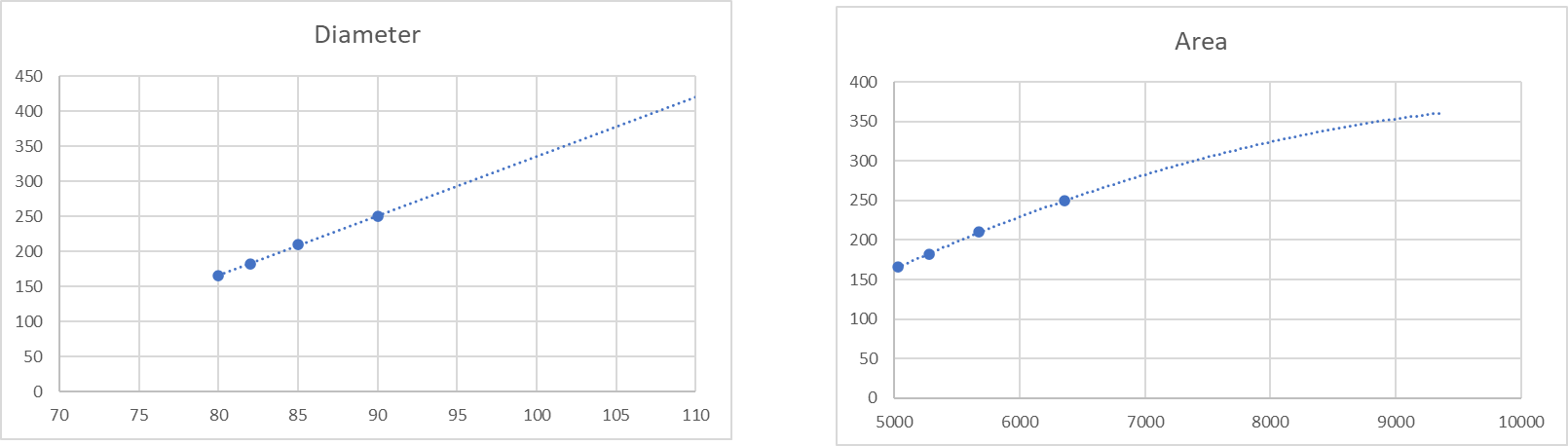

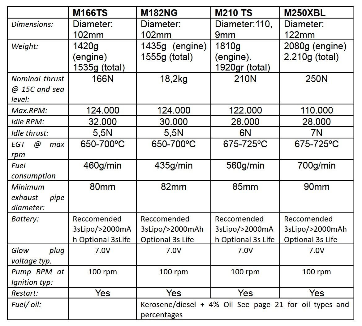

Fred,
Not a 320 specifically, but the Jets Munts manual gives minimum pipe sizes for their engines. It might be a starting point for you.
Plotting pipe size by both diameter and area and extrapolating gives a minimum pipe diameter for a 320 as 100mm.
Paul
