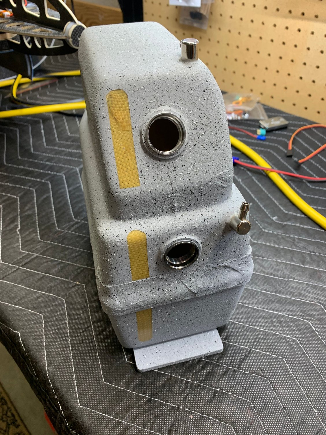

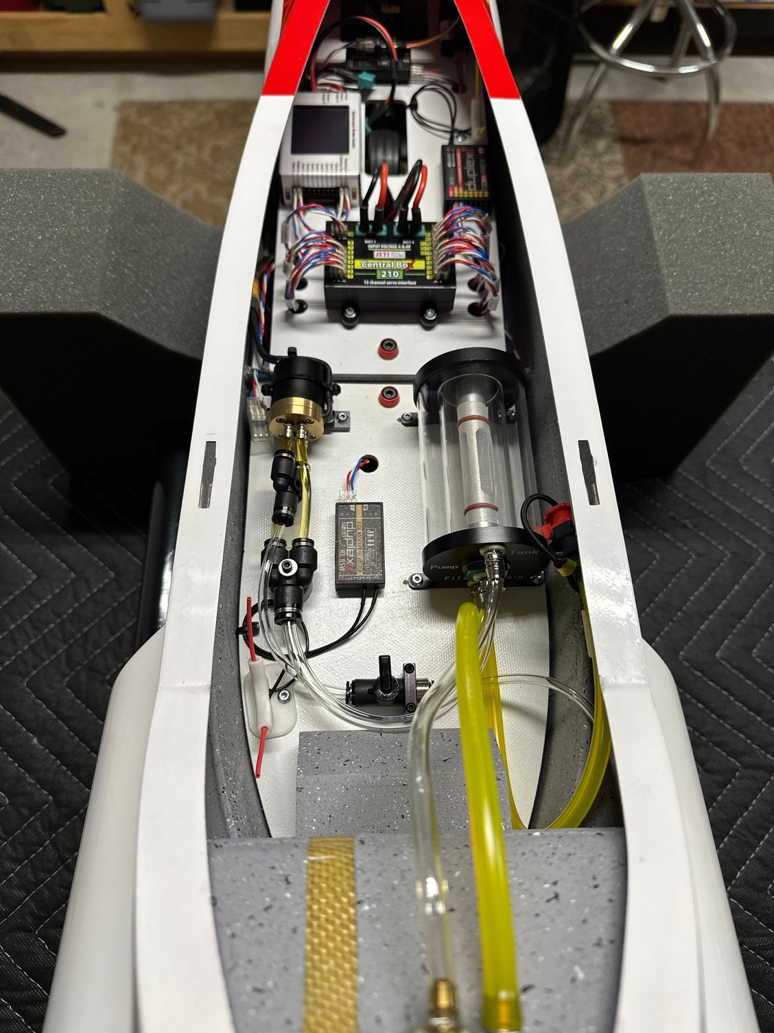

I paint them, they look so much better and adds such a small amount of weight. Painted the entire inside of my Diablo, grey primer followed by stone paint and it added a total of 3oz. And that includes the inside of the canopy. It fuel proofs everything and makes it so you can clean up spills when you have them.
In planes with a radio tray (the Diablo doesn’t really have one) I paint the radio tray gloss white. It’s a really nice combo with the stone paint, again fuel proofs it and it brightens up the inside so you can see in there.
They always get a ton of compliments at the field.

What kind of stone paint do you guys use?
Old 08-03-2025 | 04:01 PM
camss69's Avatar
My Feedback: (46)
Posts: 2,036
Received 79 Likes on 60 Posts
From: Cameron Park, CA
These are what I use.

Does the Rustoleum hold up against fuel?
Your airplane looks awesome.
Old 08-04-2025 | 05:53 AM
camss69's Avatar
My Feedback: (46)
Posts: 2,036
It has so far, if you clean it up right away. I’ve had a couple of pretty large smoke oil leaks fill the bottom of the plane and it stood up to that just fine.
The key for me with the stone paint is a coat of grey primer first then a light coat of the stone paint on top. It is way easier to get light weight coverage than with just the stone paint alone.
